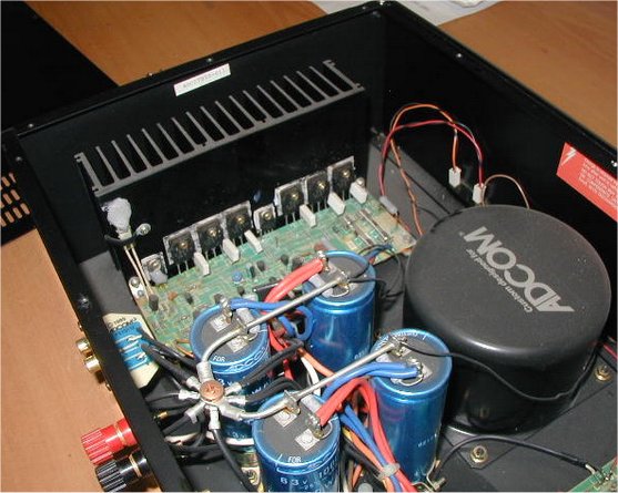

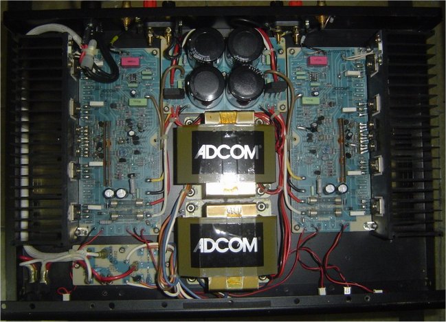

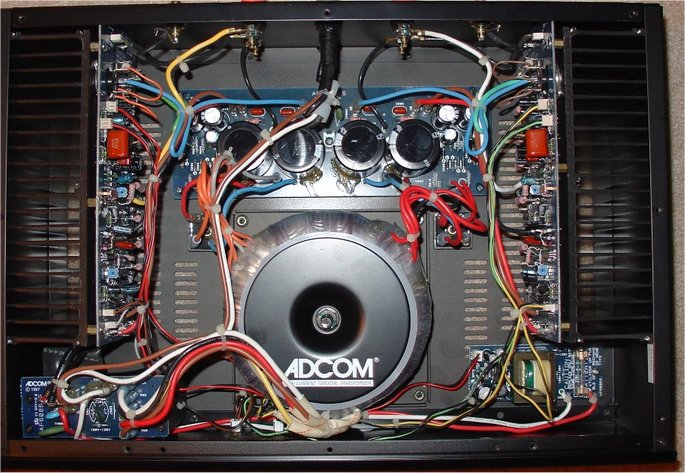

Perhaps Andrew T. could clarify .... but look at the ADCOM's -
photo 1 = single bridge/single trafo.
Speakers both go to single central star.
Photo 2 = dual bridge/single trafo.
Speakers go to separate L-R star's.
Photo 3= dual mono/dual trafo
Speakers also go to separate L-R star's.
The only difference with the badger is the fact it has onboard supply caps. the Adcom leaves this feature out and even sends the zoble return back to the offboard star on small black wires (all 3 photo's).
The answer would depend on what PS setup you have.
PS - those adcom's (535/45/55) were designed by Nelson Pass !! wow...
EDIT - even for scenario 1 (single) the "SPK" terminal would act as just one return to the star.
OS

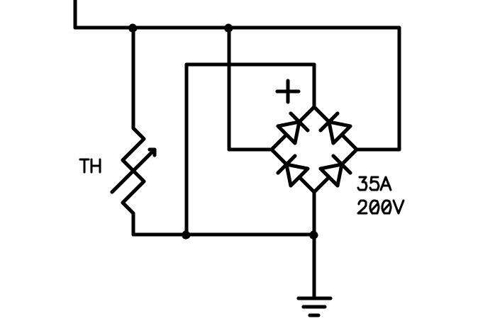

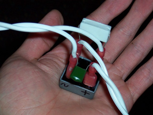

Ground loop breaker photo attached.
The bridge rectifier and cap are typical. However, there are many possibilities of resistor to use, such as thermal resistor for a more effective disconnect or a wirewound for high surge tolerance. The resistor is usually chosen specific to a design.
Rectifier schottky does not work here because it would switch too much--The diodes are a standard silicon type (ordinary) set anti-parallel, giving approximately 0.7v drop in both/every directions. If the ground loop exceeds approximately 0.65 volts, this device will switch on and conduct. It may be informative to measure the voltage across before installing the resistor.

post549 shows two wires IN and two wires OUT.
That does not look like a normal implementation of a ground loop breaker (or Disconnecting Network)
A Main Audio Ground to Chassis safety connection is a ONE WIRE connection.
It can be either a direct copper wire connection, or it can have a Disconnecting Network in that ONE WIRE connection.
I have never seen a TWO WIRE Disconnecting Network.
Why on our Earth do we need a Power resistor. How much power can it dissipate when a 1kA Fault Current passes through the Disconnecting Network to the PE protected Chassis?
I'll show you an approximation of how much power.
Vf peak when passing 1kA through a pair of paralleled 25A or 35A power rectifier diodes can be around 1V to 2V.
Allowing the higher estimate of 2V the instantaneous peak dissipation (until the mains fuse blows) is 2V*2V/10r = 400mW for <0.1ms.
Any 250mW or 400mW or 600mW metal film resistor will easily survive this peak dissipation.
Even if the resistor were to fail the Disconnecting Network is still perfectly capable of passing the next 1kA Fault Current to the PE protected Chassis.

Be sure that the IEC ground connects directly to the case rather close to the inlet. The system ground can then connect to the case someplace convenient.
You might also consider lifting the system ground with a 35A bridge and CL60 like Nelson Pass does in many of his designs. This arrangement would go between the star and the case.
