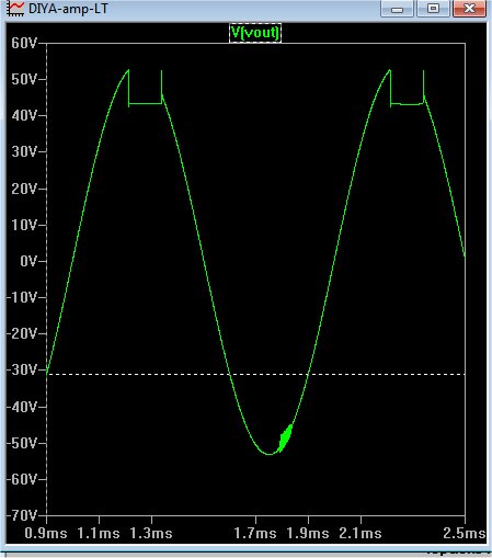

Look below to see what you got me onto ... looks familiar ,aye.
Anyone who says the simulator ... (with accurate models -Andy C's + B.Cordell's) can't predict the real world is dead wrong.
Manufacturer models and standard LT spice models do not show this "quasi saturation" variable .... So this is a issue that might plague
many a DIYA amp (most with this topology).
Glen Klienschmidt (GK - former DIYA member) solved the "sticking" problem somewhere in the "frugalamp" thread , I will find the solution. Why not go for perfection. 😀
As this amp is ... at 63+VDC , you would have to exceed 110V P-P(below) to create this condition - highly unlikely. That's one hell of a peak , and even if you do that parasitic oscillation would be mostly absorbed by the Zoble /output inductor.
My present badger uses a 70V rail for the LTP/VAS. That is why I could not recreate this on mine - the output stage clips way before the VAS does. 😱😱
I will explore this "anal" pursuit for perfection in the Badger discussion thread -
A good healthy dose of "mental masterbation". I think it just requires a couple of strategically placed high speed diodes (another option with minimal rework).
PS - My low voltage amp will have all 3 pairs - needs to run a 2R subwoofer. A lower voltage Badger just needs to have lower gain
to avoid the "hard clip scenario" + the above recommendations in post #589 .
OS

Wow, how about that! At least I know it wasn't something I have wrong. I figured it probably wasn't something that would matter all that much as it happens just as the amp clips and we rarely run that hard. Still it will be good to find a cure. I hope you stay with it. I didn't try it with the bigger Tx. I just let it play. This is a very pleasant sounding amp. I'll get some caps ganged together this week and put a case together. I think I'm going to like this amp.

Try a fast diode such as ug1d or even general purpose one such as BAV21 between the base of Q9 and collector of Q10. If it does not work then maybe one of more complex anti saturation circuits like those used in Stochino amp would work.

Sorry, that trick with that clamping diode would have worked if LTP-VAS were upside down. Then Q10 would be the lower VAS and this diode would connect its collector to potential higher than its base preventing saturation.
cheers,
PS attached is a version of Stochino with three pairs of output mosfets We have been developing with a friend of mine for some time. In newer version there are a few more resistors but anti-saturation circuits as designed by Giovanni are shown and these work.
