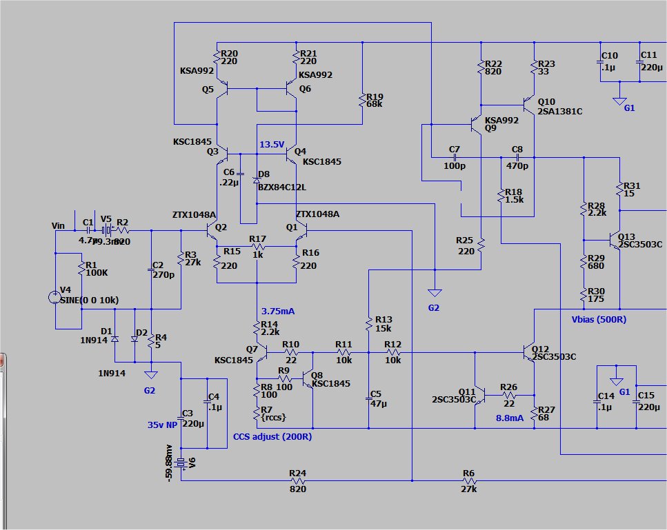

Instability upon bias change
Greetings all,
I have been lurking here for a while, but this is my first post. I have built up a HoneyBadger system, pretty similar to JoJo's: Soft-start, Antek AN-8445, 2xUniversal PSU (1 per channel). This is my first amp build, but please don't hold that against me 😛
Upon firing up my first channel (with the bias, offset and ccs resistors set as per the build guide) all seems well... no smoke escaping, led's nicely lit. My offset was a couple of mV. The TP1/TP2 bias measurement was sitting around 0.1 mV. I measure around 7.90 V across R14 (ca. 3.6 mA). I have noticed the heatsink for Q10/11/12 is a little warm, but the output stage transistors are cool. I notice R50 is ever so slightly warm. I have nothing attached at the outputs, apart from a DMM if I'm measuring offset.
Anyway, as I slowly increase the bias all seems well until I hit around 8.2 mV at which point it sky-rockets to closer to 100 mV (and I proceed to turn the unit off). Less than a quarter turn back, and with the unit switched back on and it seems happy again at around 8 mV. If I don't turn the unit off after it has sky-rocketed (and instead try to wind down the bias) even at max resistance of R30 (500R) the bias voltage remains at around 30 mV, until I switch it off and on again, at which point it's back to 0 mV. Sorry about all the information... I figure more is better.

R50 slightly warm = possible instability (oscillation). It should be cold.
I had this happen once when I forgot to set the cascode. Check to make sure you have the C-R or C-Z jumper in (or test the bases Q3/Q4 for a steady voltage,whether it is the Zener or resistive divider).
Also, what input devices are you using. Some ultra high gain Zetex models (simulated) have required extra degeneration (R15/16 higher value) for normal
operation.
Ground the heatsinks ! Check the Q9/Q10 - C7/C8 area, make sure it is right. Also ... you might try
increasing R24 (TMC feedback) from 820R to 1-1.5K.
fire up the second channel , this will determine if it is a mistake or not.

Thanks for the quick reply!
The cascode is set using a Zener reference (C-Z jumper). The voltage across the Zener is 14.34 V.
My chassis heatsink is connected to ground, but the aluminium plate at Q10 to Q12 is not. Should it be?
Everything seems in order in the Q9/Q10 - C7/C8 area and I can't find any shorts. I have tried increasing the TMC feedback resistor to 1k. This has the same effect as before, except I can get to very slightly higher bias voltage before the instability, around 8.8 mV.
I have used MPSA18 transistors for Q1 and Q2. Would you suggest increasing R14/15 in this case? If so, how much higher? 150R? 200R? 1K? Would it be easier to swap these transistors out?
I fired up the second channel and I think it's the same story, but I'm not too sure as I left it on a little longer (at higher bias) and it fried my fuses and "safety" resistors (both R53 and R54). These flameproof 22R resistors just got flamed and now measure around 23k! It seemed happy for several minutes before I touched the bias. I guess I'll try and get the first one going properly before I come back to the second one.

MPSA18= Hfe min 500 and max 1500.
Too bad that they do not have gain groups - no way to tell if you have 500 or 1500+ 🙁 ..
KSC1845(f) = Hfe 300/600

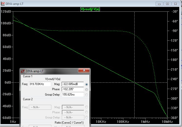

I plugged in a Zetex 1048a (below-) , the highest gain model I had (Hfe 1200+).
Yes , the phase margin was "on the edge" (possible instability).
If you have Hfe 1200 (or even 1500) MPSA18 , increase R14-R15 to 220R.
This brings the phase margin back to 78deg - stable , (see below.. 180-102deg.=78).
Also shown below is the high gain zetex models with the resistor changes.
I ran this with the global feedback resistor (R6/R3 - gain) at 22k/27K/and 33K - good.
I tried to get my amp to oscillate when I first built it. Lowered the Q10 miller cap to 47p (nope-all was good). When I lowered R14/15 to 10R (misread the resistors) , I really oscillated and could not set the bias.
Totally SMOKED the zoble resistor !! This was with standard KSC1845(F-Hfe300-600).
PS - you might want to consider using the ksc1845(f) or BC546 BC547(a-b) as LTP.
Also , if the current mirror (Q5-Q6) has uber high gain ... this will have the same effect - something to consider.

This kind of oscillations is one of the worst things to happen as it is difficult to locate its source and the source may be in the quality of some parts including output transistors. I encountered the same problem with "diamond" amp. By the time we got a clue (a friend of mine assisted me) board was almost ruined from desoldering and soldering so I gve up before checking the most recent solution (worked in simulations).
I know very little about TMC but I noticed that in some amps a small antioscillation resistor is added. In HB it would go from C7/base Q9 to R5/R6 joint - C7-additional R are parallel to R6.
In LTP one can also try 100pF plus 1k between collectors of Q3-Q4 if problem is there. Then driver transistors (q14-15) and their caps.
