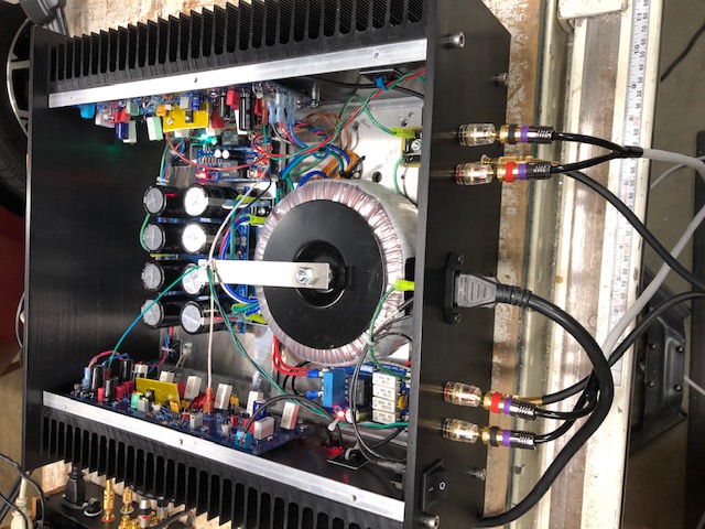

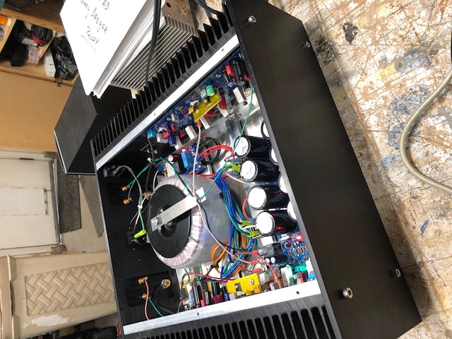

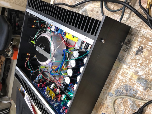

Wanted to thank all you folks for the help and trouble shooting advice, I have the Honey Badger up and running and it sound awesome. Its in it hand machined box that I did myself, and had that anodized locally.
I have let it run for hours and it doesn't even get warm.
Again thankyou all and a special thanks for working with a novice. You made all the difference.
Learned a lot.
