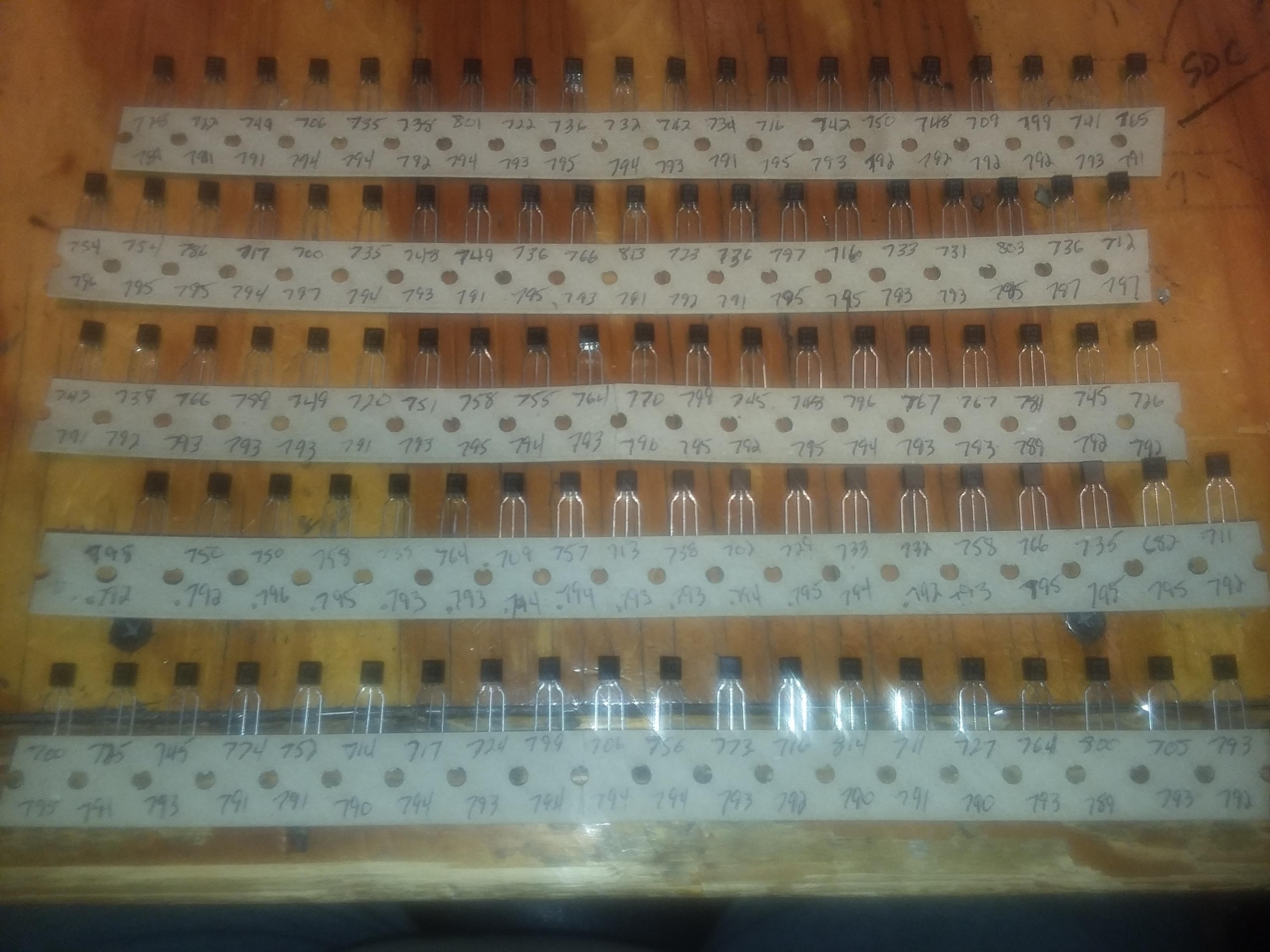

If anyone needs MPSA18, let me know I just matched 100-pc of them for Hfe and Vbe
Hfe is in the 700-800 range, tell me what ou want and I'll ship ya some.

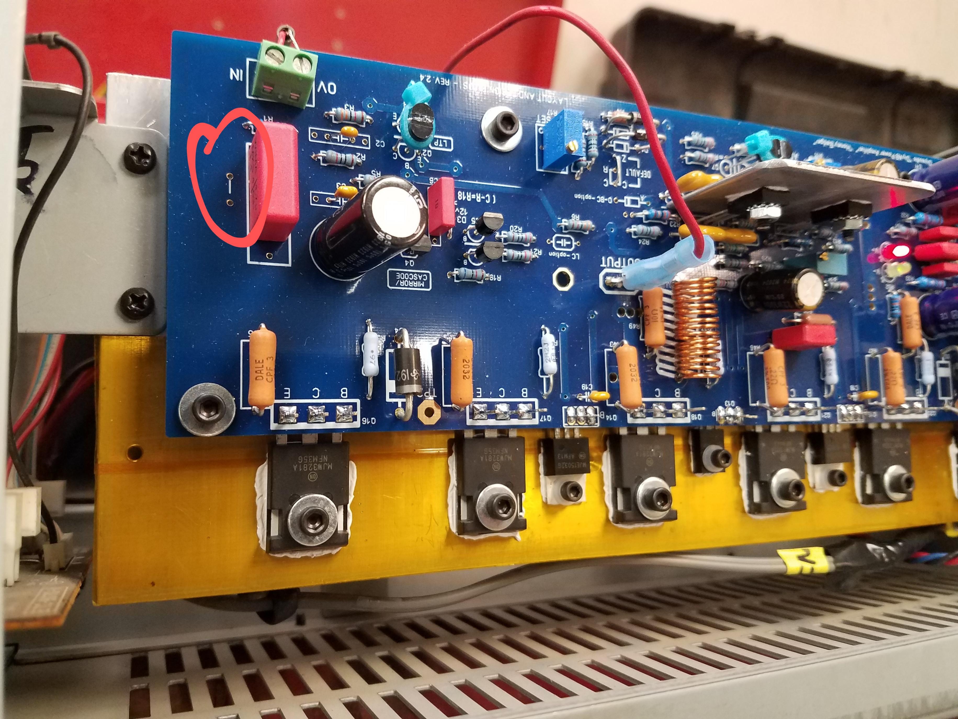

There is a guy who called me up to buy a used amp, which I ended up not selling, it was a Denon poa-2200. I ended up turning it into a honey badger amp. Somehow, the guy called me again, and I talked him into trying his hand at building a honey badger out of a Denon like mine, and I'll be damned if he didn't go out and buy a used Denon amp, and order the honey badger boards. The other night, after installing the circled jumper, having no electronics experience, but being a capable dude, he wrapped up his build and got both boards up and running. I helped a bit over the phone and with bom. Pretty fun. If you want a simple build, the Denon poa2200 and probably a couple other similar models, make an excellent platform. Heatsink is perfect size, power supply is perfect size, and blah blah, here is one side of his amp...
Just wanted to share this fun story.
