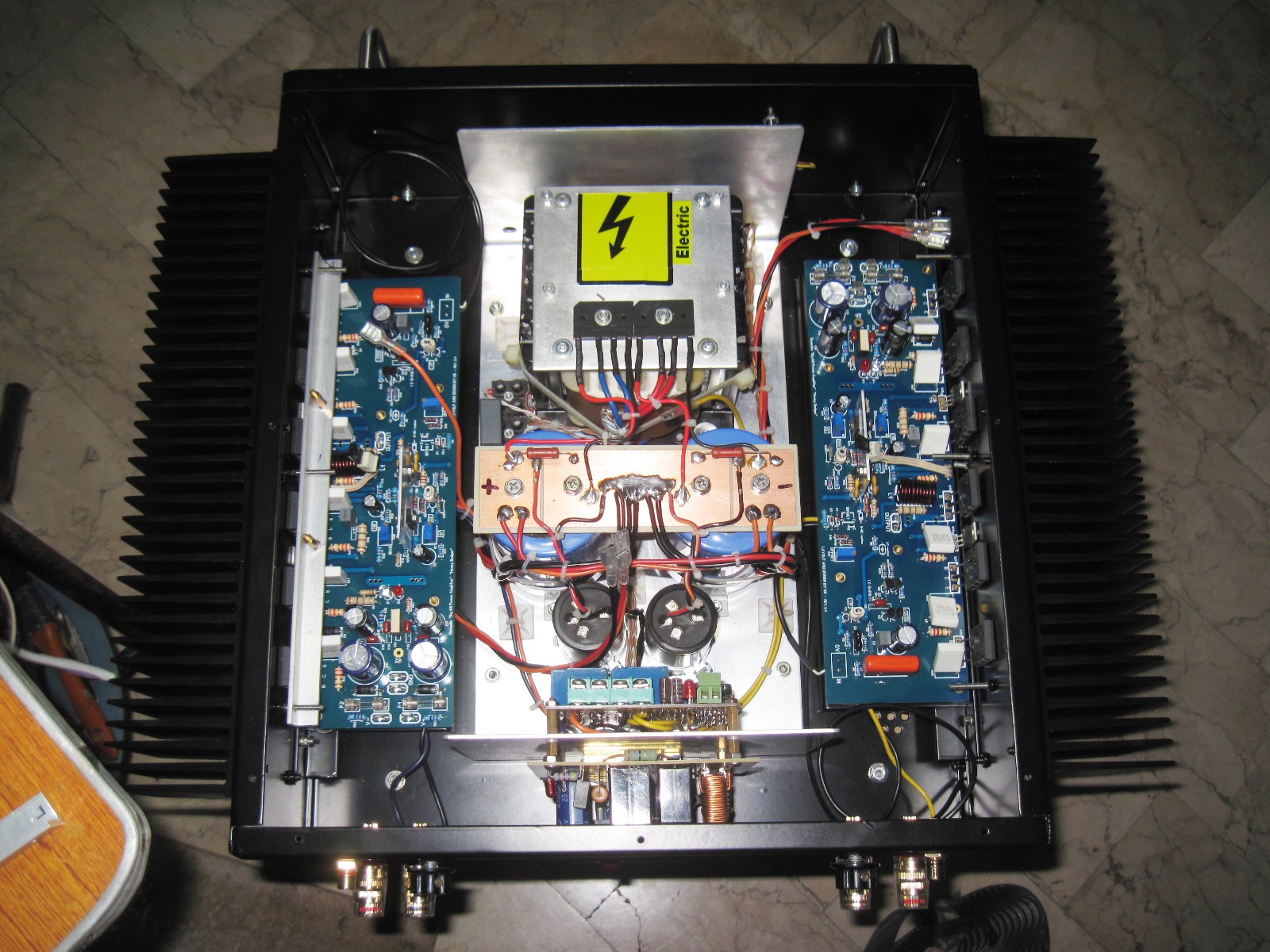

Hi Chris, as you can see in my picture, i used the Nelson Pass dual rectifier bridge configuration so that the transformer center tap, there being none need not connect to any filter cap junctions...in this way, there is galvanic isolation between the traffo secondary and the psu filter caps...
in all my builds, tubes or ss i employ a central grounding network, and it has given me quiet amps so far....

If you use two separate bridge rectifiers, then you can’t get a symmetrical psu of for example +50 and -50V?
Wouldn’t you get +50V and 0V? Or is there a way with two separate rectifiers to still get the symmetrical psu, needed for the amplifier boards?
With dual rectifiers you are rectifying the output of each output winding of the transformer to DC, then you join the positive output of one rectifier and the negative output of the second rectifier to form your ground. This gives you a symmetrical +/- power supply

@ jwilhlm What advantages do you have using 2 bridge rectifiers? I know that 2 bridges can handle more current then using only one, In this case of this chap having a modest power amplifier and he can use only one bridge Does it make any difference in audio quality?
Regarding symmetry if the windings of the transformer are wound together then the output voltages are also the same, if not with one or 2 bridge rectifiers the voltage difference between the windings will also reflect in the final rectified and smoothed voltage.

I can't remember the exact explanation as to why this is supposed to help, I just tried it in one of my first builds with great results and rolled with it. Here's another explanation from Nelson Pass as to why they are used.

the power traffo secondary if wound one on top of another and then joined to form the center tap will have different lengths and dc resistances, now as ac currents as drawn, the terminal voltage will differ unequally and this caused the center tap to wander about albeit small....

I do not think that the trafo has any reason to saturate
1)consider that you load the center tap winding one side with a 100w and the other with 200w what difference does it make regarding saturation of the core? The primary will see a single load of 300 watts that's all.
The return path is isolated by the bridge rectifier.
2) For me center tap wonder will occur mostly to imbalance of the value of the capacitor bank capacitance, ESR etc. after all we are looking at the peak voltage.
3) Looking a bit further how exactly is the gain of each output transistor is matched? some minor differences are always present and nothing is perfect in this world. The load imposed on the PSU is not exactly the same so it seems that one side will load more than the other. The voltage drop on each winding will be a bit different due to this. The center tap will wonder a little because of this.
A regulated supply will eliminate all this but it adds to more complexity of the setup which will hardly be noticeable compared with a non regulated one.

This sounds more familiar to what the original theory I was told behind the dual bridges. When using independent supplies for each channel (dual monoblock) different ground potentials between each supply can set you up for current flow through the audio grounds when using a source with common audio grounds.
