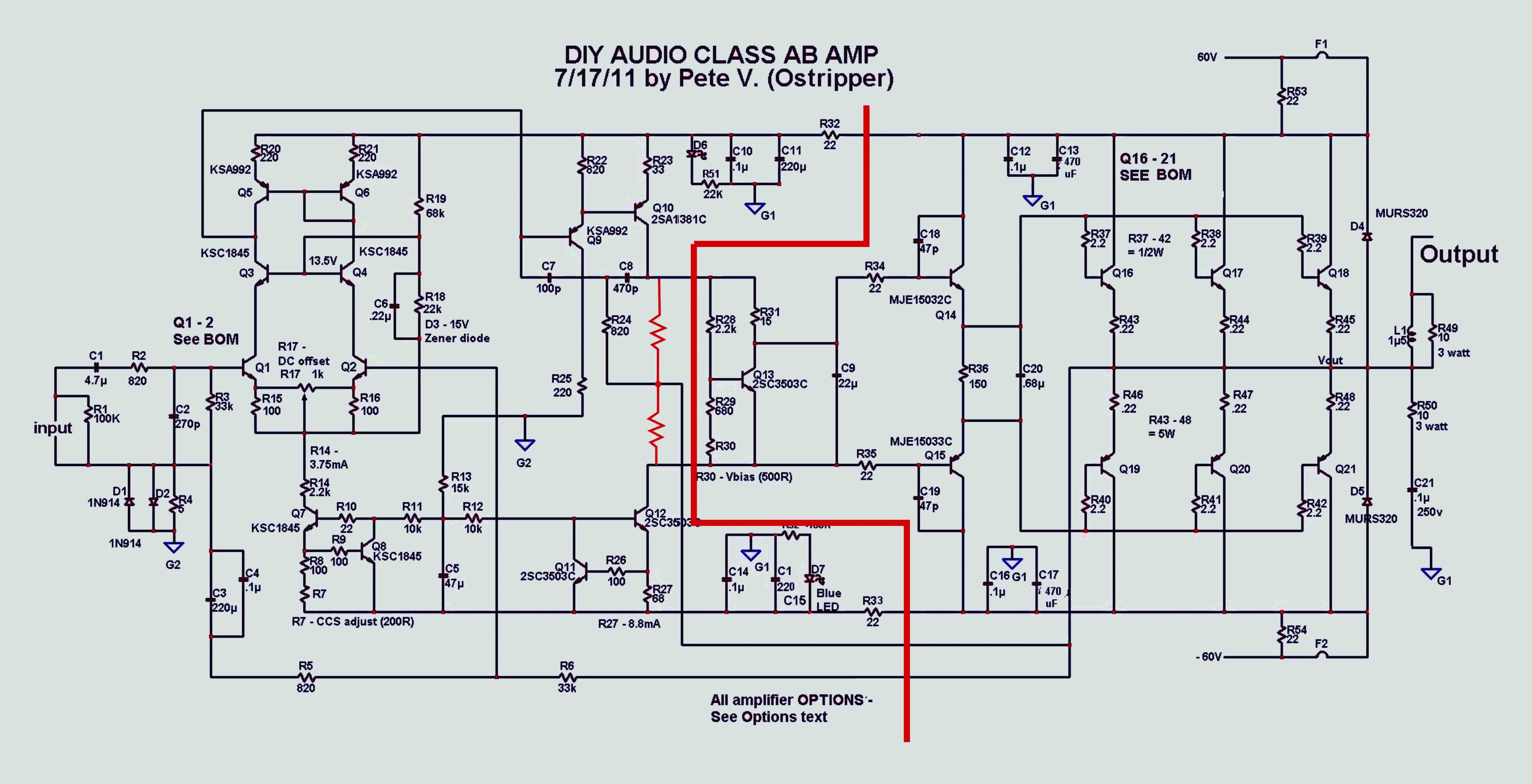

I was just wondering if there is a troubleshooting guide for the honey badger or any other class AB amplifier for that matter available on the web or on the DIY forum somewhere?
I have a friend who is having trouble with his honey badger amp and was just trying to help him out without doing any further damage.
I guess it easy to check that components are installed correctly.
Rail voltages are correct.
Use a current limiting dual rail power supply to help diagnose without letting the smoke out. But what happens after that?
Is it possible to divide the amp up in separate sub circuits "input stage", "Voltage amplifier stage" and "Output Stage" to check these. I have built the HB myself and luckily did not have any troubles. I have also built a few amps on a breadboard and know that due to the high open loop gain which is only placed under control once the negative feedback loop is in place it is a bit hard to just divide up and test the amp.
Maybe someone with a bit more trouble shooting skills can offers some advise.
Regards Stuart
This is a very good approach to building an amplifier. I always do this.
Assemble everything left of the red line. Install two 100R resistors temporarily connecting the VAS output to the feedback. Where the two red resistors join to the feedback can be used as output for testing.
Measure the voltage from the new temporary output to ground. This should be very close to zero volts. Measure the voltage drop across one of the temporary 100R resistors (either one, doesn't matter). Divide this voltage by 100. This will give you your VAS current. For example if you are aiming for 7mA VAS current (this is a good target) you should read around 0.7VDC across the resistor. You should be able to pass an input signal through the amp now. The temporary output point should be amplifying the signal to full output voltage, but won't have enough current behind it to drive anything yet.
If it doesn't behave like this, fix the issue now before installing any more parts. If it's working properly proceed to assemble the rest of the board.

Thank you Jeff that's exactly what I was looking for.
I really appreciate your input. This will certainly help with the diagnosis of the amp.
One more question if you don't mind.
What would be the lowest rail voltage that you think I could test this with as I know that the cascade above the differential pair requires around 15v?
I'm not sure what the minimum voltage the Honeybadger will operate properly at but ideally it should be tested at the target voltage for the power supply, that's what you need to verify it will operate at. You can power the input through current limiting resistors (R53 & R54) if you're worried about damage due to problems but I don't normally bother, input parts are cheap.

Hi Stuart,
first ,i use a series mains lamp tester, so that mistakes in biasing can be uncovered without serious damage to the output trannies in case of mistakes..
second, there is a low ohm resistors in parallel with the rail fuses, you can power up the amp without the rail fuses at first so that when there is a mistake, these resistors burn out quickly preventing the release of high energy to the output trannies..
third, if there were no mistakes, then the low ohm resistors do not burn out, so that you can now check for output offset voltage, close to zero volts as much as possible, adjust the sore volt pot for this..a few +- milivolts is acceptable..
fourth, you can then adjust for output idle current, you can clip a milli-voltmeter to the fuse clips, say you used 2.2 ohms across the fuse clips, then a reading of around 100 mV tell you the output stage is at around 50 mA, this is by no means accurate but in the ball park...
fifth, if you have a scope, a dummy load and and a signal source set to 1 khz, adjust the input signal so that you get 2.8 volts into your 8 ohm dummy load, this is the 1 watt output level.. look at the scope and check that there is no crossover distortion, adjusting the idle bias to smoothen the sine wave output..btw the rail fuses are inserted before this test is conducted...
sixth, if you do not have the set up called for in fifth, you can listen to the amp at low volume levels and listen that the sound is not distorted...
i do not test my completed amp in stages, i test them as a fully built amp, it there were no mistakes, it will work the first time...

Hi tony,
I build the amp complete, then use the variac to slowly increase the voltages while I watch things like bias and offset. Different amplifiers behave differently of course. One thing I like to do is increase the voltage until I start seeing some bias current. Then I adjust both channels to be the same. Increasing the voltage further I check between the channels and if one channel bias is much higher than the other I'll either look for the problem, or readjust them to be about 1/2 what we want and continue increasing the voltage. Both channels should then stay in the same ballpark. If they don't you have a problem. Turn the voltage down and start looking for it.
I never use a dim bulb tester because the variac allows me to test at known reduced voltage levels. You can do an awful lot of troubleshooting at reduced voltages without any damage to something that might have smoked with a dim bulb tester.
When things go wrong, they often go wrong very quickly. You can slow that process down with a variac which gives you time to act before the air fills with capacitor fluff. Not always, but most of the time. You absolutely must pay attention to everything, and that includes noticing hot smells, smoke or imminent capacitor destruction odours. Listening can really help too (duck when you hear hissing, don't waste time looking around!).
I think where you are able, Jeff's suggestion of testing the voltage amp first has a lot of merit. Use the variac for those tests as well. Don't have a variac? Time to get one!
-Chris
as long as the input cascodes are biased with current to keep it conducting, then the rails can go low, the small and the big CCS keeps the bias to the rest of the amp steady......
i have seen a local build tested at +-15 volts...
