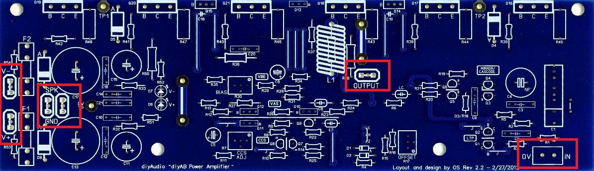

I am building the Honey Badger amp first time out. I've read a lot on this forum, but before I proceed, I would like some basic help on some rudimentary questions about this amp.
I have attached the PCB board design with the interface points on the board. Hope to get some help on the following.
1. Do I connect the +- VDC rails to V- and V+ accordingly?
For example, -45v - 0v - +45v, hence I connect the -45v to V- and +45 to V+?
2. GND is where I connect the 0v center tap from transformer?
3. From the schematics, I realize there is 2 ground types, GND1 and GND2. Are they the same?
4. Do I connect the to speakers in the following way: Output -> speaker + and SPK GND -> speaker -?
5. For audio in, i just connect the + and - from a preamplifier audio output to IN --> + audio signal, 0V --> - audio signal?
6. Should the -ve audio signal be grounded with SPK GND?
7. I plan to operate this amp with 4ohm and 8 ohm speakers. What is the best transformer specs to use?
8. Anywhere I can get the PSU rectifying board PCB design in Gerber or Sprint Layout format?
9. What speaker protection board should be used with this amp?
Thanks for all the help. appreciate for your answers in advance.
yes..
yes unless you have a filter bank off board..
yes
yes
yes
no, there is a ground point with the input
at least 300 va
i doubt you can get the gerbers, this a forum commissioned amp...
there is no SOA protection scheme on board....
dc detect and peaker delay can be found in the diyaudio store .. Soft Start & Speaker Turn-On Delay / DC Protector Combo – diyAudio Store
