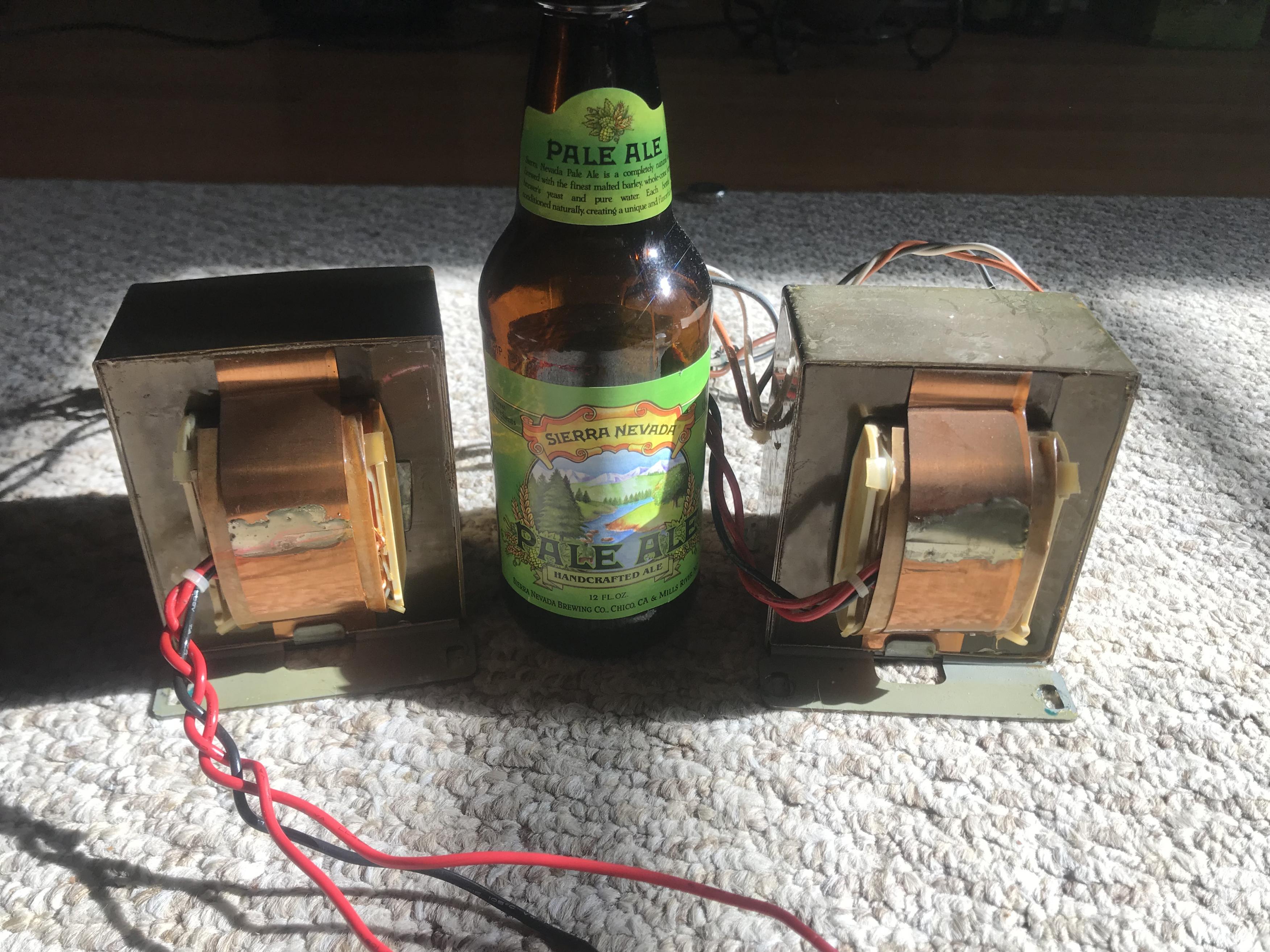

Does the HB work well on +-50V rails? I have these nice transformers from an old 4 channel Adcom power amp that I’ve been looking to put to use but they only put out around 35VAC.

Hi Fsatsil,
If they worked well for an Adcom, they will work well for the Honey Badger. The Adcom was no slouch in the power department and movies are typically played longer and louder than music for the average people.
HB will work at 30V. And be cold running with 3X the SOA.
Consider building a bridged 2 amp setup at 35V rails. Just 2 pair OP per amp.
same wattage .... more wattage at 4R . AND nearly ice cold .
SOA is 2.5X at 35Vfor most ON semi OP devices.
50V rails are nearly 2X soa , your 4R wattage would be more than any
60-70V HB setup. Thermal dissipation also drops like a rock below <50dc.
OS
Thanks guys. The Adcom transformers are around 450VA/35VAC I figure they should be good for around 75WPC or so. They were from a broken gfa5235 I picked up on eBay cheap, I used most of the other parts to repair two old Adcom gfa535s. Repairing those little Adcom amps is kind of a hobby for me.
it could work but VA is too low unless you are just want to listen to soft music 50V is fine is jut the VA too low depending of how you are gonna use it 🙂 check this link of Antek Transformers - 600VA - AnTek Products Corp
I don’t have the actual specs of the Adcom transformers but the amplifier they came from was a four channel amplifier rated at 60wpc into 8ohms and 90wpc into 4ohms. The transformers are pretty stout
Don't let them convince you "will only play soft music".
