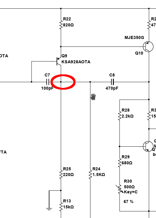

Hi Guys,
I thought that I might post a slightly clearer version of the HB schematic so others can benefit from studying the layout and each of the circuit building blocks.
Maybe some one else can give it a quick check to see if its correct.
I am thinking that I will in the future highlight / circle and name each of these circuit building blocks to help other learn how the circuit works.

I think that Baker clamp is missing?
Best regards!
IMHO: C7 should not be connected to R25 and collector of Q9.
C7 should be connected to C8 and R24 only.
BR, Toni

Hi Stuart
C7 is incorrectly connected according to the original schematic.
Please correct your drawing, so it doesn’t create confusion.
Harry
Thanks again Guy's please let me know if there is anything else.
Maybe a moderator can remove the last PDF file to save confusion like Harry kindly pointed out.
OK OK Big thanks to the Australians - no I meant Austrians!😀
You are correct about the BAV21.
Yes you are both correct D10 should be a BAV21. I just checked my Digikey order from back in 2017 and that's what I ordered. I guess my idea of the schematic was more the layout and correct component identifiers. I would assume that the forum moderator would keep the bill of materials up to date. However I am happy to make any changes as it will all help in the end. I'll update the schematic again when I get a chance.
