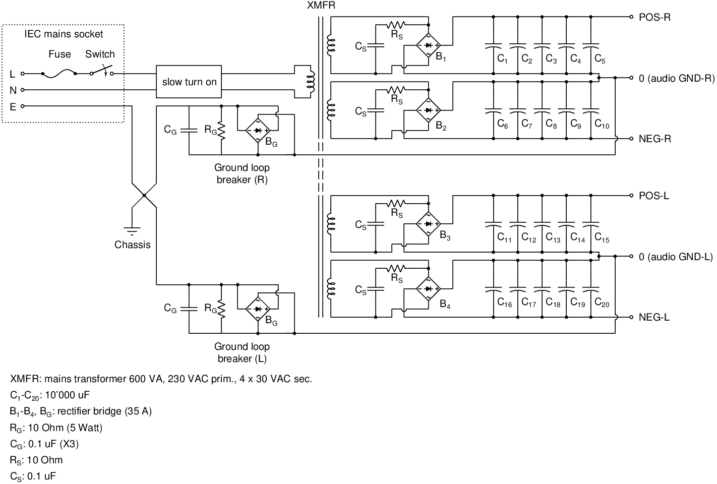

hi, can you help me to make psu? I have 2 toroidals of 37x2 600w and I have capacitors of 47000uf and 15000 uf, 63v how can I make psu? I think that a class AB, clc, crc, nubber, are not important .. or wrong ??View attachment 680196can I use this configuration with the 15000uf capacitors and my 2x37v transformers? or maybe with only 4 x 47000uf channel capacitors? thank you
Yes, you should be fine with using your parts as in my schematic (except that you'll have two separate transformers). The power supply will work without snubbers, but they are useful to suppress the ringing related to the switching of the rectifier diodes.

how do I calculate the correct values x snubbers?Yes, you should be fine with using your parts as in my schematic (except that you'll have two separate transformers). The power supply will work without snubbers, but they are useful to suppress the ringing related to the switching of the rectifier diodes.
Neno70,
You have 4x30 secondaries on each transformer. Are you going to use them as 4x30 or 2x60?
With 4x30V AC you will get around 4x43v DC, you know that.
You are correct in using RC snubbers on the diode bridges, instead of jut C snubbers, as most people use. The ringness damping should work better if you have the resistor. But I could never find out a way to calculate the values.

You don't. It's empirical, depends on the characteristics of your transformers.how do I calculate the correct values x snubbers?

You can use a Quasimodo to pick the right snubber capacitor for your transformer.

No, you don't pick the snubber parts values by ear; "empirical" is not the same as "by ear". The Quasimodo is the best tool. I didn't have one, but I have a scope. So I used that to see what the ringing looks like on the rectifiers.
