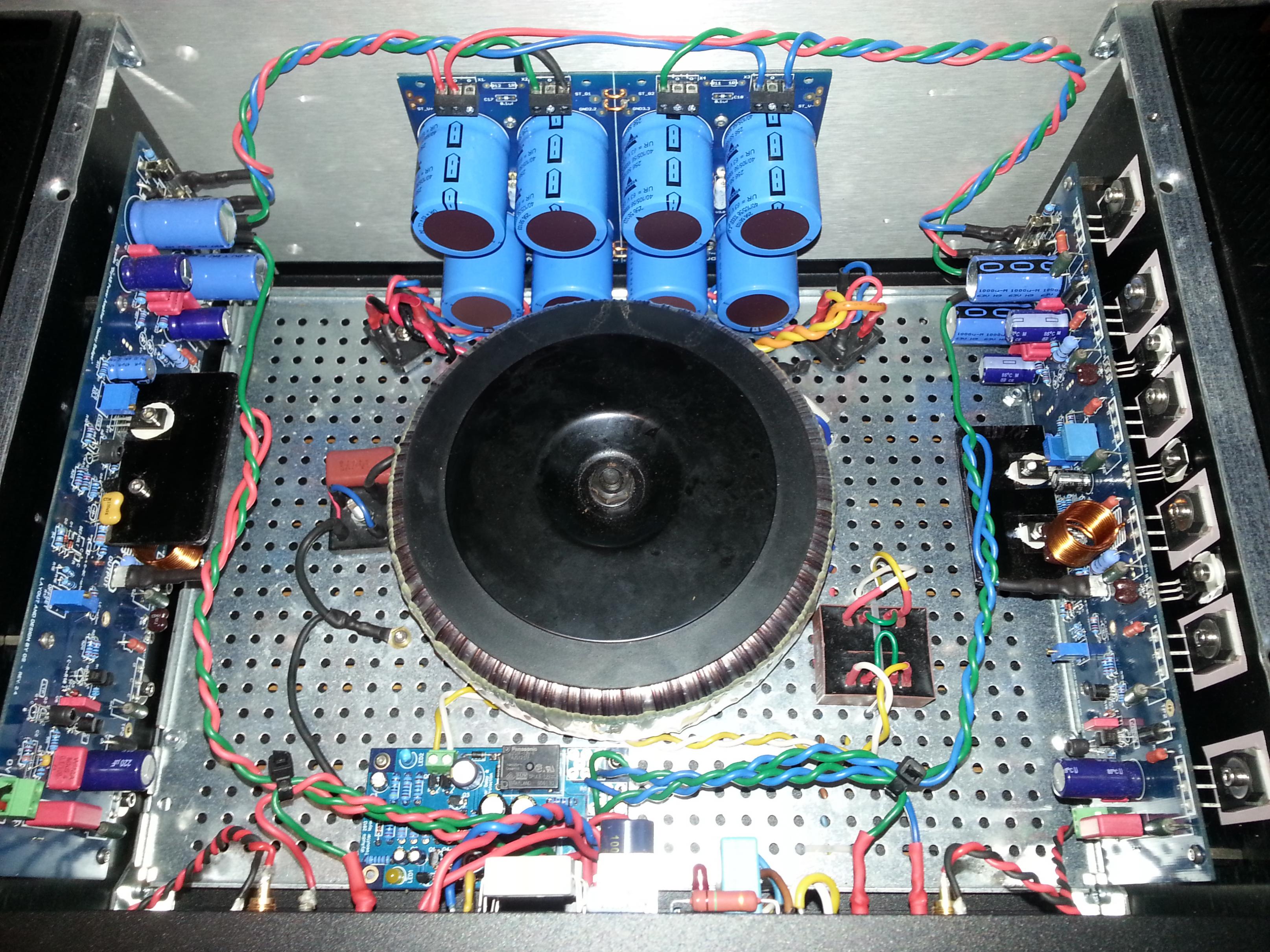

Heres mine.
Use it every day and am still loving how it sounds infact the Alpeh J i built has barely seen a spot on the rack since building the badger.
Big thanks to the guys who made the badger happen.

Very nice. Did you design the psu cap pcb's yourself?
Yes.
How come you went a 600va 230v toroidal with 30v secondarys? I was looking at the 800va with 45vac secondarys.
I had a box full of many electrolytics that wanted to go into the power supply, but they were not rated for the 60 VDC or so. Also, I don't need the full power output that is possible with the Honey Badger, so I decided to go for a lower rail voltage.

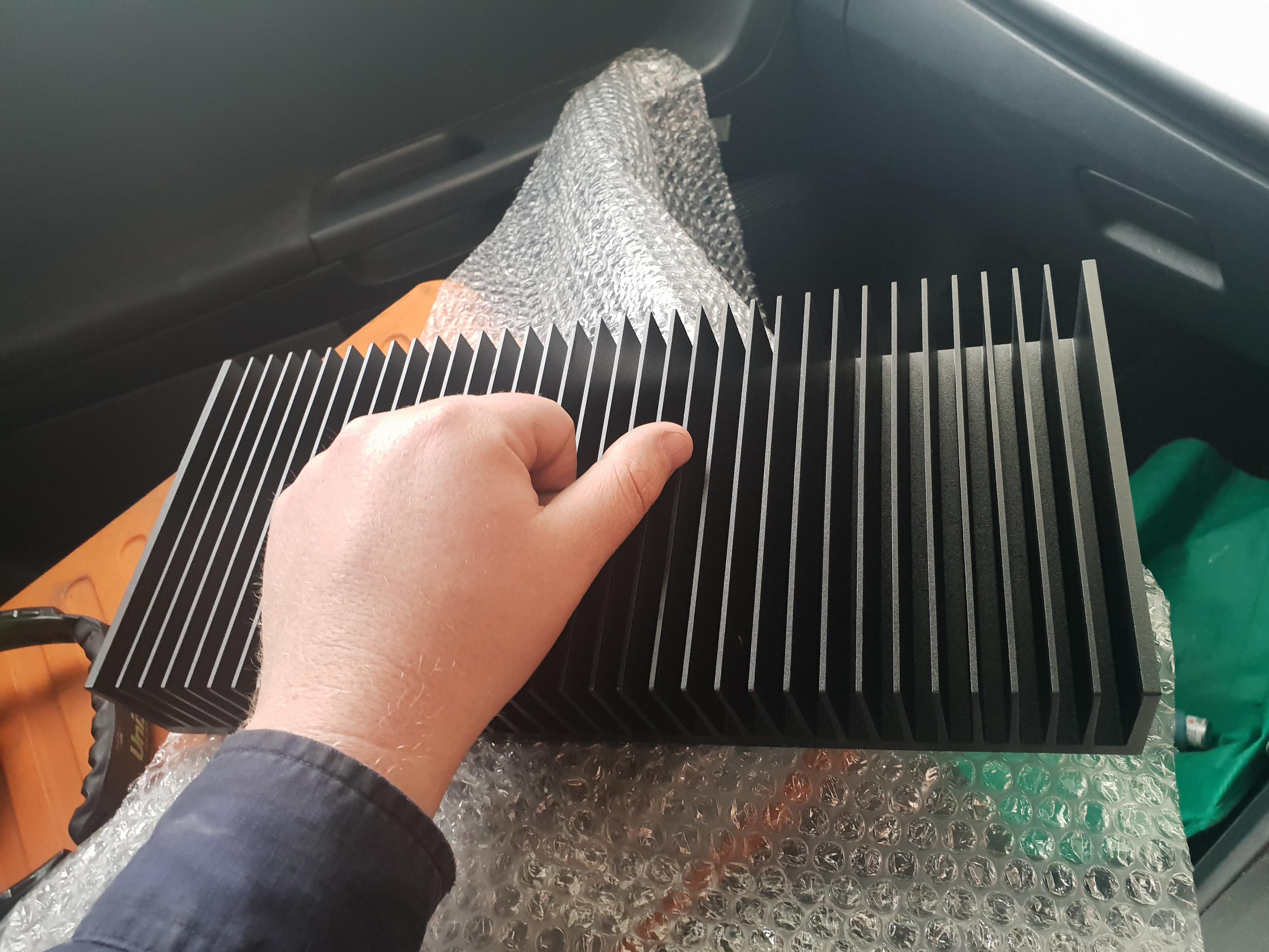

What chassis are you using? What Toroidal did you use? Thanks for sharing mate!

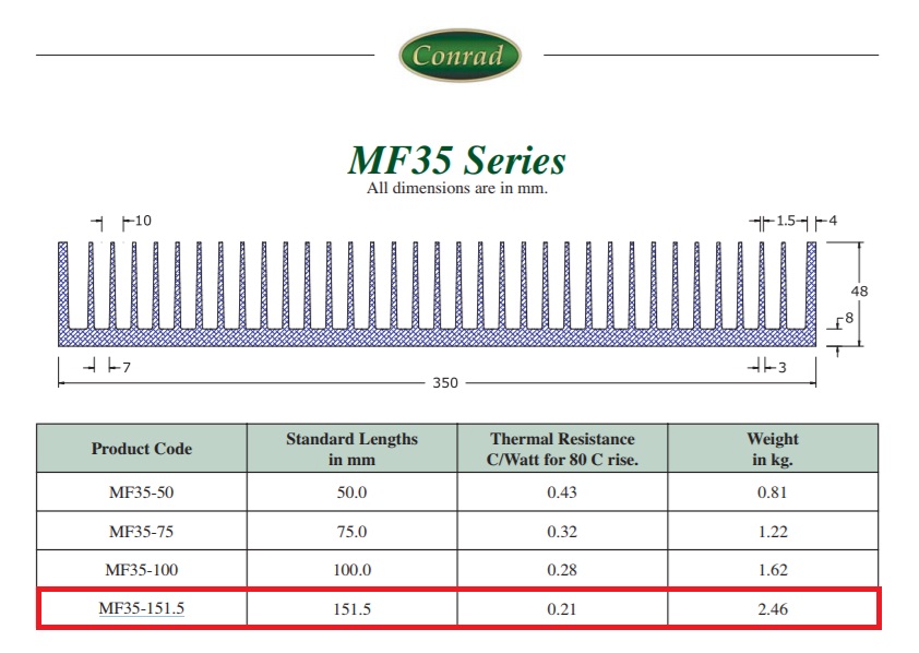

Being in Australia I'm a little limited to Amplifier Enclosures and unfortunately I cant afford to import one from DIYAudioStore. However I have found a local company with Heatsinks 350mm Long x 151.5mm High x 48mm Fin thickness with a thermal resistance C/Watt 80c of 0.21. (see attached picture).
Going this way I will have to go full custom and do a lot of drilling and tapping which doesn't bother me other than time wasted also I will have to chase up more aluminium plate to finish the front, back and bottom and maybe put a clear poly carbonate cover on top with slotted vents. only concern is, will I have enough internal height of 151.mm which is shorter than 4ru (178mm). however I can go as wide as I want for the width. Also with extra width I could mount the boards horizontal and not vertical and adjacent to the heat sinks.
I've had a decent read through the HB threads and too me it looks like I have to go with two 230v 40v-0-40v Toroidals if I want to be able to use 4 Ohm speakers and not just 8 ohm speakers, is this right?

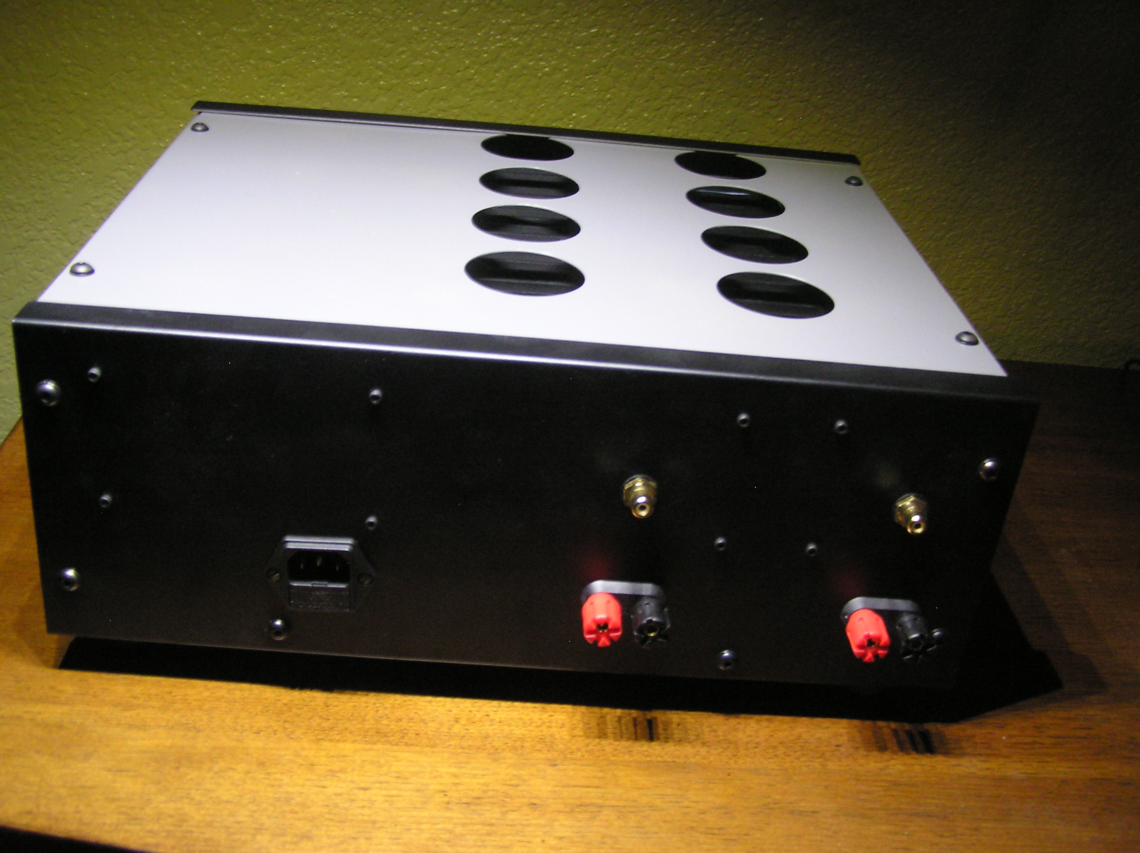

I recently finished two three-channel honey badger amplifiers, and I've finally started work on the active speakers I plan to use with them 🙂
The voltage of the transformer you have is less important than the power rating (normally measured in VA). 4 ohm speakers need twice the power at the same voltage as 8 ohm speakers, so you'll need to rate the transformer accordingly. Rod Elliott has some great reference material. I'd start with Power Supply for Power Amplifiers and Linear Power Supply Design for some guidance.
I used +/- 35 AC volt secondaries on my HB amplifiers, for a total of about 50V output. +/-40V AC gets you about 56V DC rail output. If you want 150W output, you'd likely want either two 300VA transformers or one 600VA based on a conservative power rating factor of 2x on your transformer. You'd need to double each of those ratings to go to 300W into 4 ohms, but you'll actually want to do some calculations around the capabilities of the output transistors you're planning to use. A lot won't run 300W safely and continuously - my choice certainly won't. I also used a somewhat undersized transformer in my amps with three sets of rectifiers and capacitors based on my own estimates of what I'd actually need and headroom vs continuous power requirements.

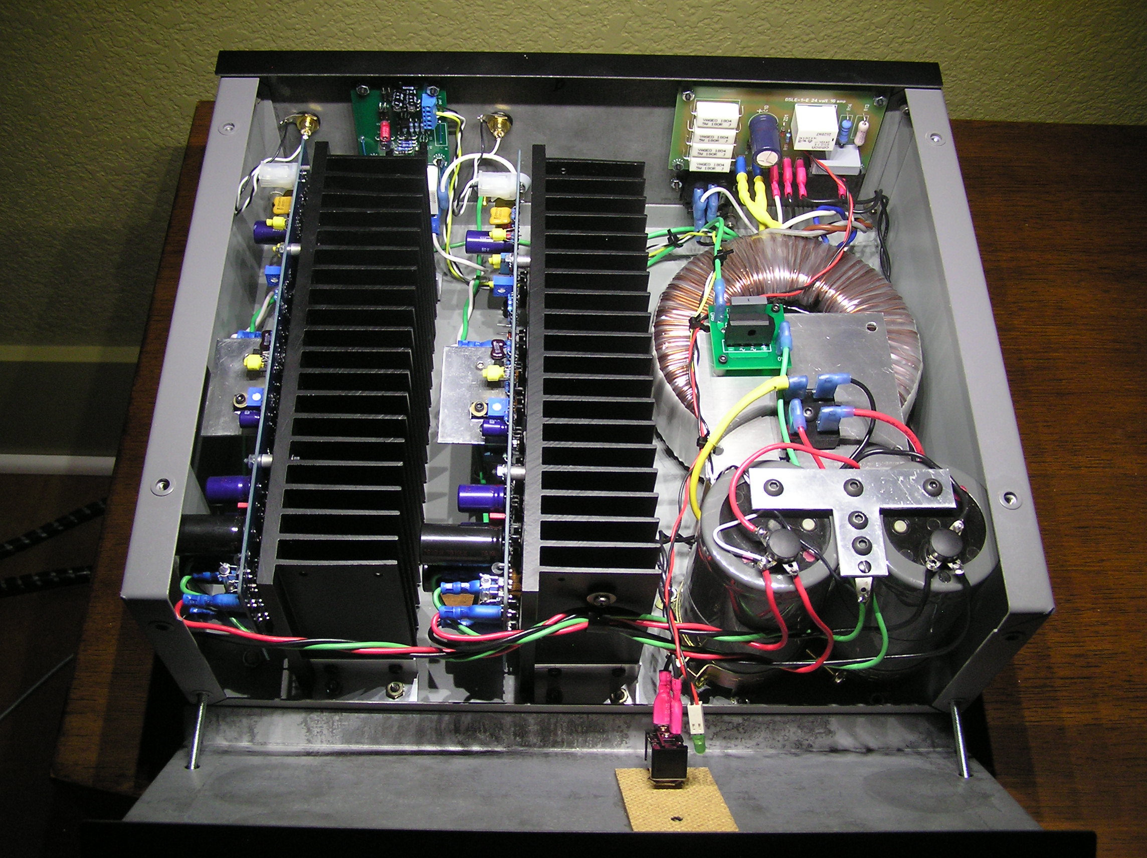

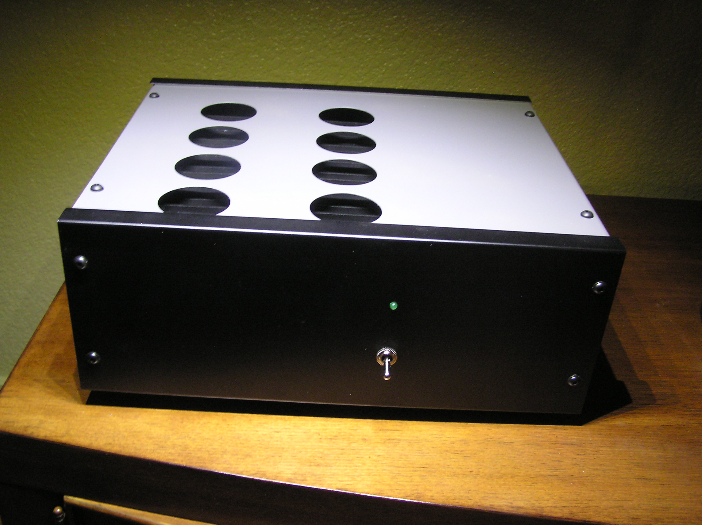

This orientation works out fine, and I'm just finishing up the 4th amp built like this and plan to use them with my Linkwitz LX521 speakers. I wanted to use heatsinks and caps that I had in my parts collection and this layout made it easier for me to build the chassis. There are 12 2" holes under the heatsinks that you can't see to help with ventilation.
The big caps are NOS 47,000uF @80V, and I believe they are Panasonic brand. The only reasons that I chose the caps are that I already had them, and they are a good size and voltage for the Badger amp.
I did the same. Bug.mistake. My old electrolytics were dry, overheated, and blew up. I hated myself for not getting good new parts right from the beginning.
mbremmwa, I agree, and that could be a problem with using older caps. Before I used any of these caps, I "formed" them using my 60vdc bench supply with a 15K 10 watt resistor in series with the positive line. Since I didn't notice any problems and they appeared to be working as they should, I decided to use them. No problems so far.
Re-forming old electrolytics, even NOS ones that might have been sitting in the stashes for a couple of years, prior to their use is generally considered a good idea. We also have to measure their capacity after the procedure, though, to verify their properties.
