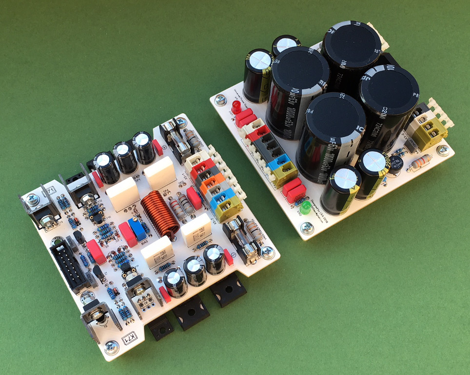

Nice work. I really like those coloured screw terminals. Do you have a part number for those and were did you get them?

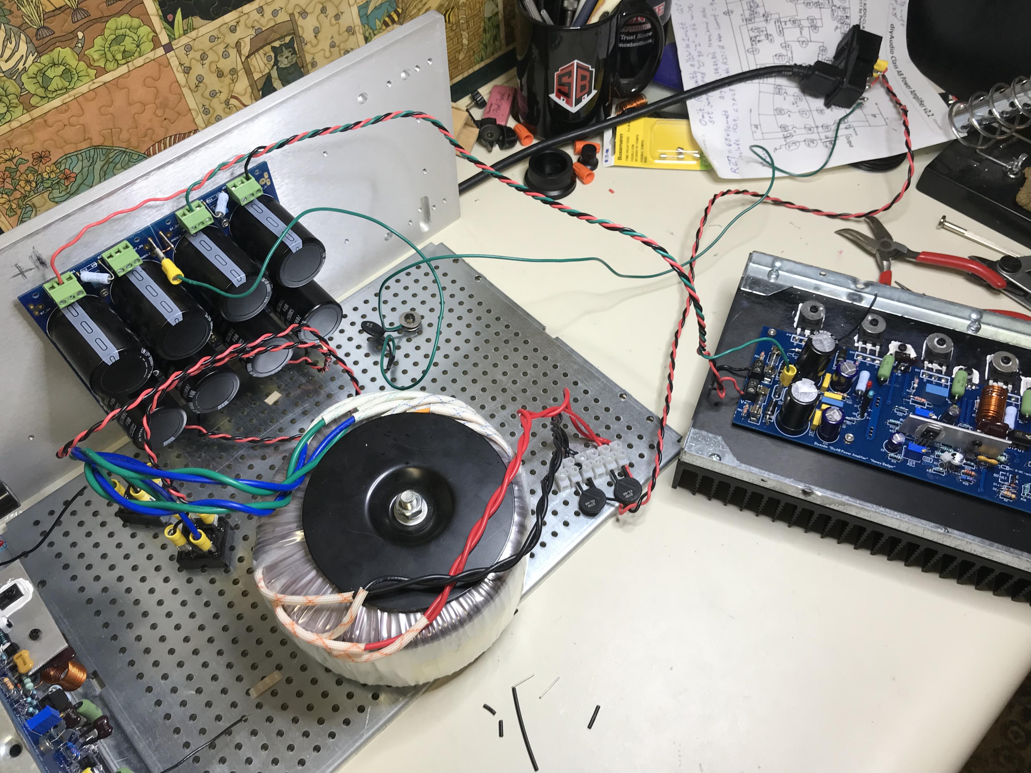

Here is pic of one side. Wires are long for ease of testing
Is the thermistor still considered safe as a ground loop breaker? Nelson Pass used used a thermistor like on your photo, but I believe the typical diode bridge solution is preferred.
Not many people that have shared their finished HB Amplifier. Would love to see some pictures lads 😀😛
Here's mine: Honey Badger.
Very nice. Did you design the psu cap pcb's yourself?
How come you went a 600va 230v toroidal with 30v secondarys? I was looking at the 800va with 45vac secondarys.
Thanks for sharing!
