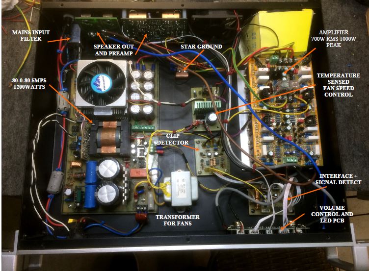

Thanks for the reply Chris, In fact I built myself a half bridge smps which can deliver 1200w. It is unregulated and does not need a lot of filtering in the output as far as I have seen on the scope my ripple current at full load (8A)is 4v peak to peak, a very small percentage compared to an Iron cored trafo. The noise floor without load is 20mV p/p The supply is 80-0-80. (160v)
The smps is powering my 1000w amplifier and the output voltage sags very little (77v) while it is playing on high volume. Harmonics are very low not to say un-noticeable these are very high up over the audible frequencies (over 60Khz)

Hi Chris, No apparent noise on the output, I tested with the volume turned full on but no signal to the input and the speakers are dead quiet with my ear 10cm away from the woofer. no hum no hiss nothing that I can hear.
I still need to change the clip detector as the one used is indicating prematurely, I built another one from Elliot sounds which I found the schematic on the internet I am to try it out tomorrow morning. I hope it works as it should.
PS the box used for the amplifier is a commercial one which this had its power supply and amp burnt and was not worth fixing up, I utilized the existing preamp, speaker outlet and the front panel and interfaced everything else to fit with my supply and amplifier.
The smps build can be found on diy smps which I have posted the full pdf file for it
Regards Silvio

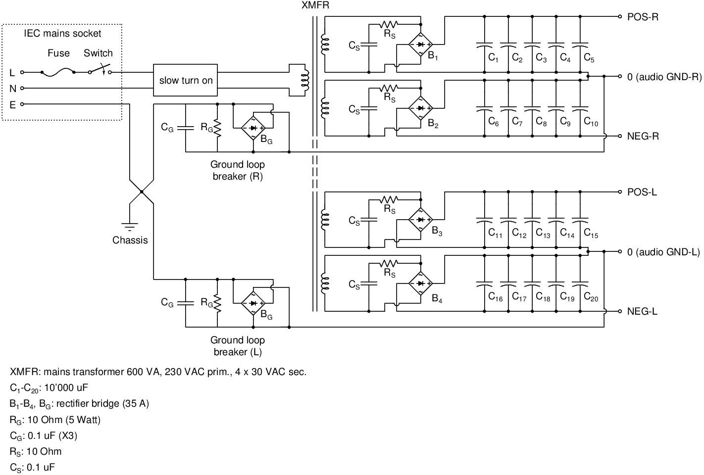

PSU help ?
hi, can you help me to make psu? I have 2 toroidals of 37x2 600w and I have capacitors of 47000uf and 15000 uf, 63v how can I make psu? I think that a class AB, clc, crc, nubber, are not important .. or wrong ??hb_psu.pngcan I use this configuration with the 15000uf capacitors and my 2x37v transformers? or maybe with only 4 x 47000uf channel capacitors? thank you
