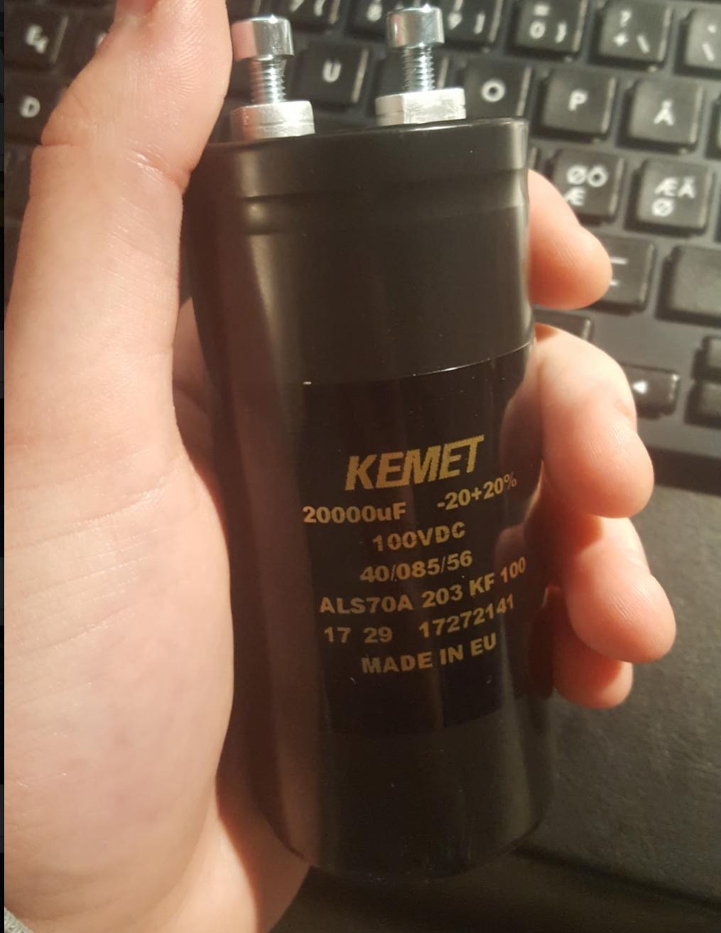

Very good caps you are using Ejje - expensive as well. My most expensive are 8 22mF/63V RIFAs. Their ESR (my measurement) is about 60mOhm. That's not less than ESR of all my other caps - 80V Panasonic and Nichicon Fine Gold. RIFA's are big and heavy and I expected lower ESR. Bought them long time ago from the UK.

Yeah, they where not cheap but I'd like to think that they will last me a very long time 🙂 Maybe my choice of transformers wasn't the best, hehe.
For now I'm very happy with how it performs.
Here is a better pic at one of the caps..
