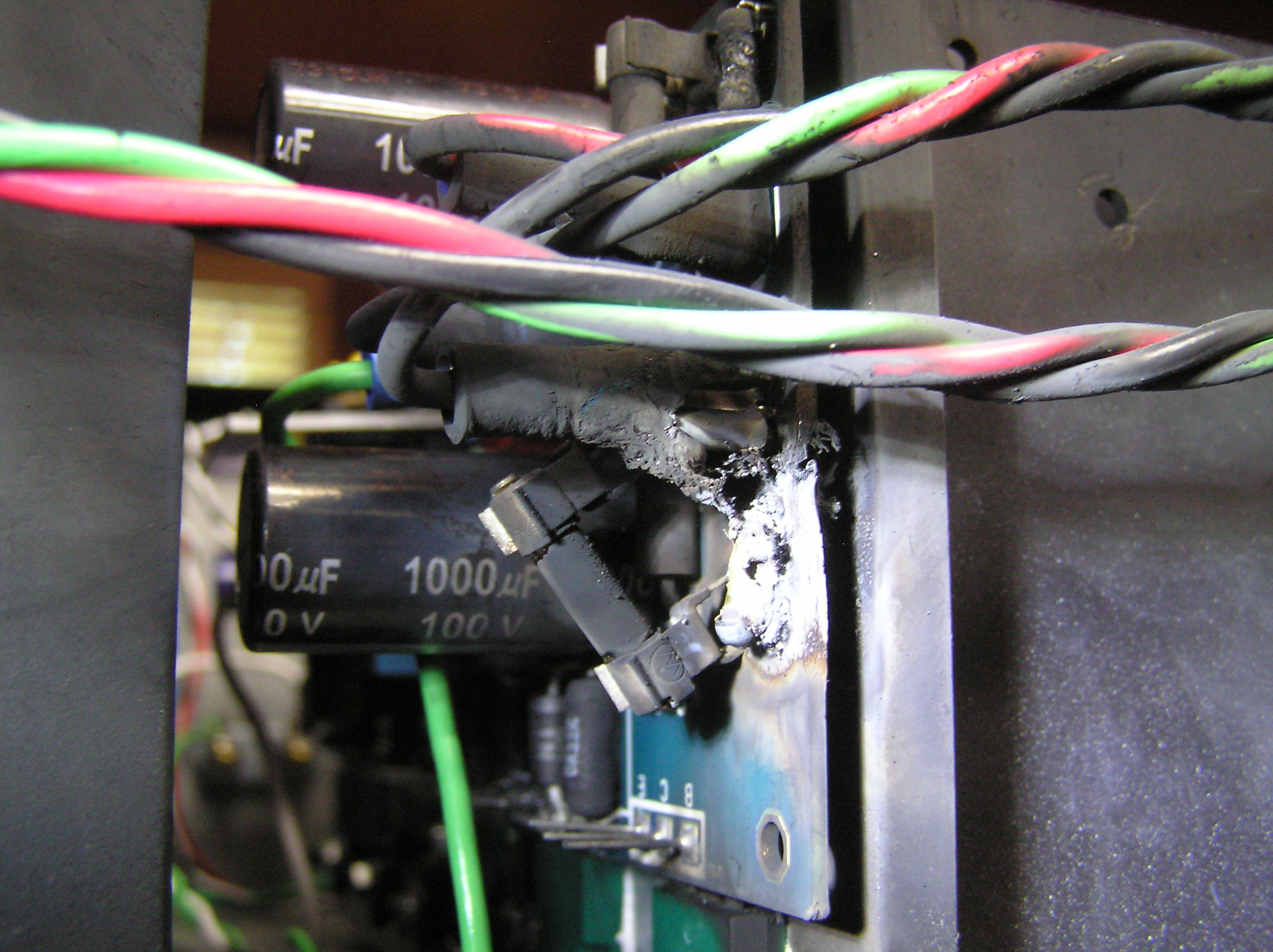

Badger catches on fire!

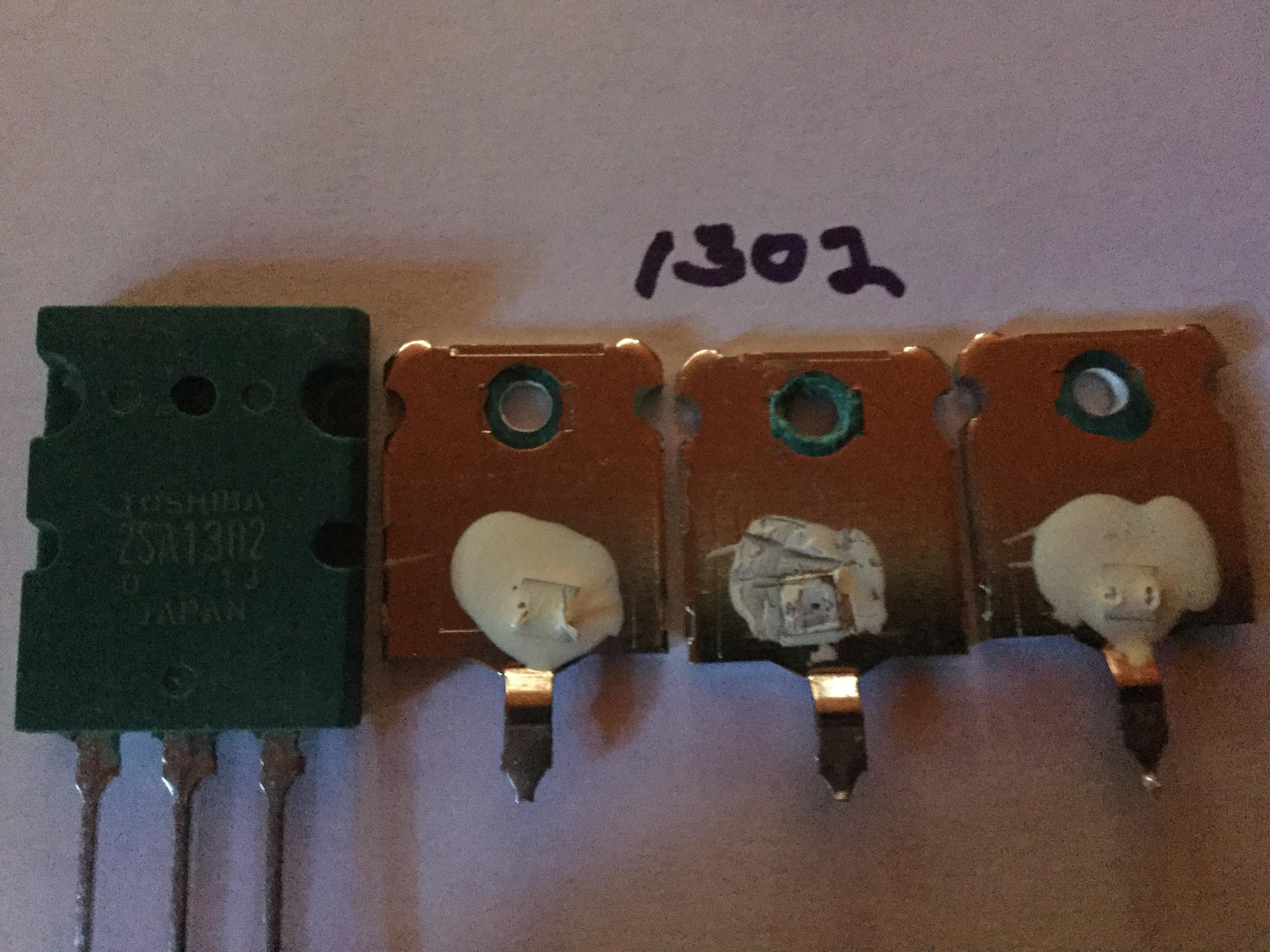

One channel caught on fire. The power supply is +/-62vdc and the output transistors are Toshiba 2SA1302/2SC3281 purchased about 15 yrs. ago from a US distributor. After some research I believe the 1302's are fake, and failed. What do you other builders think?
even with genuine parts, the amp can still go up in flames if there is a mistake in the biasing....so the use of the series lamp tester is strongly suggested to avoid the magic smoke from coming out...when doing the preliminary testing and idle current boas setting up..
FWIW, i use ON semi parts, the mjl1302 and mjl3281
Hi Tony,
I've built 8 channels of the Badger, 4 using the Toshiba 1302/3281 (+/-62v supply) and 4 with the NJW0320/0281 (+/-42v supply). For initial power up I used my +/- 30v bench supply and did the initial measurements and adjustments as detailed in the build guide. The all powered up fine without a hitch. Then I would hook them up to the amp power supply and do the final adjustments, and let each channel run for at least a half hour and monitor all the test points. They all worked fine except one channel with the Toshiba transistors caught fire on the bench shortly after connecting to the +/-62v amp supply. I replaced that channel with a new pcb and parts using the toshiba transistors again and it powered up just fine. The channel in the picture blew up having been in my system and playing music for about 8 days. I could not find any errors in the build so I started suspecting the transistors.

There are all kinds of reasons why an output stage can fail. Fake parts are one way. Bias or defects in mounting the part also kill lots of outputs a year. These days I would use On-Semi parts. It's just not worth the risk of having fake parts.
The NJW0320 and NJW0281 parts were fantastic parts. Same for the ones without the bias diodes.
-Chris

this honey badger design do not have a SOA protection circuit built into it, the designer did not like it.....so anything like a momentary short in the output to speakers can ruin it...
we have a 10 pair version with such SOA protection...
the Toshibas are long been discontinued so fake parts are most likely to happen...
no so much for ON semi devices...
