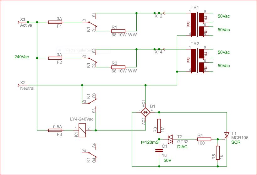

Hi Folks,
I am building a Honey Badger and just now starting on the power supply and soft start. There are issues, in my mind at least, with Jojo's design in the diyAStore in that there are electronic components always in the AC power circuit with associated dissipation and subsequent uncertainty of outcome should there be a failure.
My solution has been to use a 240Vac relay with a spare contact pole to permanently latch the relay ON after the timing circuit delay. For my Badger with 2 transformers I have an LY4 with 2 sets of contacts controlling the transformer softstart resistors and a 3rd contact to short the timing circuit to keep the relay powered by shorting the timing circuit.
What voltage does the Diac fire at?
How long does the Diac plus Triac take to short across the bridge rectifier?
How high does the voltage across the 1uF 50V capacitor rise before the Triac shorts the supply?
Does this proposal fit within the Forum's Rule about direct to mains circuit discussion?
Diacs are imprecise, nominal trigger voltage is 28V, +/- 4V.
From Trigger to SCR fully on < 5uS
Capacitor voltage = Vdiac-trigger + Vscr-gate = (28+0.7) nominal
Yes, this is about the Forum's own direct to mains softstart circuit.
