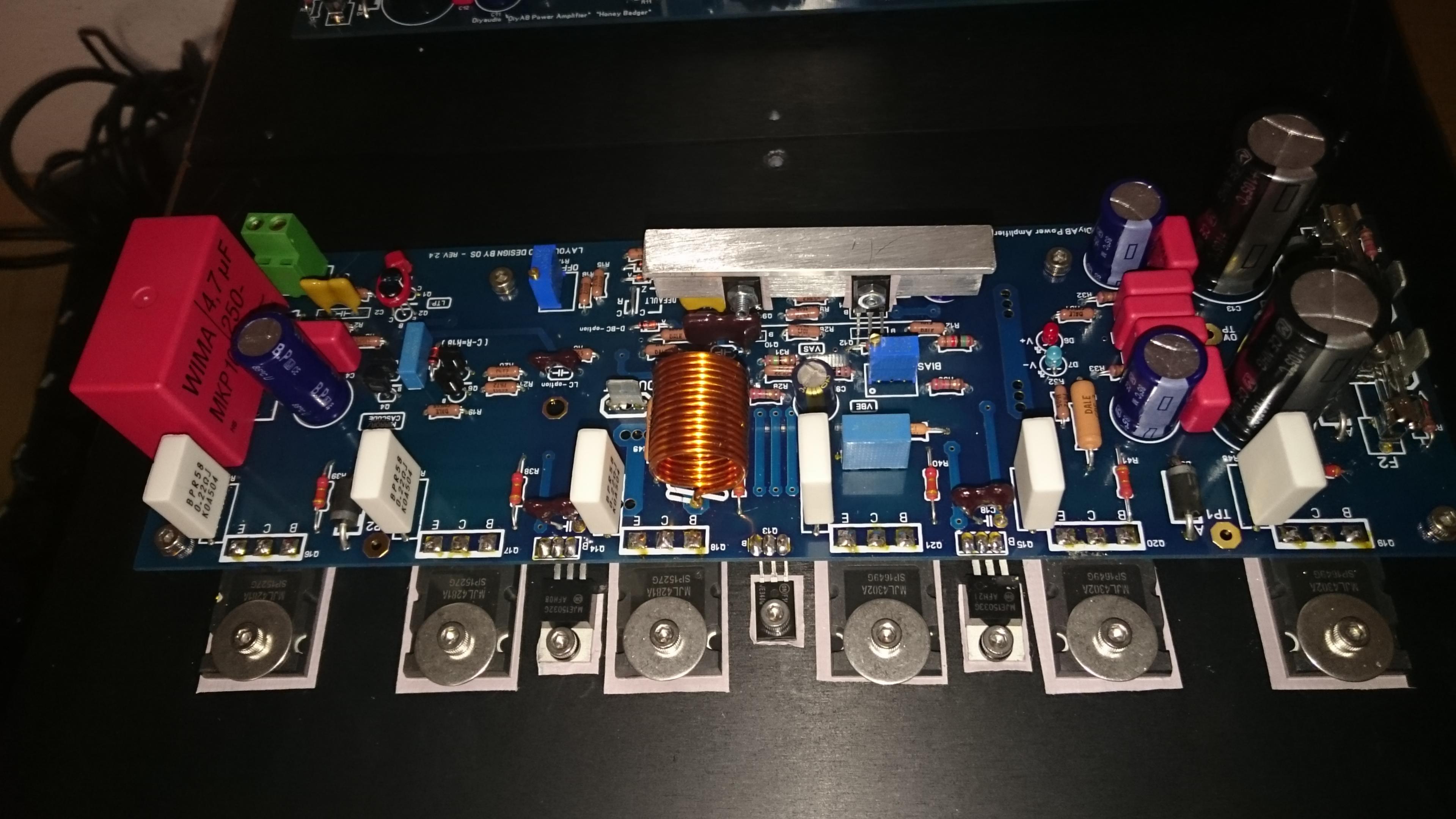

Thermal runaway
Didn't help with the diode transistor. That could help in case of a too high temp coefficient if the diode transistor is not mounted on the heat sink. But with both mounted on HS I have also to adjust the resistor values to finally end up in the same coefficient.
A solution I found in the book from Douglas Self "audio power amplifier design": to add a voltage source in series to R29/R30. But I hesitate to try it because I would rather like to understand why I have this problem at all where it seems to work for others.
I rather thinking of trying other (better) isolators for the power BJTs and Q13 since I am not too far away from thermal stability. I have also tried to mount Q13 directly on one of the power BJT, to no avail. Of course using thermal grease.
Also I tried to use an 2SC3503 instead of MJE340 but it gives same results.
Here my measured temp/Voltage (emitter-emitter Q18-Q21) values:
27°C/25mV
31.6°C/27.4mV
36°C/32.4mV
40°C/37mV
53°C/54mV
I am using silicone isolators, maybe I should try mica?!

Sure
Actual design with Q13 between Q14/Q15:
You grouped Q13, Q14 and Q15 together. The diyAudio Honey Badger boards have them separated, with Q13 between two power devices (see photo). Could this lead to different thermal behaviour?
Maybe try a "thermal bus bar" as shown in the HB build guide (you can download the PDF from the diyaudio store). This would easily allow you to 'skip' the drivers in your build.You got it, Matthias! In Zymorg's construcion the Vbe transistor senses the temperature of the drivers, which almost certainly are much colder than the power devices.

My 2SC3503 is not insulated, the collector is connected to the housing. I don't think insufficient hfe plays a role here: R28=1.63V; R29=0.48V; R27=0.584V --> hfe~214
(R27=82; R28=2.2k; R29=680). 0.03mA Ib shouldn't make a significant difference with 0,74mA I(R28).
I also cannot imagine that a thermal bus bar helps because I already tried to mount Q13 directly onto one of the power devices - the result was worse than mounted between Q14/Q15. Seemingly the plastic housing has a higher thermal resistance than Power device->insulator->heat sink-> insulator -> Q13.
With 0.05mm Glimmer instead of silicone I could improve the compensation a little but still insufficient, see diagram:
Tomorrow I will try to mount Q13 very close to the power devices.

I've made this argument a few times. I think the sensor on top of the output device was developed when the output stage used To3 metal can devices............... I already tried to mount Q13 directly onto one of the power devices - the result was worse than mounted between Q14/Q15. Seemingly the plastic housing has a higher thermal resistance than Power device->insulator->heat sink-> insulator -> Q13...............
The plastic devices have too much insulation in my view.
I have suggested that a sot23 glued to the middle lead out of the output device gets closer to measuring the Tj and thus a better tempco for the Vbe multiplier.
Doug Self shows TO-126 packages mounted on the case of the plastic TO-3 and similar cases. Depending on the design of the output stage, the bias sense transistor should be mounted to the drivers.
A SOT23 stuck to the collector lead of any part would be difficult to attach without shorts to the terminals. If it releases under operation and something touches the collector lead, you could be picking up the pieces for a while. You're further ahead to use the Thermal Trak devices On Semi came out with.
Try to get insulated version, if possible! They are better.
214 is not bad, but higher is better. My KSC2690s has hfe over 300, and they give better regulation comparing to the 3503, in my amplifier.
Try to put the Vbe transistors above the output devices. The warm air rising up, so the top of the heatsink has higher temperature.
Sajti
I don't think so. As there's no convection within a solid body and the convecting air never gets as warm as, not to say warmer than the heat sink's surface, most supposedly the highest temperature is in the mounting area of the power devices.
Haven't measured it, though.
Best regards!
To me it sounds reasonable to put Q13 above the power devices. Cold air is comming from the bottom, heating up and air temp is rising as it goes upwards. Perhaps not a big difference but in case of doubt I would put it above the power devices, but very close to them.
A copper bar on which the power devices are mounted and this mounted again on the aluminium heat sink could also reduce delta temp.
However, I am still wondering how it is possible that others don't seem to have issues here. If I remember correctly, ostripper stated that he had even an overcompensated bias (something I encountered with same bias spreader circuit with another amp I built).

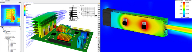

Try to do some measurement! It's better to mount above than side by side. But it must close of course.
The convecting air is not as warm as the heatsink, but it's not cooling donw the heatsink as much as where it's cold. Check out the right side of the picture attached!
This is mesurement of the heatsink with left to right forced cooling. The temperature is significant higher at the output of the air.
Sajti
and that is why you would mount the devices in an asymetrical arrangement to try to equalise the interface temperature of the devices.
We do the same for passive sinks. Move the lower device towards the cold/lower end and give the upper device more heatsink to work with in the warmed air.
