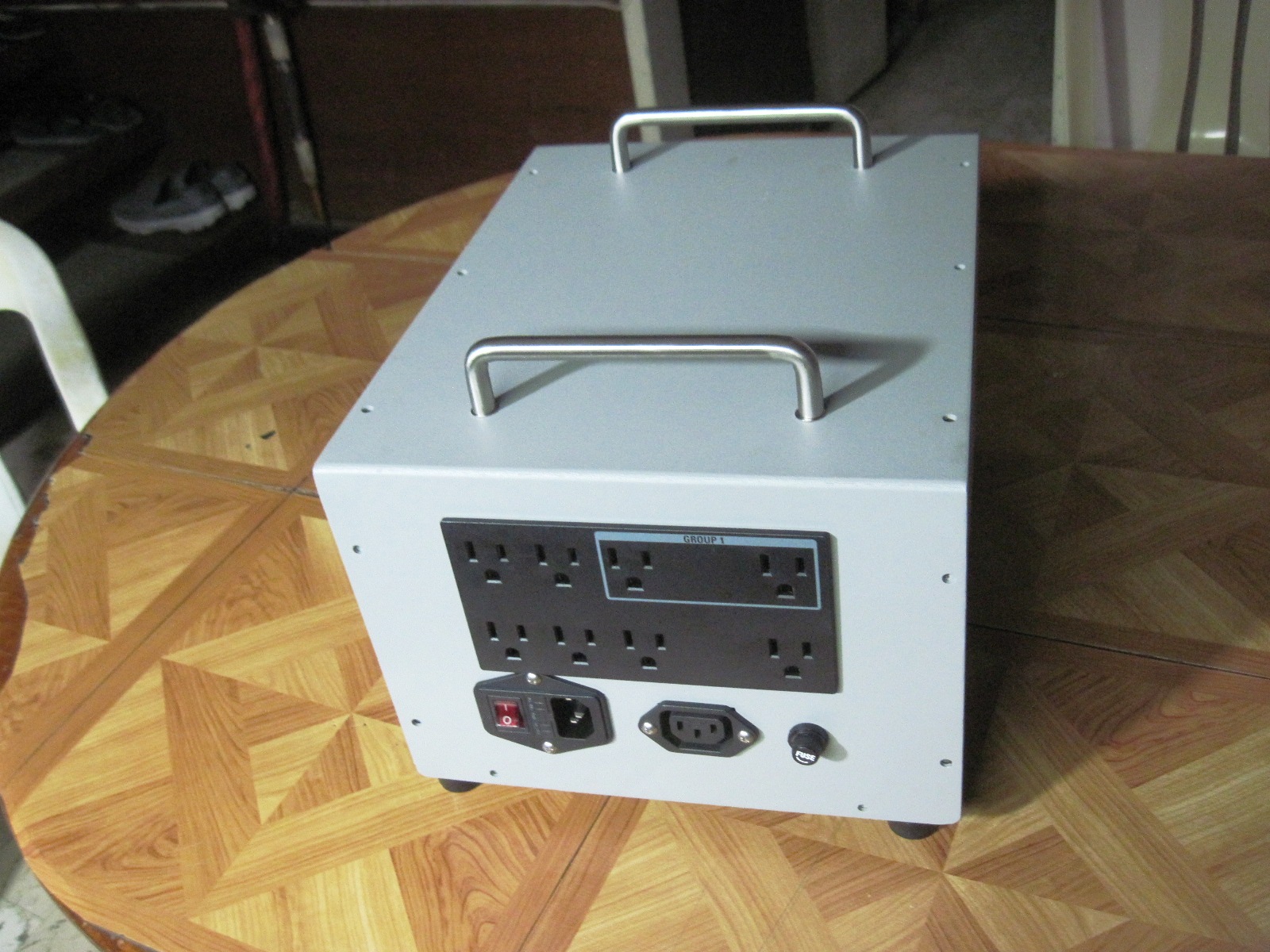

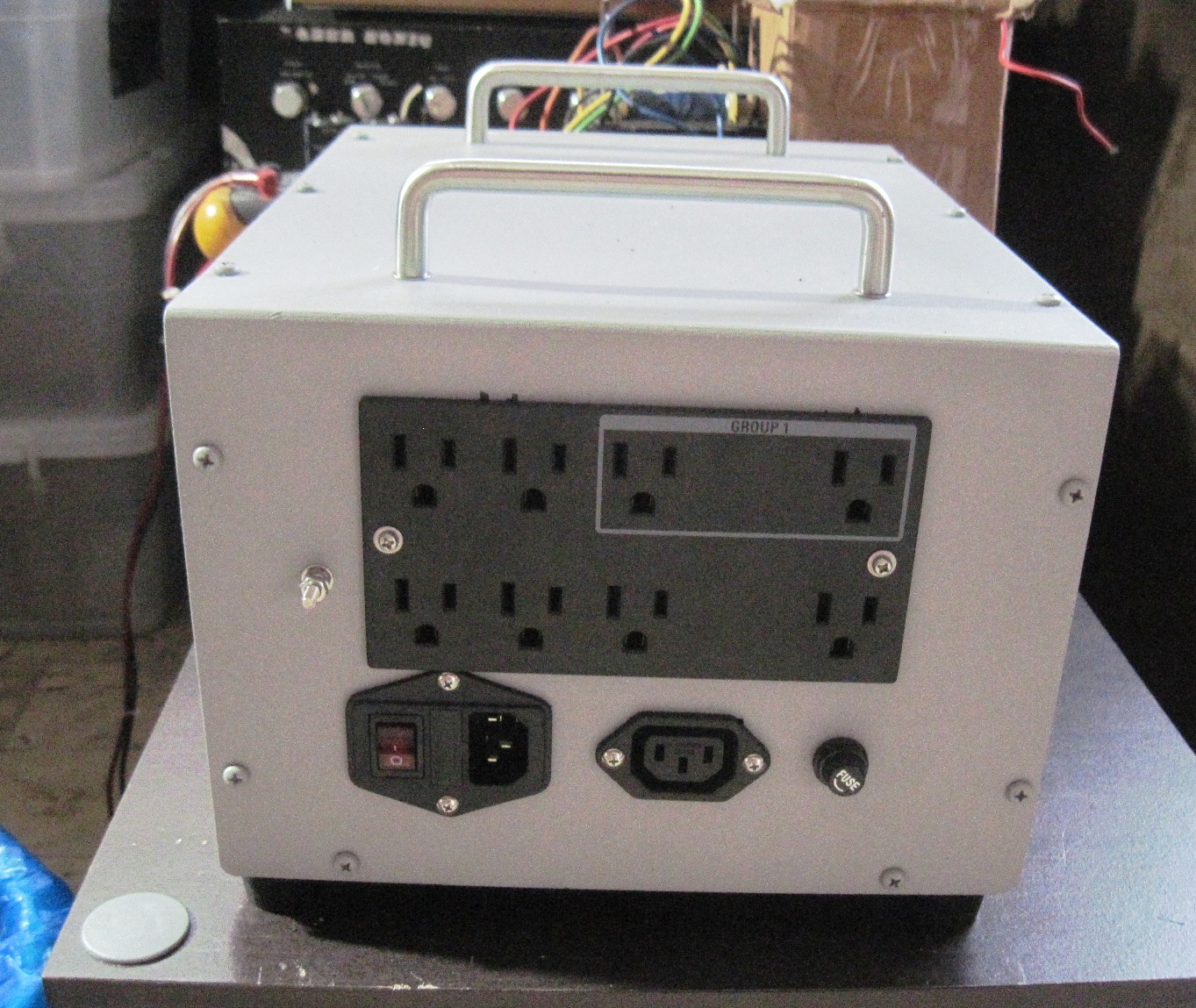

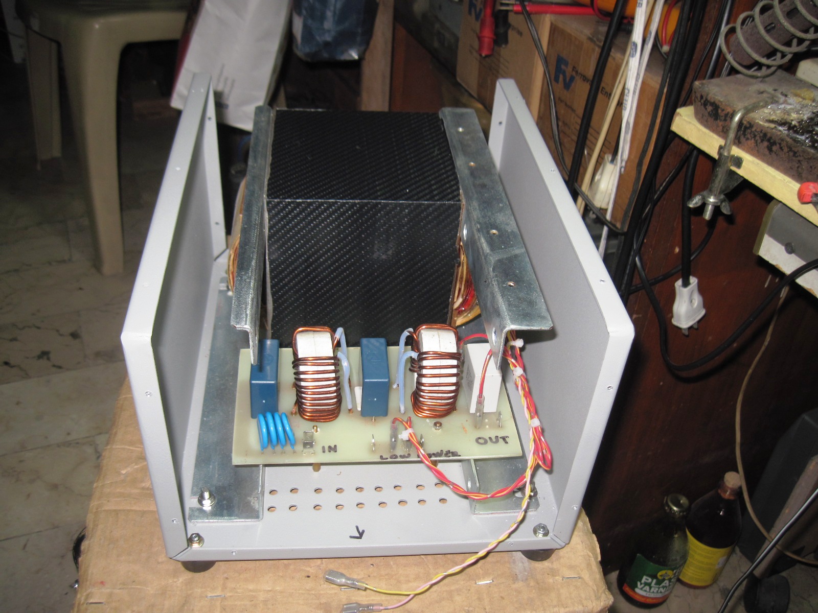

i made my own 1500va isolation traffo.....

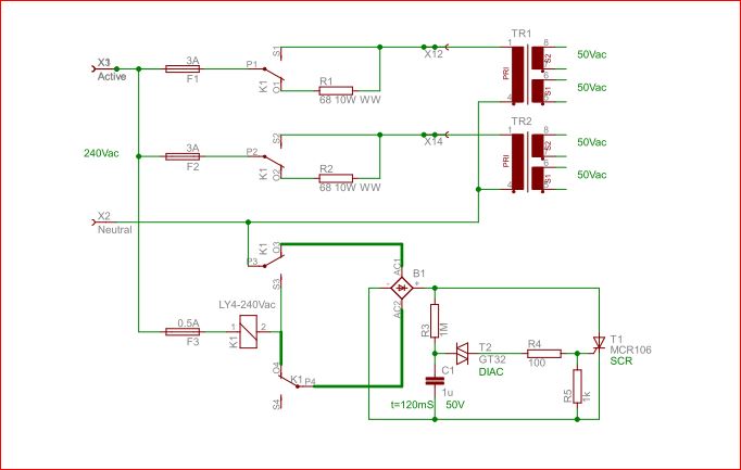

Circuit in post 2406 is a clever circuit ..but can get better with this modification .. this way ... even after a quick power failure the timer is reset ..
Thanks audiofan but it is not necessary to add a discharge path for the timing capacitor as you propose. Let me explain...
1/ When power is applied the timing cap is charged through the relay coil.
2/ When the charge on the cap reaches the Diac breakover voltage it conducts in avalanche mode (negative resistance) through the SCR gate and fully discharges the cap (at least down to 2 diode drops).
3/ The gate current triggers the SCR on and it conducts with only a single diode drop until the relay turns on. There is now no voltage across the SCR to re-charge the timing cap.
4/ Relay contacts P3 latch the relay ON until power is removed.
To further improve safety it is possible to use the relay contacts P3 and P4 to completely isolate the timing circuit and leave it floating. See the attached update....changes in bold.
John

Johno, i tried your circuit in the 80's but was unhappy with the result,
the power traffo had mechanical buzz, i hope you have better luck with yours...😉
that is why i am back to plain jane resistor cum relay as mentioned
