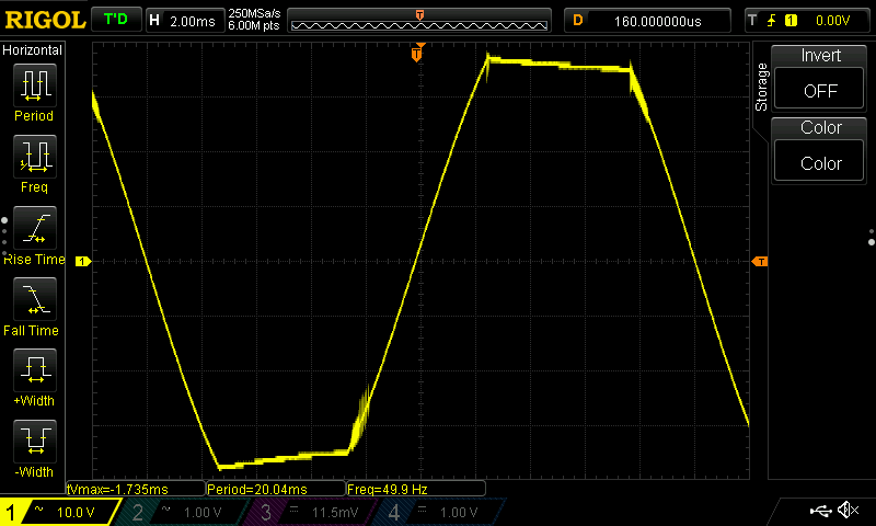

I just tested the clipping performance of my Honey Badger (just fired it up for the first time yesterday, with +/- 40 VDC rails). I have the Baker Clamp diode (BAV21) installed, but I do get some high frequency issues at 50 Hz and below. The glitches go away at higher frequencies (I tested at 500 Hz and above). Is this expected / normal behaviour?
