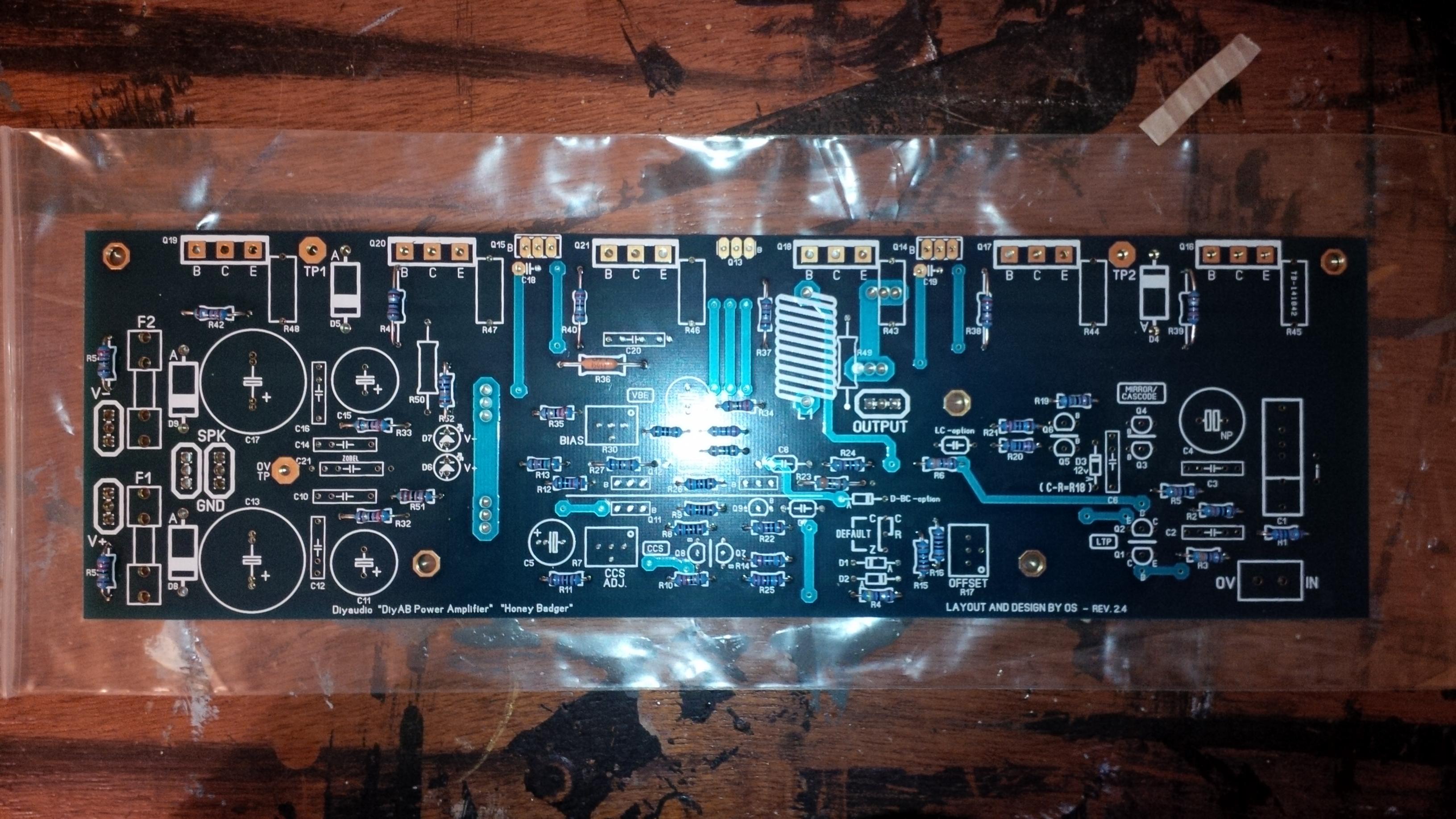

Don't worry, I'm far too cheap to risk my OPS 😛 (it was 120 bucks CAN for the dozen 😱 )
I have been looking into the 21s century design, and briefly discussed it with another member. It's pretty outstanding stuff! Once I finish my badger, the 21st design looks like a great investment in protection.
This is all a relatively new hobby to me, so I have to take it one step at a time!

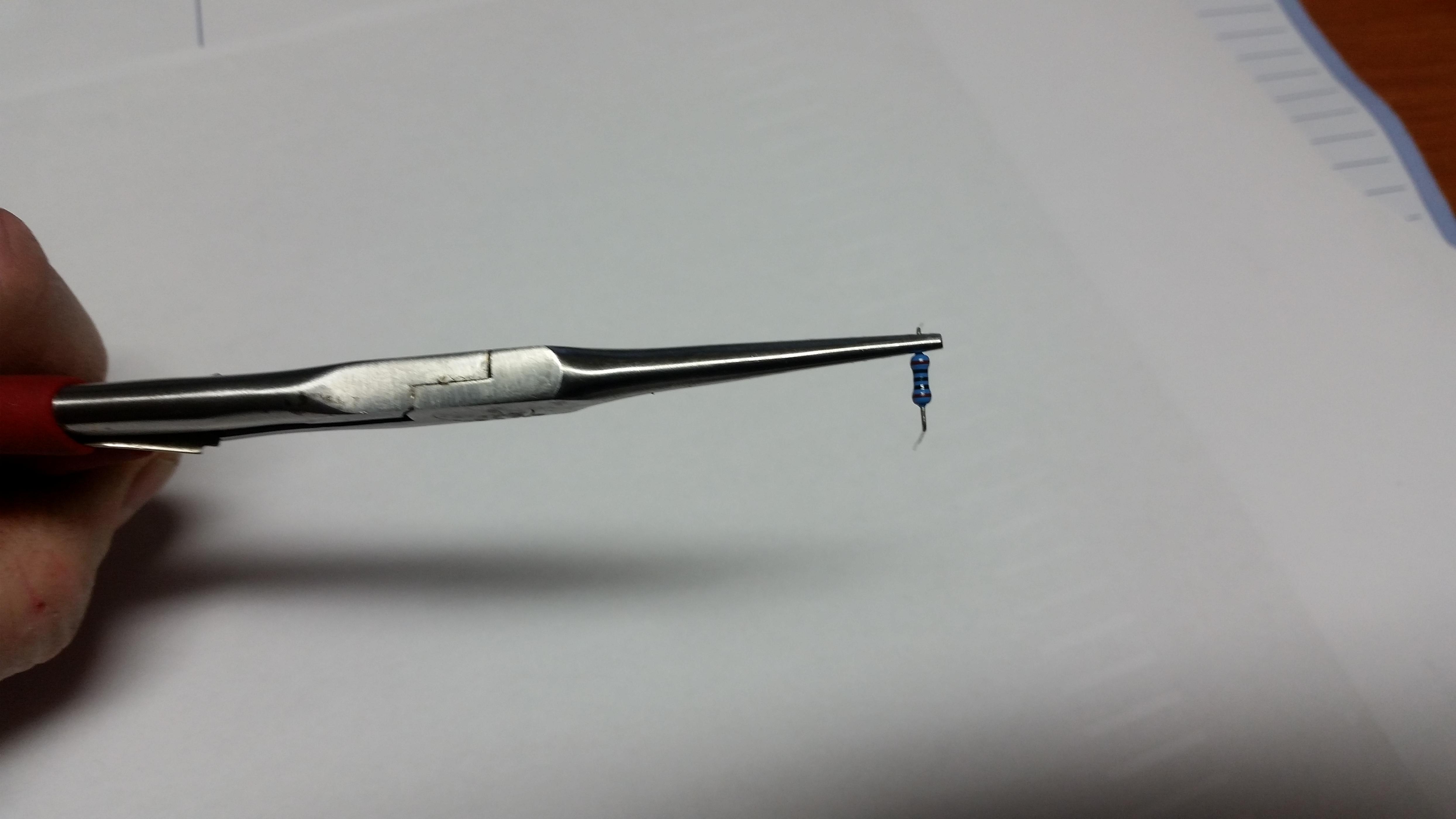

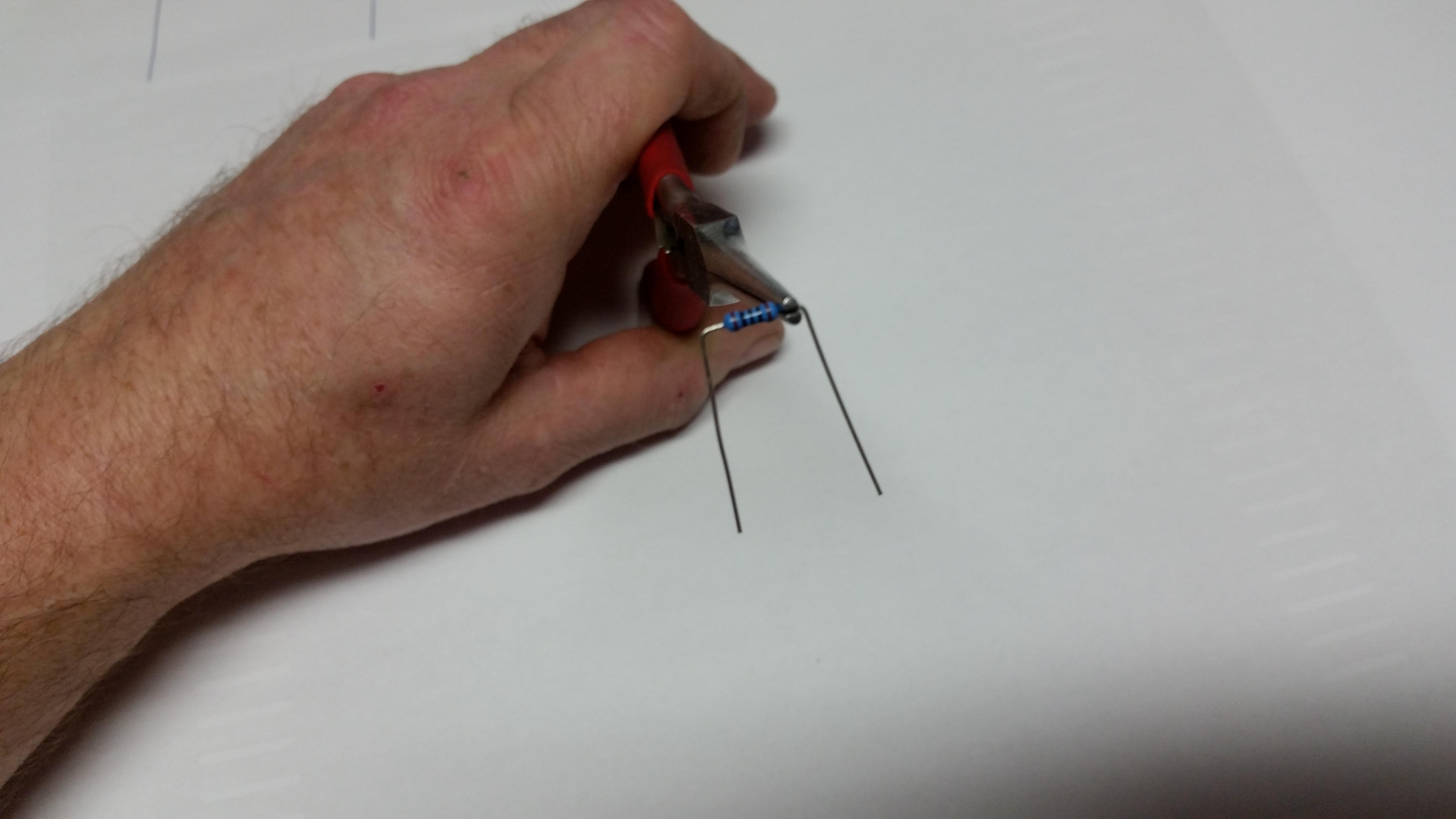

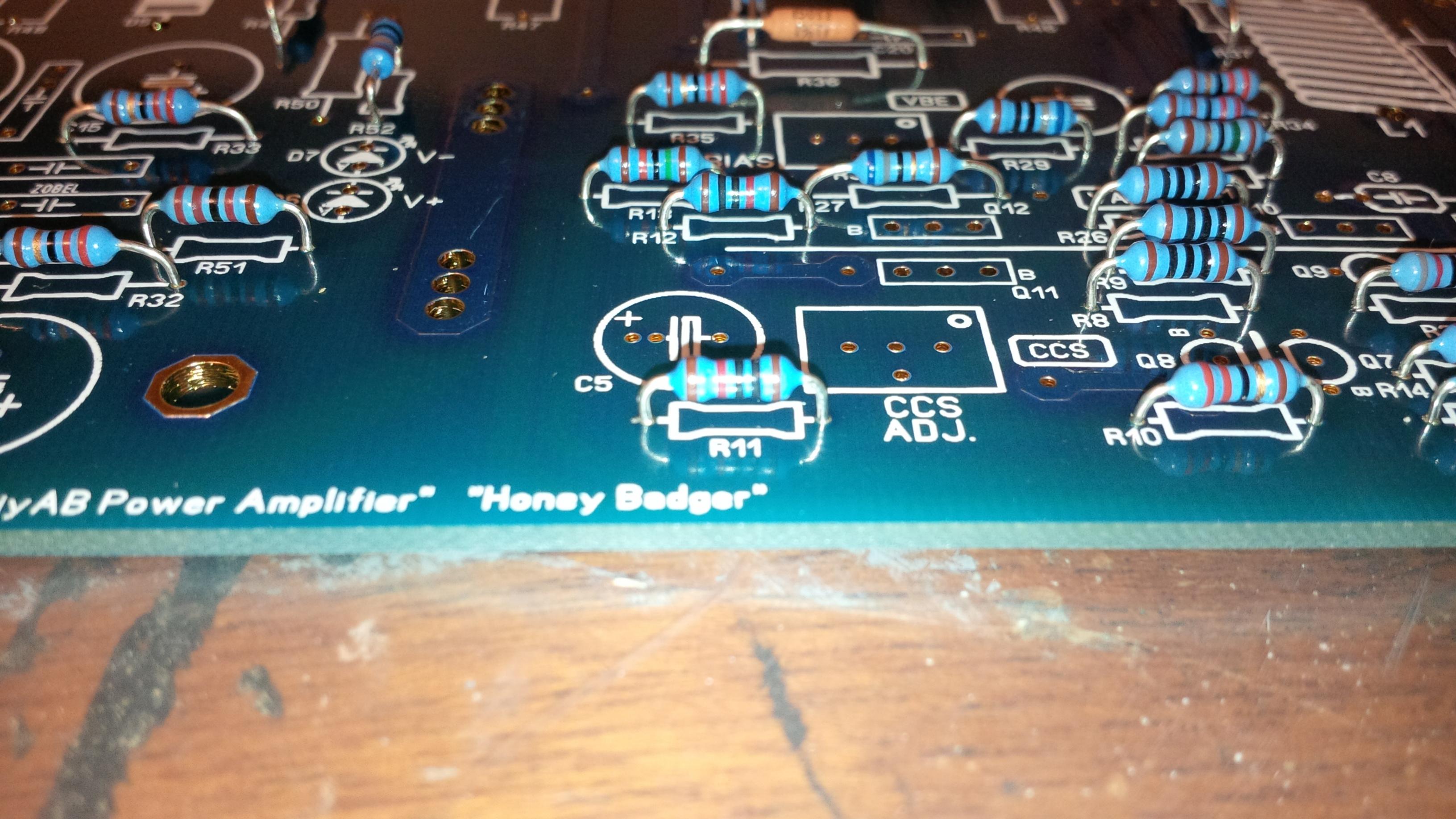

Thanks! That will tidy up the bigger pitched resistors on the second channel for sure. The smaller ones are too tight. I was using a dental pick at first to round the bends, but it wasn't very effective so I just eye-balled the rest... the 0W6 resistors are a little big for the holes, but I knew that when I picked them 🙂
Thanks,I like to use round nose pliers.
I'll look around locally to see what I can find . All my good tools are up north at work.

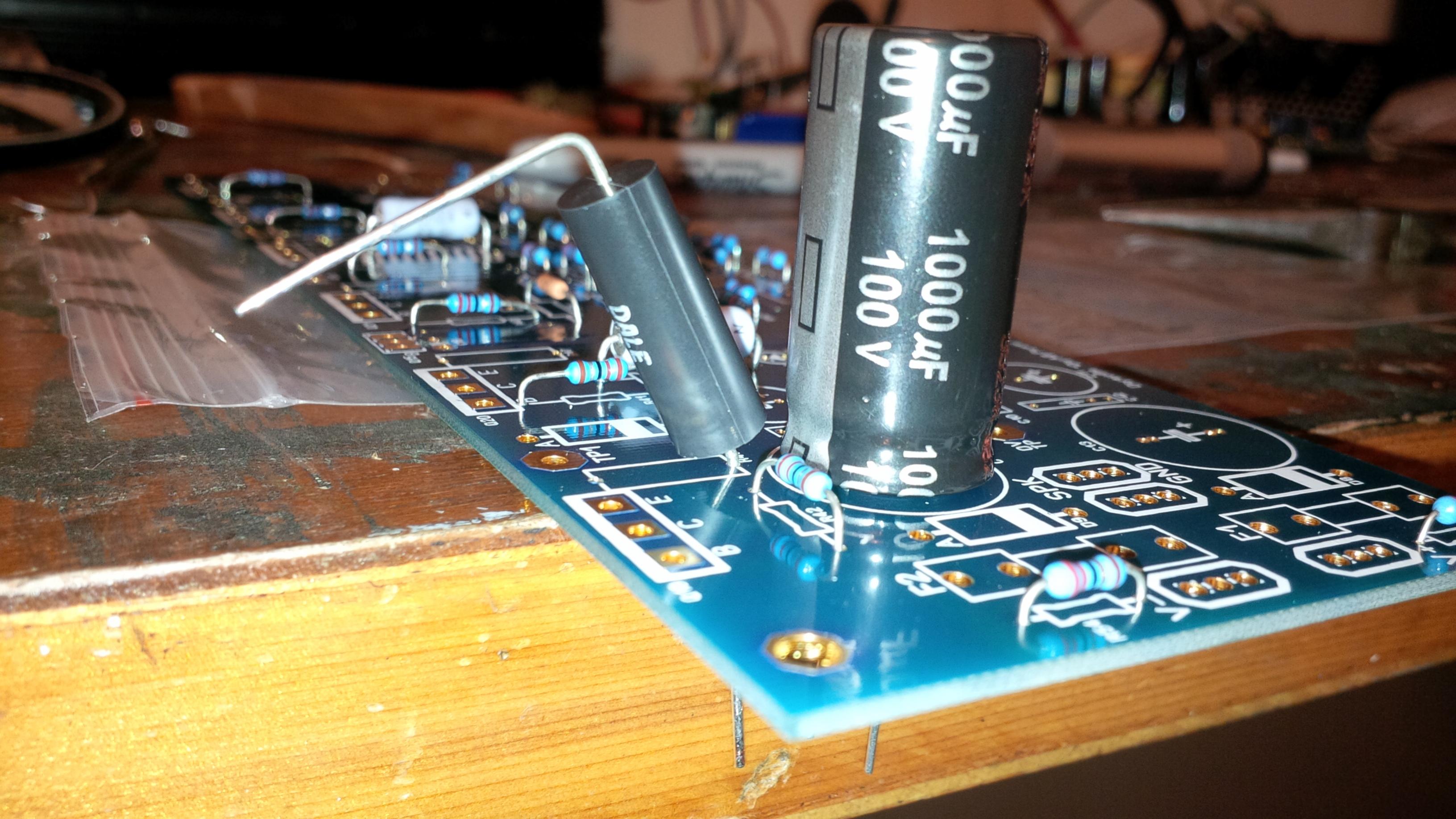

The leads are just a little bit too short to mount vertical. Does it look too close to c17 (R48)?
Edit: this doesn't work either. The leads are too short unless both bent underneath the body. But the body is too big in that case.
