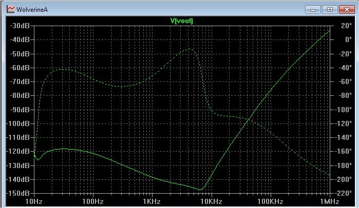

Since you have your R32/R33 jumpered with wires , you will have worse
PSRR. No stability issues , but less performance.
The way it is = -67db PSRR at 1K
22R for R32/33 = -95DB
If you add 2 capacitance multipliers between The R32/33 (pads/pins) like the example :
(below 1) .... your PSRR becomes excellent. -120db is an audible improvement.
Any Badger builder can use this mod ...... but you will lose 2 volts of
amplifier headroom before clip. Still , not a bad tradeoff !!
Negative rail is just a simple PNP version of the example.
PS- this simple enhancement is 90% of the wolverine improvement over the badger.
The stereo image will be noticeably improved. Even in a dual mono setup ,
the general audible detail will also be enhanced.

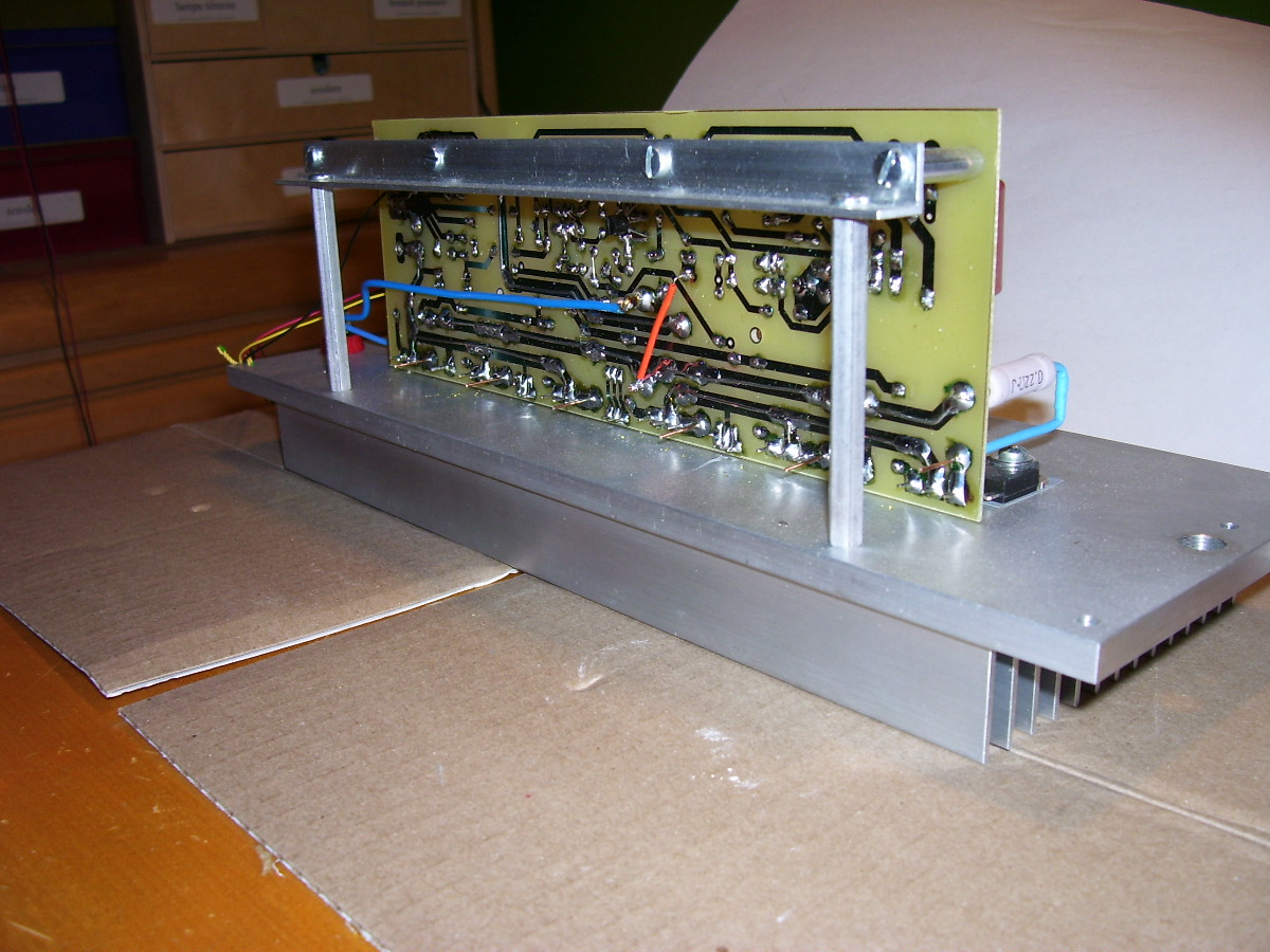

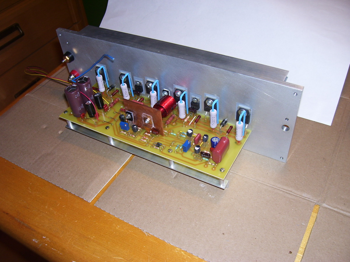

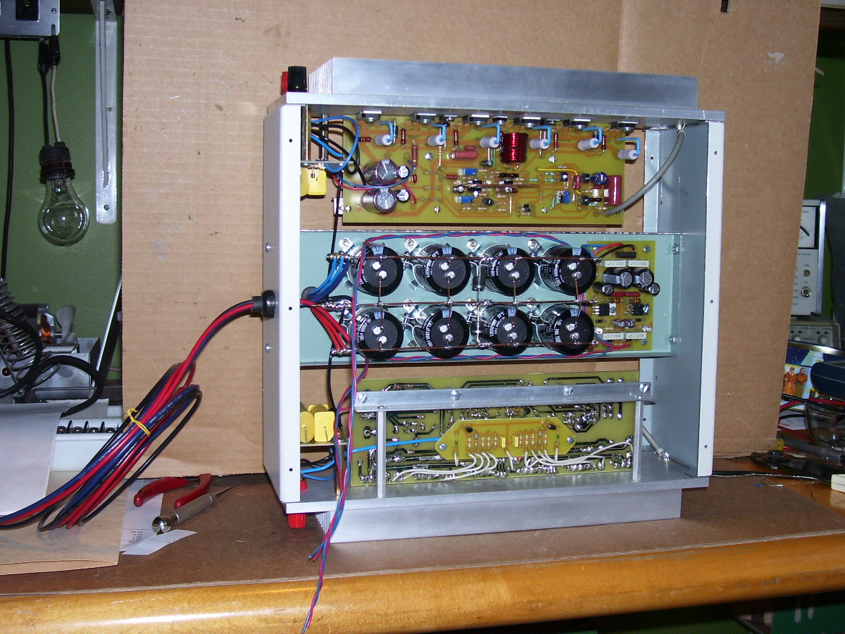

The picture you see in post 2103 is a unfinished unit.
I did build a pair of module and build a stereo power amplifier using a common power suply.
I ad a typical protection circuit on a extra board, and also a single ripple filter for input stage of the 2 chanels.
You may see theses extra boards on the pictures below.

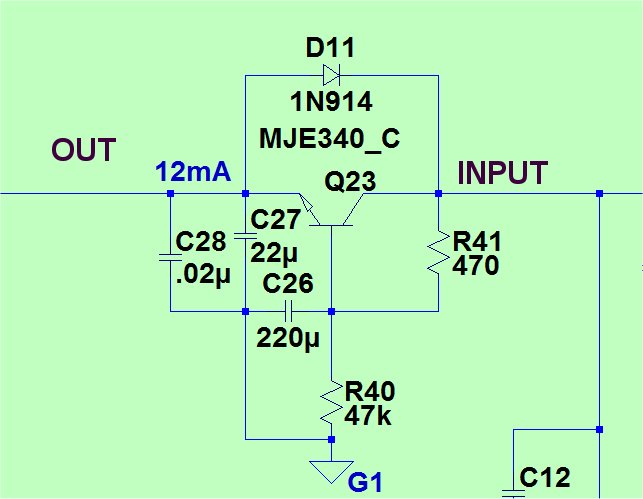

the ratio of R40:R41 gives the proportion of input voltage at the base/gate of the series element.
the 470r:47k gives 1:0.9900990099
i.e. 99% of the input is applied to the base.
The output is one Vbe below that 99% value.
The difference between input and output is thus Vbe+ (a %) and this appears as Vce
The Vce is what allows the multiplier to work with a ripple on the input. If Vce becomes too small then the multiplier does not work properly.
Many poor designers forget to include R40 (the 47k) and this error in the multiplier topology results in poor ripple attenuation when the lower Vce allows the series transistor to become saturated.
Typical percentages for that resistor ratio are from 90% to 95% when ripple is high. The 99% used here should be reserved for low ripple supplies.
The time constant of R40 & C26 (10seconds) sets the attenuation of low frequency ripple.
