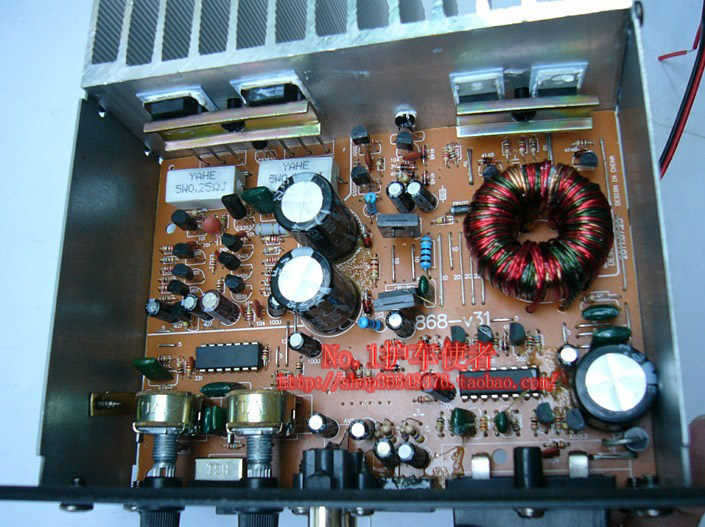

TO-3P and TO-220
As you can see from the car amp below , most OEM's don't trust the
thermal conduction provided by standard package mounting.
They use a metal bar over the row of devices , applying the torque
over the die , not on the package hole.
This might not matter as much with the TO-220 drivers (or to-126 Vbe)
on the Badger , but would better the thermal derating (conduction)
on any of the power devices. The car amp pictured also does this
for the TO-220's because they are the switch- mode devices and
the amp runs in a hot car trunk !

Thanks for the tips!I call them "top hat" washers...With care and a very sharp knife you can cut down the depth of the sleeve. Use a metal washer on the top of the top hat. That stops the bolt/screw head digging into the soft-ish plastic (probably nylon).
They can split when stressed.
Shoulder Washer is the correct North American term for those washers.
...use a metal bar over the row of devices , applying the torque over the die , not on the package hole...
...would better the thermal derating (conduction)
on any of the power devices. !
OS

I agree so please explain how having a bar with one bolt for two transistors can ever be as good as having a single bolt into the center of each transistor where the designers put it. Those car amps are made that way for ease of assembly, not because it is superior.
I was considering one long clamp strip per channel. With multiple mounts. Or using the smaller strips in the center of each output to spread out force. I am most likely the least qualified to discuss this however.
I can't explain that.please explain how having a bar with one bolt for two transistors can ever be as good
I have said:
When clamping use a bolt/screwing fixing on each side of the transistor.
Yes know. I guess I was agreeing with you though it didn't come out that way. IMO, the devices were not designed to be clamped. They were designed to be bolted through the hole provided. Clamping several devices with one "bar" would require that all of the devices were exactly the same thickness. I'm not so sure that all the plastic cases can be trusted in that regard. In cases where there are a mixture of TO-3P and and TO-220 a continuous bar is useless. The bare also requires that more holes be tapped. I have yet to have any issue with attaching the devices with the provided holes.
No , having the torque centered on the semi will distribute the force equally
over the whole device.
To-264/3p the bolt tightens down the end of the tab (slug) thermal compound
will "ooze" out around the screw first .... under the die end later.
MT-200 has 2 screws ... industrial triacs and the old TO-3 - 2 hole ,
this configuration acts like the bar in the car amps.
I did see one TO-3P industrial motor control , it had a 12mm aluminum bar with
3 -4mm bolts over 4 semi's.
In the real world , I would say you might get 5-10% better thermal derating
with the bar.
A test of this would be to get "plasti-gauge" at the auto store , compare
the two methods. I bet the plasti-gauge would be much wider under
the screw hole and even wider under a MT200 or the bar (wider = less 1/1000").
PS - multiple holes (screws) over the length of the bar is what I meant.
If the single screw bar was larger (>4mm bolt) , I also bet it would at least
match standard mounting .... plus only require one hole. This most
likely is the reason the cheap car amps use this method.
OS
A single screw in the bar could be made to work well if properly engineered. A slight arch in the bar could easily evenly distribute the camping pressure.

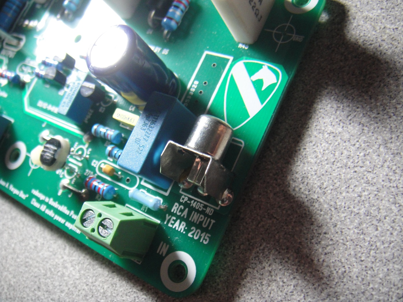

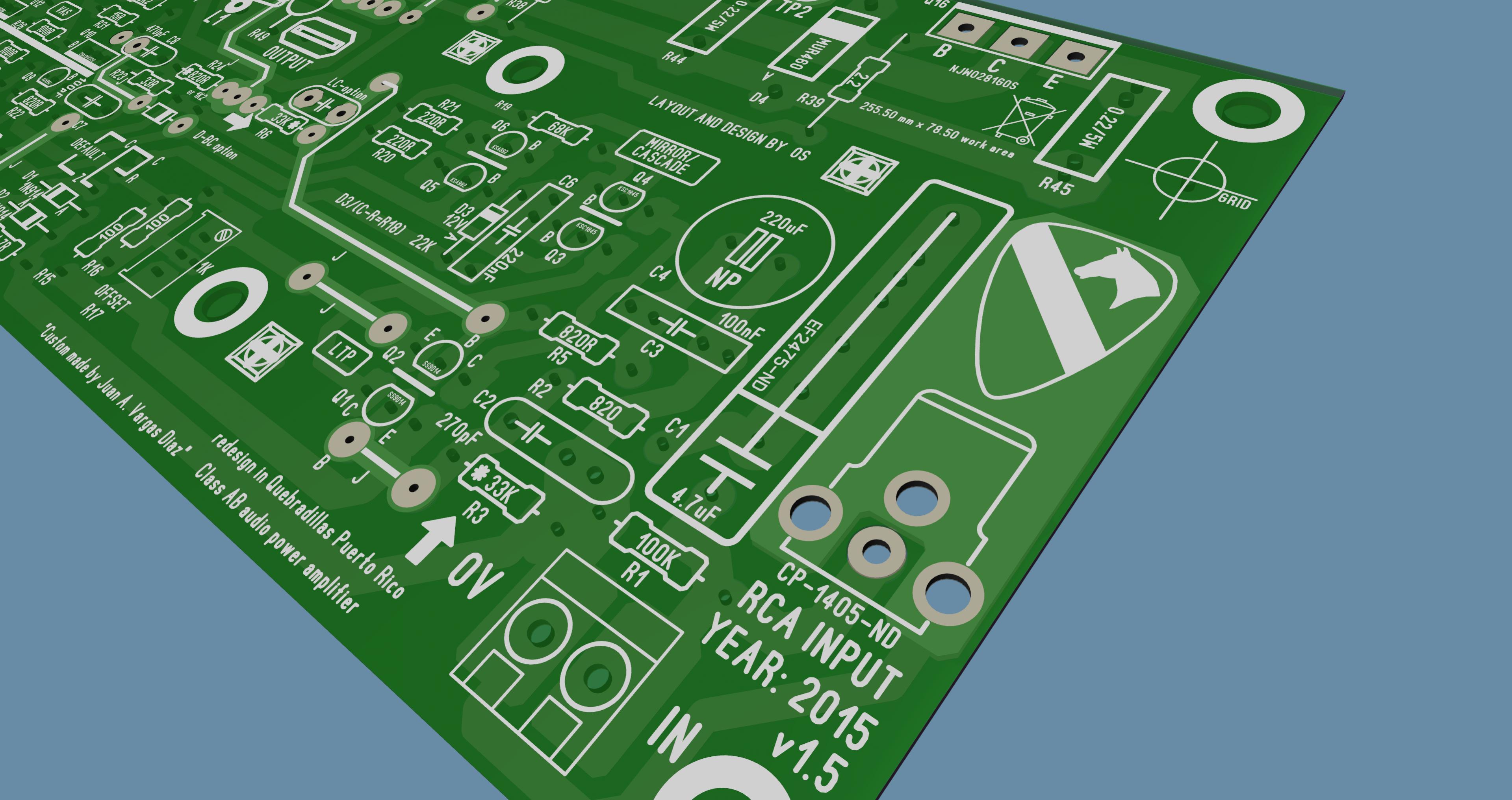

hello OS
this is only an idea of adding a RCA input connector to the Honey Badger for quick test audio what you think ? 🙂
Regards
Juan
I actually would do this on something modular (like the slew's). Would save
time unscrewing the input terminal wires after swapping.
Badger is a finished product , build it once ... forget about it.
OS
