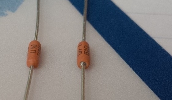

I haven't received mine yet. I did however recieve all my badger parts, aside from a couple pieces that were damaged.
Will be doing another order shortly for my PSU/ wiring. I will have to re-order that R36 resistor, as I only ordered the 2 required units due to crap price!
On another note, those MJL4281's and 4302's are MASSIVE!
