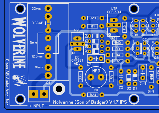

Hi OS,
I believe that the PCB is now ready. :)
I have been checking it for most of the day.:eek:
I have reviewed everything including the BOM that
Juan kindly created.:D
I found a few small thing which I fixed and I also found this
Please see the attached image.
D8 was not actually drawn in, it was only the option R5.
So I updated it to make D8 the primary component and R5 the option.
Also OS what is the value you wish to assign to R5 if it was to be used.
I used a * to indicate that R5 and D3 are options.
Please also look at the silkscreen. Has anything been missed?
Can someone else please review this sprint layout BOM and provide any feedback before the final version is posted.

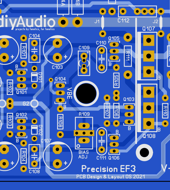

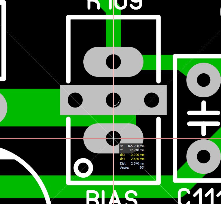

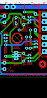

good idea ST for D5 and * value for R5 the file that ST have now also I did the
tiny adjustments on the pitch of power output transistors yesterday to 5.45mm the holes are 1.70 mm so is fine, Q10,Q11,Q13,Q101,Q102,Q105,Q106 = 2.30 mm pitch and Q104,Q103 = 2.54mm
who did C109 look a lot better yes :)
all trim-pots too 2.54mm too

OS tweaked C109. He did a great job.

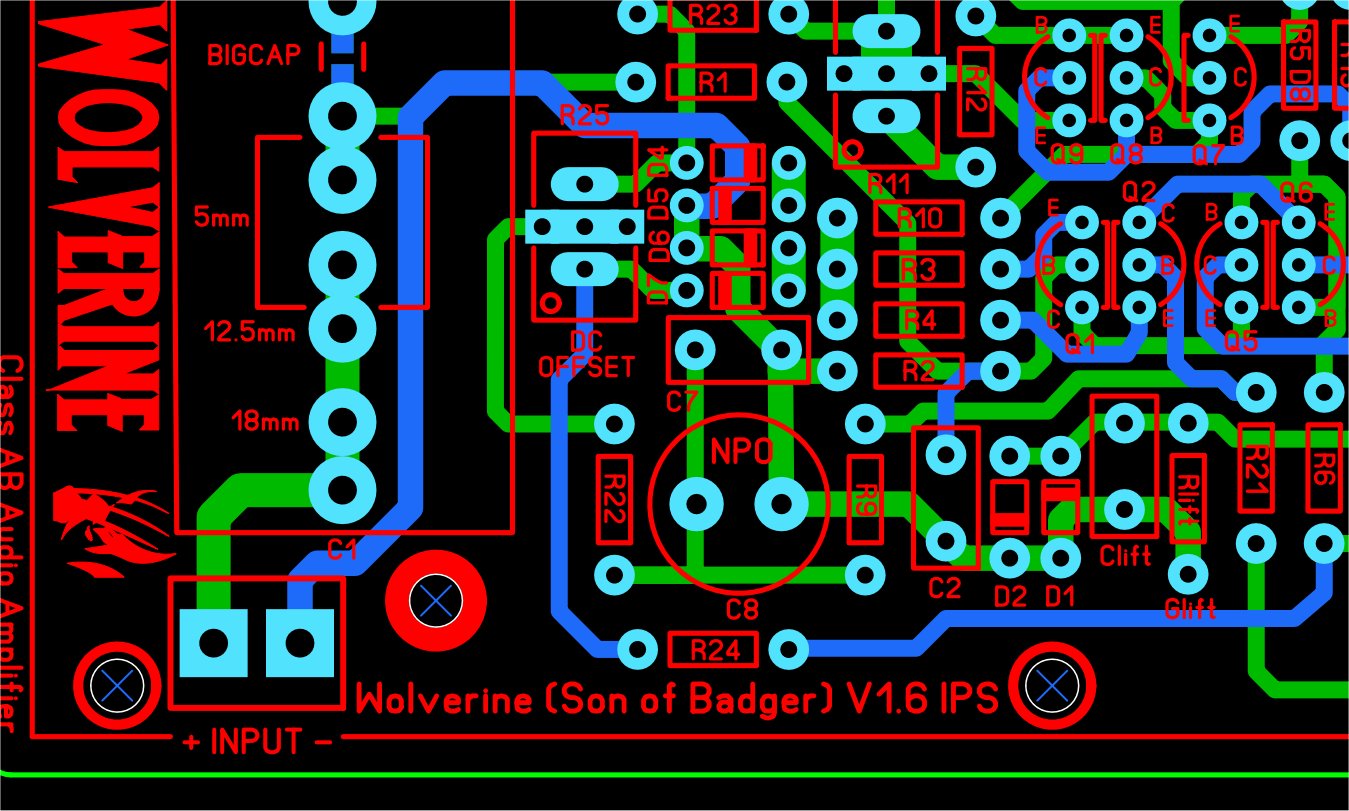

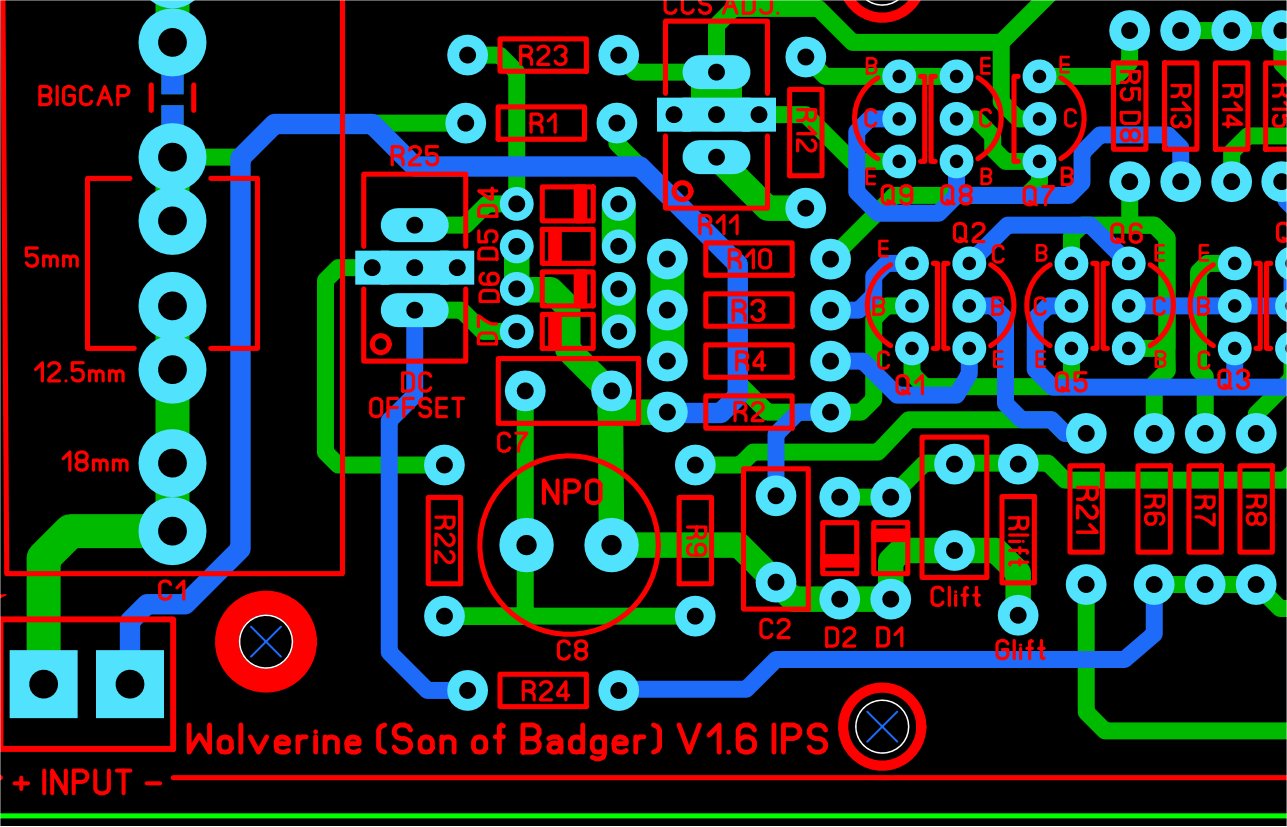

Input loop area.
Yes , spooky has less of a loop. That is just chance from the spirits of layout.
Wolverine's loop ?? C1 , by it's large size ... will increase the loop anyways.
We are filtered/ decoupled by C2/R2. Low currents.
Where I did see mention of this consideration would be for RF/SMPS design in relation
to the PCB , or for a mixed signal layout.
R1 sits in a very quiet area (CCS1) , this IPS is also regulated.

These are also HV silver mica's.
For consistancy , same macro as C4a/b.
That seems to be it ... Nice board.

Hi OS,
Wow. You found a quick solution to that. Well done OS...
Thanks Mark for pointing that out.
OS please post your version so I can make the changes on my latest version, by overlaying the two. I DON'T want and so mistakes at this point. I'll update it later today.
I also need the value of R5 from post #619
