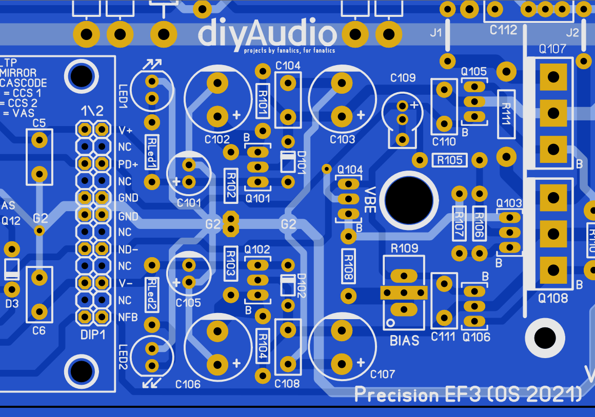

"PS. NC stands for not connected so add the silkscreen text to the empty slots"
ok good idea ST
I learned from Alex MM, Willy and OS layout references, then me years of practice thanks ST

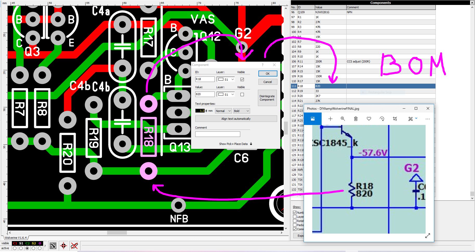

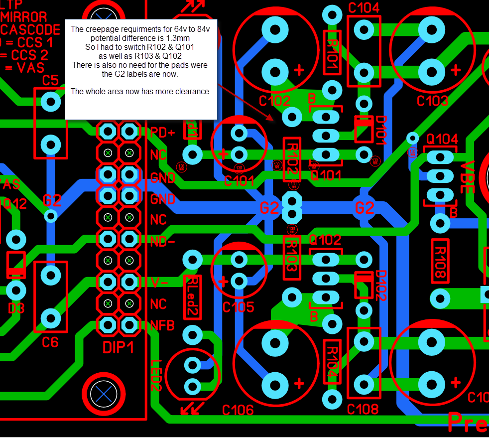

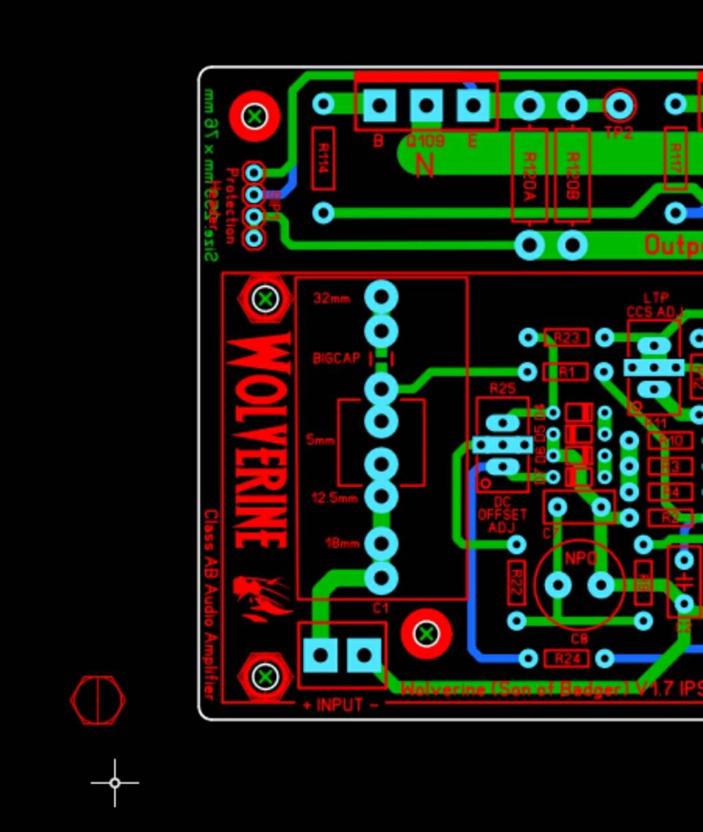

More Clearance
Hi Guys,
I managed to develop more clearance around the G2 Trace.
I also switched R20 / R19 as advised and made more clearance there too.
Comments in Image.
Juan, Please use this version to Continue with the BOM.

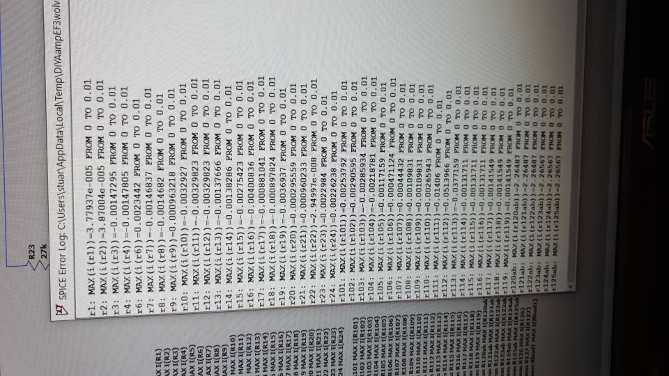

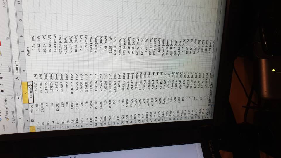

Hi Guys,
I just ran a current check on all resistors using 65v rails.
Hopefully it will help with your resistor selection.
Check the attached spreadsheet.

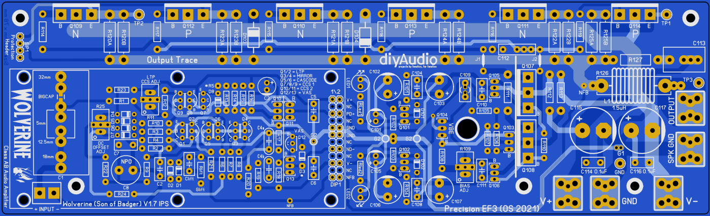

V1.6.4b (attached).
This is the main project. I like the wolverine , but I like the Spook more.
Attached is the current spook (LT and sprint) .
I'm going to make it easy for the more adventurous in the build guide.
I will explain how a standardized current VAS full IPS can be swapped
for any other IPS.

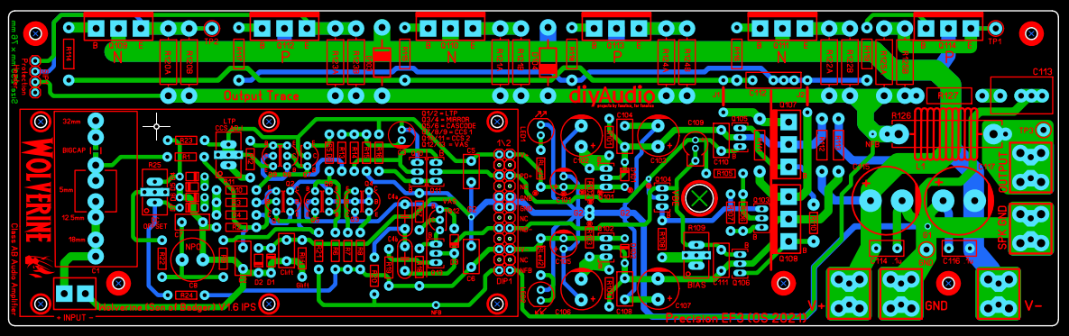

V1.6.4b (attached).This is the main project. I like the wolverine , but I like the Spook more.

Hi OS,
I believe that the PCB is now ready.
I have been checking it for most of the day.
I have reviewed everything including the BOM that
Juan kindly created.

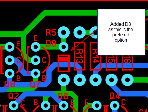

I found a few small thing which I fixed and I also found this
Please see the attached image.
D8 was not actually drawn in, it was only the option R5.
So I updated it to make D8 the primary component and R5 the option.
Also OS what is the value you wish to assign to R5 if it was to be used.
I used a * to indicate that R5 and D3 are options.
Please also look at the silkscreen. Has anything been missed?
Can someone else please review this sprint layout BOM and provide any feedback before the final version is posted.
