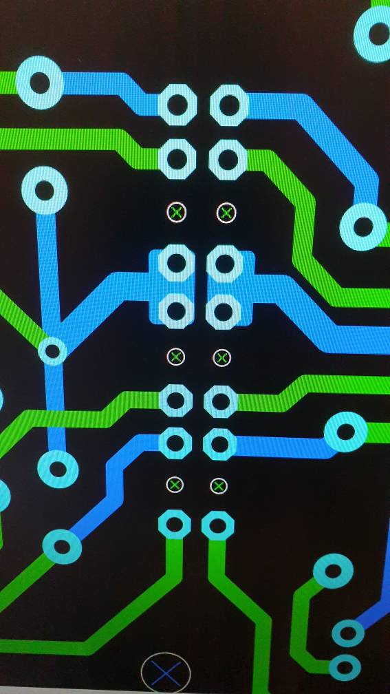

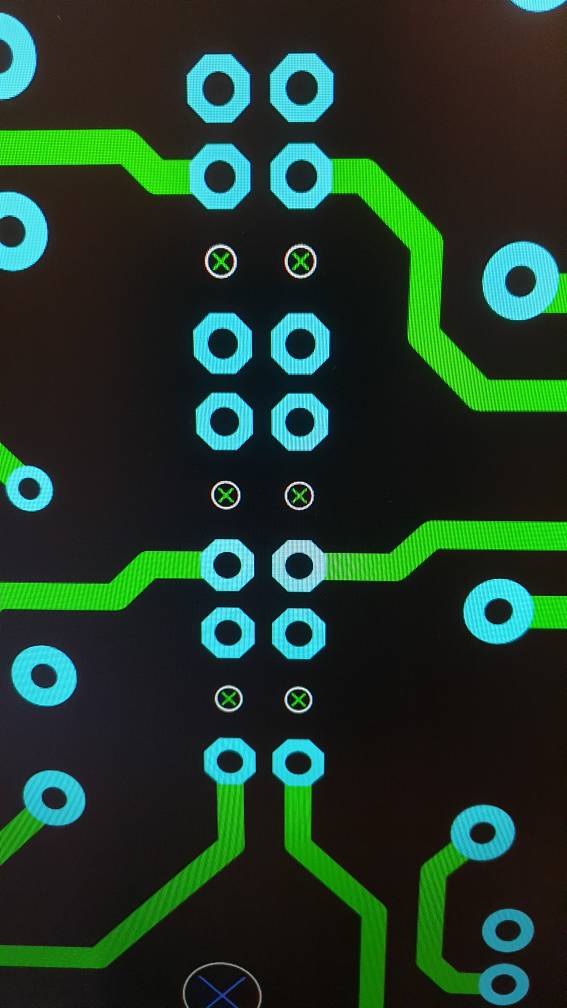

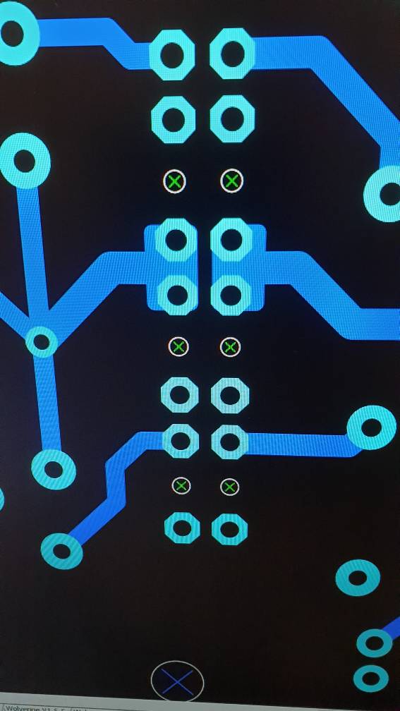

I don't have alot of time during the week, but I did managed to sit down and put a bit of thought into this problem.
This is what came up with.
I will need to check over a few other things once I receive the ltspice file and BOM from OS.
I will have at least a day free on the weekend to continue so hopefully OS has the BOM complete by then.

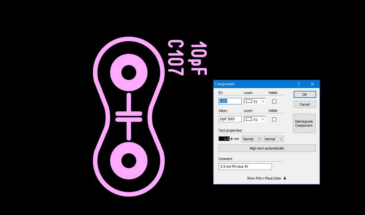

Not all , 470p is 7.9mm ... harder to find 500V 470p is 5.9mm.
68,100,56pF are 5.9 .. generally.

uhmm got it this macro cap I'm gonna attached here and send it to Stuart yes 😀

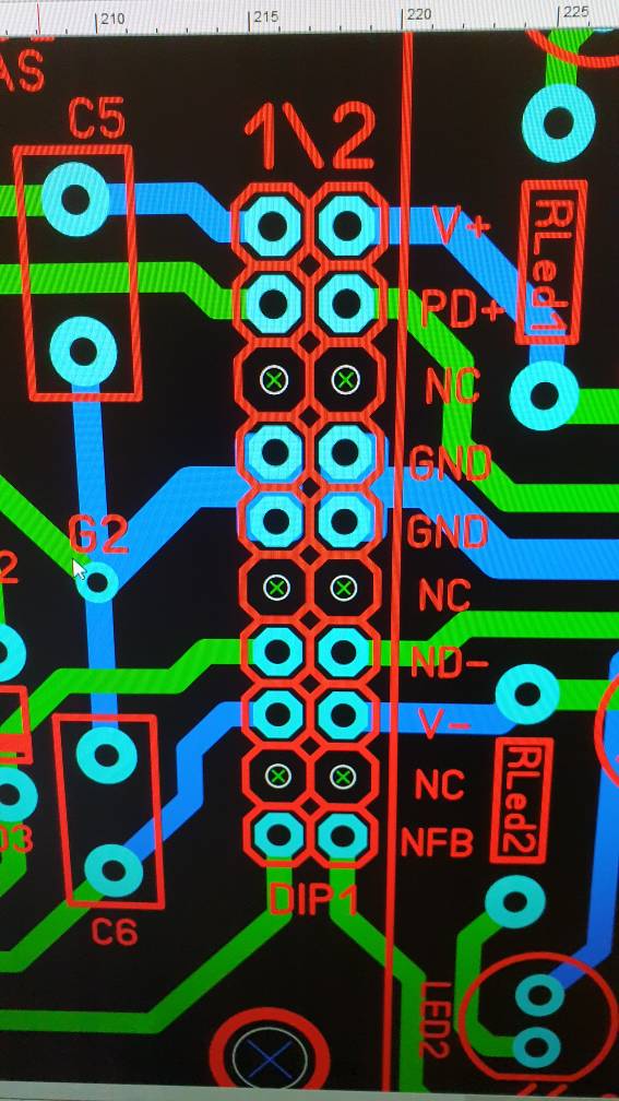

Ain't (I know) a problem . PD+/ND- are at NANO amps/@ 110v p-p.
G2 or the rails , which draw as low as 15mA.. would not "see" anything.
PD+/ND- are the (very) high Z traces. This , looking at 100's of OEM EF3's,
is a rule they all follow(my traces). They never run these traces anywhere near a higher current return.
They are ideal as they are between the clean C mult. outputs and G2.
An example of where you would NOT want to run these traces would be
like close to C103/4 "very dirty" (output/driver ripple decoupling).
PS - NFB , on the other hand ... is super low Z at mA's. While not high current ,
a CRO probe would possibly show a signal within mm's of this trace without even touching
it (at 100Vp-p).

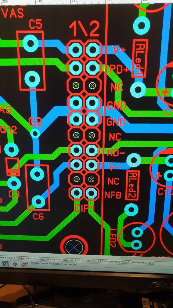

Hi OS, Attached are the latest files.
If we try and develop clearance between traces with high potential difference between them by using alternating sides of the PCB this may solve the creepage problem. I also recommend reviewing the Pad sizes using my calculator. The outer ring it very large in some instances and 1mm inner ring is a little large for 1/4 watt.

Stuart's idea of having traces with high voltage on alternate sides of the PCB is good.

You don't need to use a 2 X 10 position DIP 1 interface. NFB and PD+/ND- are quite optimized.
PS - Slewmaster actually used the "DIYaudio fanatic" method of IPS NFB
delivery. This is running a shielded wire from G1/NFB output rail to the
IPS NFB through-hole. These two through-hole's could be 1mm proper
pads (leave the interface NFB jumper off) and the "fanatic" option would live again !
Edit , you know what ... a 10 pin 2 X DIP1 is alright. Overkill , but just as available.
