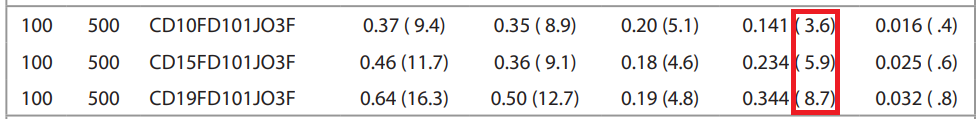

Here's the 2 silver mica's I chose for the BOM (almost done).
Emitter Resistors R120-125a/b are either 2 X .47-.5R per emitter.
Vishay PR02 or any 15mm LS will do.
Single Resistors could be those KOA 15mm LS wirewound ceramics Thimios
posted.
OS
C4a - 100pF silver mica - CDE - 5.9mm LS - CD16FD101JO3F
C4b - 470pF silver mica - CDE - 5.9mm LS - CD15FD501JO3F (500pF)- 5.9mm CD19FD471JO3 470pF (7mm LS)

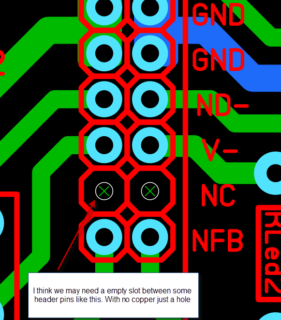

Hi OS,
Can you please include the lead pitch on your bom for the caps that way I can check the layout is suitable.
What about the pads for the holes. Do you mind if I reduced the ones for 1/4w, 1/2w, small caps to 0.9mm inside and 2.0mm outside were they are currently 1mm x 2.4mm?
I'll leave the output transistors emitter resistors as is.

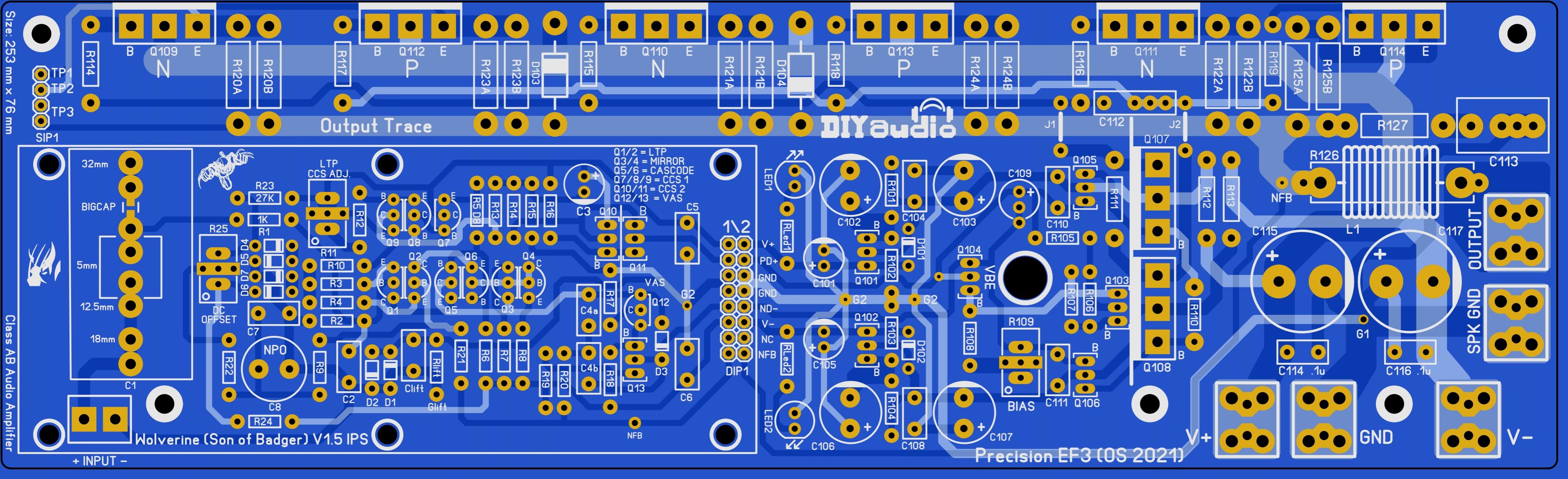

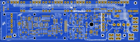

Stuart's last V1.5.9 with upgrades.
-R20/21 tweaked
-ground moved away from R21-C4a/b.
-small inner IPS trace tweaks.
-R25 will bias - for a positive response (offset). So clockwise/counter might
not matter. A builder would turn it one way or the other while watching
his DMM. +mV or - ... who cares. Having it point (down) matters.
-Repositioned all the semi EBC's/label's. Spooky is this way.
All of Stuarts other tweaks are golden.
OS

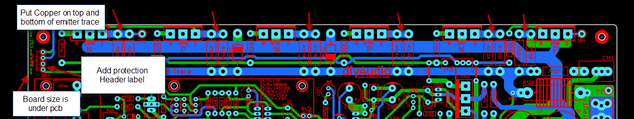

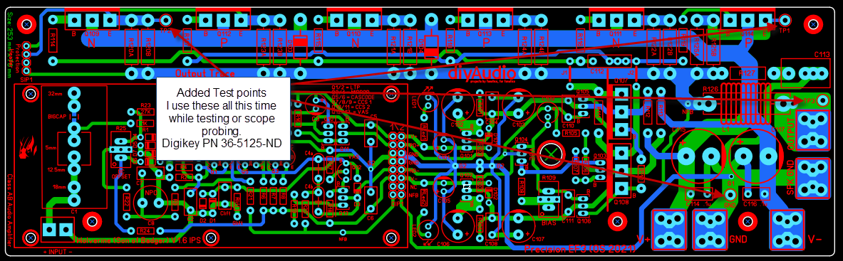

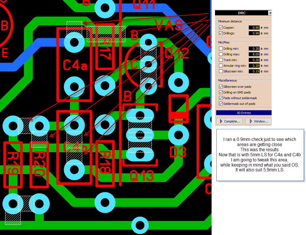

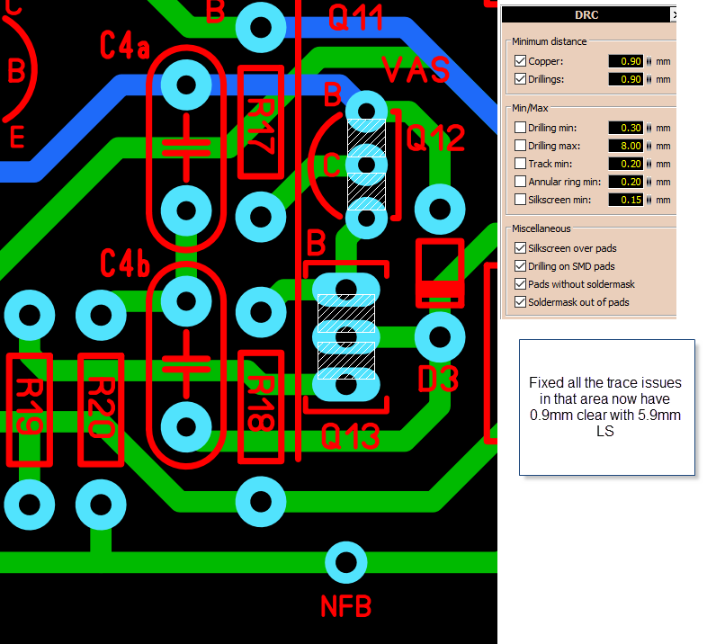

Hi OS,
Thank you for taking a look at the file and sending it back.
I see what you have done to maintain clearance around those high voltage areas.
I found that a little more needed to me done as other pads and traces in that area were still very close.
Please review the images to see what I have done.
I don't believe that any other traces need tweaking anymore and we should try and focus on more productive things.
Juan helped out and I think as far as that goes we are good to go.
I will review the pad hole sizes, LS and silkscreen once I see your BOM.

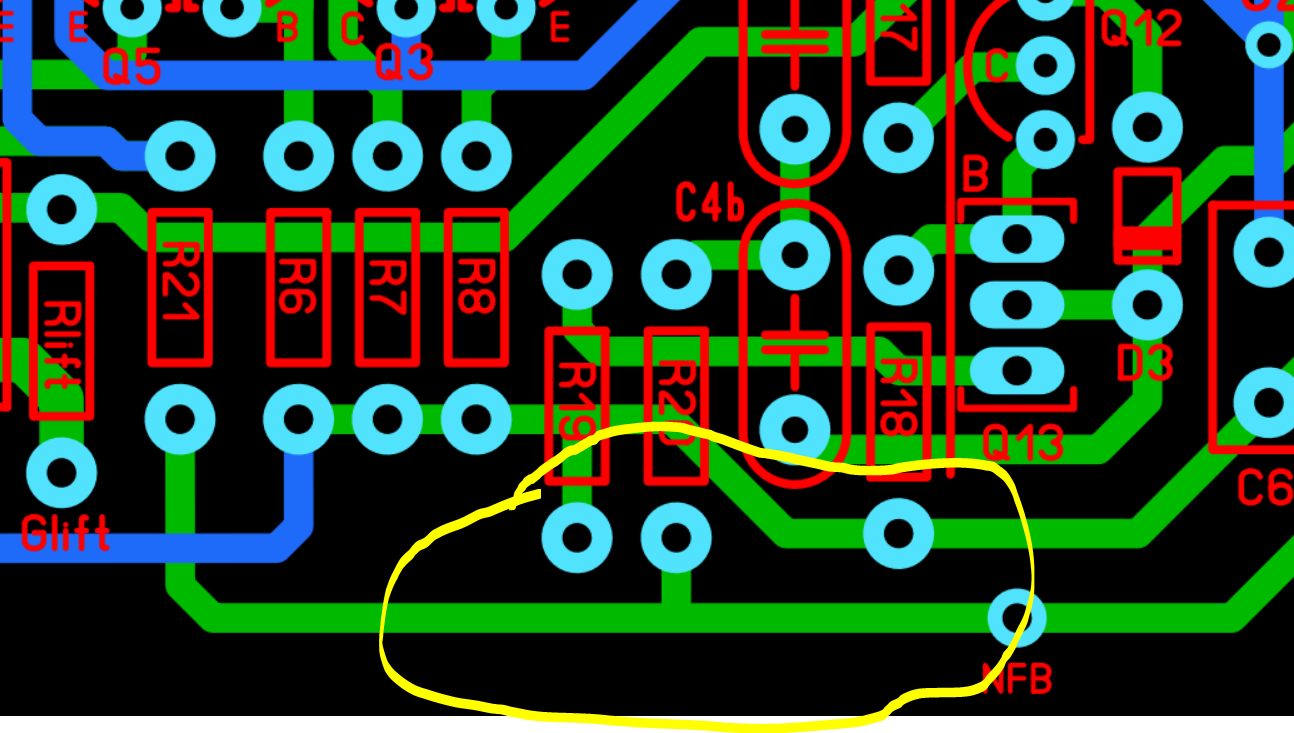

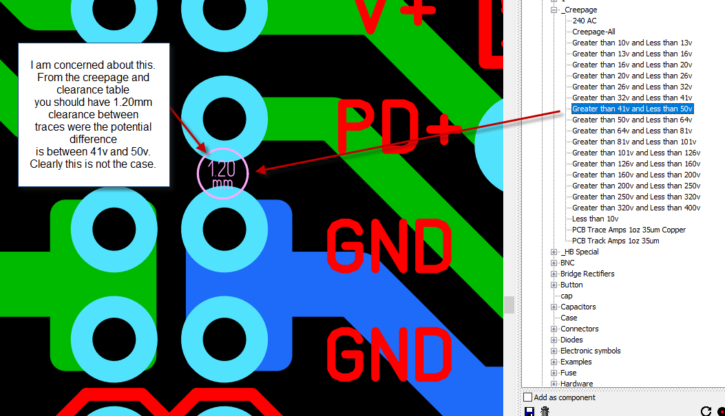

Hi OS,
Please take a look at this, There maybe a problem with creepage and clearance in some areas. I have noted down one for you to look at.

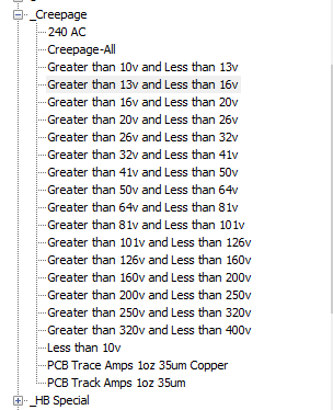

I could check the board but is a lot of work. You need the LT spice schematic and you need to look at the worst case for all adjacent traces. Takes a long time.
Any ways I have included my creepage circle macros which I use as a guide to determine if I have the required clearance.
I have also attached my latest file.
The biggest area to concern yourself with creepage distance is around the feedback trace, particularly around the proximity of the high voltage rails. Voltage to ground is maximum 60V, which isn't really a big deal. Feedback can swing close to rail voltage, so it can approach 120V (in theory with a perfect amplifier). The area at the bottom of R20 is really the only part that concerns me with the input stage. R19 is connected to the negative rail. Everything is too tight there.
For pcb layout IPC2221.
in pdf page 51 and 52/131, on page bottom marked 39 and 40.
http://us.jetpcb.com/Cht/Document/ipc-2221all.pdf

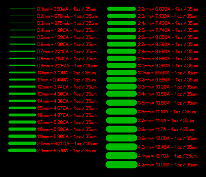

1. Use LTspice and set the circuit parameters for the worst case.
a. So for Example 70v and 4 ohms
b. OS Please upload the LTspice file.
2. We then size all traces to have at least 1.5 – 2 times that load rating. While keeping the minimum trace width to 0.40mm.
3. We then use the BOM that OS is working on and my PCB pad calculator (attached) to size the pads accordingly.
4. We then check the creepage. Some area’s won’t take long and other area’s will take some time.
What do you guy’s think?
Maybe we can work out a plan to move forward with this PCB.
One possible way that I have used before is.
A 0.4mm/35um pcb track can carry 1.6amps, to carry 1.5-2 times the rating the track would need to be 0.9mm-1.5mm wide.
Sorry Indiglo,A 0.4mm/35um pcb track can carry 1.6amps, to carry 1.5-2 times the rating the track would need to be 0.9mm-1.5mm wide.
That's not what I meant. Sorry that I was not clear. What I meant to say was if we see from spice simulation that the trace will carry 100mA we the multiple that by between 1.5 & 2. Round up to the nearest 0.1mm. So let's say 200mA we the look at the required trace width. Looks like its less than 0.1mm. But we have decided that 0.4mm is the narrowest trace. So use 0.4mm.
Hope that clears up the proposed process.
