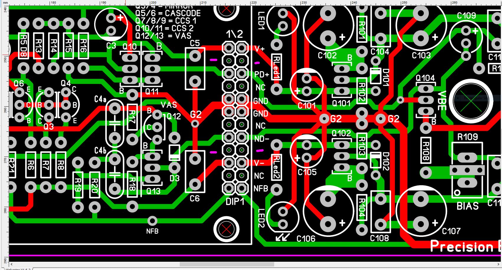

The creepage thing is why I opted to lay out the NS inputs that way they are. PD+, NFB and ND- are all in one plug with only a few volts difference between pins. I put the power connector between the input and VAS. The power connector pins are maximum 60VDC difference between pins with our external regulators. Worked out very well!

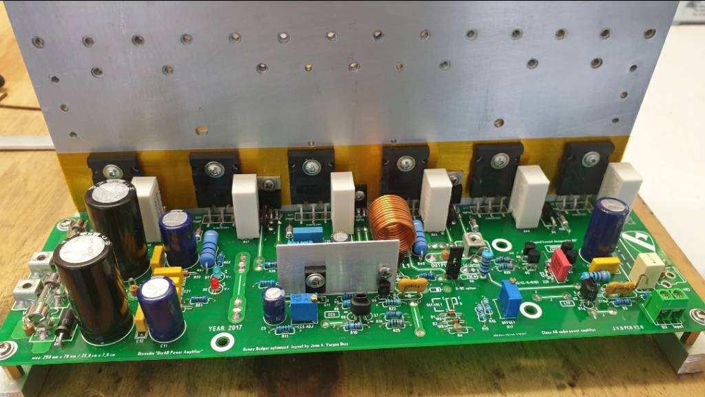

MJL4281A/4302A are great devices but not as tough as the Sankens. They will blow up if you make a mistake where the Sankens just blow fuses.
Yes , good choice. they are also in phase (not perfect , but close).
Stuart needs to bring PD+/ND- closer to G2. Why ... at idle , PD+/ND-
sit a roughly +2V/-1.8V. At full power each can swing rail to rail -5V.
So you could have a 115V potential between PD+ and V+. A G2/PD+
potential could only be 55V. Better.
OS
Yes, the power rails are the scary voltage to have any large voltage swings near by. Plan B would be to put PD+. NFB and ND- together at one end of the connector with an empty pin separating them from the rest, but that's a big rework.

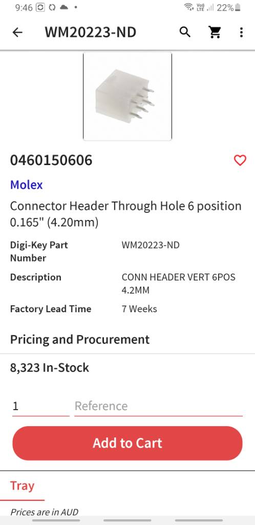

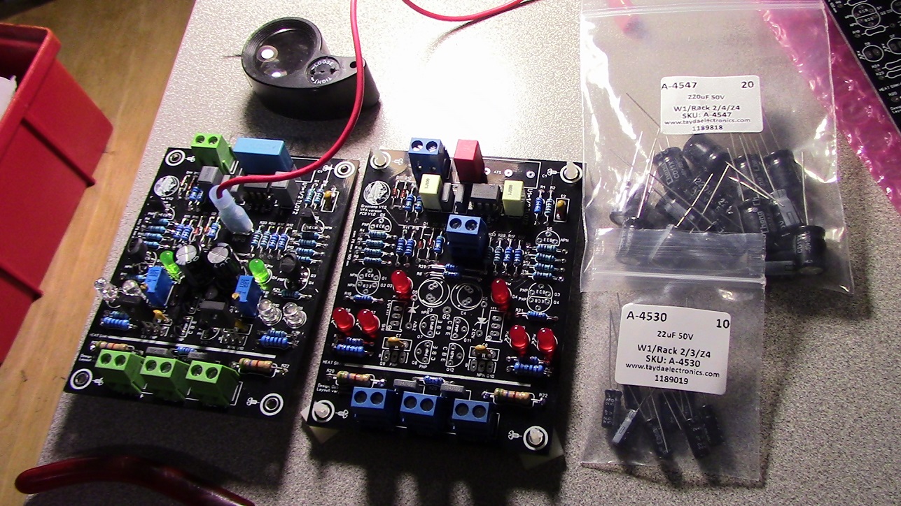

I was talking to Harry and he suggested maybe we can use a larger pitch plug to solve the creepage problem on the pads of the DIP
Maybe a 4.2mm pitch could work.
You may also be able to use a 6 position like this.
Just use a 12 position version of what you are using. Space the connections
out.
The reason ??? The use of common PC jumpers to bridge the connections.
2.54mm pitch is also more universally available.
OS

I'm sure the Badger had borderline creepage issues. It's good that 3 layout
people are swapping designs.
Creepage with this one is more important. Slew/Wolverine is a 50-85 ! volt
design. Badger was strait 60V.
I don't remember this much fussing over the Badger layout - but we know
more and this is good !!

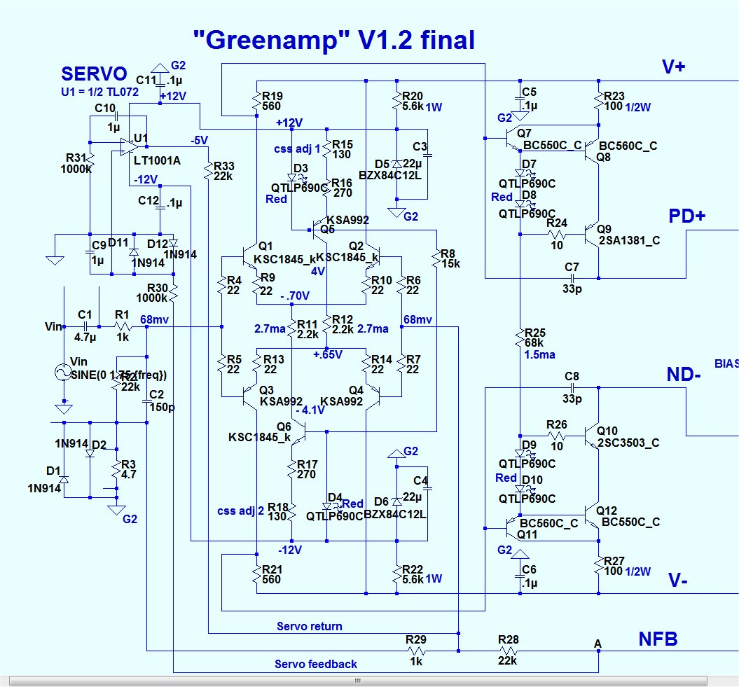

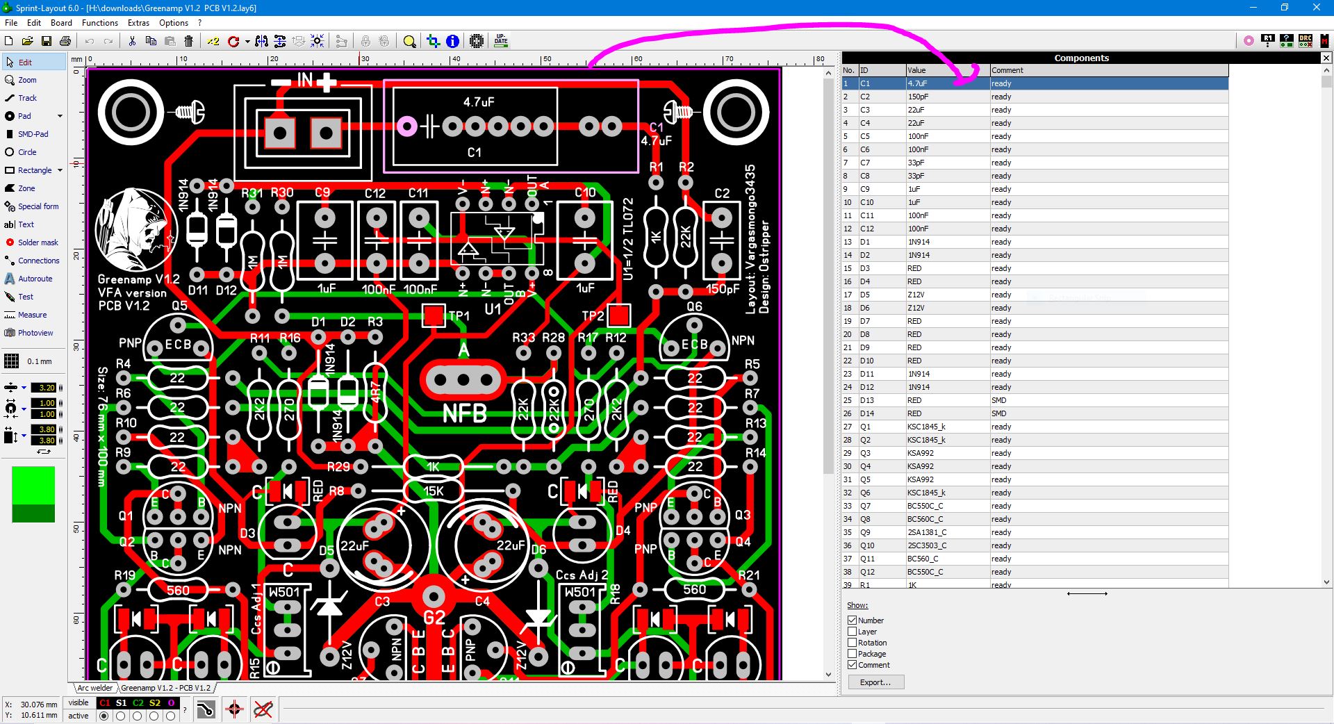

sure OS the file that stuart post here #576
I just did the 12 pin thing I was doing the components ID I haven't finish yet, also because ST is working on it I really don't want to mess this up too 😛 since all macros are made already as components they can have ID and value and that generate a BOM exporting to text easily I did the same with the Greenamp The Green Arrow version you did last year the schematic "I don't remember" lol
yes the Greenamp PCB V1.2 I tested and sounds really good just that I don't have proper tools to give and inform accurate results 🙁
I'm gonna attached here as example 🙂
