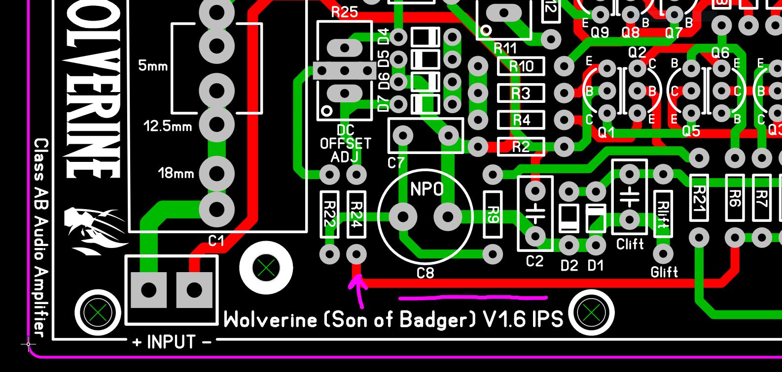

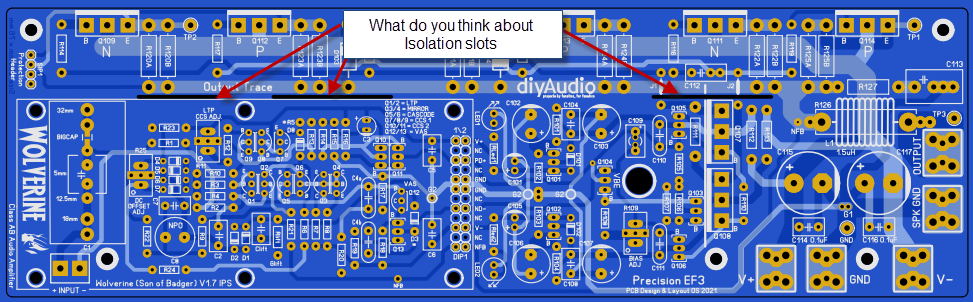

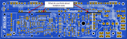

Hi OS, Harry and I have been giving the BOM and Silkscreen sizes a close going over.
We had to tweak a few Caps but we are nearly there.
I was wondering what you think about adding Isolation slots as shown in the Image or in any other location.

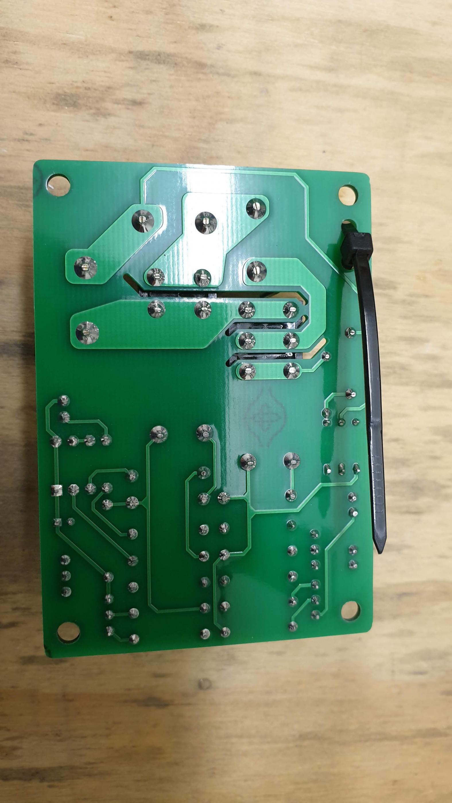

I used them on my Soft Start PCB (attached)

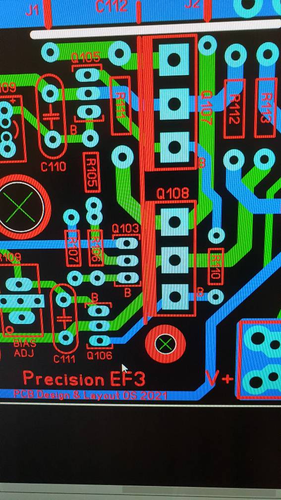

You can't change Q103's position. It must line up with Q108 for
thermal FB.
Q103 bolts to Q108 , all 3 (Q108,107,103) have a small aluminum plate common.

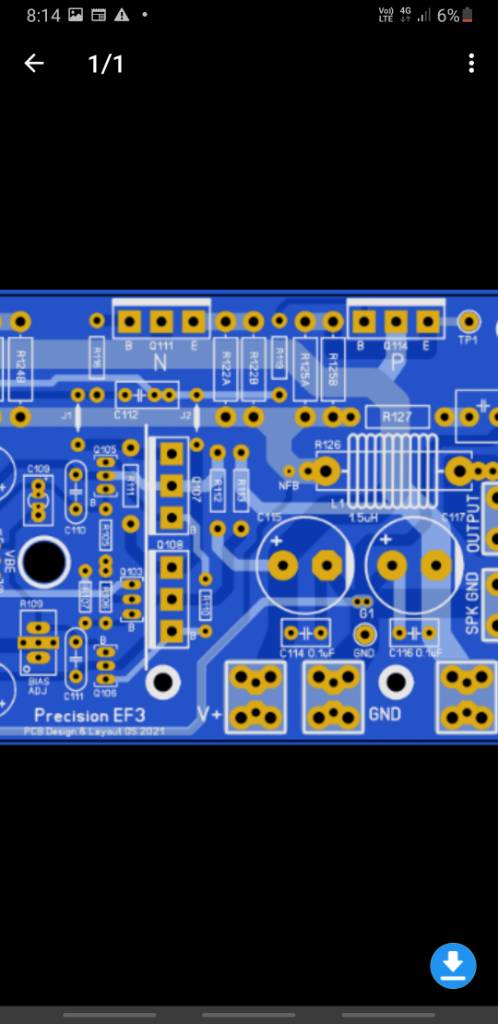

Hi OS,
Yes I thought you might be sharing the mounting bolt. But Q108 is going to sit alot higher on the heatsink plate.
If Q103's mounting hole is to line up with Q108's mounting hole it will be sticky out the board along way.
So there is a few options what would you like me to do.
1. Move Q103 back up so the centers align.
2. Move Q108 down so the centrs align.
3 move Q103 up a bit and move Q108 down a bit so the centres align.
4. There is on other option. If we use a 3mm aluminium heatsink plate we can just leave it as is and just drill and tap two holes and use a short screw for Q103 as it can now sit lower down closer to the board. The screw from Q108 can go through and won't hit Q108. The centers are only offset 2.8mm anyway.
If I moved it down this is what it would look like.

I had someone early in the thread mount a TO-126/TO-3P "sandwich".
Original HK EF3 screwed all 3 devices together (heatshrink tubing ,actually)
Another TO - xx "sandwich".
Both case styles mate nicely at the same height with sufficient lead space/length.
Moving them as long as they align is alright.
Those arc gaps along the output rail are for continuous 120VAC . We
usually run 5-50V (normal listening). Standard creepage will do.
OS

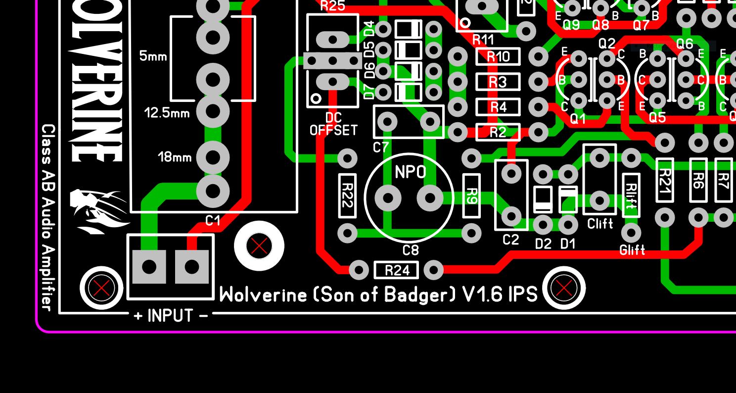

Done, I moved them a bit each way. :)
I will check in with Harry today but I believe we are done.
Once I hear from him and make any necessary changes I will submit to you the final version for your final review.
I also updated the pads on C109

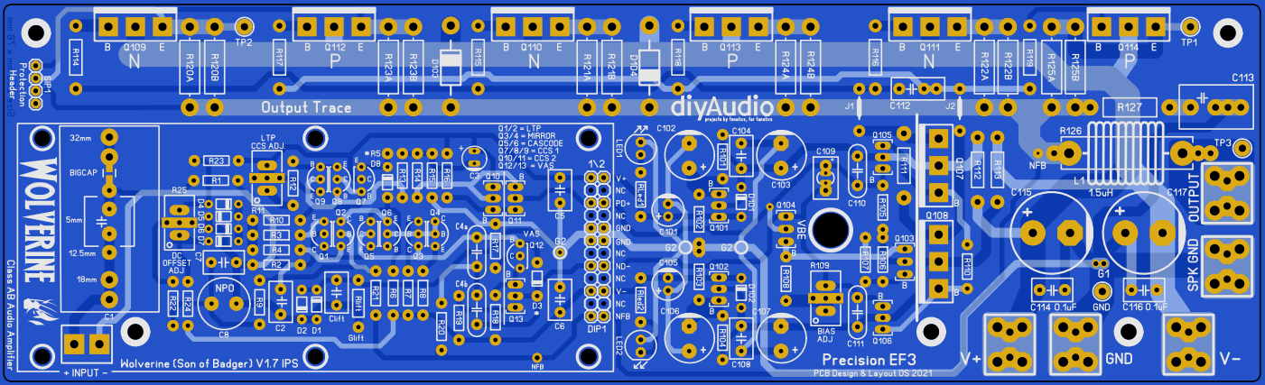

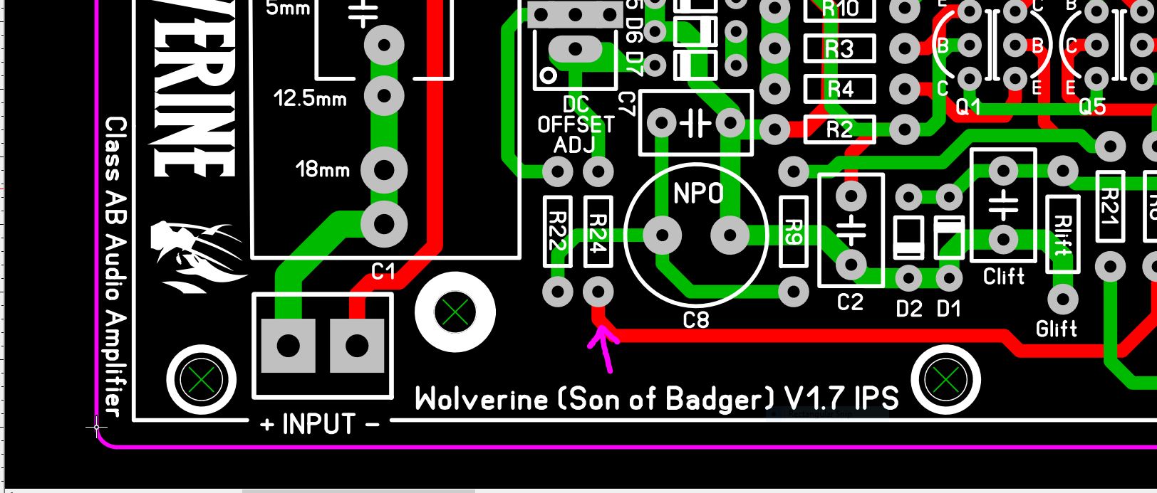

Hi OS,
I can confirm that the Holes line up.
Yes, there is 1 extra hole near the GND of the V+ and V- connections.
It also appears from the PDF you provided that the VBE hole is an extra.
Measuring -20mm, 20mm relative to the hole at the base of Q108.

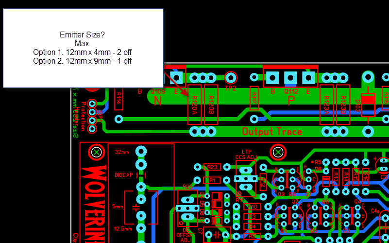

Harry & I have been checking over the BOM and PCB to ensure all the parts will fit. This afternoon Harry was checking over the Emitter resistors and wasn't finding a lot of resistors that would fit in the space provided. He searched Digikey and Mouser.
Below is a Image of what we have so far.
Can you please advise what was your plan for emitter resistors.
I guess another option would be to stretch the top of the PCB but keep the mounting holes in the same position.
Currently the bottom of the PCB is overlapping 10mm from the bottom holes and 6mm from the top holes. I think that an extra 4mm would help.
But we seek your guidance on how to proceed.
I have included a snippet from his BOM to make comparison easier.
