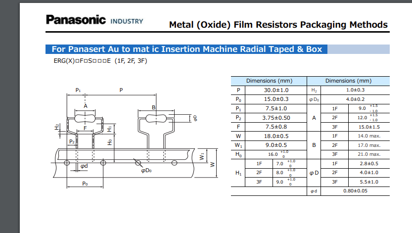

Here's the datasheet. https://www.mouser.ca/datasheet/2/427/cpf-1762878.pdf Check out Panasonic's recommendation for insertion. Almost anything will go.

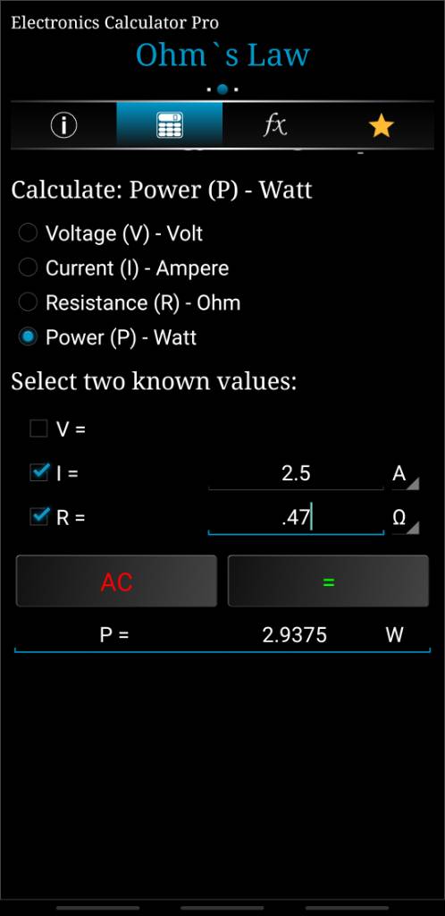

I would have thought that 3w would be the bare minimum.

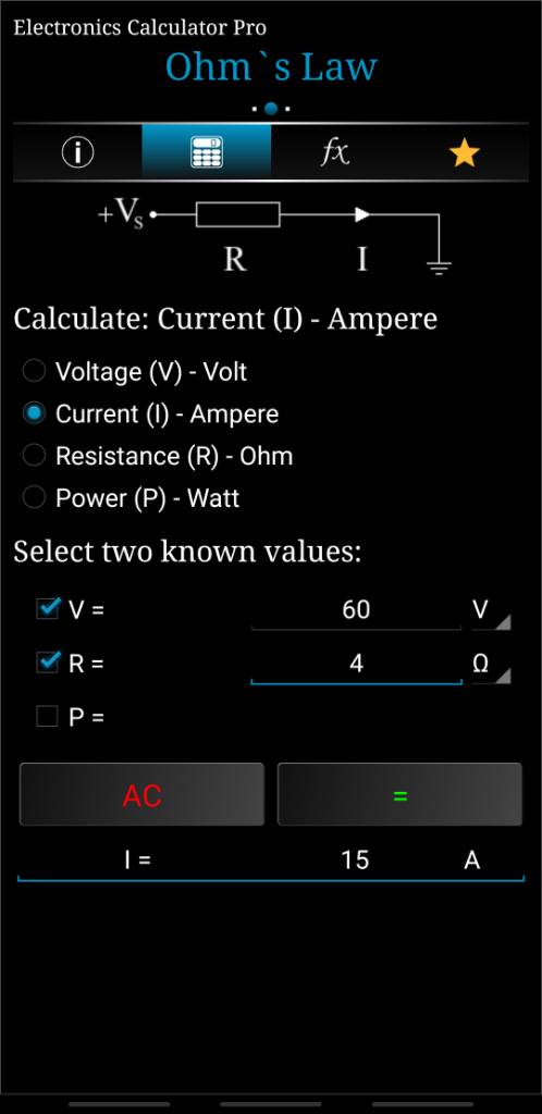

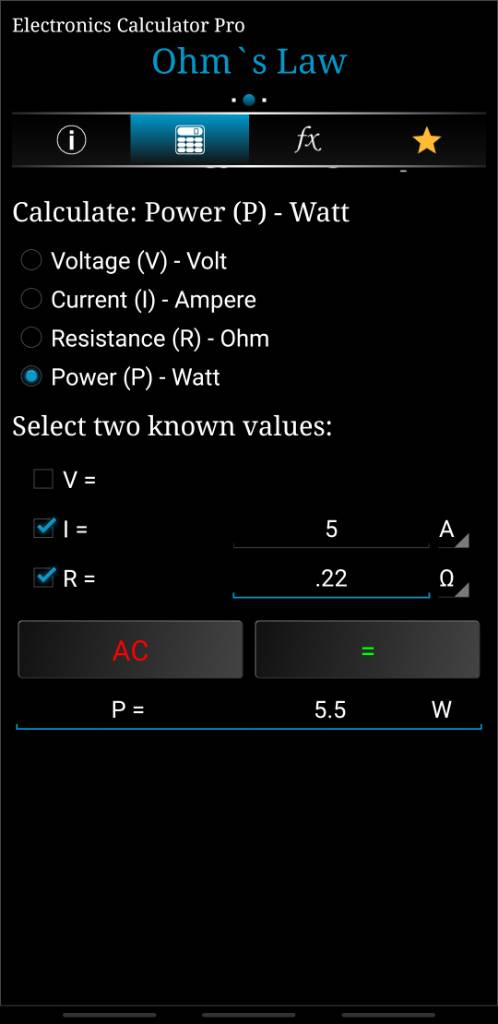

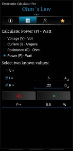

Considering 3 transistors into 4 ohms with 60v rails. View attachment 946434 View attachment 946435 View attachment 946436
60V 4ohms, and 3 pairs means 5A peak current/device, and only half cycle. The means 1.6A continous, which is 0,56W for each 0.22ohms.
(Edited, because my mistake)

Ok.. I see my mistake. Thanks guys.Yup ...
I still like the 3W route for 4R. Plenty of either SMD/TH at mouser.

I made mistake with the calculation (forgot half cycle), so 0,56W for 0.22ohms.
Sajti
So 2W devices are quite valid , as well. Good. Most 2W's are 10-12mm.

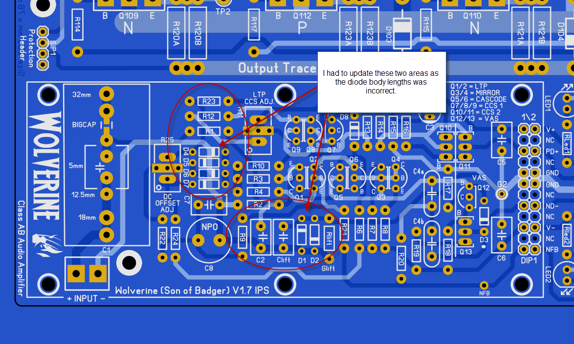

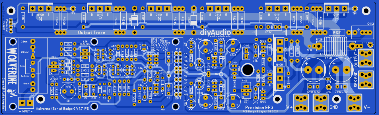

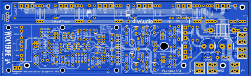

Please Review
Hi OS,
I believe that Harry is just about done with the BOM review and I have been making a few changes as he has been checking. He found a body length problem with the silkscreen and pads for most of the diodes. So I have redrawn and adjusted accordingly.
Please review what I have done.
Hi OS,

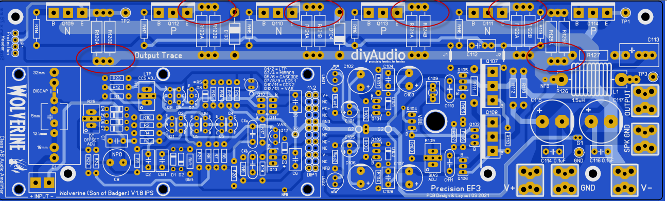

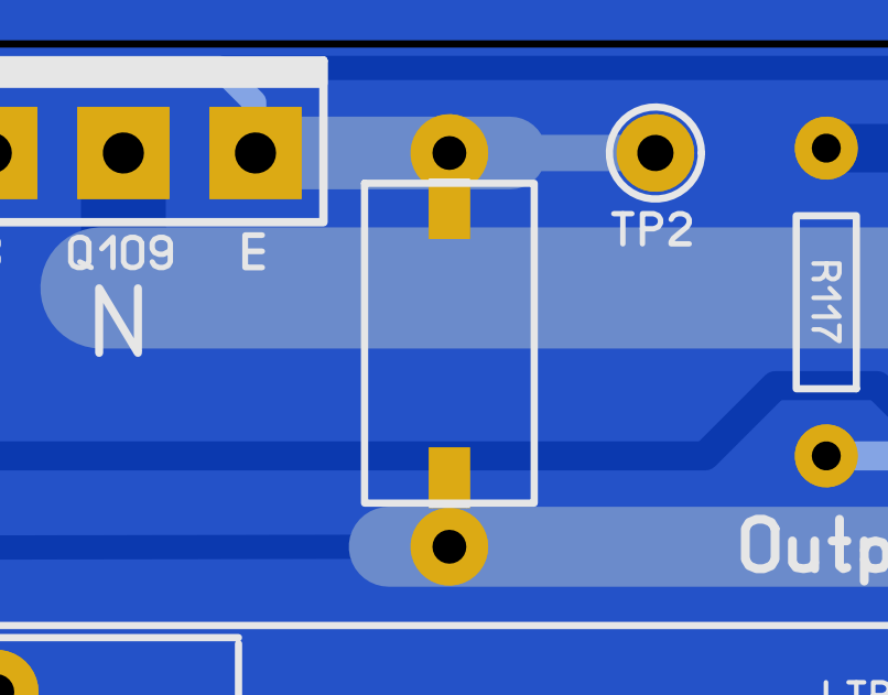

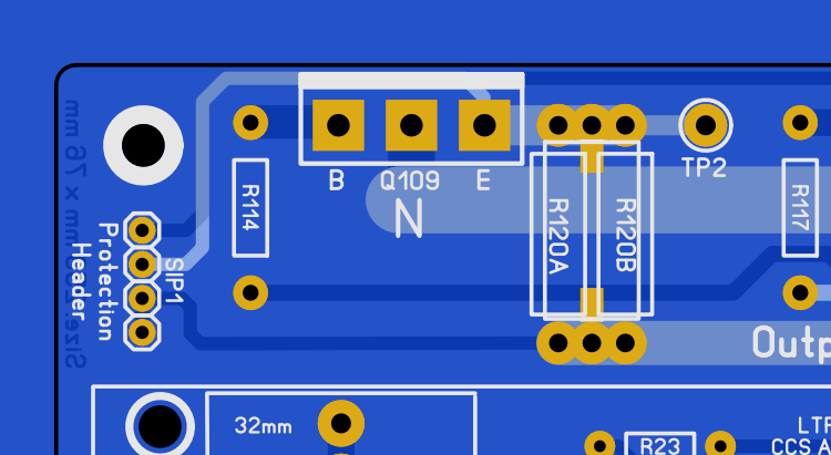

SMD option for R120-125
Small square pads (circled) will also give the option -
Moulded SMD wirewounds.
https://www.mouser.com/datasheet/2/418/5/ENG_DS_1773242_F-720908.pdf
If I could find the SM-5 varient - digikey has them.
Blocked
.93c X 6 - very cheap.
Talk about a non-intrusive emitter resistor.
edit - or ... make that center emitter resistor through-hole into the SMD pads. Don't be scared
of these SMD's , they are huge (7.3mm X 13.5mm).

Hi OS,
I'm not sure that's going to work.
The metal lead / strip that you solder to under the resistor encroaches in the creepage allowance.
The inside of the lead / strip measures 8.6mm
I removed R120A / R120B for clarity.
This might be a good choice.
PNP300JR-73-470R
or
WNC470FE
PNP300JR-73-470R
or
WNC470FE

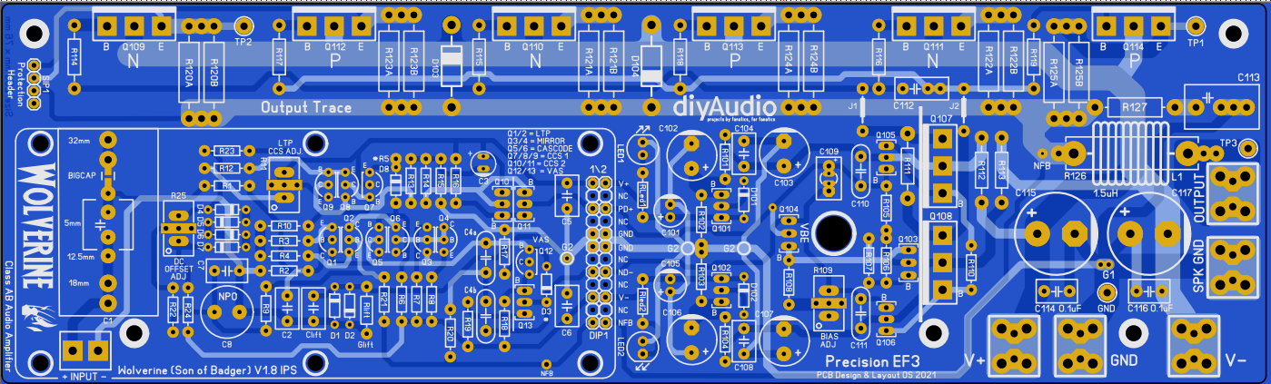

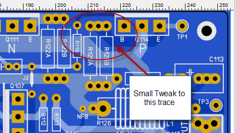

DIYAWolverine1.8 Final
Hi OS,
I'm done.
I managed to increase the emitter resistor lead pitch from 16.25mm to 18.5mm with a little tweak to the output trace. This will hopeful give more people more options to use parts that they have or are able to source locally were they live.
I hope you like it and approve this fine PCB for manufacture.
I suggest that someone else does a final schematic to pcb trace check to ensure that the circuit has been routed correctly.
PS. The resistor above were 470 ohms sorry about that. But equivalent 0.47 or 0.5 ohms are available.
Hi OS,
I'm done.

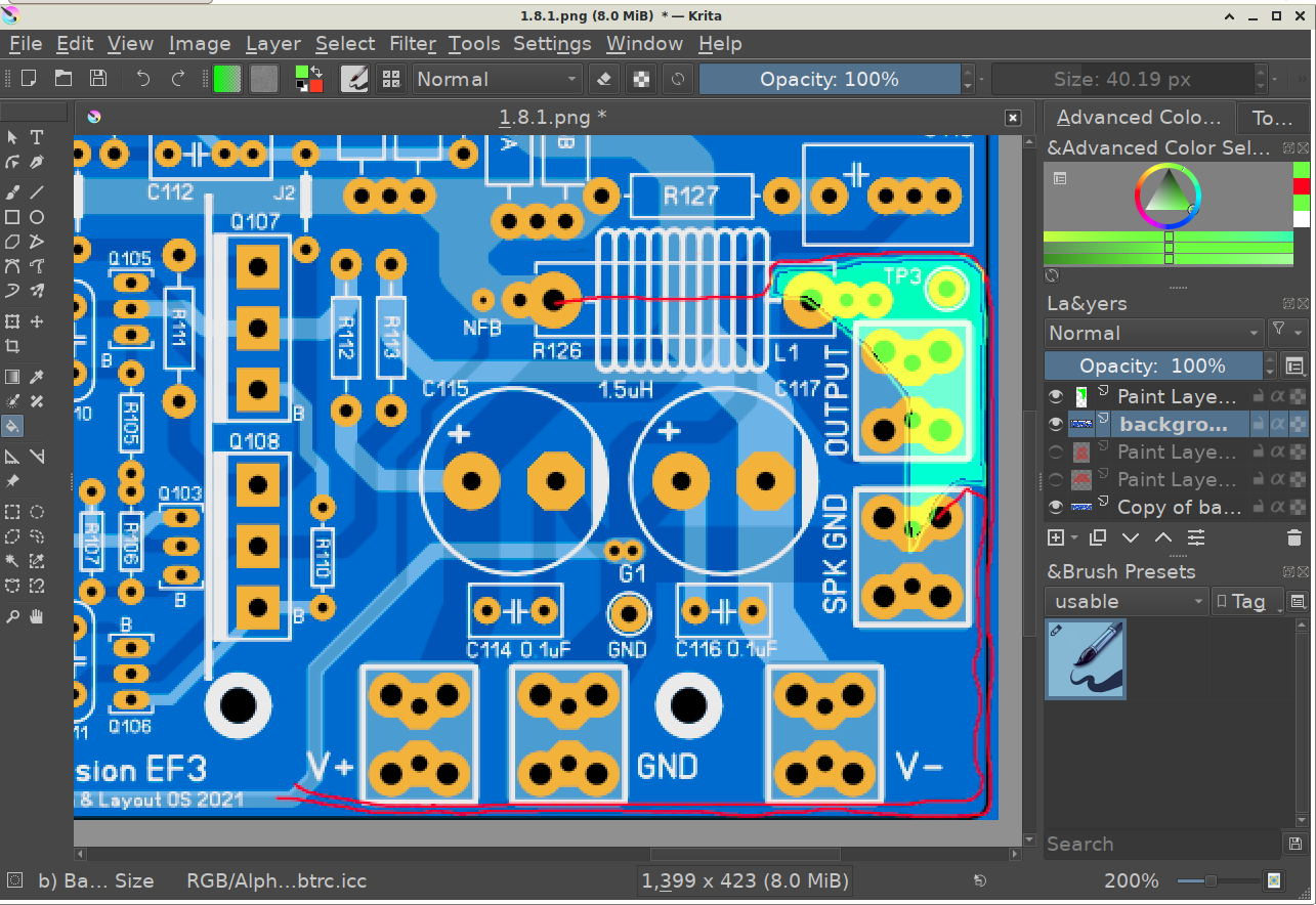

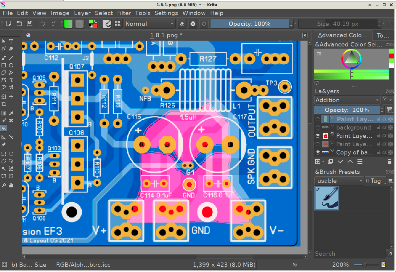

Here is some drawings of the current loops.
First picture is the current loops for the PSU caps and the PSU input. These are the areas where the rectified OPS currents have been physically separated, so they radiate strong even harmonics. At HF the total loop area decreases because the capacitors shunt some of the current.
Second picture shows the feedback current loop. Notice that it entirely overlaps the capacitor current loop. Overlapping loops have 100% coupling. This means that the voltage that appears across the inductance of the capacitor loop will be coupled to the feedback signal at a 1:1 ratio. The areas that don't overlap couple according to the inverse square law and their distance to the offending current loop.
3rd picture shows an alternate feedback route that eliminates almost all the loop area, but will probably require a jumper, and it would help to turn the PSU terminals 90 degrees.
What surprises me is that FB ground (G1-G2-G2-G2-Rlift) is also used for other parts of the circuit. Is this not a problem? I would split this into two traces (G1-G2-G2-G2 and G1-Rlift).
Also, C114 and 116 look wrong and should be placed closer to the output devices. Perhaps, swap the place of the power and output on the board.
