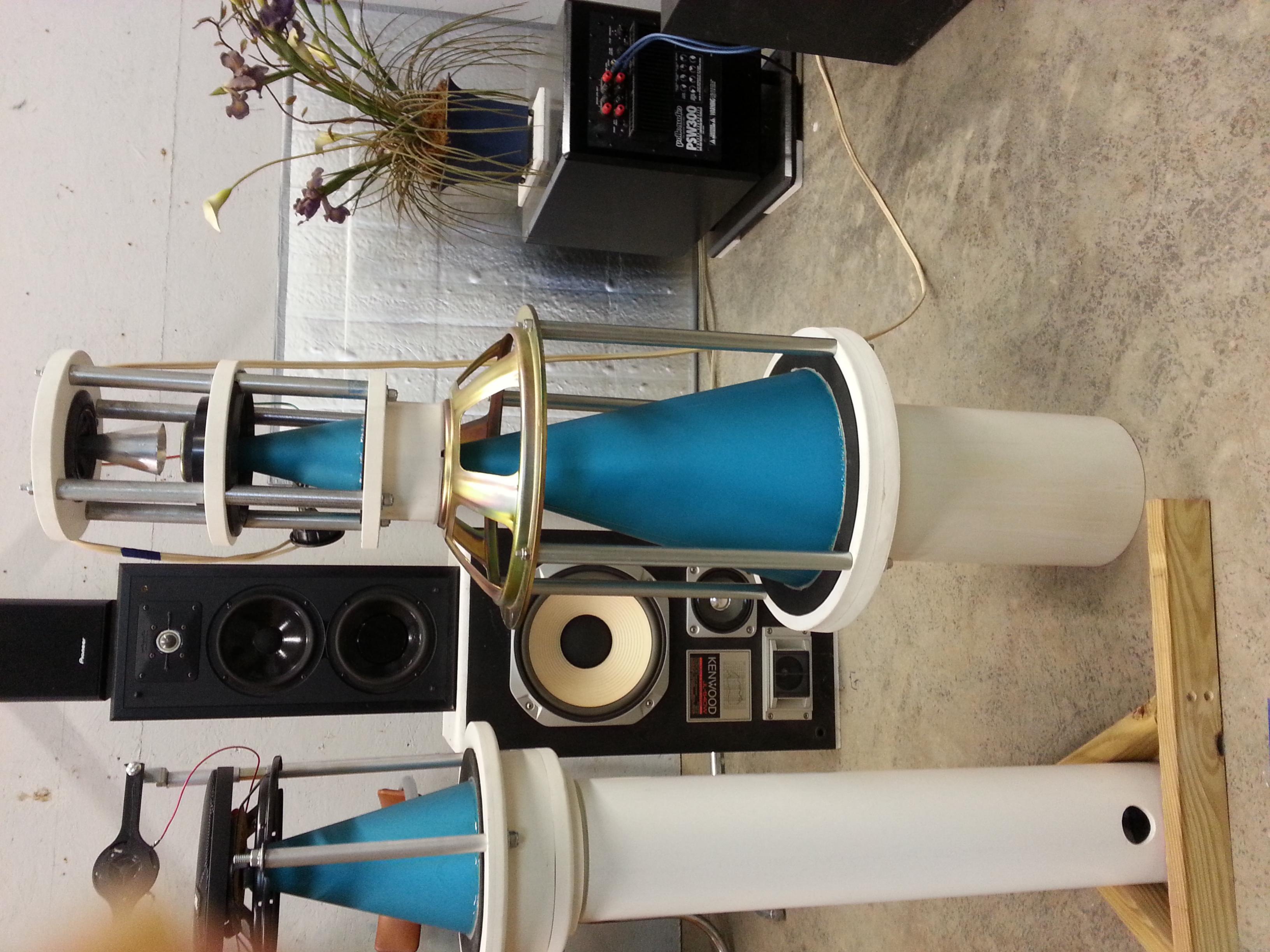

V3.5 first impressions
Returned from our biz trip to Raleigh yesterday and applied the original crossover to the fully cured units, and lit them up. Pleasant surprise, all drivers worked...
...as to how well, mixed bag...
First reaction was to adjust eq with a heavy hand; lots of high through mids, rolling off deeply on the bass. Woofers 'booming' like the bass drums of a marching band. Removed entire array from the wood 'X' supports, meant to keep it all from inadvertently toppling over, and placing directly on floor. Bass immediately tightened up. If placed on a proper enclosure, that could eliminate any need for a sub. But that is just an initial impression....
Output from the mid unit is considerably less than the V.2 units of the relative same size. I'll chalk that up to the size of the magnet structures, which are roughly a third of the V.2's. Sound from them is 'restrained' because of this, IMHO. Considerably more gain has to be applied to get them to 'speak'.
Tweeters work, but are even more restrained than the mid units. Again, I'll chalk this up to their magnet structures, which are probably fine for a typically coned 3". To get them to respond, they ask to be 'cranked up', which starts to generate heat fairly quickly. I monitor this by just placing a finger on the center backside of the magnet. You can easily feel the temp rise gradually....
Above was noted by connecting the xover individually to each element as an initial test. Attaching everything in pairs (T+M, M+W) roughly confirmed my immediate impressions.
Attaching all 3 units together, the woofers are what one hears above all. The response is still 'bassy', but is better when used without the supports. If one damps the surround manually by touch, they 'firm up'; first 'tweek' is to either add damping into the support column or adding additional material beneath the surround to absorb more movement.
Not perfect, but not 'broken in' either. As a test stand, a reasonable start...
More later as I run them more...

Current thinking on the 3.5's is I'll call the tweets and mids a 'fail'. Drivers too small to be effective. I'll keep 'the guts' around for later improvements. My current drivers blow them away with mere output...
I'll continue to goof around with the woofer, just for educational value...

Have you experimented with any paper cones? The lighter weight will make a difference in loudness and high frequency output. Try a 6" diameter paper cone.
Interesting proposal, But...
I agree with that suggestion, Gary. Perhaps the alum cone is limiting the output, esp. with the 'lightweight' magnet structure the 3.5 mids have. I've one other trick I'm going to try before that, however. Currently the cones are under a slight bit of compression, mostly to damp any potential of pistonic motion. I'm going to introduce a tad more height in the support structure to see if allowing more motion will allow more gain. The way they're constructed will actually allow this to be done rather easily. Cheap tricks is us. *L*
They're 3" dia. x 4.5" h. though; going to 6" dia. would require a major rebuild. The V.3 array of 4 that I've been running 'successfully' has 5" dia. x 7" h. cones of the 5 mil alum. If I did anything to them would be to invest in some of the 2 mil alum and mod them a pair at a time to see what occurs.
But going to paper with the 3.5's is a good call. Even if the 'shimming' works, lowering the weight of the cones can't hurt, and they have been built to be messed around with.
If that proves to be an improvement, I can see no reason to not mod the earlier V.2 pair with the larger magnet structure as well. Same size cones; another potential pseudo-surround array. *G* Large in front, smaller in rear...
Gives me a good reason to wander over to Michael's and fondle some of their paper stock. One material that comes to mind is a decent quality water-color paper; they tend to be heavier and a bit stiffer than most, and I suspect will be considerably lighter than the 5 mil.
As for the tweets, they're using the 2 mil you gifted me with. The magnets may just be too weak to adequately drive the cones. But I'll salvage the cones and see what presents itself with larger magnet structures....
The woofers exhibit some odd resonances at certain frequencies. I've been thinking about applying some of the fabric you've mentioned to the exteriors of the cones to nudge them about, a la EnABL. Can't hurt, might help. Since they're meant to be an experimental subject, I may as well get on with it.
This all may well trigger a major 'rewire' of what's driven by what around here. I'm thinking of turning the array over to being driven by the main amp, which has the extra capacity to do so. I'll just have to throttle it down so I don't torch anything...
Yep. the light weight voice coil/magnet doesn't have the cajoles to drive a heavy gauge cone. Also, a 5x7" cone has more than twice the radiating area than a 3x4.5". If you replace the 5 mil with paper it will have about 1/4 the weight.
We have an art supply here called "Blick's". I think the water-color paper is worth a try.
The thing about paper is that it is self-dampening, so you can get by without the treatments that Al foil seems to need (to reduce ringing).
Also, I think you are right about the suspension being too stiff, one place where stiff is not good🙄
You're absolutely right. *L* It's a 'basic physics moment'. 😉 It'll be relatively easy to swap the cones out since I'm not going to have to start from scratch. And forming small cones with the 5 mil is a bit of a struggle, fighting 'spring back' from the material. Paper should be a piece of cake...
I've got one magnet/coil structure hanging around with nothing planned for it. I might try using it to try forming the cone to a minimum 'tip' diameter as was mentioned earlier, just for grins. It's larger than the 3.5's mids, a 'leftover' from the V.1's that got cooked. In paper it should have a better time of it.
