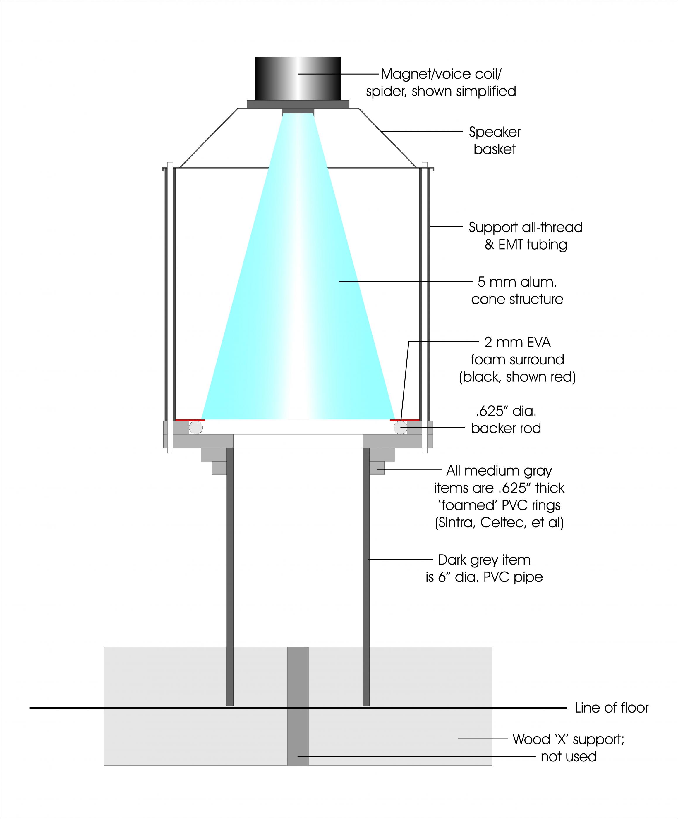

My cones are rigidly affixed top and bottom with adhesive. No fails at either end, no buzzing or mechanical noise noted by my tin ears.
The surround material is 2mm EVA foam (Darico 'Foamies', "Great for any craft project!") from Michaels, selected because it had a nice 'feel'. Doesn't compress 'twixt thumb and fingers, flexible but springs back flat, doesn't crease. Cuts easily, and available with or without adhesive on one face. I've tried both, non-adhesive version sticks well with my adhesive transfer film tape or #77 spray.
Cut into a flat ring, inner and outer diameters based on size of cone; I've been leaving a 'skirt' on the inner dia. of about .25", a space between cone and surround support inner diameter of .25" to .375" varying with the size of the cones (larger cone=larger space), and a minimum of .25" for mounting on the support structure. It's laid up essentially flat, with a slight compression to make gluing up the cone edge easier. It's a pain to have the cone shift out of center when one's trying to lay down a nice bead of glue (3M #4475; glues nearly anything to anything else, and not so unforgiving as cyanoacrylates...).
That's How, and up to now, typical.
Mags, the 'booming' I got with the 3.5 bass reduced considerably when I removed the PVC tube base from the wood base that held it all off the floor +/- 2.5". I chalked that up to 'terminating the enclosure' and eliminating the back wave coming off the interior of the cone and into the 6" pipe support. I've noticed the same effect with my other models...they 'settle down and play nice'. That back wave, if handled correctly with an appropriate sized enclosure, could provide additional bass reinforcement...which is likely what Ohm currently does, and was certainly done with the F's and A's.
The one thing I've tried since is to insert under the surround a foam ring of .625" backer rod (yep, the stuff used to fill cracks before applying caulk; I keep it around because I use it periodically, and NO, I'm NOT going to apply it to self Anywhere....that's not funny...😉 ) to try to provide additional damping under the cone's bottom edge....
It worked...somewhat... It seems to have brought out some harmonics that exhibit themselves with certain frequencies. This perhaps could be the price paid for trying damp pistonic motion brought about from the larger cone's base diameter. These motions 'hit bottom', and some reflect back up the cone to varying degrees.
Actually, I kind of expected 'something' to occur with these larger cones; it was a matter of 'what', to be followed by 'well, whatd'ya want to try' to see what happens. I'd like to find the 'magic diameter' (they ya' go, Gary *G*) where the break between wave to piston occurs. That will instruct me as to the next Version's cone size. Coupling that to mo' beefy mag/vc motors ought to be a good combination for further refinements.
Let me 'colorize' my drawing that I posted earlier, and include the backer foam to show what's where and how. A picture worth 1K words, which I've likely already surpassed....*L*
OK, here's the Real Thang.
Bass unit drawing...for scaling purposes, the EMT supports are 11.5" tall. Actual height of the 6" dia. pipe is 12.75"....
I already see something I want to correct IRL. The backer rod should be placed directly under the bottom edge of the cone. If it's 'off center' the way it shows here, the cone is still able to move vertically. I'll just add another rod of appropo diameter to 'shim' the larger rod over. We'll see what occurs with that routine....

Hi Jerry. Yeah, that's how I thought you constructed the proto. I was just focusing on whether (or not) the 2mm EVA foam surround was [constricting] the cone movement too much. Seems like vertical movement would be good, but not so in horizontal? I've never tried that method of termination.

Well, you want that pistonic motion, that's your bass freqs. What you are describing [sounds] like either 1/4 wave "tube" resonance, or the cone itself resonating. I made a large cone (9 in.) and at certain freqs went into "bell-mode", you could see the sine waves as they traced their way around the perimeter of the cone (no surround). It sounded like a flag flapping in the wind.:xeye:

There's vertical movement, to be sure...I'm just playing about with levels of control to see what occurs. The glue @ the perimeter of the cone base ( a nominal 1/8" bead) locks it down to the surround, so there's no horizontal movement at all. I took care in ensuring that the cone is centered on the surround, for the sake of precision, all that...
Resonance surely could be coming into play here as well; good call. 😉 The size of the cone is such that it could be asserting itself...earlier versions are smaller, so the frequency would be higher and not so noticeable. I've really got to 'get serious', stick the mic up to them and feed some sweeps into the input. That would give me/us a better handle on what's going on.

Tangential movement, agreed, is a Good Thing, yes. The amount being expressed at the lower edge is likely being damped by the EVA. I've noticed that, if I place thumb and forefinger on the cones under drive and move them vertically, it acts like a physical eq. Cute parlor trick. This is one effect that moves me to find the level on the cone where the shift from longitudinal and tangential takes place. That's where I'd like to define the height/diameter of any further cone sizes to 'damp @ the sweet spot'. I'm still more interested in turning lower bass frequencies over to something conventional, and let the cone 'sing' in the range it seem more suited to.

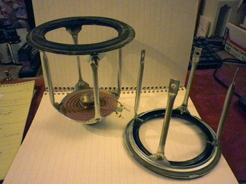

As far as the surround thing, I always was saving that for last. There are so many different ways to skin that cat.
Actually, I always used the surround that was on the speaker that was sacrificed. That is, I jacked up the motor with struts attached to the original mounting ring and up to the magnet assembly. Then, the new cone was transplanted in place. That's probably the best case scenario for a cheap and dirty proto.
