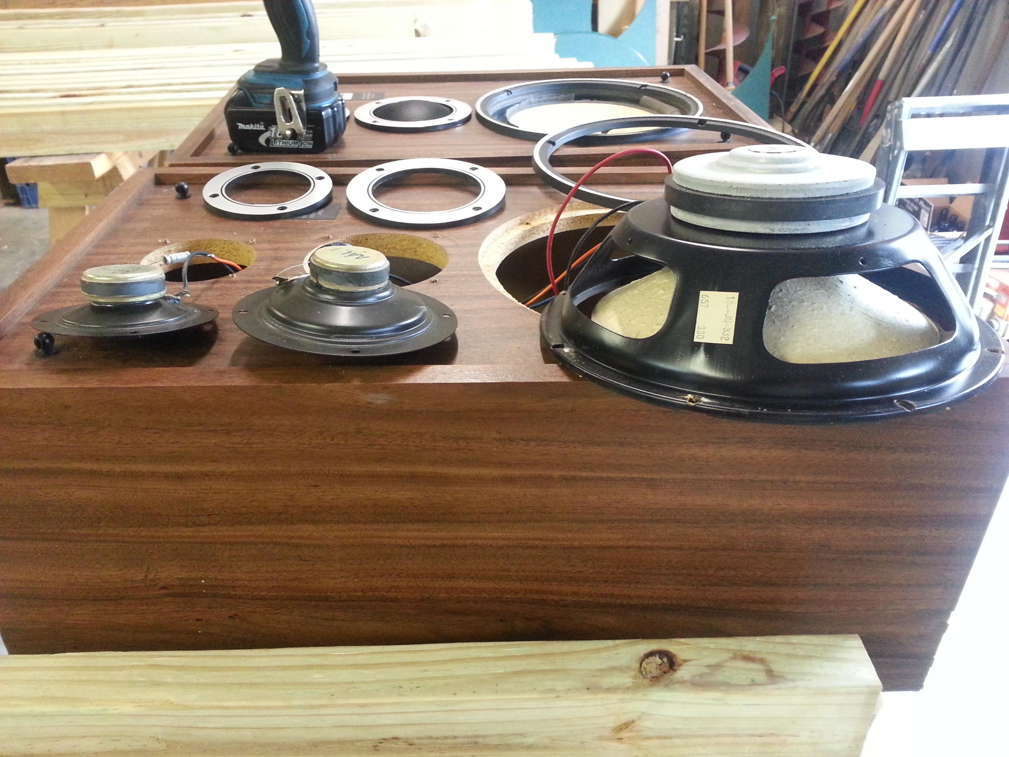

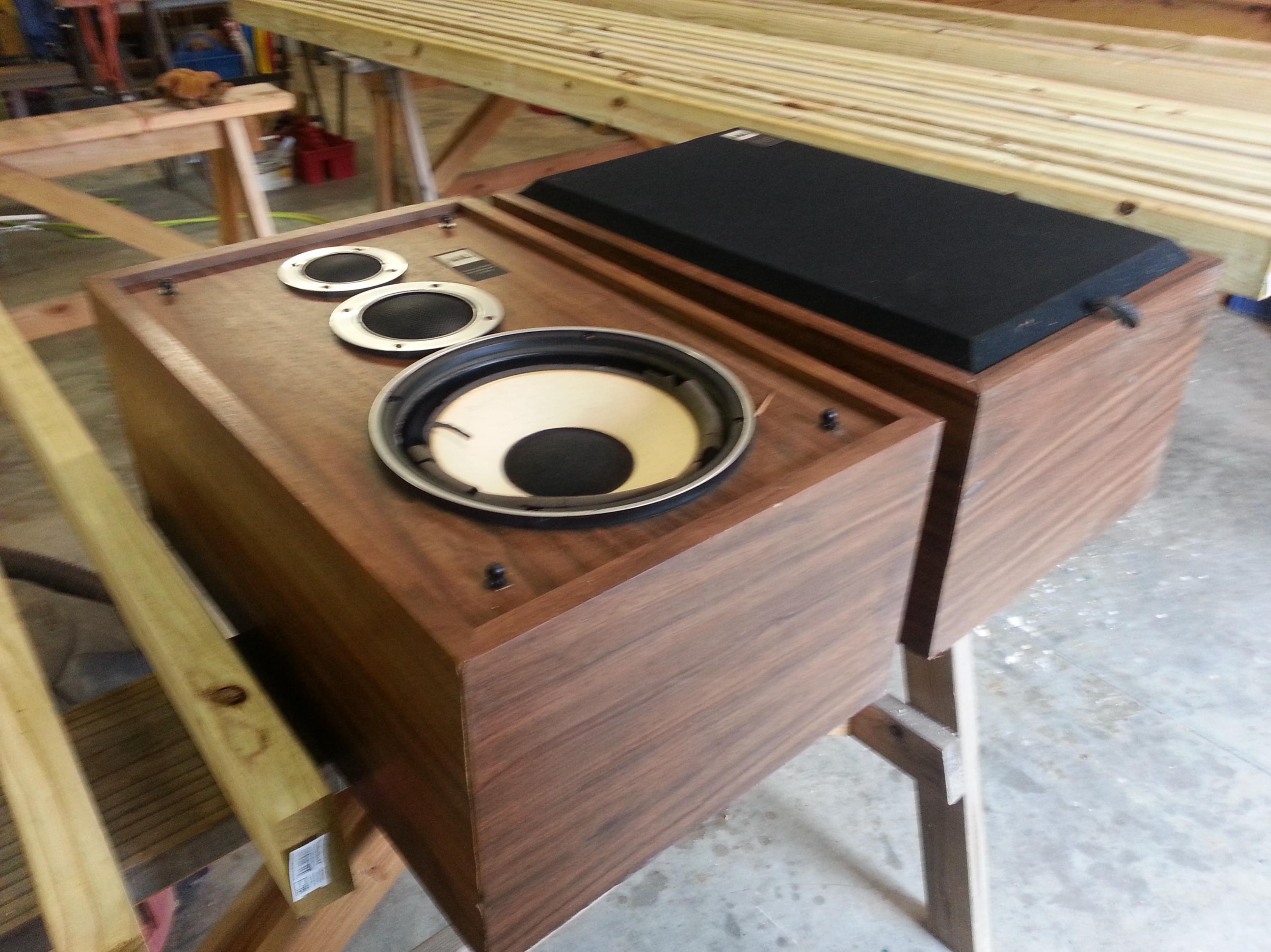

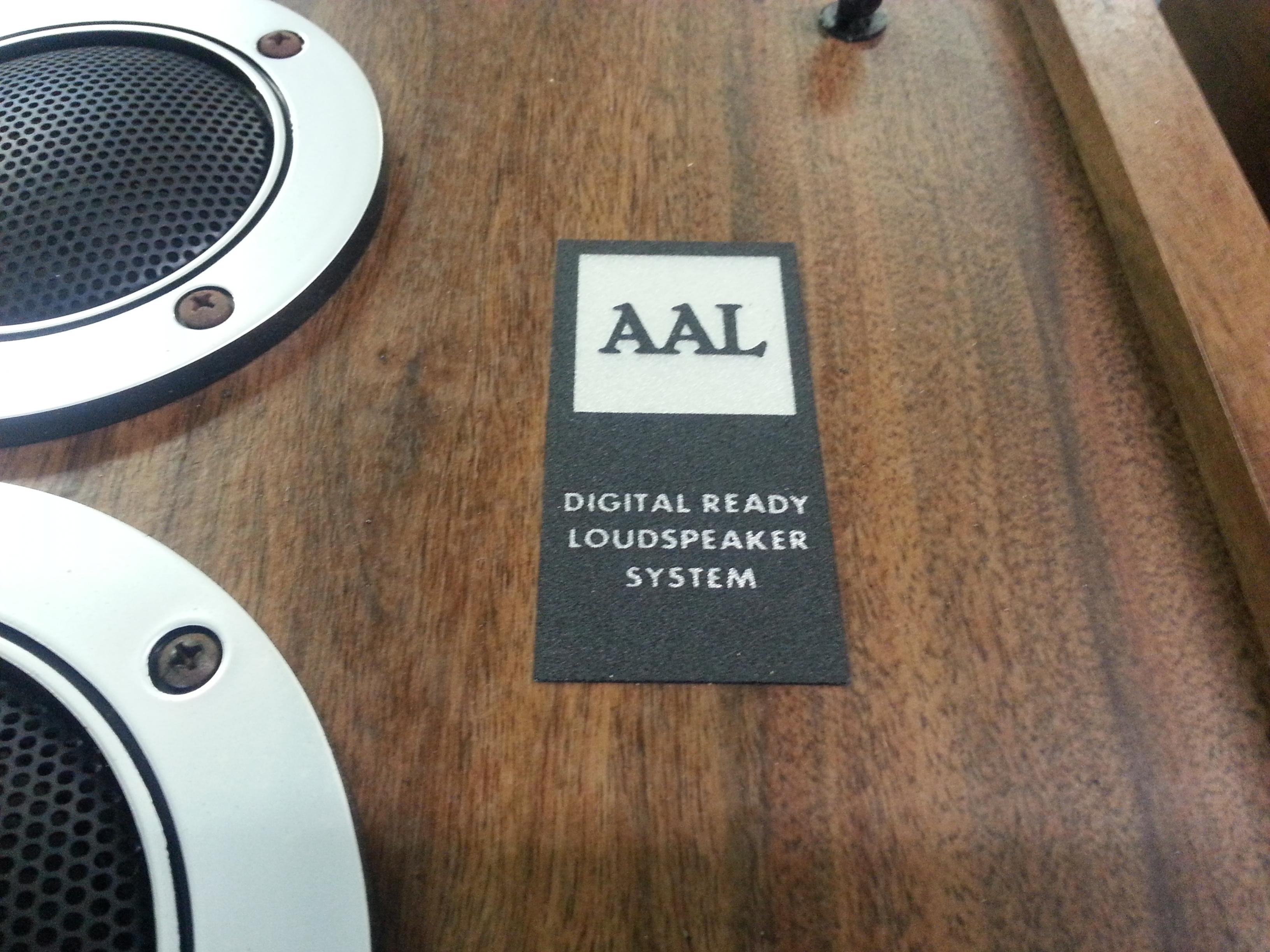

A pair of AAL model 2000, purchased today @ Habitat for $16.05. AAL was apparently a 'B' line from MTX, made for Best Buy and the rental furniture market. Claims made that they can handle 'lots of power'. We'll see about that...and as for 'Digital Ready'....well, aren't we all....😉

Just my kind of trash. *L* 8" woofers, 3.5" mids, 2.5" tweets, capacitor xovers. Fresh meat....

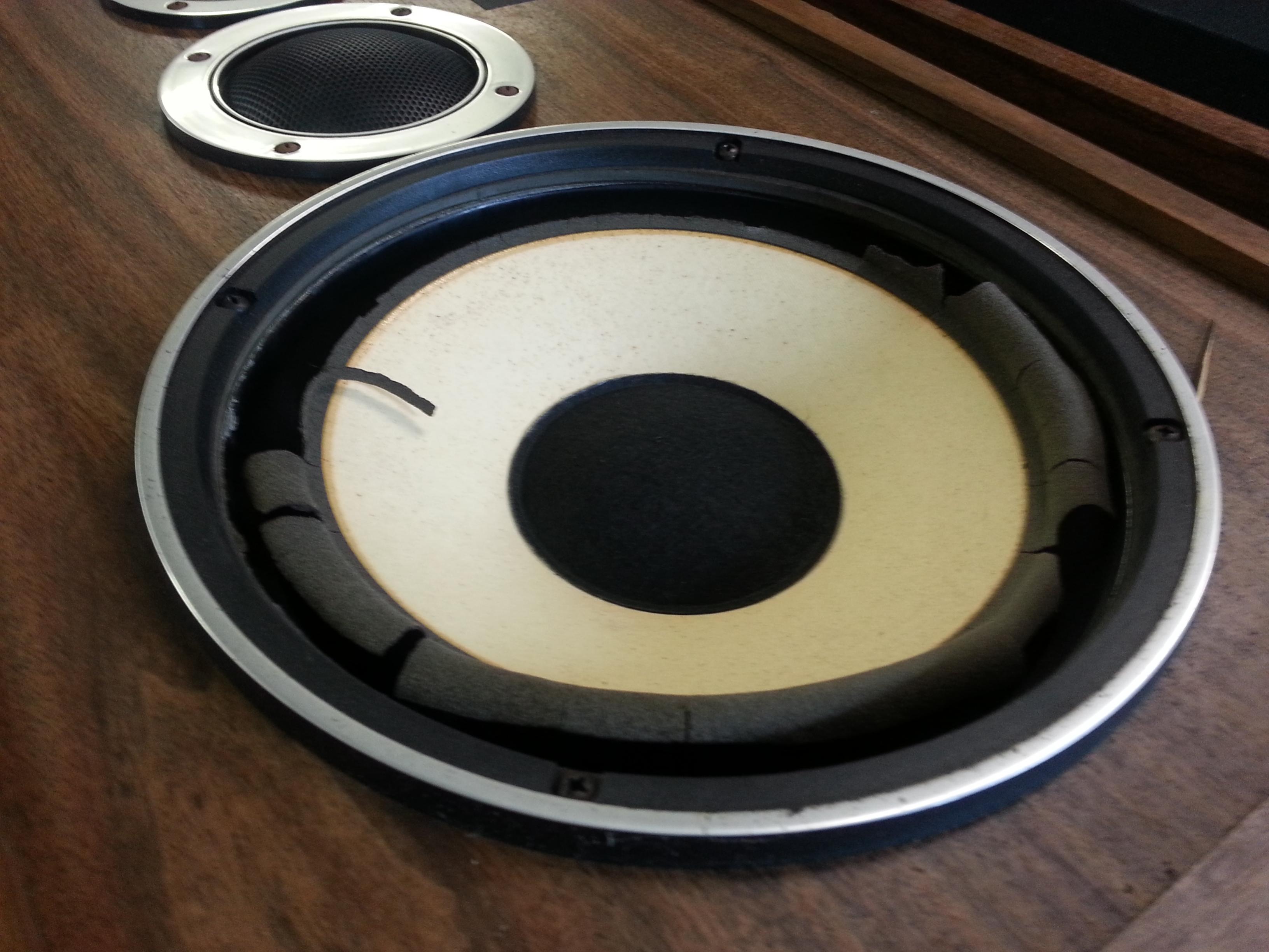

Woofers have decent sized magnet iron, as well as the typical foam rot. 5mil alum cones, because I still have a lot of it. Tweets and mids, not so much iron; but since they're destined to receive 2mil alum and paper cones respectively (following a suggestion), they might just be able to be interesting on some level....

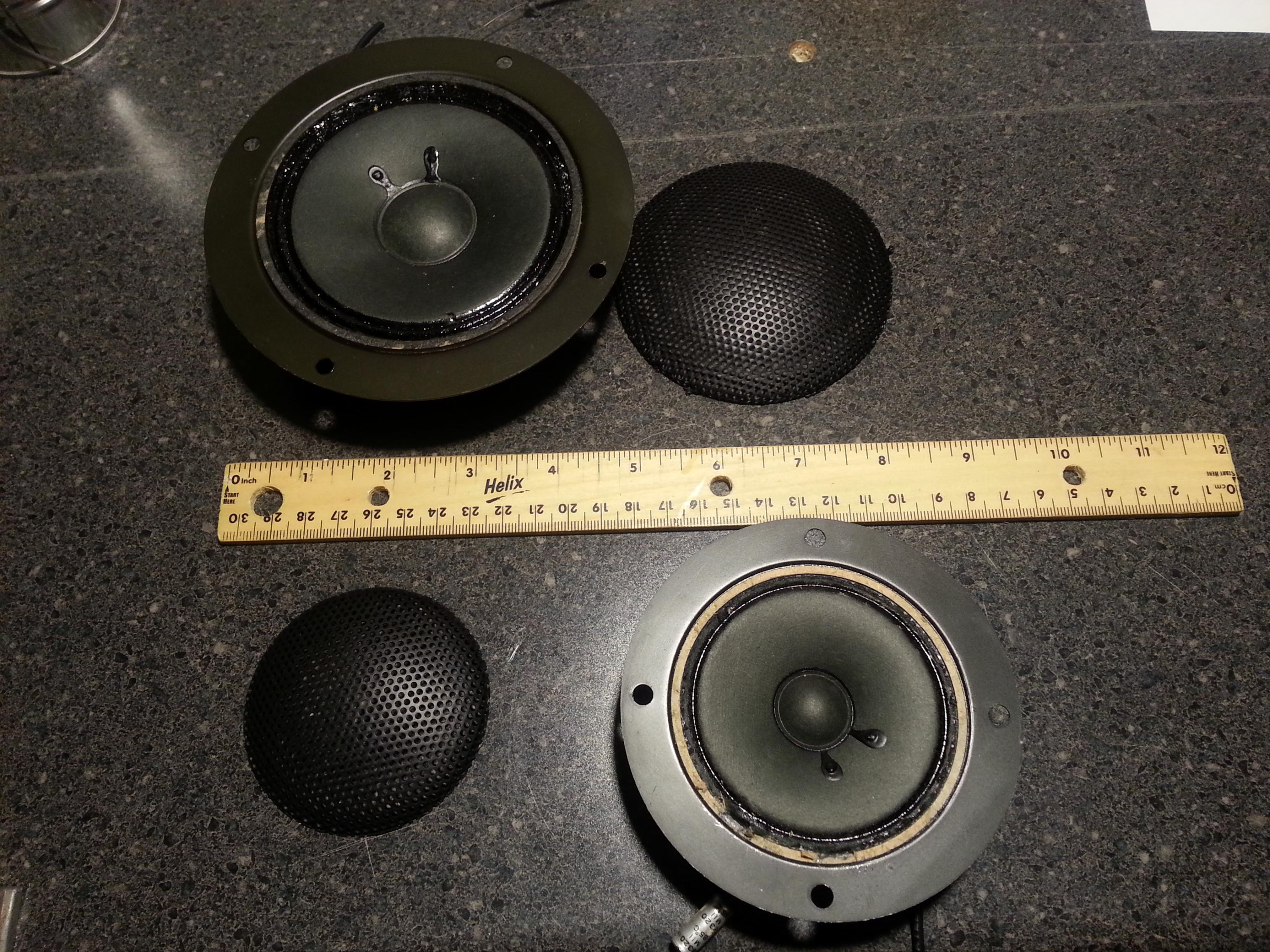

Popping the hoods of the tweets and mids, we find them whole with no rot. Nice, but that won't change their fate. The screens, undented, seem to be aluminum instead of plastic. They'll make nice 'heat sinks' for the magnets if they'll perform their 'new trick' properly...
Magnet structures on both are the same size, interestingly enough. Larger than the V3.5's failed tweets, smaller than the 3.5 mids which are destined to receive paper cones in lieu of the current alums.
Decision: What we'll go for is 4 new tweets; 2 w/2mil alum recycled cones, 2 w/paper cones. Voice coil diameters are 1" on the mids, 3/4" on the tweets, measured at the dust caps. We'll give the 3/4" the paper, the 1" the alum.

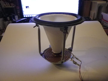

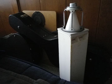

I'm listening to my little brand-new walsh. I installed a 1.3g paper cone in that frame that I posted. I'll give more info on it after I get some shut-eye. It has good efficiency, and the highs and mids are nice. Just plain-ole light-weight drawing paper off a roll. 🙂
I like simple, and simple sounds good, too. No foam treatment, basically a regular speaker.
Well here it is all fleshed out. No issues, nice freq range, no buzzes. very good SPL, keeps up with my Tang.
I've missed the Walsh coherent micro detail. Listening to Eva Cassidy, what a babe! Hope I get to jam with her some day.

IfIf I understood the Argument correctly I don't think you shOuld be seeing any "horizontal" movement at the base. All of that should be taking place at the very top an experiment you could try would be to play sines above 5khz and slide your finger wacross the cone. Same and opposite for below 700 hz
Magnasanti, the only issue I'm having right now is; the paper strength could be a little better. Perhaps a paper incorporating some high tensile fibers would work. One would want the cone to track the voice coil radially without much waveform distortion. Right now I'm right at the limit of that. 😉
Ok now its an argument good.. I hope we come to an understanding. I was mainly replying to Jerry when he said "Tangential movement, agreed, is a Good Thing, yes. The amount being expressed at the lower edge is likely being damped by the EVA". I was thinking that was wrong since the "horizontal" or bending or whatever would be focused around the top third of the cone not the bottom now if you played only sines above 5khz lets say for argument the main vibrations should from this argument be focused in the said section. on the other hand lower frequencies like 700 and below should be shifted to the lower half and this would in fact not be horizontal but longitudinal and pistonic in nature. I dont have a walsh driver so maybe you guys could see if I am right?
Honestly they sell chopped fibers both carbon and glass. Maybe if your not conformable making a cone from a sheet maybe you can simply paste the chopped strands like a hi-end adult paper mache project.
You and I must be reading different things I may not have a good source. But from a logical point the tangential waves would manifest at the stiffest part in that case it would be at the voice coil end not the base which is highly complaint in comparison?
