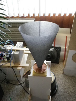

here's one I'M PROUD OF... made it four years ago.......carbon fiber

Re #441 pic...."and if it doesn't work, it can always be a vase for flowers..." *LOL*
Now, that's pretty large. You don't run the AC behind it when it's operating, right? 😉
OK, the 'hard' question: Does it work Well? It would seem without some termination at the base that it work exhibit some sort of 'strangeness'. It would be interesting to subject it to a strobe to see what low frequencies do to the base edge....see what sort of 'flexion' is going on, say @ 40hz.
It sounded great! Over 90dB. The best thing is that you could step on it and it would pop back without harm 😕

BOT (back on topic), I took a speaker that I bought for $0.99 from PE, snipped it with my straights, punched a few holes in some AL tubing, added somes bolts/nuts...well, the cone took some practice and a little trig...BUT, it seriously sounds great, I've been listening for hours now.

I think your seeing my line of thought I was on at that time. In short, I was pursuing alternate pathways. But at the same time making a good sounding cone that could be practically fabricated. I know for a DIY'er that is a wide playing field. 🙂
The factor was mainly surface area w/respect to SPL. The surround becomes needed to control the perimeter of the cone base at high drive levels.
The carbon cone was durable, until I dropped it one day and it shattered like a glass vase.
