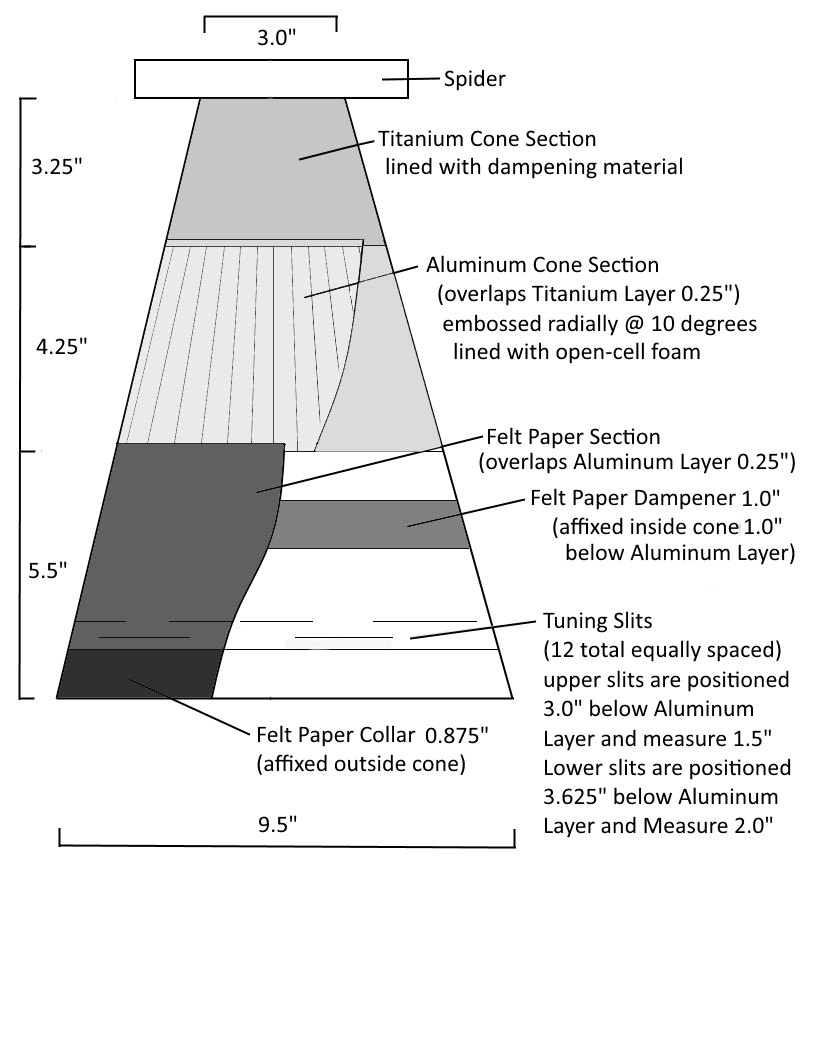

This has been a fascinating thread to follow! Thanks to all. I don't know if any DIY folks would be interested in a rough drawing I made of the original F drivers. I have really seen any detailed descriptions of how the cone is constructed.

Ohm F D, thanks for your supportive comment and the nicely detailed jpg of the F cone details. Any and all constructive commentary and information adds to the pool that is under inspection and consideration. I think I can speak for the regulars that hang out here that we're fascinated by the Walsh concept, and are doing what we can do to recreate that for our personal enjoyment. *G* Please feel free and comfortable to join in....
...and *damn* that cone was complicated! It's no wonder that HHR is pricey for repairing/rejuvenating them.... not a simple object, no....
I knew by photos that there was a lot going on at the cone's interior, but the extent is still surprising...
Hey Ohm, where/how did you come upon this detailed of information, if I might ask? Former fabricator of them? Found this bit of arcana squirrelled away? Did an analysis of a moribund cone while the owner wasn't looking? *G* Curious minds ask curious questions... 😉
Interesting....taking these dimensions and doing a little bit of extrapolation, I get a 'base diameter' for the titanium cone of 4.625", and 6.875" for the aluminum....
If these dimensions have any significance to material used vs. frequency range...considering the previous line of reasoning of having the material matched to the frequency range to be radiated/created (metal to paper as a 'physical crossover' for the bass frequencies, tangential/pistonic motion)...
Titanium for the high(er) frequencies, alum for the mids to upper base +/-....a physical '3 way' full range radiator...perhaps?
Anybody feel like poking holes in that conjecture? *L*

Ohm drawings
I just pulled mine out and measured it 😉
Seriously, it was time to check the condition of the interior foam (which is in a rather advance state of decay).
I think what makes the cone interesting is the decreasing mass of the materials - titanium @283 lbs/ft2, aluminum @169 lbs/ft2, and paper @60 lbs/ft2. I haven't really seen details on the GP cone (titanium or carbon fiber) and wonder if the behavior is similar (with one material). From what I've read, the type and positioning of the dampening material is critical. I don't really know what the material used on the titanium is (as described before, it does look like clay but it is hard).
I wish that my smaller wattage tube amps were able to drive them to their comfort zone.
Fabricating Ohm cones
Jerryrigged, I have read that these cones were originally constructed on Walsh's kitchen table (along with other prototypes) and a 30 degree angle was agreed to be most effective. All you need is a 30 degree mandrel (wood, ceramic, etc) and you would have the template (similar to the inlow sound horn pattern). One time I saw a 3 foot tall wooden spire at a furniture store that had a 30 degree taper. I think the bottom was around 18". With something like that, your finished cone could be any size you want depending on the section used. Positioning and layering would be much easier, sort of like a seamstress with a mannequin.
Another interesting note is that the dampening material used on the titanium section extends 2/3 the way up (from the 3" VC), at that point the remaining 1/3 is covered by the open-cell foam which continues to the aluminum/paper inner seam.

Philajoe73, the decreasing mass IMHO makes sense if one was attempting to create a full-range driver of that scale. As Cochleus noted, even a smaller cone has the surface area of a 10" speaker. I haven't 'run the numbers', but I suspect an F cone is approaching an 18~24" typ. driver, which is massive.
That, and as a waveform is descending the surface of the cone, it should be losing energy as it's being 'stretched' by the increasing circumference. It would follow that one would want the mass of the material to decrease to allow that wave to continue to 'flow'...or that's my take on it...
The damping materials were obviously carefully chosen, and the placement ditto. Likely to control 'ringing', harmonics, and the other plethora that cones of any sort are subject to. Since we're considering a rather steep cone profile, and one made even partly made of metal(s), I wouldn't be surprised if 'bell modes' are in there as well, further complicating the thing.
And as for 'kitchen tables', I wouldn't be surprised by that. *L* The patent states that there were prototypes made and displayed as 'proof of concept', typical for the patent process. HHR uses wood mandrels...me? I've got a plaster cone for smaller ones, and a larger foam one from Michael's that is virtually the same angle. It's used for floral displays and the like....and cheap. *L*
As for laying up 'cone on cone', it's just me reacting to the scale. That, and doing it pre- or post application of the damping materials is a question. It's just difficult as 'ell to do what I've doing without sweating damaging damping...

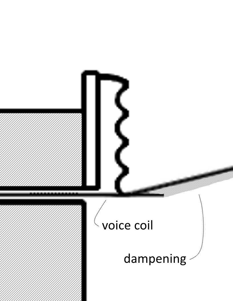

Hard Dampening Material
Upon further inspection, I can see a very small piece of this material has flaked off and it is clear that it serves as a filler at the joint of the merging angles of the cone and VC. See attached (quick) drawing. I looked for it and thought I might send it post so you could have it analyzed, but to no avail. BTW, I don't recall if it was mentioned, but the VC looks like titanium as well.
Jerryrigged, I do treat these two with TLC and despite what I mentioned about the listening levels, that was just me pining for the past. They still sound good on my 14w WE monoblocs. 😀

The surround on the GP unit looks like a 'U' shape, a 'flipped' version of what we see on a conventional surround. I wonder if there's anything beneath it, augmenting it's action(s)...
Good analysis, Coch...the patent claims that the wave is traveling at a supersonic velocity, at which coherency would be maintained on the face of the cone since it's so short. Even on an 'F' or 'A' cone, the distance is essentially nil. It might begin to lose coherency on the proposed 6' tall 'stadium' versions, but I suspect that even then it would take a Very Sharp set of ears to discern that...

A titanium vc form would actually make good sense. You'd get heat transfer into the upper cone to some degree, at the risk of adhesive deterioration at the intersection.
And making titanium cones would almost guarantee 'drops' of material; made sense to utilize it, and why not for the vc? Nice quick sketch, too.
