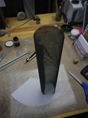

It shattered....? Like a dropped light bulb, or just cracked as would an egg? I can see where lacquer would cause that latter to occur. And by 'carbon veil', you're referring to that material that you included in your 'care package' to me?
The lightness of that first combination is intriguing. I'm assuming a spray application...
Yes, cracked like an egg, but around the whole circumference near the apex.
Even though carbon fiber has high tensile strength it is very brittle. The speaker was dropped, landed magnet first naturally, and the impact shatter the cone. 😱
Same stuff I sent you as a sample. I think I still have three yards of it.
It was tricky to coat with lacquer since it is so porous. Ended up laying it flat on wax paper and brushing over it. It was much easier to laminate on paper, using the same technique.

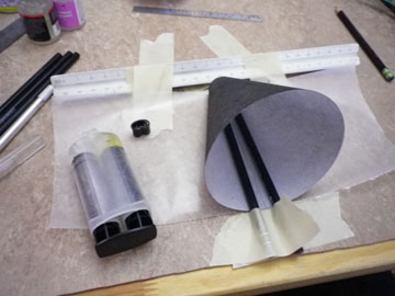

Some pics... IMGP0994.jpg seaming a small carbon fiber veil/paper cone. Bottom pic is the raw materials.

After the lacquer coat...did your form it while wet, or after it dried? The second seems more reasonable, but I'd think the lacquer would make it stiff. That would explain the brittleness...
Forming wet, however, could degenerate into a sticky mess rather abruptly. Laminating the paper seems a good alternative....and eliminates the 'shatter factor'. *G*
Starting a new p.g. installation tomorrow, so my projects go on hold for awhile. I'll look over your shoulder, if you don't mind posting the process. *S* Always good to see alternatives, different approaches.
For the lacquer to adhere to the carbon fiber it has to dry completely. This took about a day or so because the lacquer is trapped below the carbon fiber matrix. Plus, I used "brushing lacquer", which has a "retardant" to extend drying time.
Laminating with paper was a much easier method because the paper absorbs the lacquer. This made application and drying easier. A better end product resulted being smoother, more durable, and easier to form into a cone. This version weighed 10 mg cm-2, only 25% more.
Spraying the lacquer would probably be a better method, once you perfected it.

I have some 5 mil rice paper called "masa rice". The drafting vellums are what I used for backing the carbon fiber veil. One is 1 mil and the other is a cotton 2 mil called "clear print". Both worked good.
The resin (lacquer) will then about double the weight. Thought about more advanced methods like vapor deposition (polymethyl methacrylate).
The carbon fiber veil weighs nothing...floats down like a feather when you drop it...
