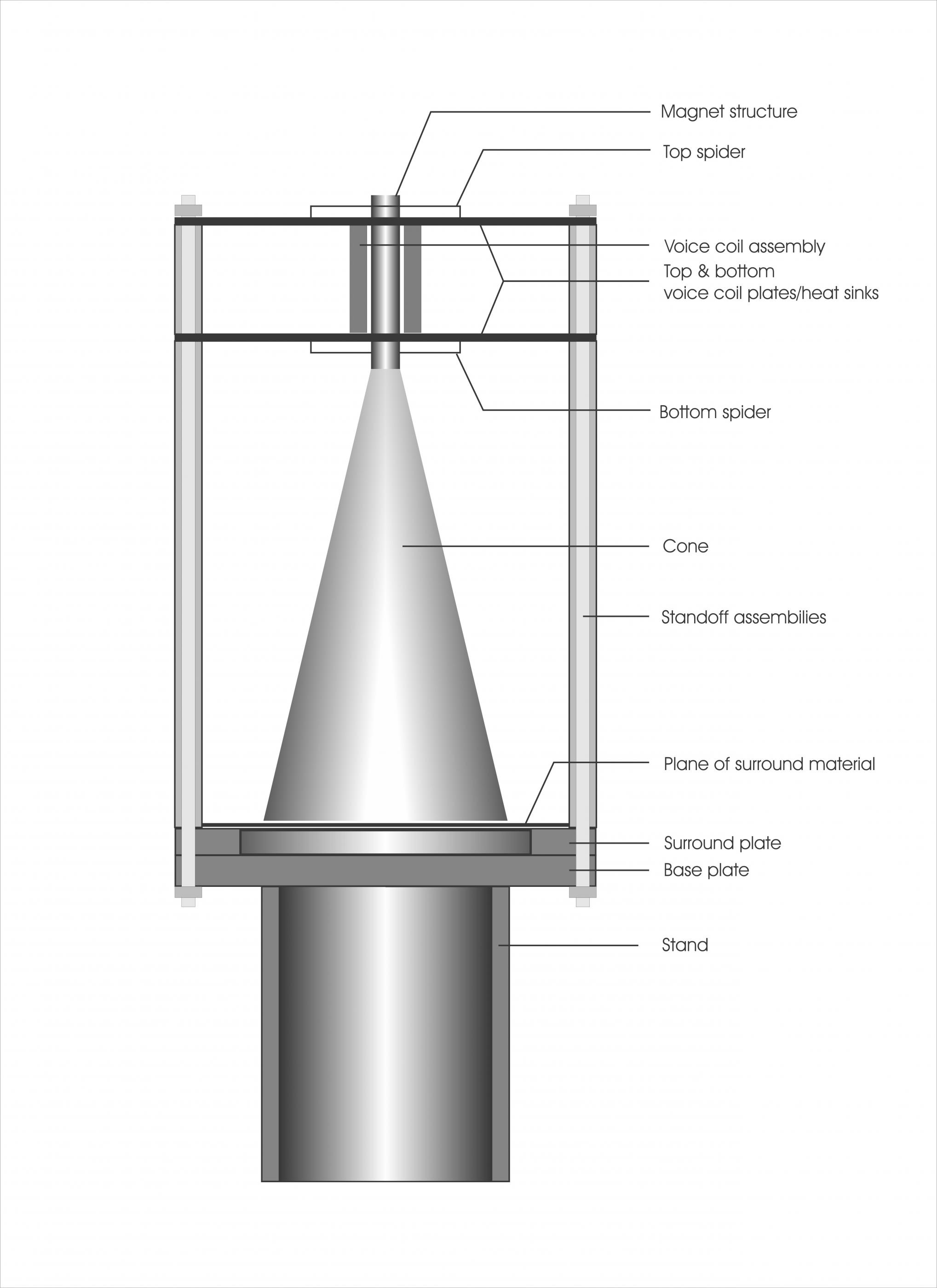

I do. I actually got to hear them. They were, as is noted, phenomenal. They were also fragile as eggs and, like the original Ohms, 'victims' of the current technology of the time. But what popped into my greyed matter literally just in the past hour was the way the bass stack was driven. The 'rod array' drove the stacked diaphragms, it was just mesmerizing to watch it....
...and it occurred to me...could a cone be driven by a single rod? What if you 'flip' the equation, and make the voice coil the magnet? The magnet is within a coil, 'spidered' top and bottom. The cone could be tapered to a diameter small enough to eliminate the need for a 'tweeter' of any sort. And as for the bass...well, I'm still of a mind to let a conventional woofer deal down there....
Make the whole cone out of carbon fiber or titanium. Making that 'birthday cake' layered cone makes my head hurt, and I've not even tried to make one. *L*
Anyway...poke holes in that conjecture...tell me I should stop taking drugs, or do different ones. *LOL* It just seems too obvious to have not been tried.
Even if you had to run a bias current to light it up, like your ML's...how crazy is that? :headbash:
Yeah, I thought about that too. But there's the practicality of the physical connection twixt cone and driven element, and how tightly you could make the apex of the cone. That's something I've run into with my 5 mil aluminum; the apex overlap is the area that's hardest to keep together, due to 'spring back' of the material....
And I think there's the 'law of diminishing returns' in there...anything from that narrow portion of the cone might go supersonic, and only impress your dog. *L*

Wild hair/hare? moment....
Speaking of pretty...
Mags, BTB...(Sorry, got distracted by visions...*G*)...re your #345 (nice, consecutive numbers....SEE!? *L*)
Yeah, this would have a simplicity that borders on blatant. *L* Easier to cool from the get-go, as the plates above and below the coil could be aluminum that could 'hard attach' to the coil former. And lots of air around it, instead of being buried in the structure. I think the physics involved would work...it's just a linear motor after all, and they're not that uncommon. In this case, it would simply be restrained by the spiders top & bottom. And given a large enough coil and rare earth magnets, you could probably use it to drive nails. *L* Exciting a cone ought to be a piece of cake....
*Shrug* Like I've posted...Someone poke some holes in this. It just seems too easy, and anytime I hear or read about anything 'easy' (remember cold fusion?), I get suspicious and the BS Detector goes off....
...and I don't like the idea that it's coming from Me. *L*
Yeah, that's a problem that gets worse the smaller one goes with the apex. Your right there. Possibly the apex could be fabricated some other way and then mated to the cone later.
I decided a few days ago that my next cone would be driven in this fashion, just to see what transpires... :smash:
(Oh, there you are....*L*) Hi...
Cool, that will be a interesting test to run. With the 2 mil alum, you should be able to form the apex tighter than I can currently. Attachment to the vc might be problematic...unless you try using a piezo or something dinky, you'll have to dream up some sort of 'vc plug' to mate the cone to....*shrug*
For the 'V.X' concept, I was thinking along the lines of the way a router bit is secured into a router's collet. A tapered cone into a tapered receiver, with a matching tapered plug into the center of the cone. One could almost 'hot swap' the cones, if one could make the surround do the relative same thing....
