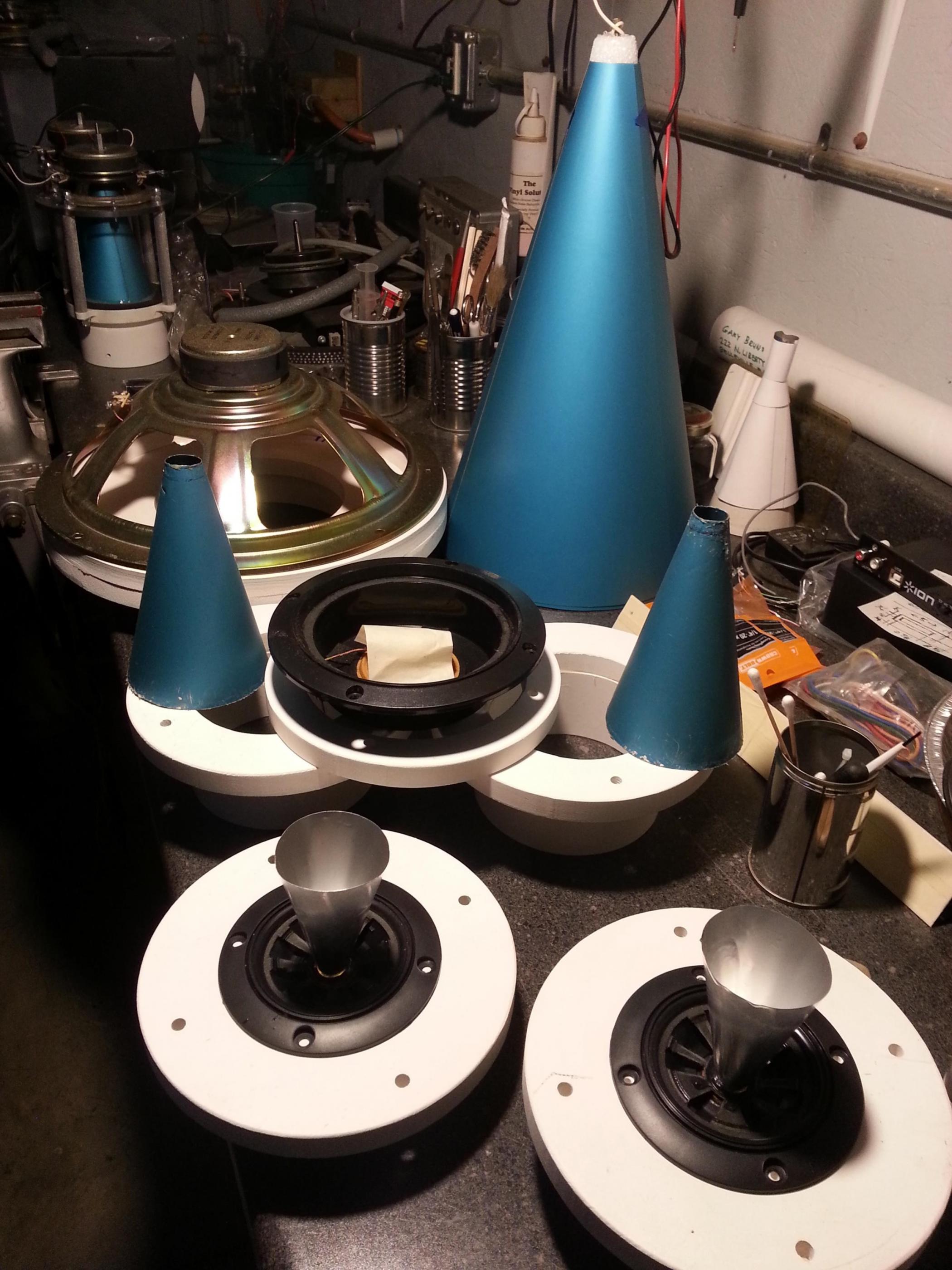

Structural parts for V3.5 (or V.4, I've been calling it both) have finally been completed...on to cutting hardware to size, cutting and applying surrounds, and assembly.
Hopefully sooner than later should get to see if my 2nd take on a Walsh tweet based on the Infinity 'ice cream cone' works properly, and a large scale driver using a 'previously' 10" woofer driving a 9" dia. cone. The latter ought to be interesting; since the original Ohm A physically 'crossed over' to a paper cone from aluminum @ a 7 1/2" +/- dia., I'm wondering if it'll exhibit pistonic motion despite the rather stiff surrounds I apply...or will it manage to create some upper bass response in a dml fashion typical for the rest of the cone. I do expect the voice coil to warm up from this adventure, we'll see how long it can handle the strain, even though the unit has a higher wattage rating.
This might be a 'test to destruct' affair, depending on how it sounds, anyway. Fortunately, the balance of the array is physically independent from it, not 'hard attached' to the larger structure below it.

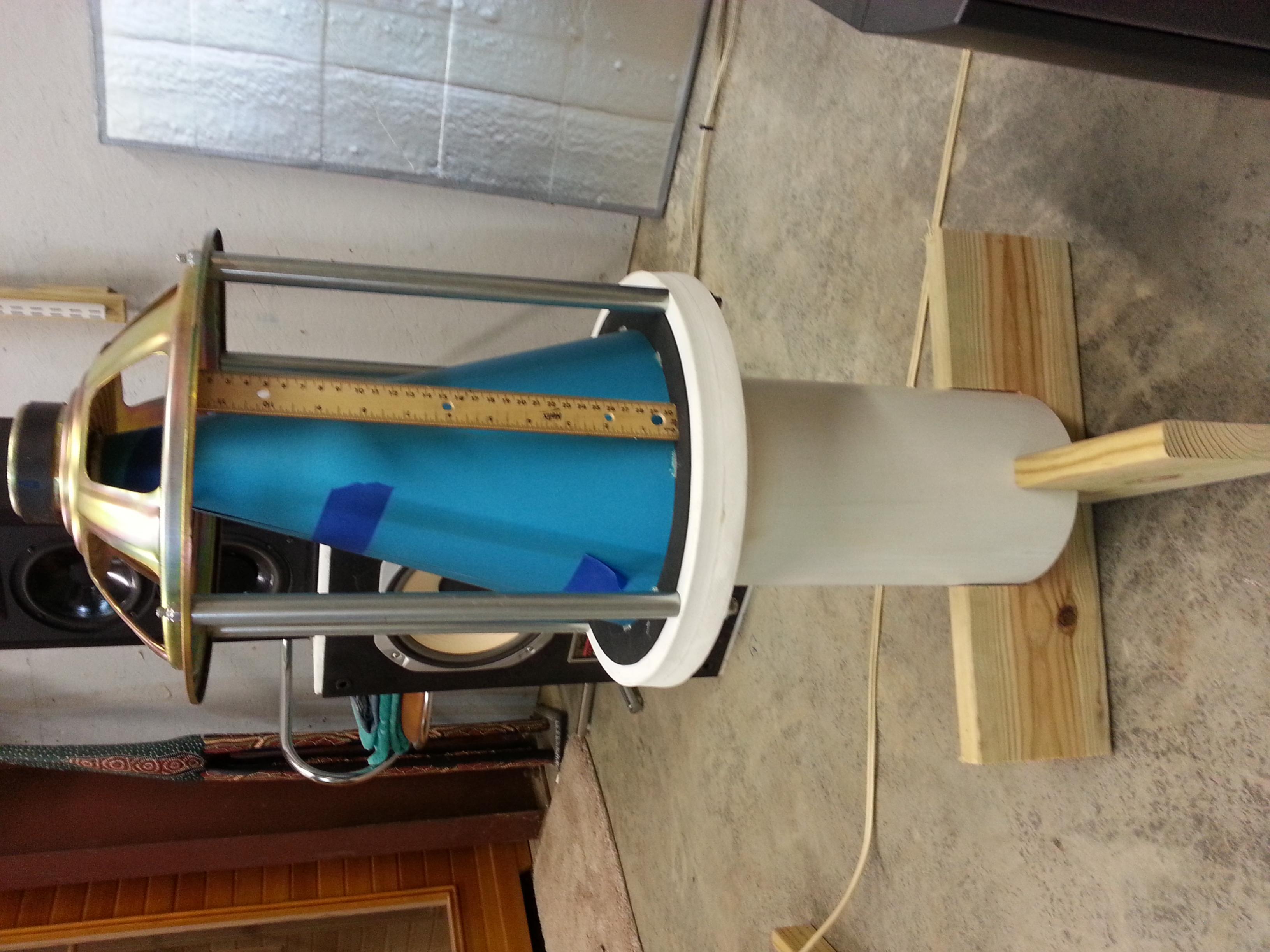

Anyway...parts pic attached, hope it displays properly upside right...
Looking good
I love and dread the building process. I know I will end up with a superior product and thus sound, but boy is it tedious and frustrating. I am looking forward to measurements, listening impressions and maybe a recording that I know will not do it justice.

Jer- your stuff looks phenomenal! I notice you may be dabbling with Walsh tweeters. If I may I'd like to offer a few suggestions if you haven't already thought about it.
A Donut of felt applied to the front of the driver body will help discourage diffraction near the base of the "cone".
There needs to be some sort of termination at the large end of the cone. This will help stabilize the cone, help control weird radial contortions around the periphery, and finally terminate the line to prevent reflections back the the voice coil.
We (and Infinity) used a NON magnetic dowel adhered to the center pole piece that was about as long as the cone. The old Seas mid tweeter we used had a hole in the center of the pole piece that we tapped, then used threaded aluminum rod to couple the dowel and secured it with epoxy.
We protected the gap from filings and glue with masking tape. When we removed the tape, we used a bit of cardboard with masking tape folded over it sticky side out to clear any bits of shavings.
Earlier versions used Dacron to fill the void inside the cone to absorb radiation from the back of the "cone" and thus prevent interference with the opposite side. It was simply gently stuffed inside.
Infinity later used urethane foam, possibly cut to fit, and possibly glued to the cone to fill the void. This was also the termination. Problem is, urethane oxidizes over time and turns into a powdery crud.
My suggestion is to stack increasingly larger felt "donuts" up the center rod that don't actually touch the cone. This would absorb the inside energy reflections and cavity resonances.
Lastly, top it off with a disk of relatively dense packing foam, maybe 1'4" thick cut at the angle of the cone along it's edge and gently pressed into place. That black stuff- This would be the termination.

Glo, thanks and thanks for the suggestions. Initially, I'm going to go with, quote "Lastly, top it off with a disk of relatively dense packing foam, maybe 1'4" thick cut at the angle of the cone along it's edge and gently pressed into place. That black stuff- This would be the termination." The mounting of the tweets will allow me to add/subtract various 'routines', such as you've suggested, to see what might occur. The previous attempt had a 'core' of an ordinary plastic straw. A dab of glue within the tip allowed it to be placed on the center pole without hazarding the vc gap...and the price was right at the time. *G* More sophisticated refinements will follow with more sophisticated observations of what hath been wrought by this ham-handler. 😉

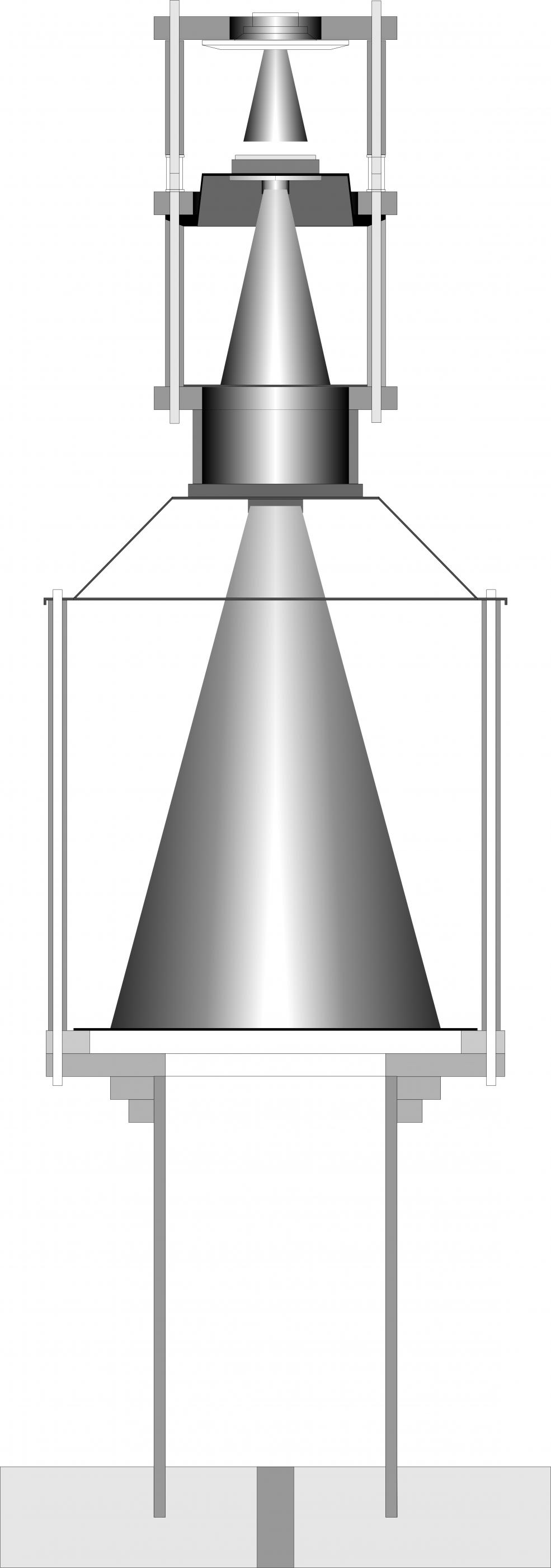

BTB. here's a drawing of the concept...half section views, half WYSIWYG, typical for my drawing style for things of this and most natures. Allows me to work out details, resolve kinks, etc. Height just under 43". Upper tweet and mid mid-range sit atop the woof, base of mid surrounds the magnet of the woof but is separate. If the woof don't woof nice, I still have the remaining to run tweet tests with....

Ambitious, perhaps. It's certainly has had a long 'gestation period'... And actually more of a test bed for the tweeter and some construction detailing on individual segments.
The tweeter @ top will be able to be removed by just removing 4 nuts. In this way I can apply/try different 'routines', such as suggested by Glo, to see what effects occur. Hopefully this can be done in a non-destructive/'swappable' fashion, as it's made from the 2 mil alum that you graciously donated. 😉 That's the idea, anyway...
The 'midrange' at the center is similar to what I've done previously, just adapted to the physical details of the co-opted driver (plastic basket vs. metal). It'll just sit on the woofer's frame with some foam applied to damp any vibrations, as the magnet fits within the mids base. A lucky occurrence...
The lower 'woofer' is an excursion into finding out 'where' the cone transits from a dml to pistonic excitation as frequency descends. The base is made purposely to allow reducing the diameter of the cone by inserting 'shim rings' beneath the cone, which can be reduced in diameter and receive a smaller diameter surround. This obviously will reduce it's height; the posts can be cut down to accommodate this.
The cones will all align vertically, so that more or less addresses 'time alignment'. The cone's profiles are all the same (small up, big down), which hopefully will allow the radiation patterns to more or less 'blend/overlap'. I can't get them any closer together vertically, so I'll see if this works. A 'sonic layer cake', if you will... My earlier test of 'flipping' the top unit (much like the Ikonoklast units) didn't work IMHO, so here's my 'go' at it.

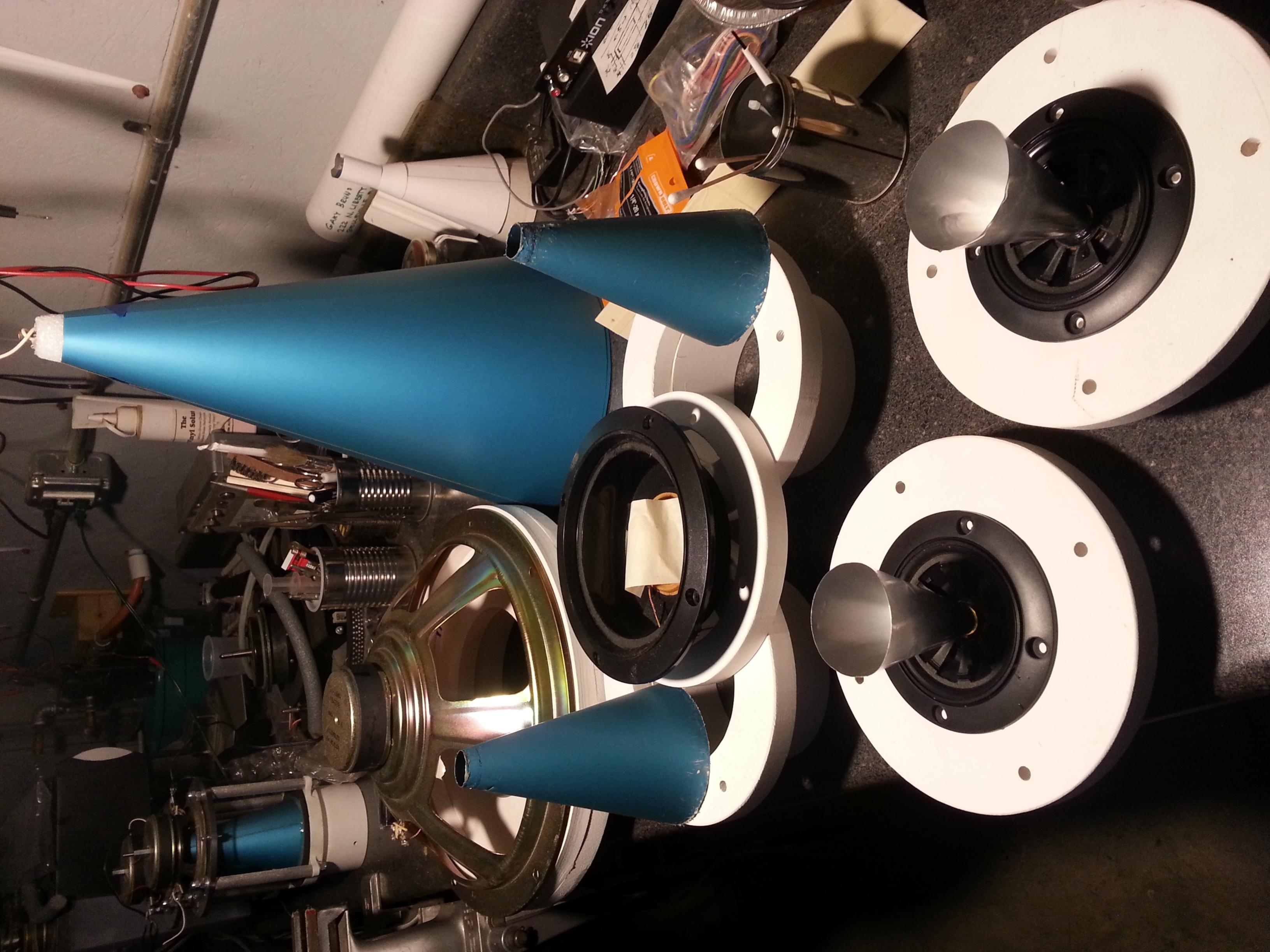

What to do on a 6/4 weekend.
Assemble the V3.5 bass units, that's what...
Due to the size, they (there's 2) were actually easier to put together than a smaller unit. There's room for fingers to fit without bumping into something else...*G* You can see the foot ruler in the pic.
At this point, they're being glued at the surrounds and the voice coils. The 4475 needs 24 hours to cure completely, so patience becomes a necessity as well as a virtue. The tweets are essentially done; the mids' posts need a bit of shaping at their top ends before they can be assembled and enter into the 'adhesion cycle' (i.e., application of more patience).
The goal is to complete assembly prior to leaving Tuesday 7/7 for a business 'overnight speed tour' to Fayetteville and the Raleigh area for some deliveries and minor installs. By my return (Thursday-ish), everything should be cured and ready for hook-up and 'first voice'.
...and then we'll see what hath been wrought...
Might be a good idea to glue some felt or something inside the basket ribs (spokes) to discourage reflections back the the cone.
