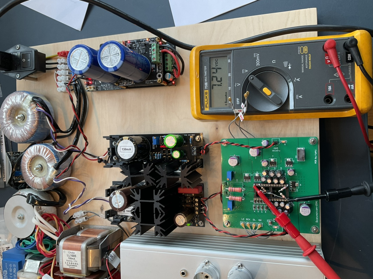

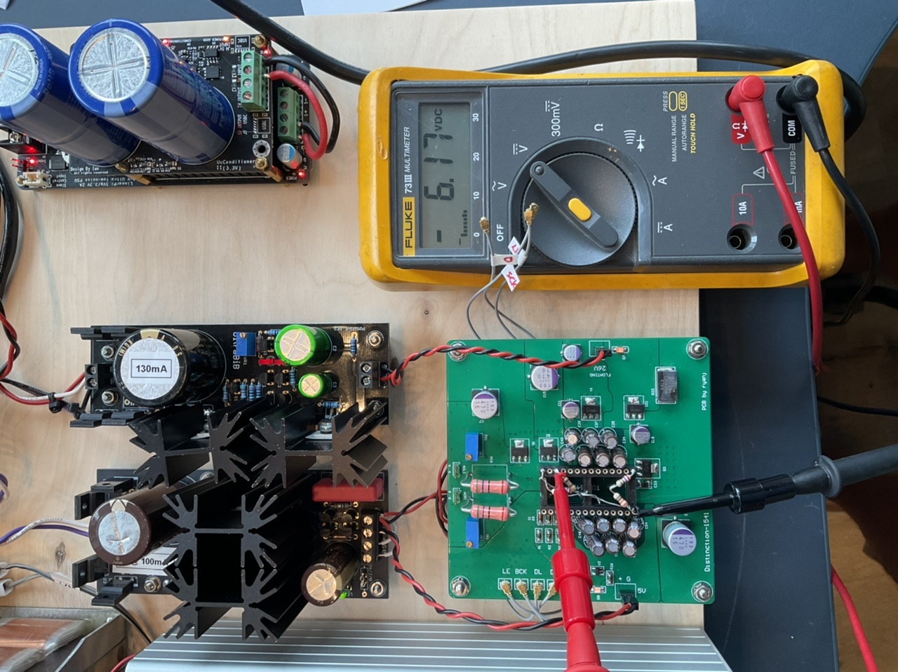

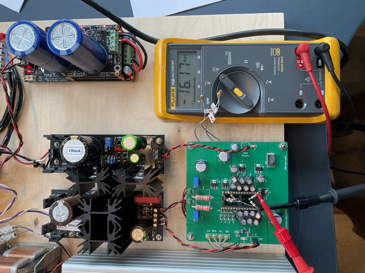

I see I made a mistake of measuring referenced to -26v pin I measured again, see attached pictures.
Pin 15=-16,17v
Pin 26=-6,17v
Pin 28=7,24v
The input voltage from the Salas regulator is 27,05v
There was no output stage, only iv resistor, input from your i2s-pcm board.
Power supplies are all isolated. (Also separate transformer windings)
Is there a defective ps component in your view? How can the voltages be adjusted to be within dac limits?

The +5V and -5V final regulation circuits look suspect. Perhaps X1 and X2 (TL431) are faulty. That can be checked by measuring the voltage drop across R20 and R25. They should measure 2.5V (Vref for TL431) if the TL431 are working.
The TL431 in SMD package are easily damaged by too much heat during soldering. I know from personal experience.
Supersurfer,
Im leaning towards solder joint issues on X1 and X2. X3 looks like its working.
First thing I would do is use some flux and reflow the pins on X1 and X2 and all the resistors connected.
Yes that has done it! I think bad solderings got loose due to heat during operation. I resoldered x1 and x2 and all voltages are correct again.
