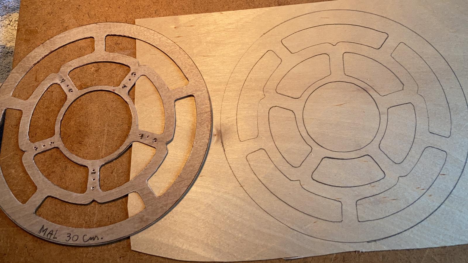

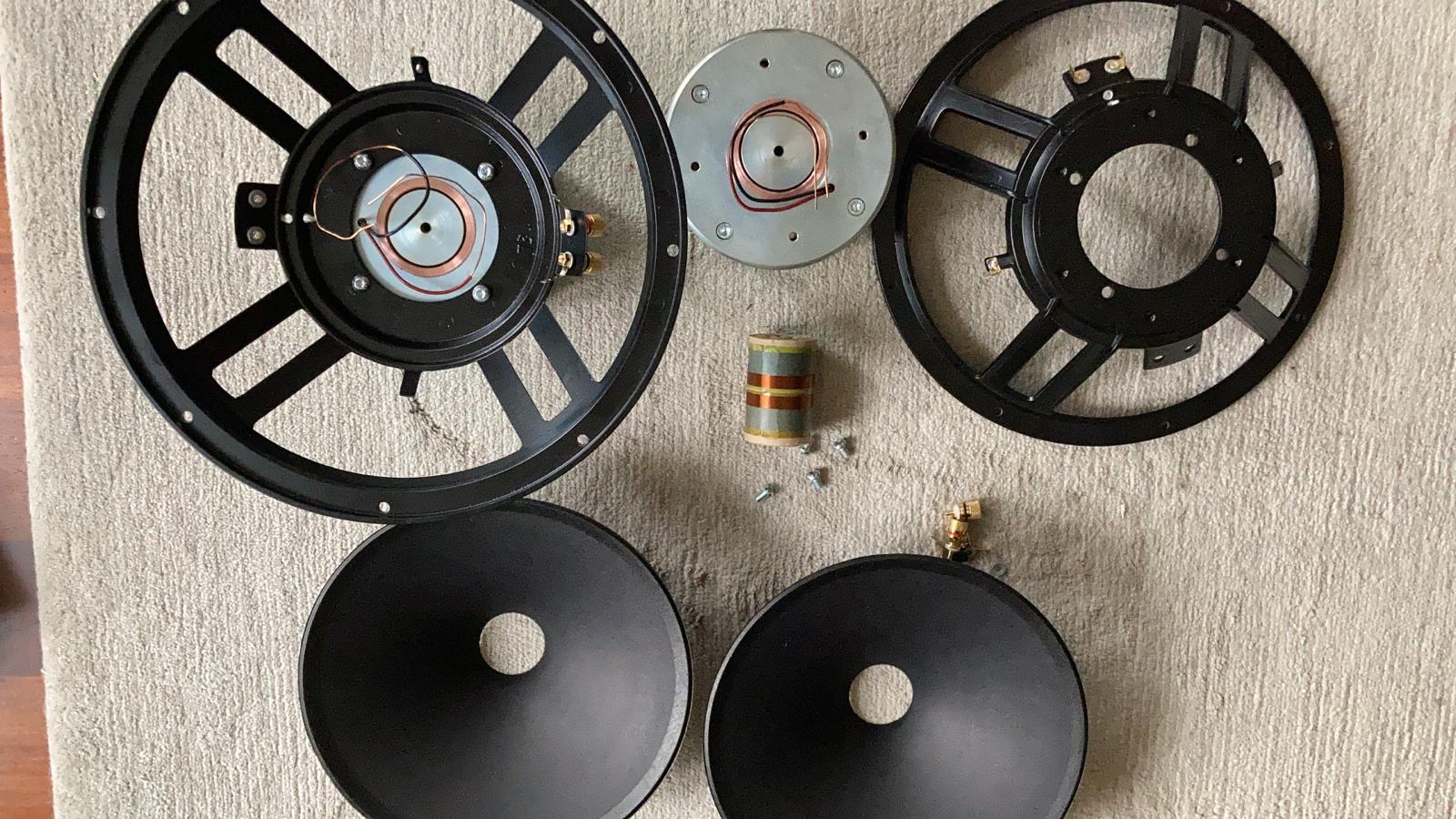

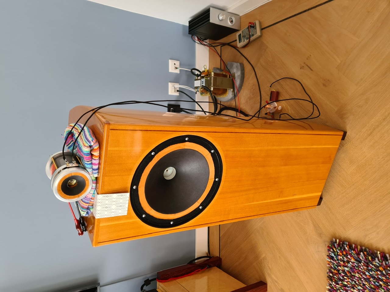

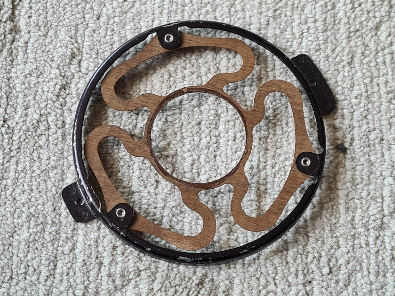

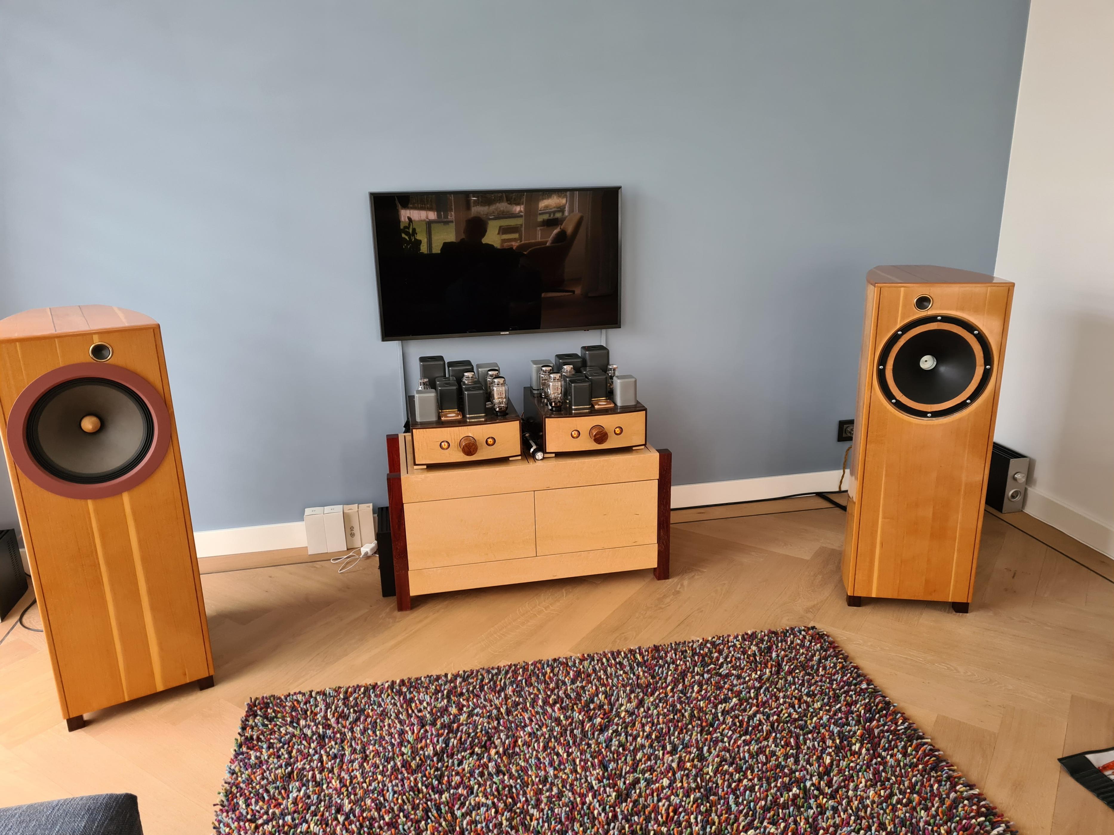

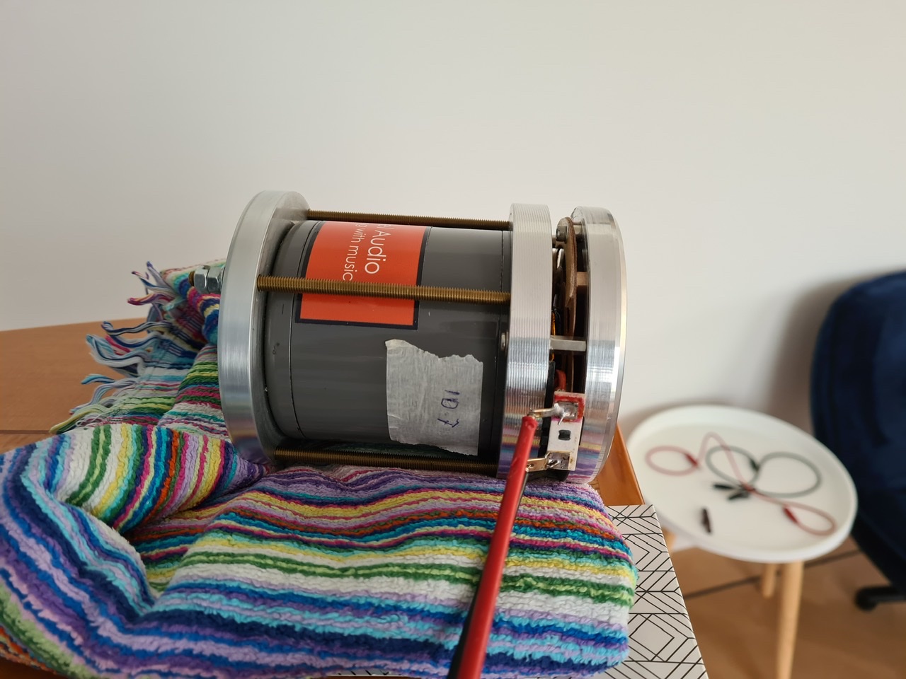

The other project is a field coil tweeter modified with a wooden spider and leather surround, to accompany my 12” field coil with same modification in an open baffle (folded baffle in fact) cabinet. The results are very promising!

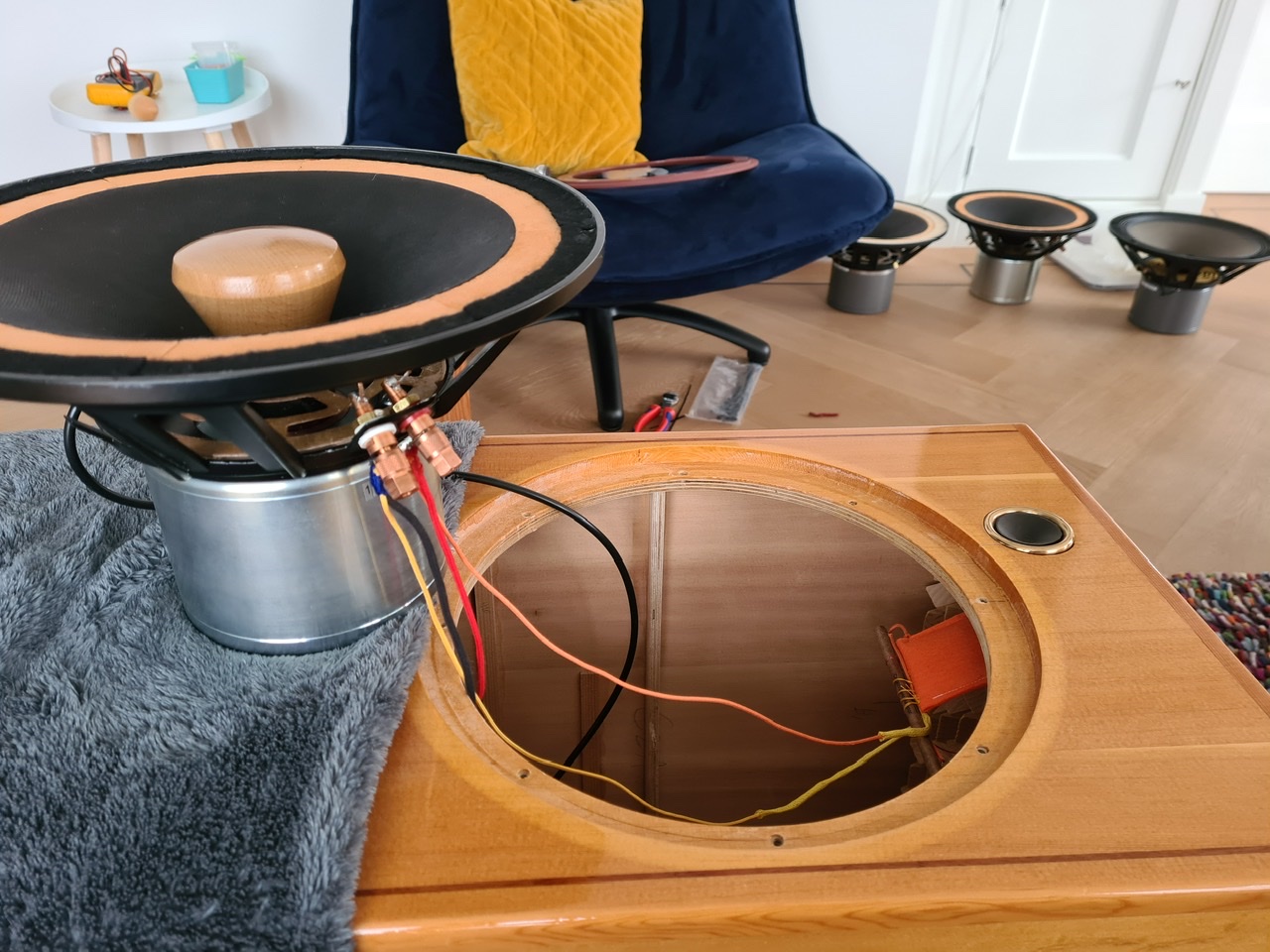

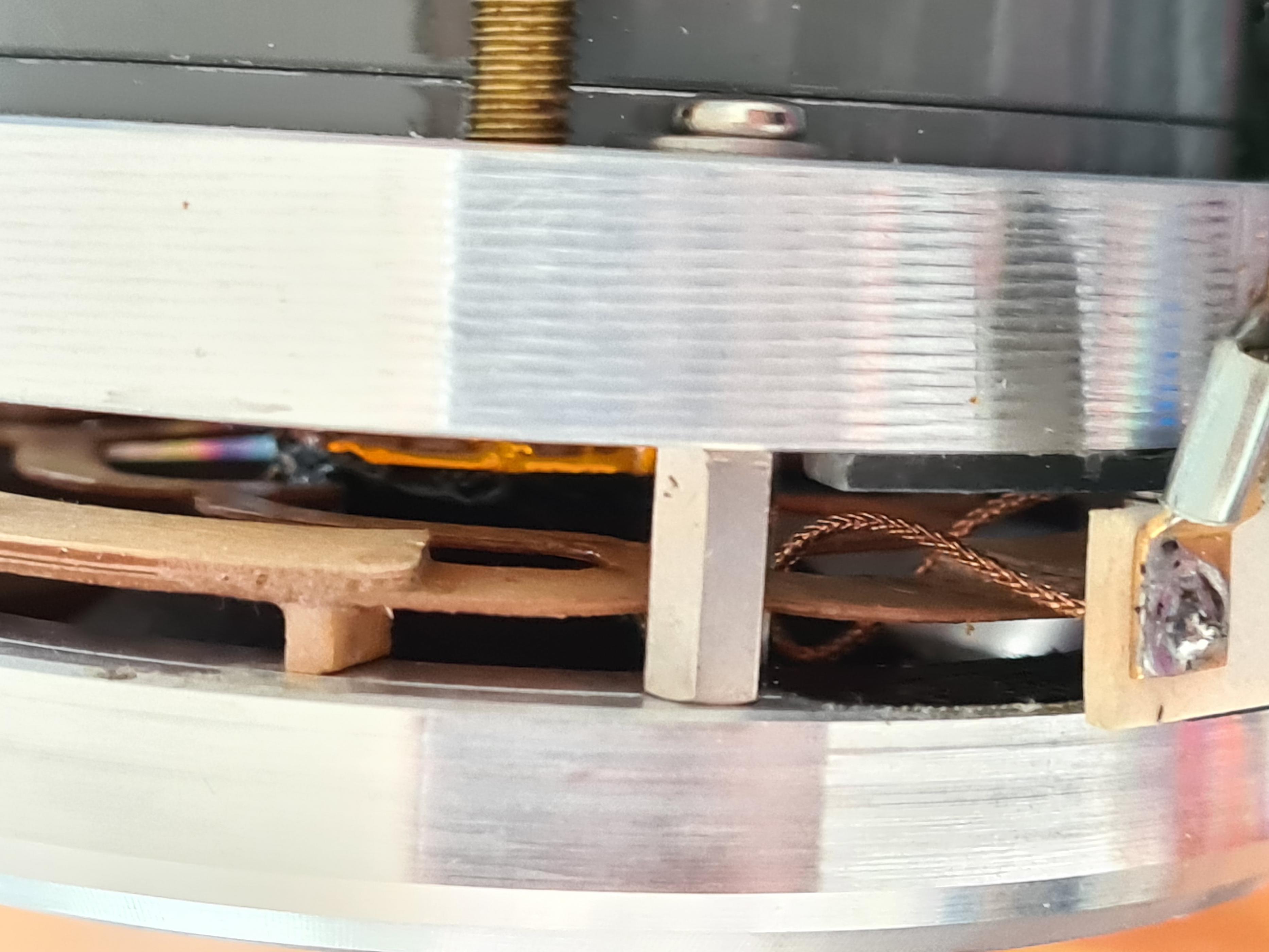

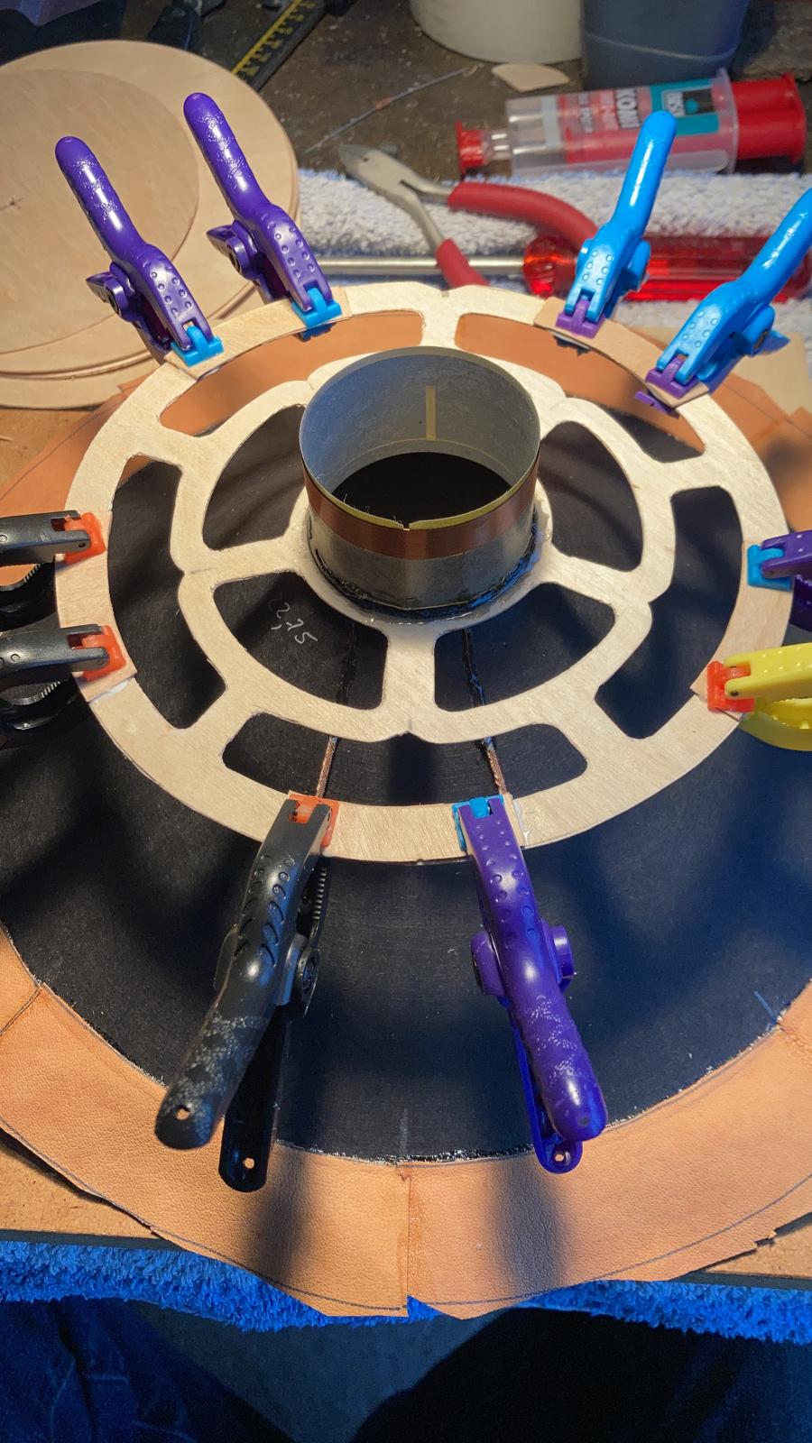

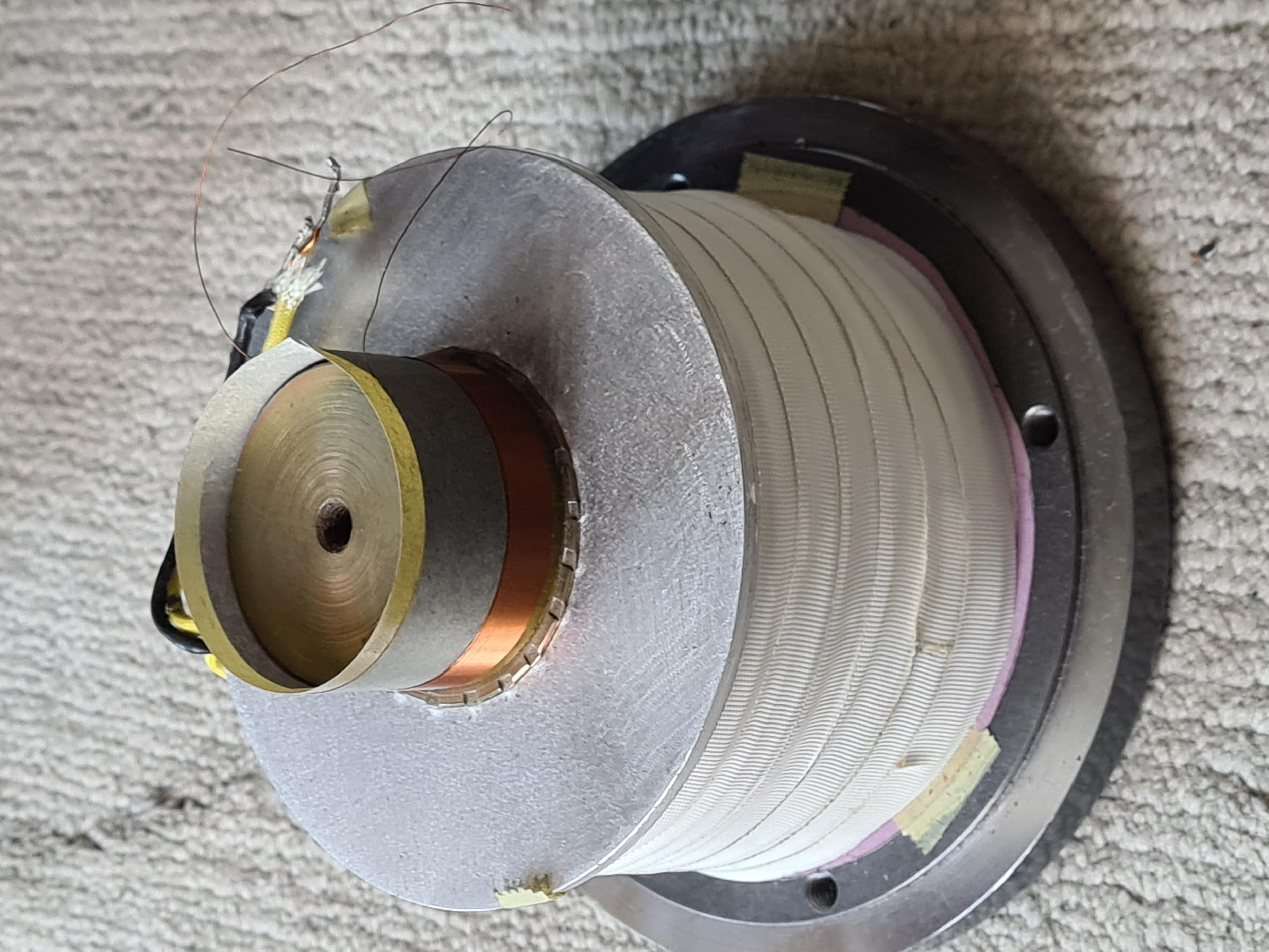

That is very interesting! You are one very adventurous diyer! Do you have a thread or a blog about these modifications?
Sorry, no thread of this project. These speakers are a design that friends of mine and I are developing for years now, we improve something each year. I think we are nearing the last step of this concept.
@diyiggy: The parts are from EMS loudspeaker from France. I believe you are french?
A friend of mine used to be the importer for these units for benelux (and also Phy from France when Salabert was still alive) and we have good relations with them.
They deliver us the speaker parts from their field coil series and cones modified to our specifications and another friend of mine makes the spider and surrounds. It takes a lot of experimentation (lots of discarded designs) to get the best out of such a construction, but the result is worth it.
The big advantage of this kind of spider is that it reduces the cone distortion a lot; a common spider lets the cone move in all directions, this spider only provides movement on the cone axes, not sideways. If you hear the same 12” with standard spider and with the wooden one the difference is huge: much more focus, openness, less distortion (in the last picture: left one is standard spider, right one new spider)
The field coil is also a much better concept than a conventional magnet, there are 2 advantages; the magnetic field can be made much stronger and it stays constant (no dynamic loss due to the sagging magnetic field of a permanent magnet).
And the third advantage: you gan regulate the magnetic field with the power supply voltage (Q factor) to tune the response of the unit (this is a tweakers dream speaker😉 )
These techniques are old, the first cone loudspeaker was a field coil design and the wooden spiders were also used in units from the 1920s. The fifth picture is an old spider from Altec Lansing.
There is one disadvantage though: Once used to such a speaker you cannot stand the dull, distorted and colored sound of conventional units anymore........
