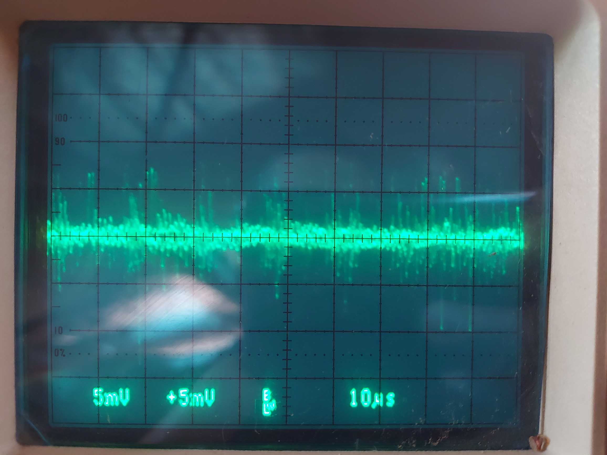

I found that going from single ended to differential gave a cleaner more hifi sound, particularly in the vocals - they sounded less "bloomy" for lack of a better word - not that I had an issue with how the vocals sounded. I would surmise that this would be from the attenuated H2. There are probably other factors at play here like common mode noise attenuation and bit averaging - but that was my experience anyway.
While on the topic, I took a differential measurement on my scope using the "poor mans differential measurement technique" to see what noise was left over. Two probes each 50 ohm terminated and in this case added together instead of subtracting to cancel out the music signal. The probes were connected to each side on the primary winding with the grounding leads left off - this way we can see the noise left over without the signal that will be attenuated by the transformer. Music was playing at full swing while taking this shot.
The amplitudes in reality are larger because of the passive probe impedance, but still, its a good indication of the noise being attenuated by the transformer in differential mode.
