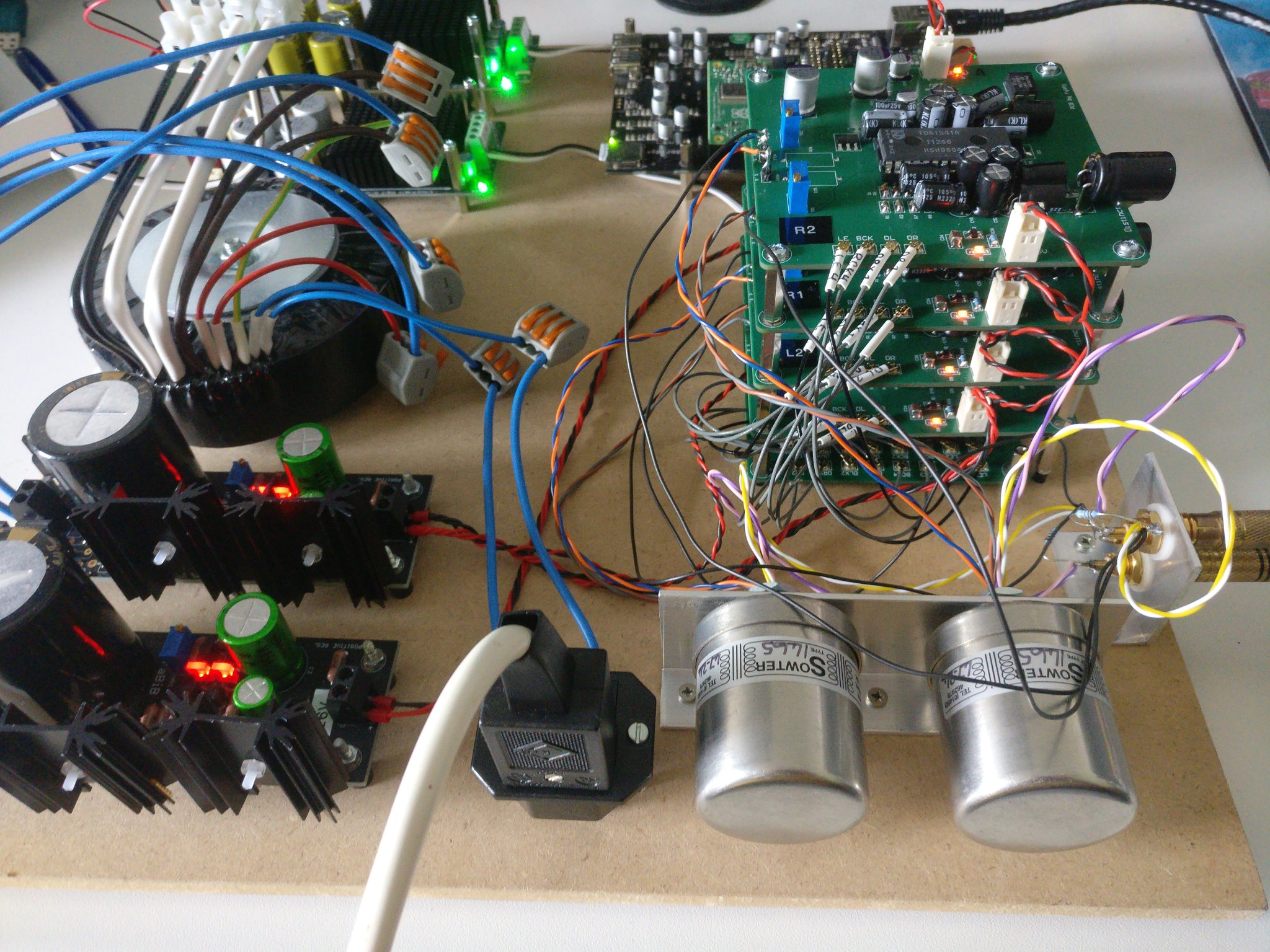

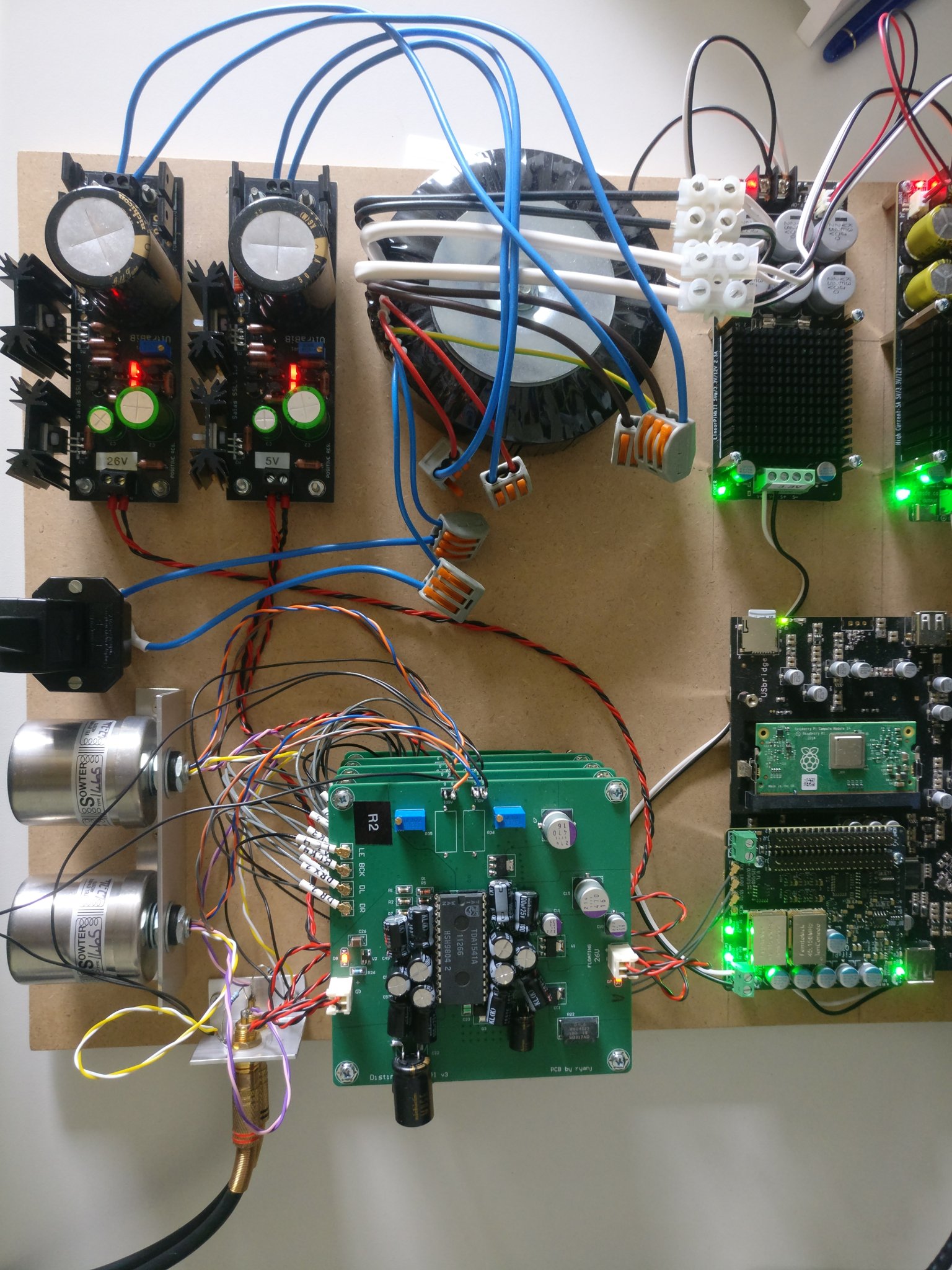

Yesterday, I read the whole topic again.
And I must say, since I had to study some of the schematics reading it all over again. And that made it much more clear to me.
I ordered some parts at mouser, now just have to wait till it arrives, and on with the testing.
Especially with the IV resistor, since I read this value can make a difference sound wise, in combination with the pre-amp it is connected to.
So different values I've added to the order, to test with.
(Thanks again @Supersurfer for all the input!)
Reactions: Supersurfer
Can anyone tell me how much current one D3 board and the glue logic board draws?
I know the D3 uses +5V and +26V but not sure how much current is draws. The same for the glue logic board, I know it uses +5V but not sure how much current it'll draw with one board vs two, or four.
