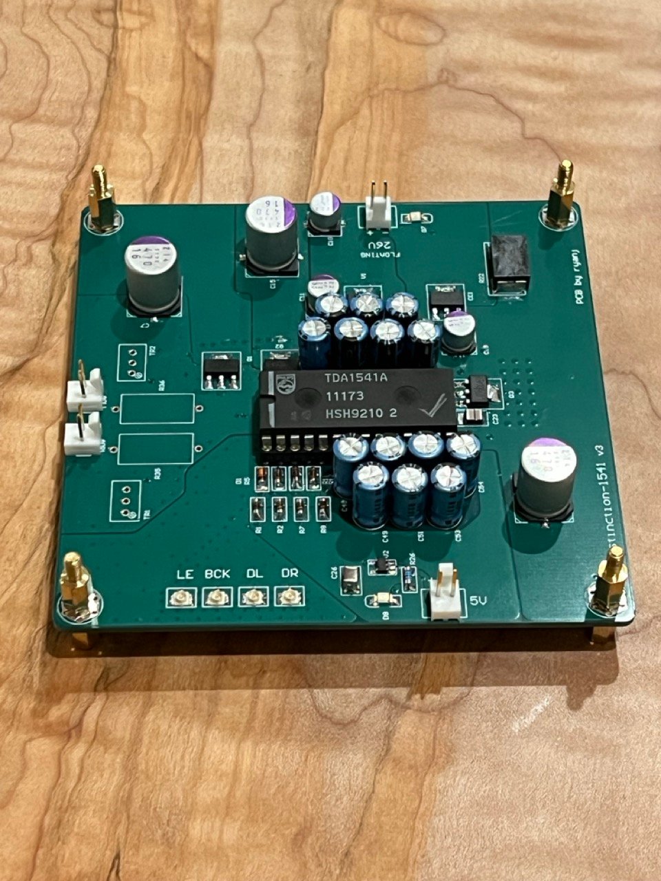

I assembled and powered up the board with a lab PS. Power on the chip (+5,-5,-15) is within few mV from expected values. The 26V consumes 130mA.
What is a requirement for the 26V and 5V PS? Is something like 1000uF after the bridge sufficient or it has to be a better quality?
Apologies if I missed this information somehow - I searched this entire thread.

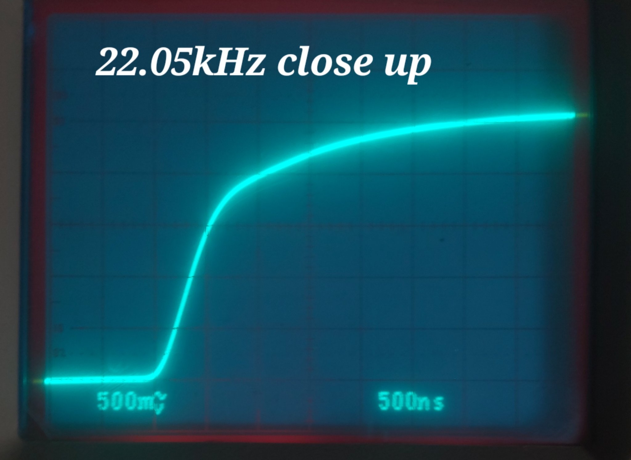

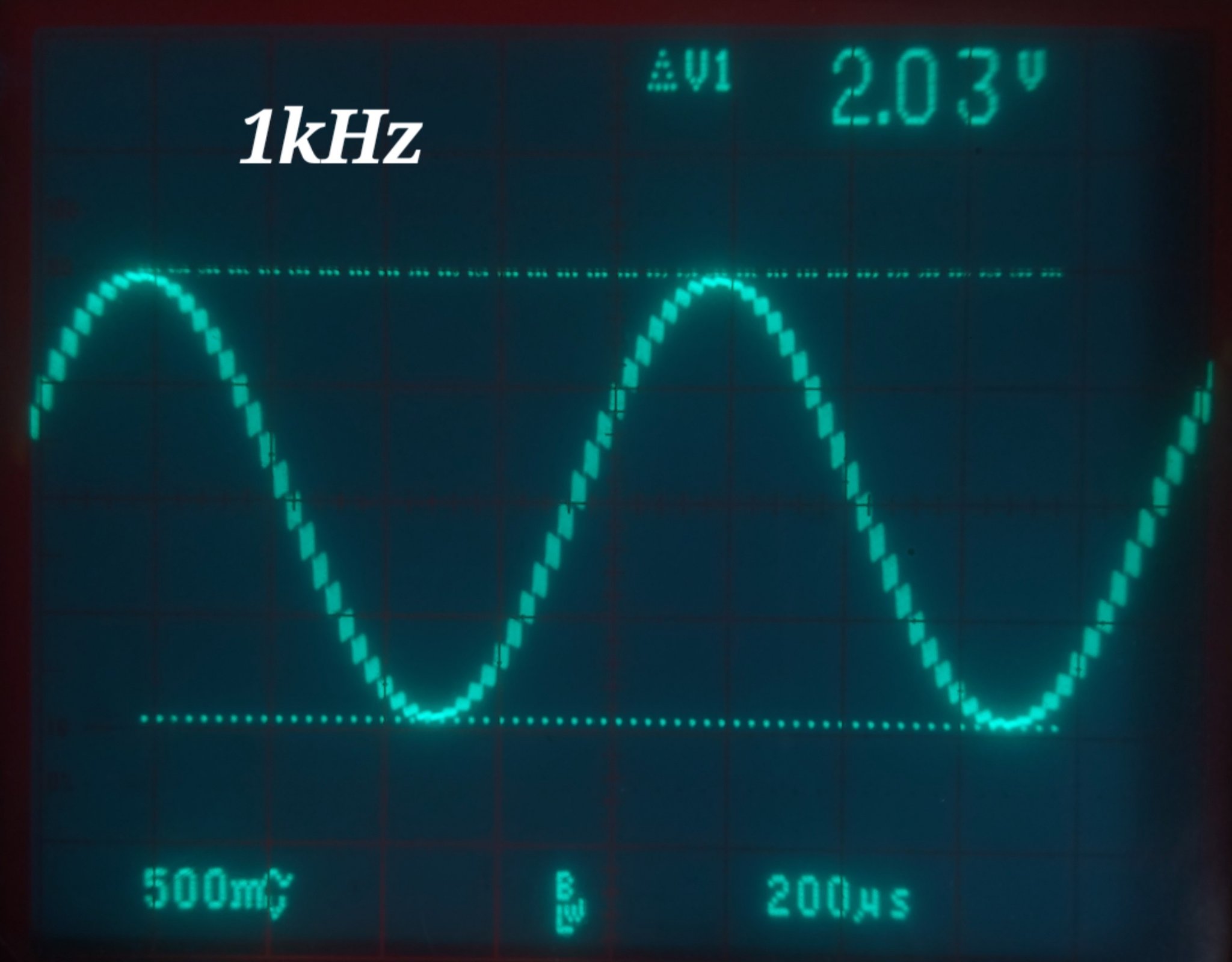

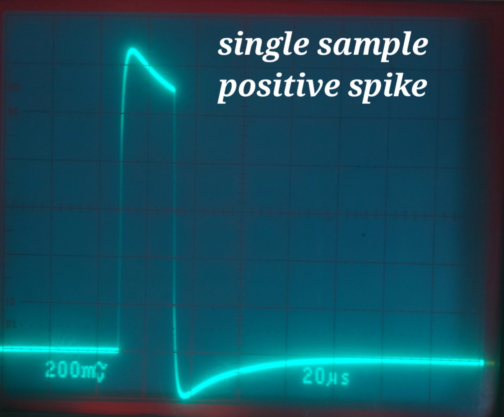

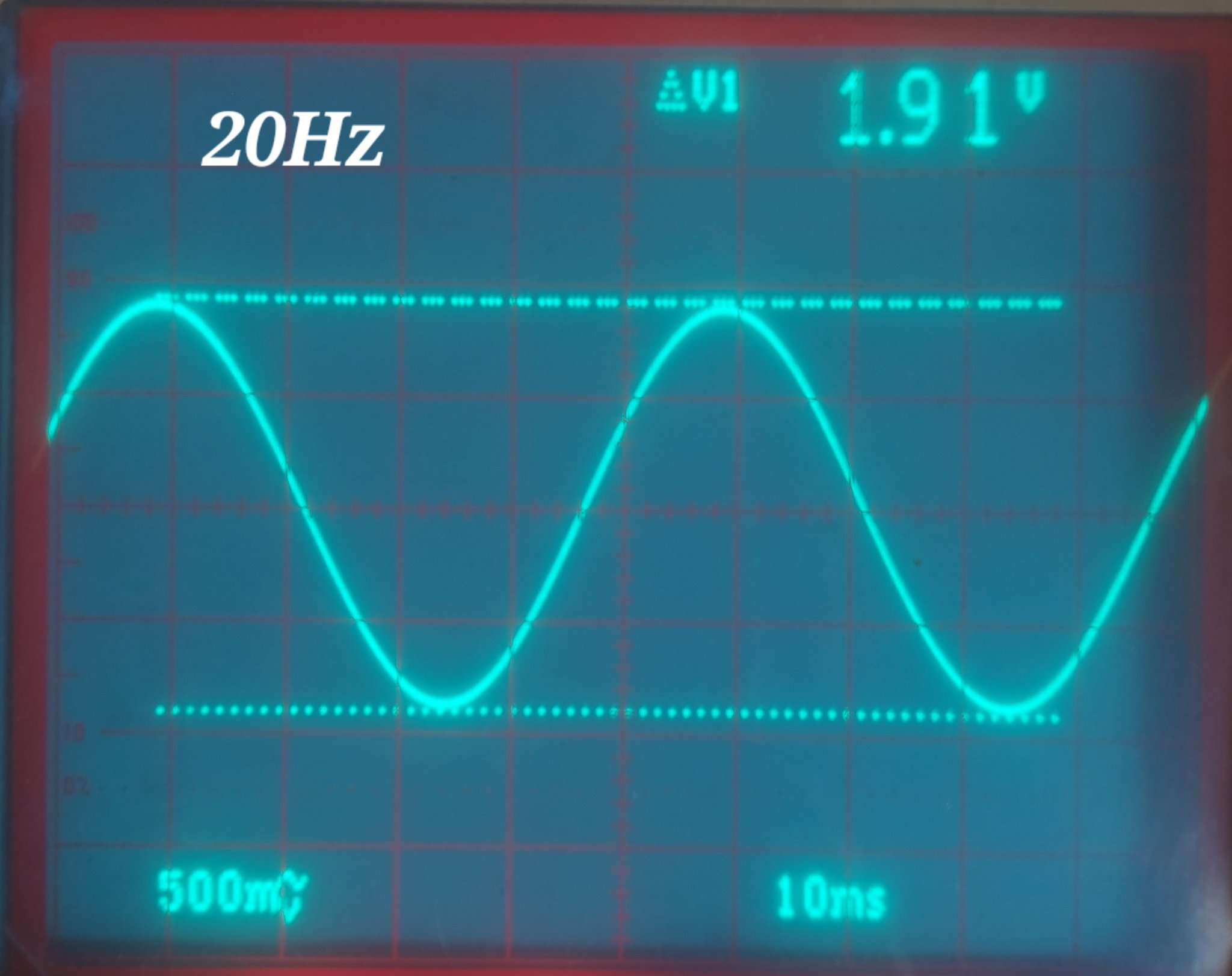

Hey All,

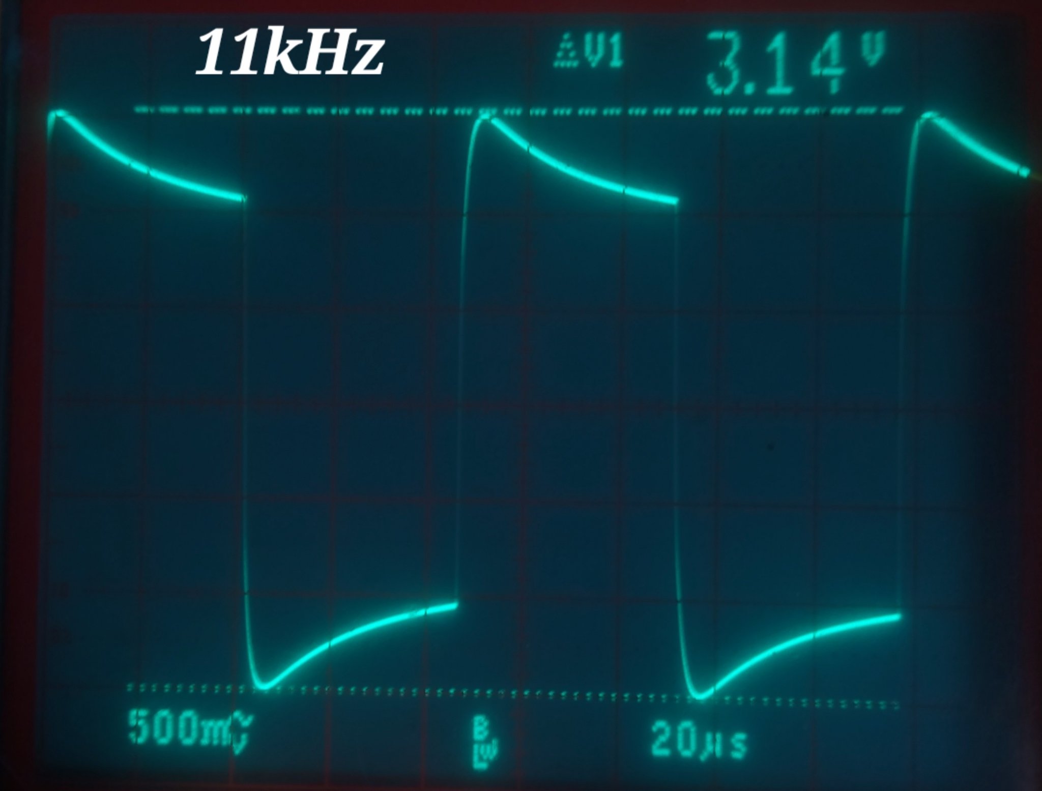

Just thought I'd share these scope shots of the tube stage im working on-
20Hz rolled off by -0.39dB from 1kHz with H2 @ -75dB and H3 @ -102.5dB
Overall the bass has been completely unaffected by the filter. Still sounds full and detailed with great control and good extension.
1kHz H2 @ -73.6dB and H3 @ -103.8dB
22.05kHz +3.5dB
Overall it was a balancing act to get the filter to sound smooth yet retain a fast sounding transient response.
I tried much steeper and narrower filters to suit the NOS droop more accurately but the treble became detached from the music. I found a gentle, wider slope sounded more natural even though its was technically incorrect.
From schematics here, I have changed C11 to 220nF, and changed C9 to 24.6nF, keeping the rest the same. This seems to suit my system and tastes. Others may prefer different values to suit their systems.
All fun and games! Bit more work to do though... stay tuned, ill get there in my roundabout way eventually!

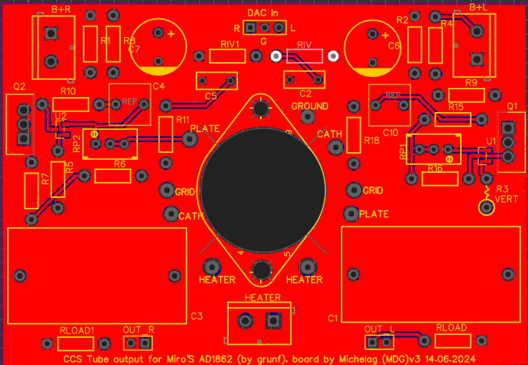

Good work @Seavan,
Yes the socket and surrounding circuitry is set up for a 6n23p, ecc88, and a few others. Perhaps in the future ill make a different version for other tube types with different socket pinouts. What tubes would you like to use?
At the moment im thinking of changing a few things for the final version, like diode output protection, capacitor footprint pitch, and a relay to bypass the filter. Other than that im happy with the layout.
The board started up right away. Thank you for making it fun for us!
Next step is to populate the i2s-to-simultaneous board, I hear people say it sounds better. I also have a lot of records with 192k.
At this point I am planning to experiment with ECC40, but I like trying different tubes and it would be great to have that ability to replace the socket. Can I ask if you tried other tubes?
