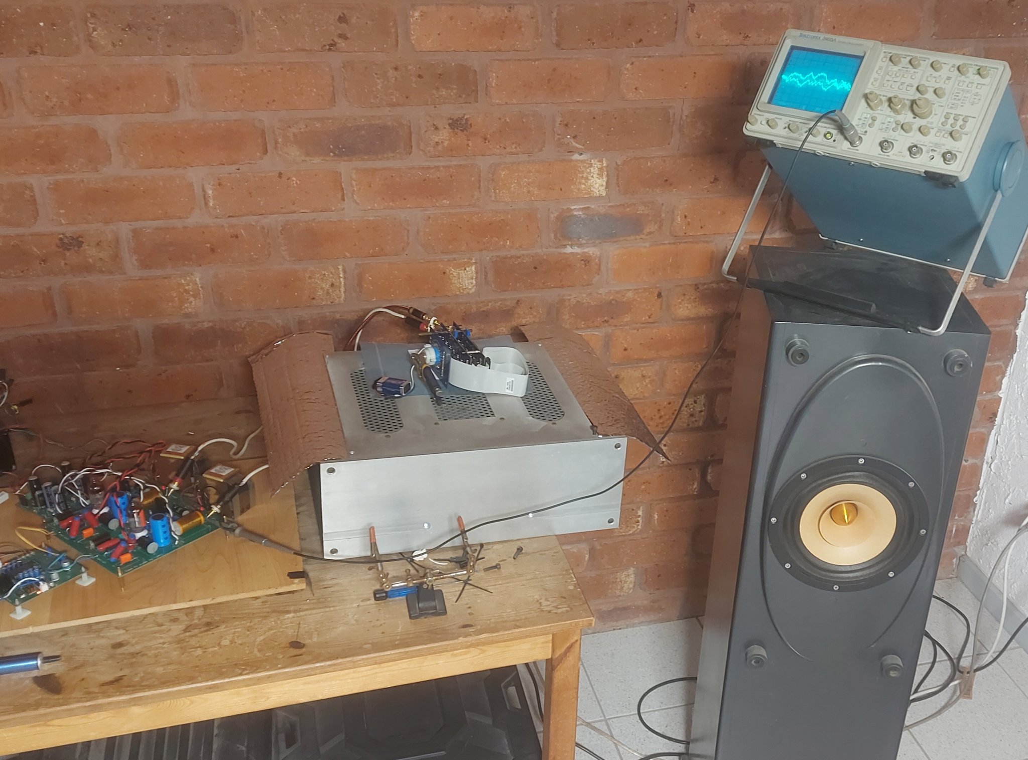

Just finished populating this tube IV stage i've been working on for the past year.

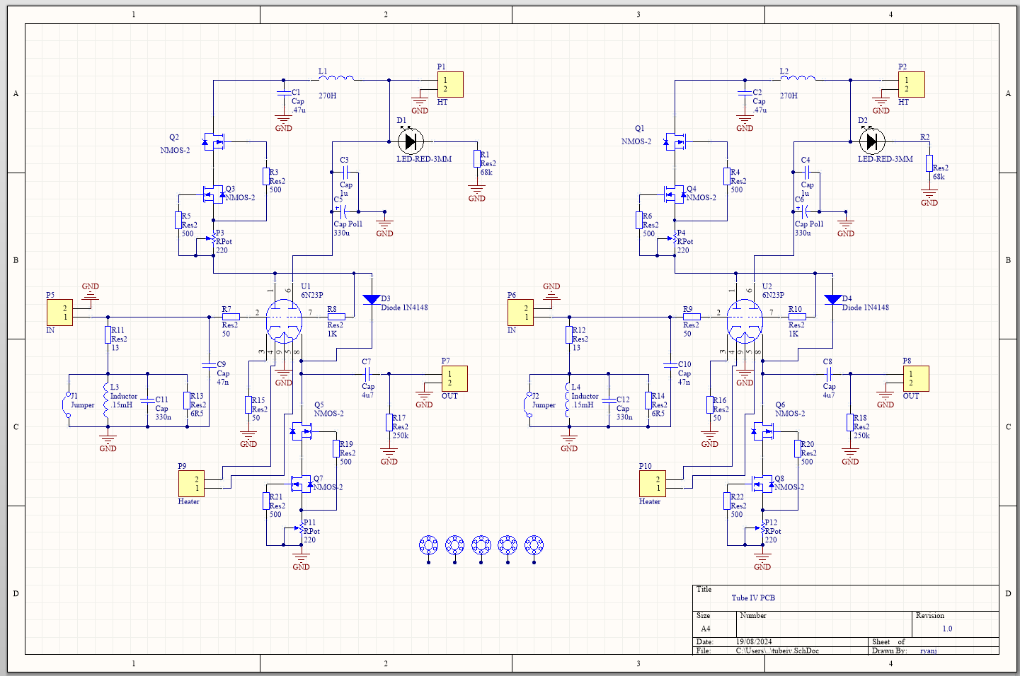

Actually the second half of the tube is used as a cathode follower, ill attach the schematic. Both channels are included on the schematic with two triodes in each tube symbol.
In the past i've tried disconnecting the 2ma current injection but wasn't sure i could notice the difference, ill try again with this tube stage.
Yeah I'd consider making an alternative pin out version if there was enough interest.

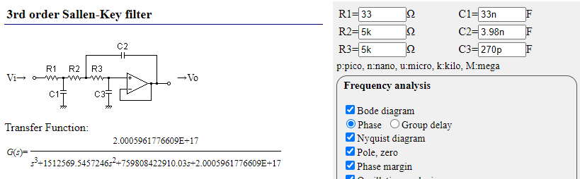

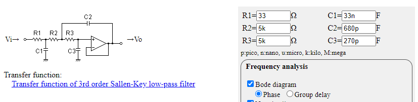

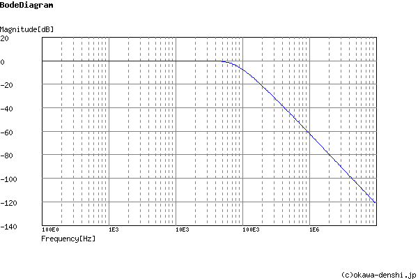

Yes, I know. Use it as Sallen Key RC filter, which can be "peaking" to compensate the SINC roll-off instead of the RLC element in series with the I/U conversion resistor.
Example:
Riu = 33R
Ciu = 33n
SKF
R = 5k + 5k
C1 = 680p
C2 = 270p
C1' ( to create SINC EQ) 3.3nF
http://sim.okawa-denshi.jp/en/Sallenkey3Lowkeisan.htm

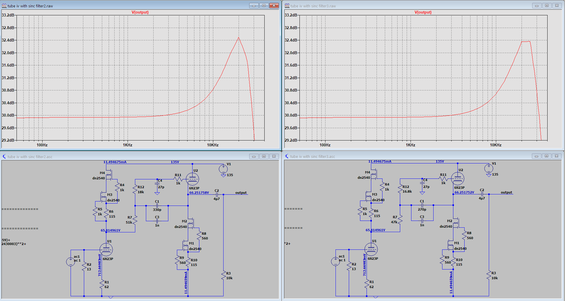

I'll have a play around with this in ltspice.But as you have a second tube half, how about doing a Sallen Key filter around the follower? It can be made peaking to EQ the SINC roll-off. It makes it easier to construct as using inductors often get's complaints. Add a relay to switch this on-off and it can be tied into sample rate indication.

I tried Thorstens suggestion on post #1341 (and Schematics here) using a sallen key filter between the two stages to compensate SINC roll-off.
Although the values I used weren't exactly the same that Thorsten suggested (see attached- my values on the right) It should have at least given an indication of what to expect according to the simulation.
I could hear the benefit of the slightly "cleaner" more defined highs, BUT, the dynamics sounded compressed across the whole frequency range, negating the benefit of having the two stages DC coupled to my ears. Even the bass had less impact. It left me feeling I needed more volume but the levels where the same. The effortless dynamics were gone. Perhaps i've applied it wrong but at this stage of the design im going to continue with the current PCB design.

Did you confirm the circuit operated as intended by measuring the response, checking oscillation etc?
Yup.
May I ask what you call "compressed dynamics sound".
You could try removing the capacitors in the SK filter and see if the issue arises from the resistors. What kind did you use?
Thor
Yes, at 20khz it was only -0.5dB down. Everything looked good on the scope too. FFT looked very good also with the broad spectral noise normally seen with unfiltered NOS almost gone. Noise floor was about -110dB.Did you confirm the circuit operated as intended by measuring the response, checking oscillation etc?

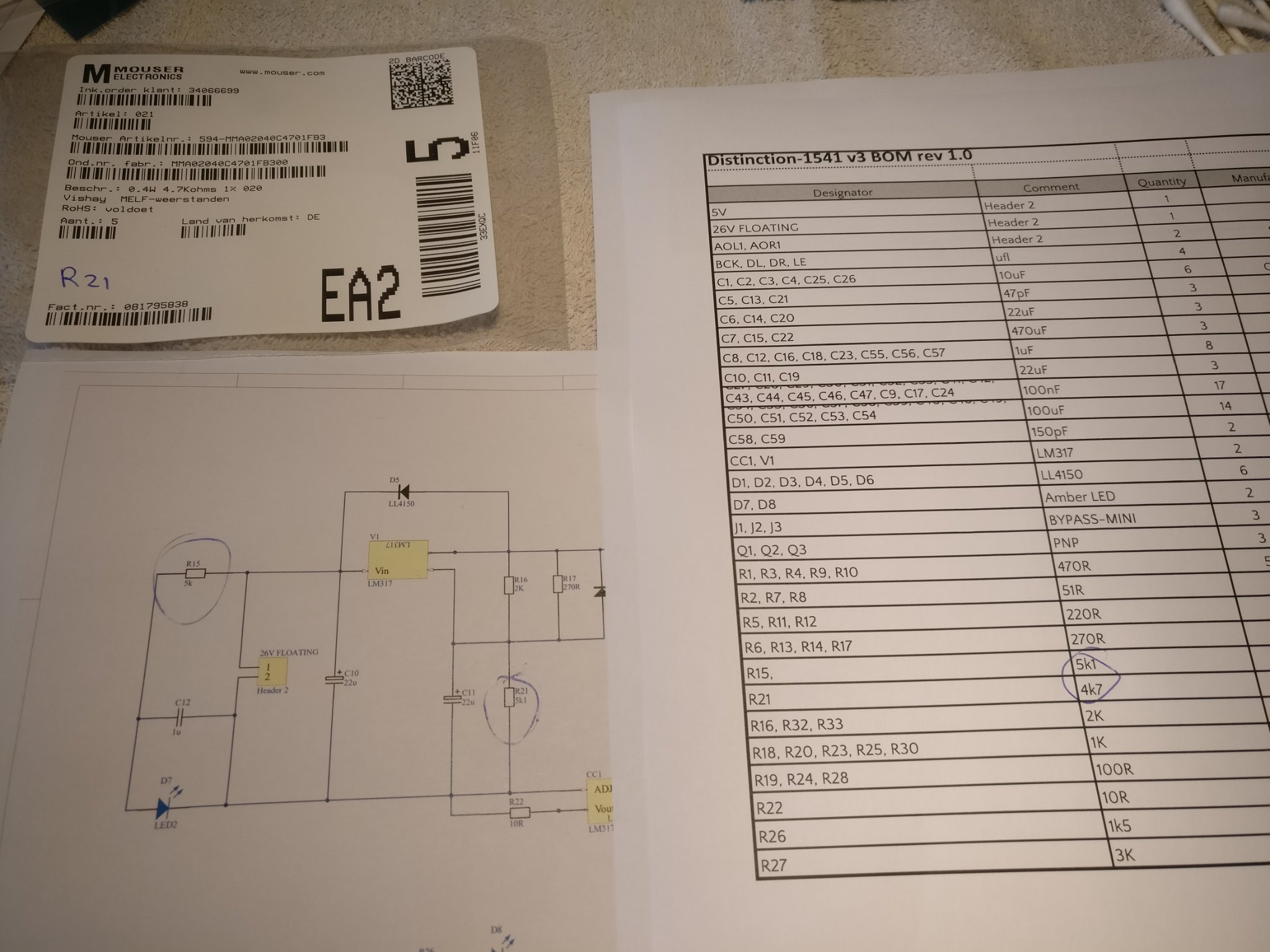

Follow the BOM, I had to make a few adjustments.Going on, brings me to a question.
The schedule tells me for R21 to use 5k1, for R15 5k.
The BOM says, R21=4k7 and R15 = 5k1
Which should I follow? ( I did order parts listed in the BOM)
