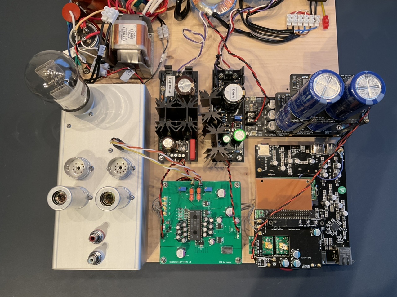

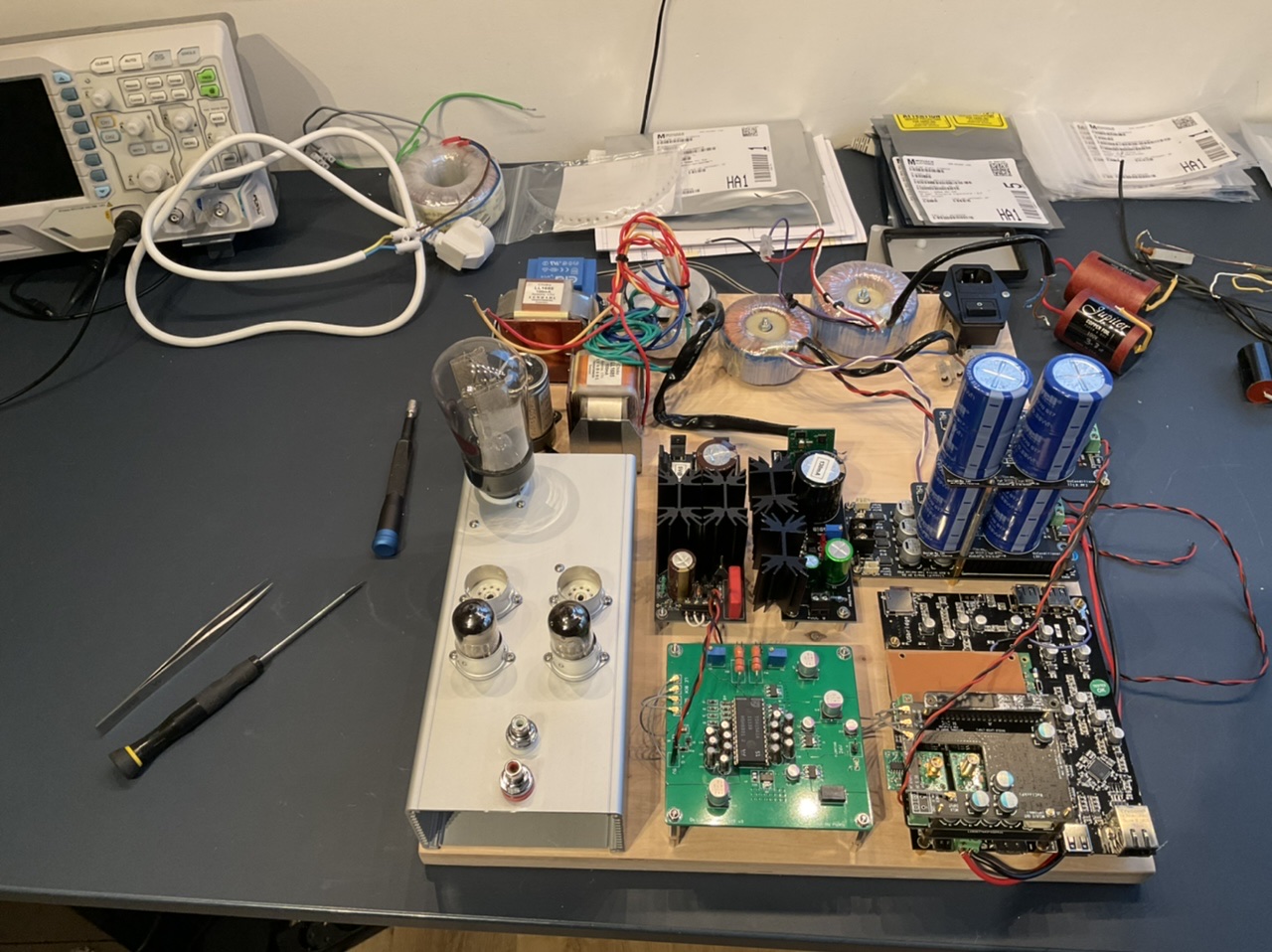

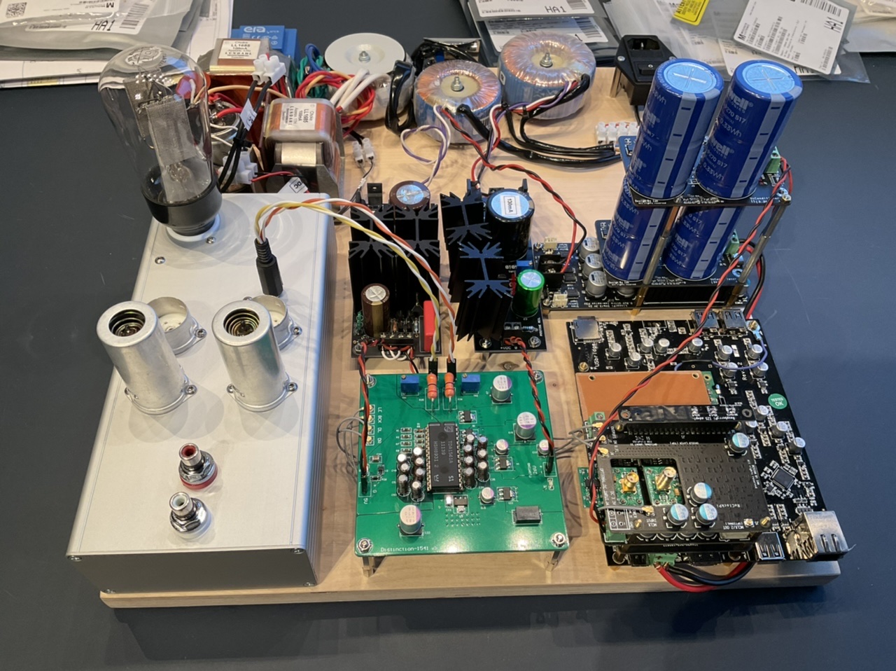

I'm no expert. I believe that you should avoid having two close together in the same orientation. I think A looks good. Each is separated by an inch or 2 and seem to be rotated 90 degrees from it's neighbor. You can also set them in place and power them. If they are coupling, they'll make a fair bit of mechanical hum. I did that in my first layout with a couple of Hammond 229 transformers side by side and they let me know.Hi,
after a very long time on a MDF board my D3 will receive a case. I bought a Linn Intersekt case for very little money and now mod it to my needs.
My question is : Which way to mount the PSUs would you prefer and why ? Is there a difference if the transformers are side by side, facing away from each other or even one on the floor one on the wall ? Which would make sense ? Here are my possibilities.
I defer to Ryan. FWIW, I believe I've seen this asked a few times as I reread the thread. I believe the answer is Ryan designed & tested at 26V. He recommends from that up to max 28. He says that below 25.5V it might not perform as well as he tested.
I plan to use my existing supply that runs around 25V.

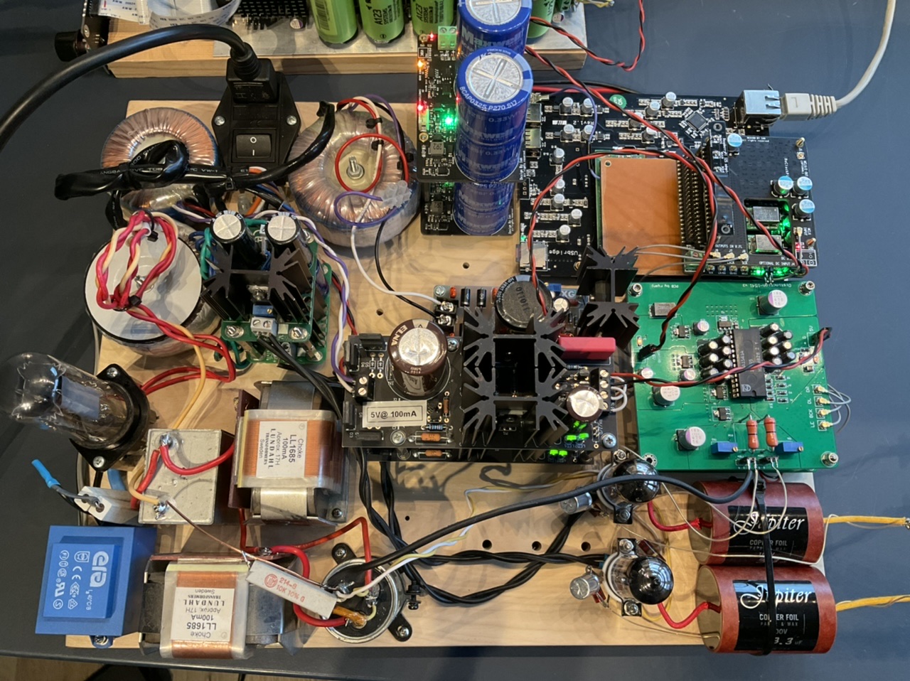

This is my latest bread board approach, still in development.
The tube output stage is currently an SRPP but I intend to build a second D3 and go differential so I already added 2 extra tubes.
Still looking for a nice schematic though. Maybe a differential Aikido?
I see a lot of good stuff in that photo. This will sound sweet.
Cool layout with the I2StoPCM board under the D3! I would not have thought of that. I'll keep that in mind for the future. I somehow failed on assembly/debug of Ryan's I2StoPCM. I am thinking for now will revert to I2S input from Reclockpi.

I changed to the 32v transfo and the mosfet rectifier with diodes for some extra voltage drop (too bad I get the switching diode noise back🙁) and adjusted the voltage output to 27,5v. In this way the heat of the regulator stays just under the limit.
Attached is my previous mess in comparison to the current layout.
It is playing now but there is too little bass and a grounding problem so it is not finished yet.

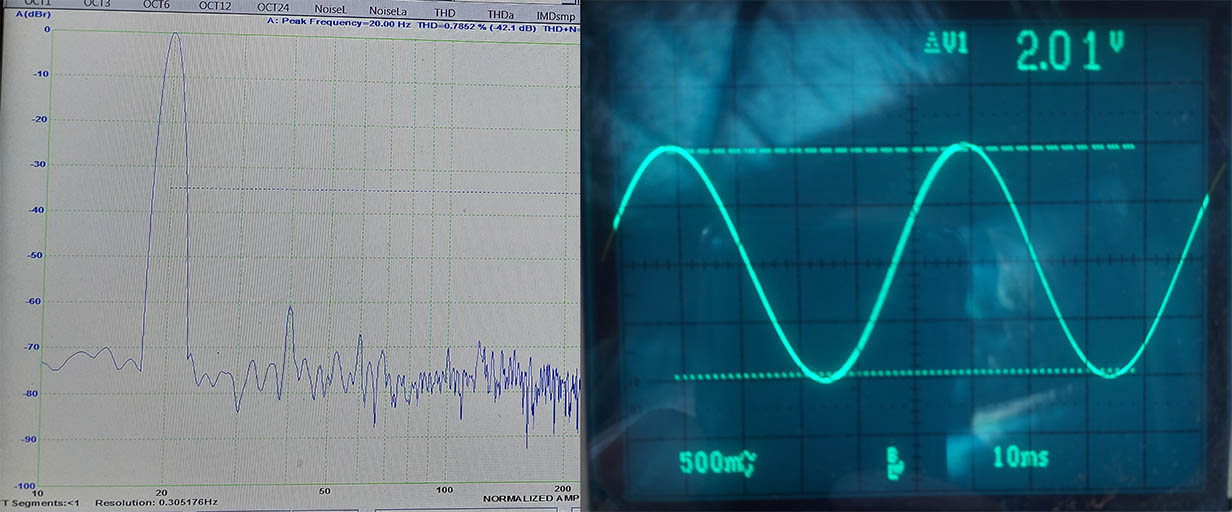

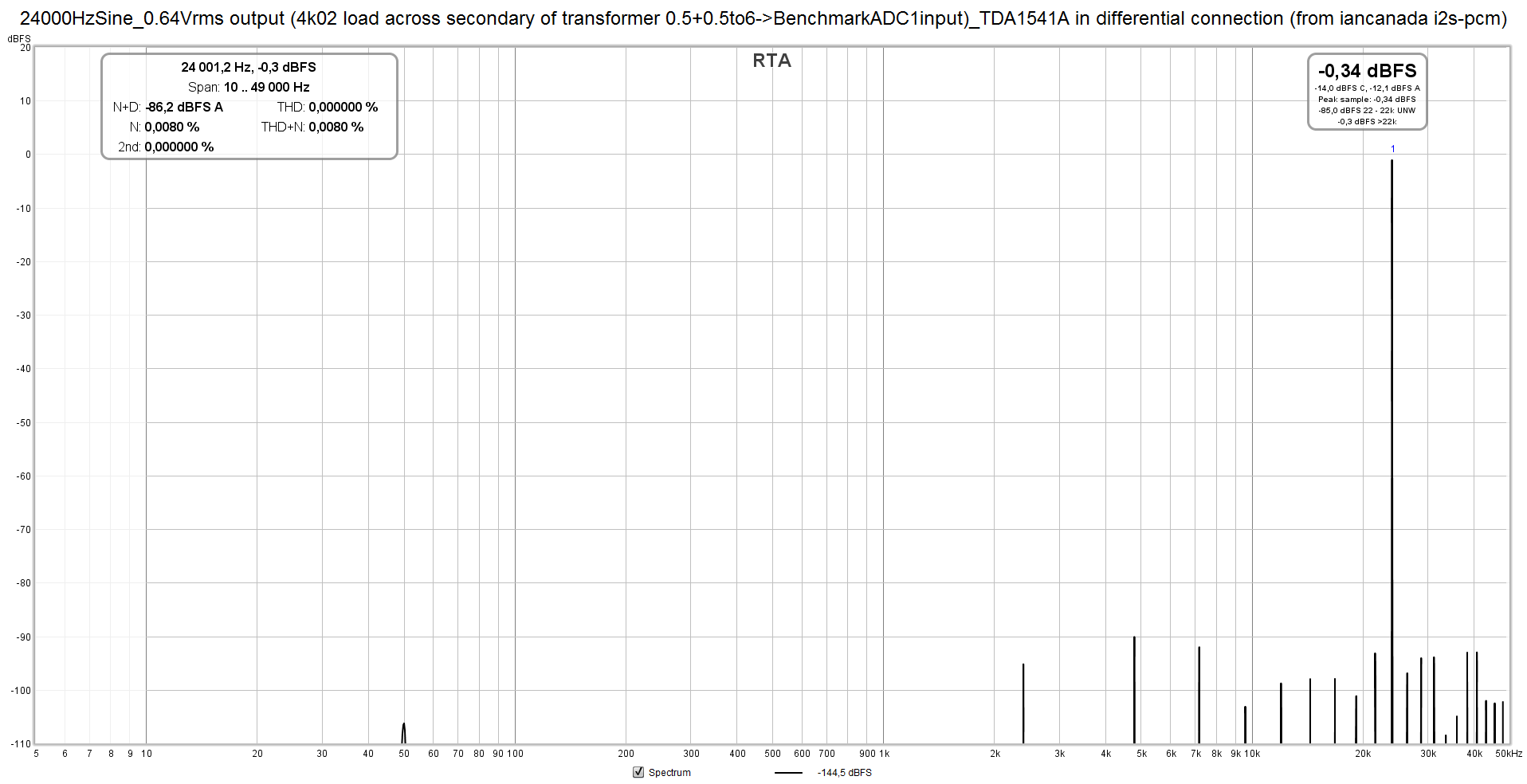

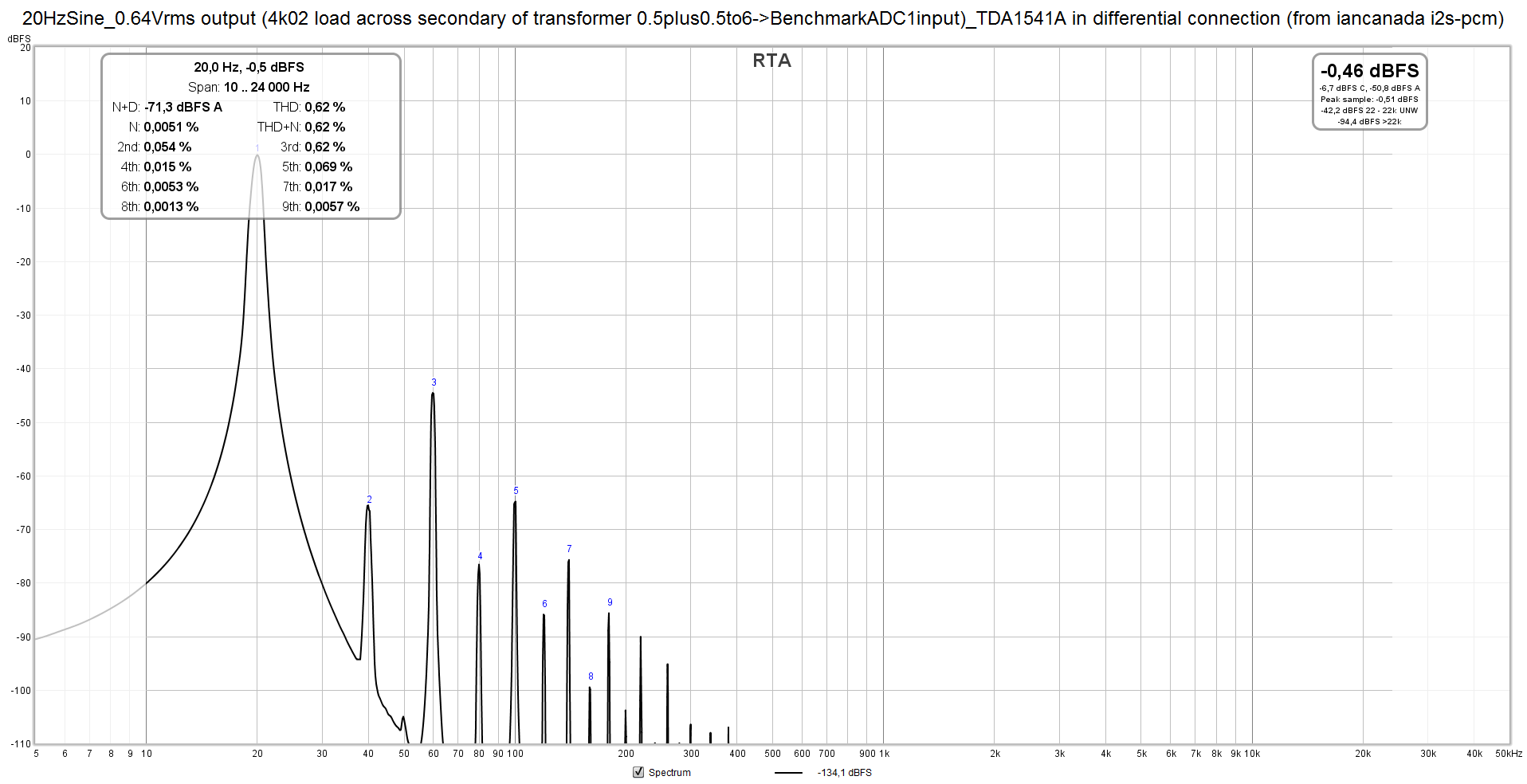

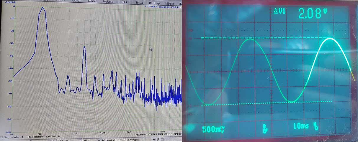

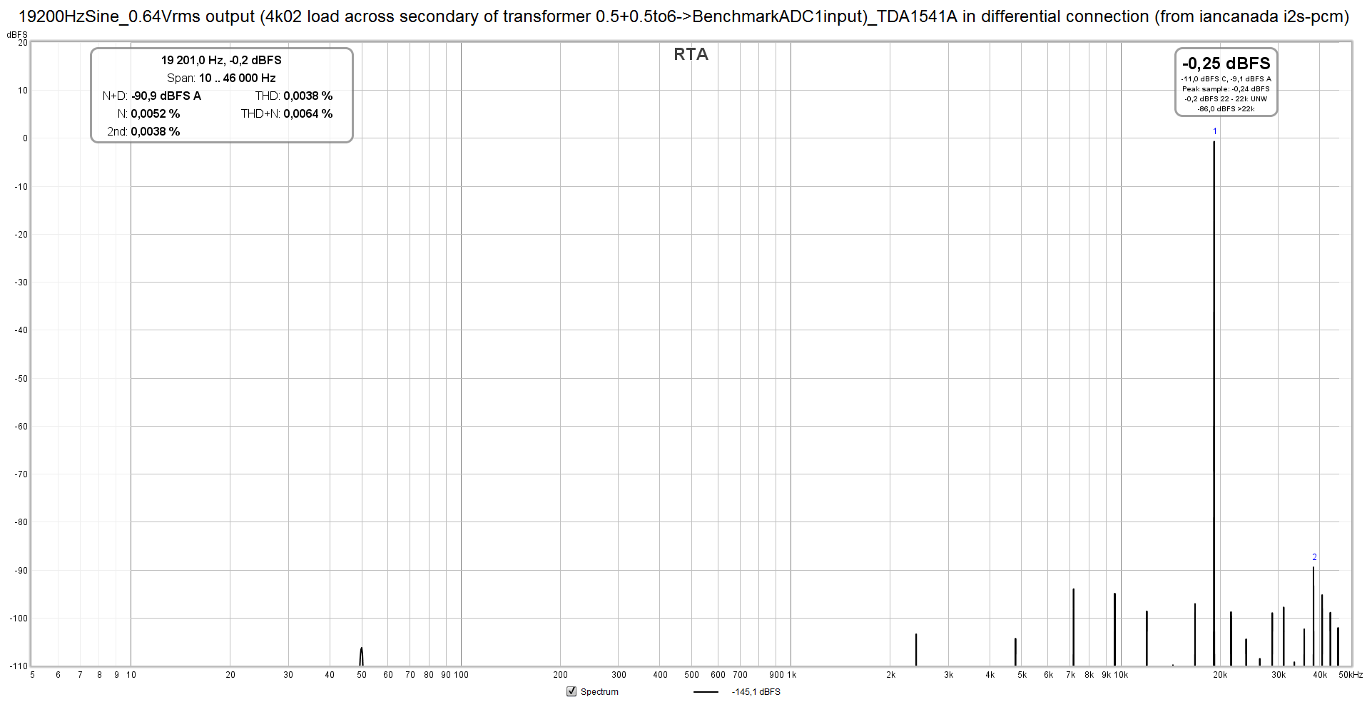

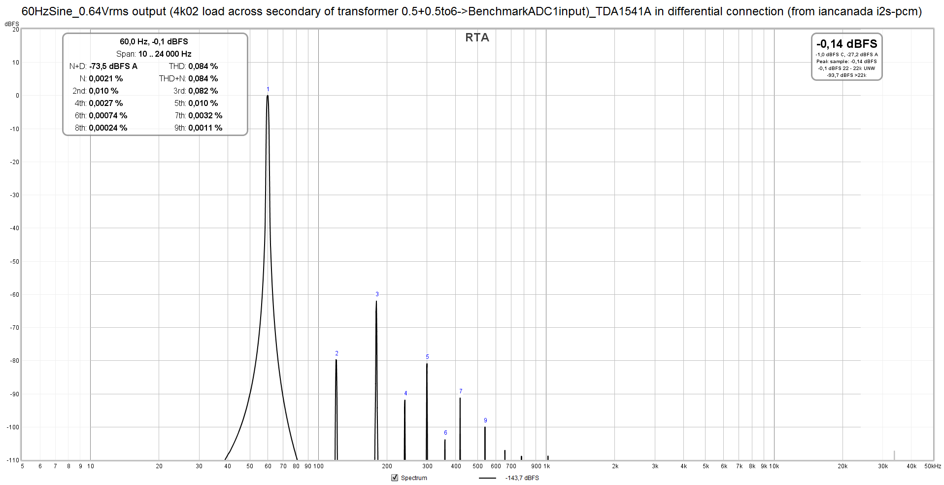

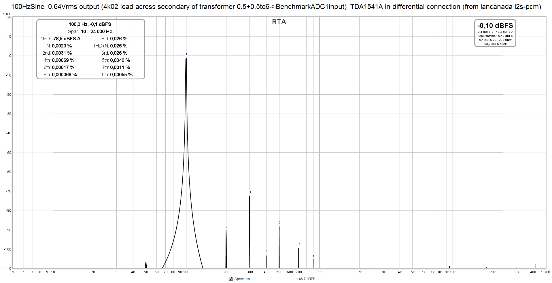

I tested two different sets of Bisesik's transformers with different ratios. They both performed roughly the same in terms of THD, but I think the lower ratio ones sounded slightly better to me - I think it was 1:6 and the other was 1:22. These transformers seem to perform very well in the higher frequency range compared to the Sowters. The Sowters seem to limit frequency bandwidth past 20k so filter out the high frequency hash when running NOS 44.1k.

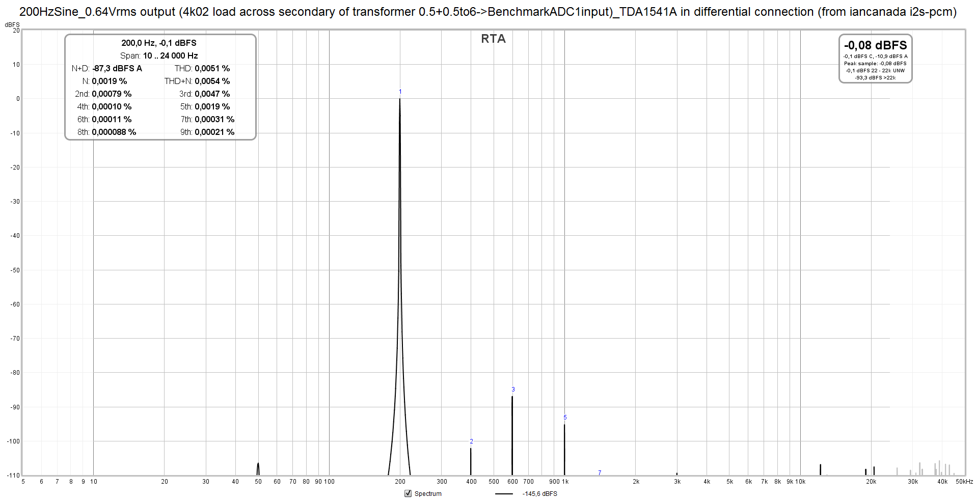

When I tested THD with at 20hz the Sowters outperformed Bisesik's, ill attach some pics of the results. Please take the results with a grain of salt as my test setup is far from optimal, but you can at least get an idea of the difference between the two. In my opinion the results do corelate to my listening experience.

Ryan, have you shot the THD for 1kHz and HF?
Yes, it was a similar distortion profile with H3 at about -32dBr.
