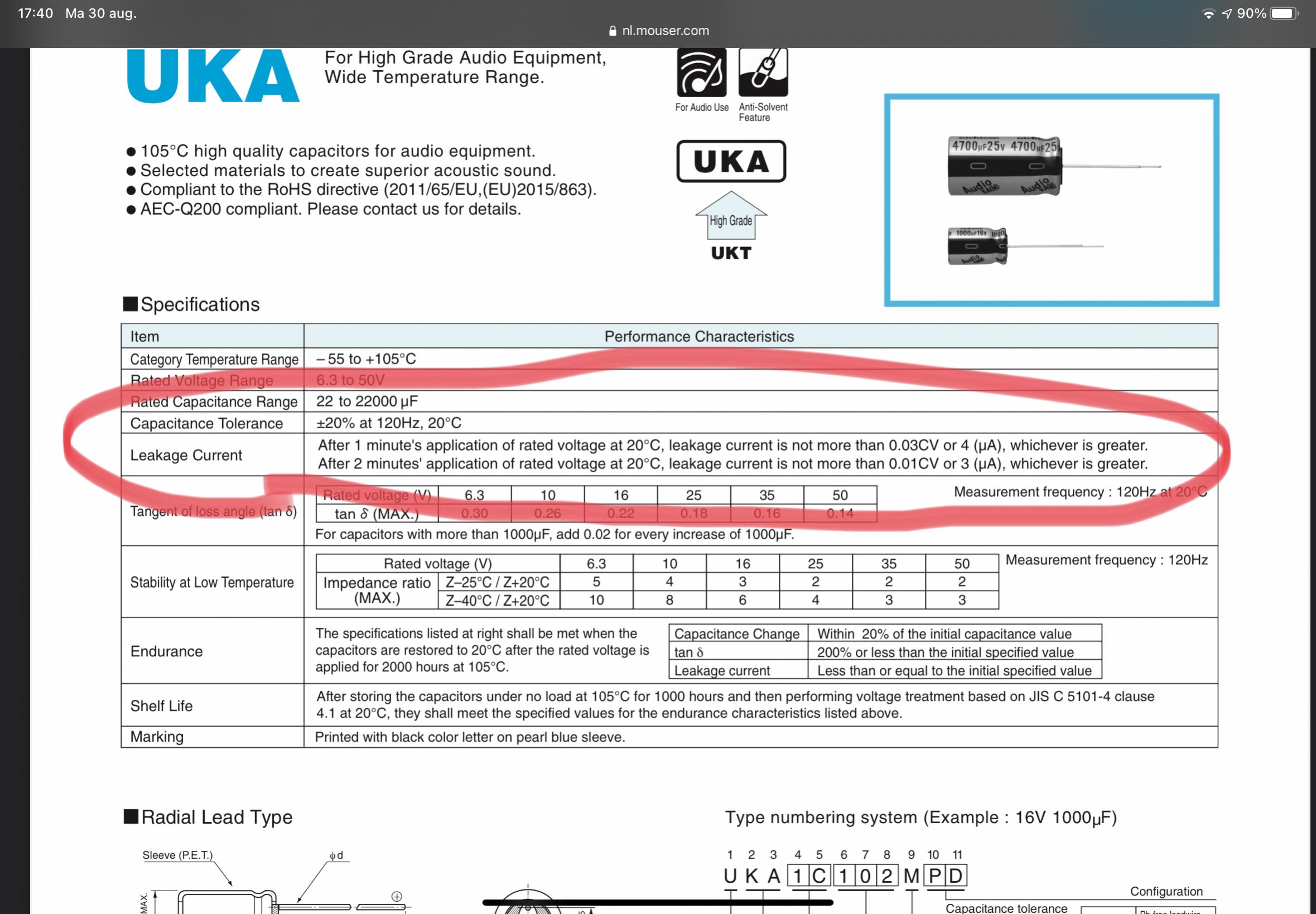

Based on the datasheet of the UKA capacitors:
The leakage is calculated according to the datasheet and is bigger if the rated voltage is bigger so 16v would perform better than 25v.

Yes higher rated caps need thicker insulation/dielectric but in turn also need a bigger capacitor surface to reach the same capacitance.
So regarding leakage the bigger surface will probably compensate for the thicker dielectric.

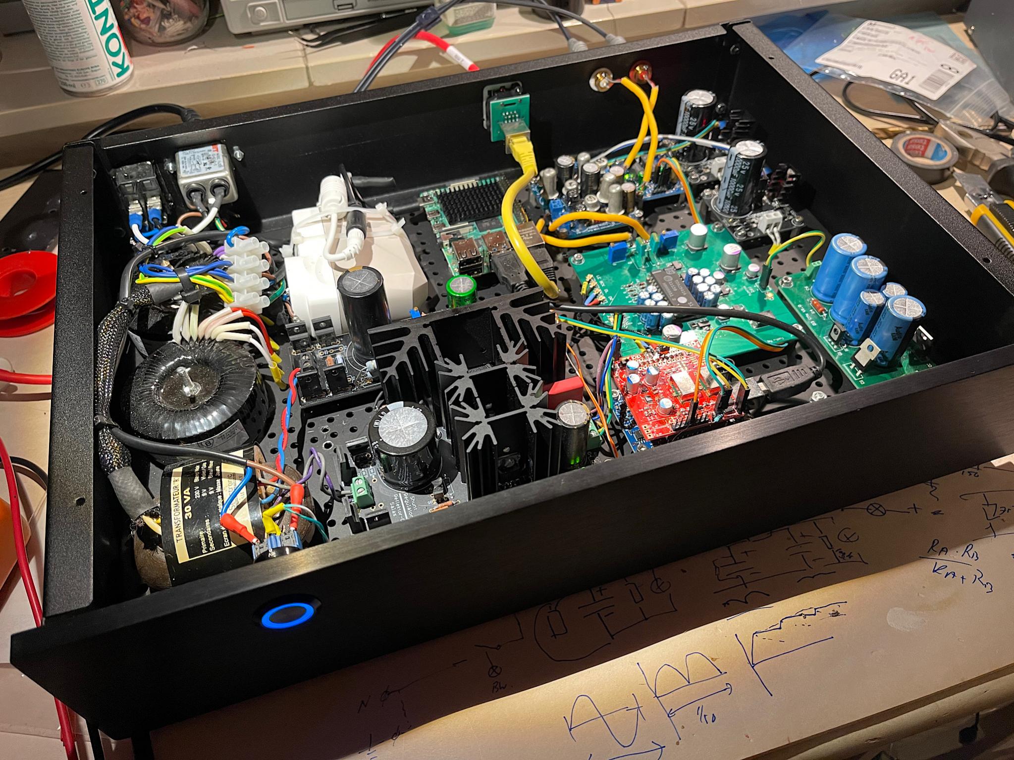

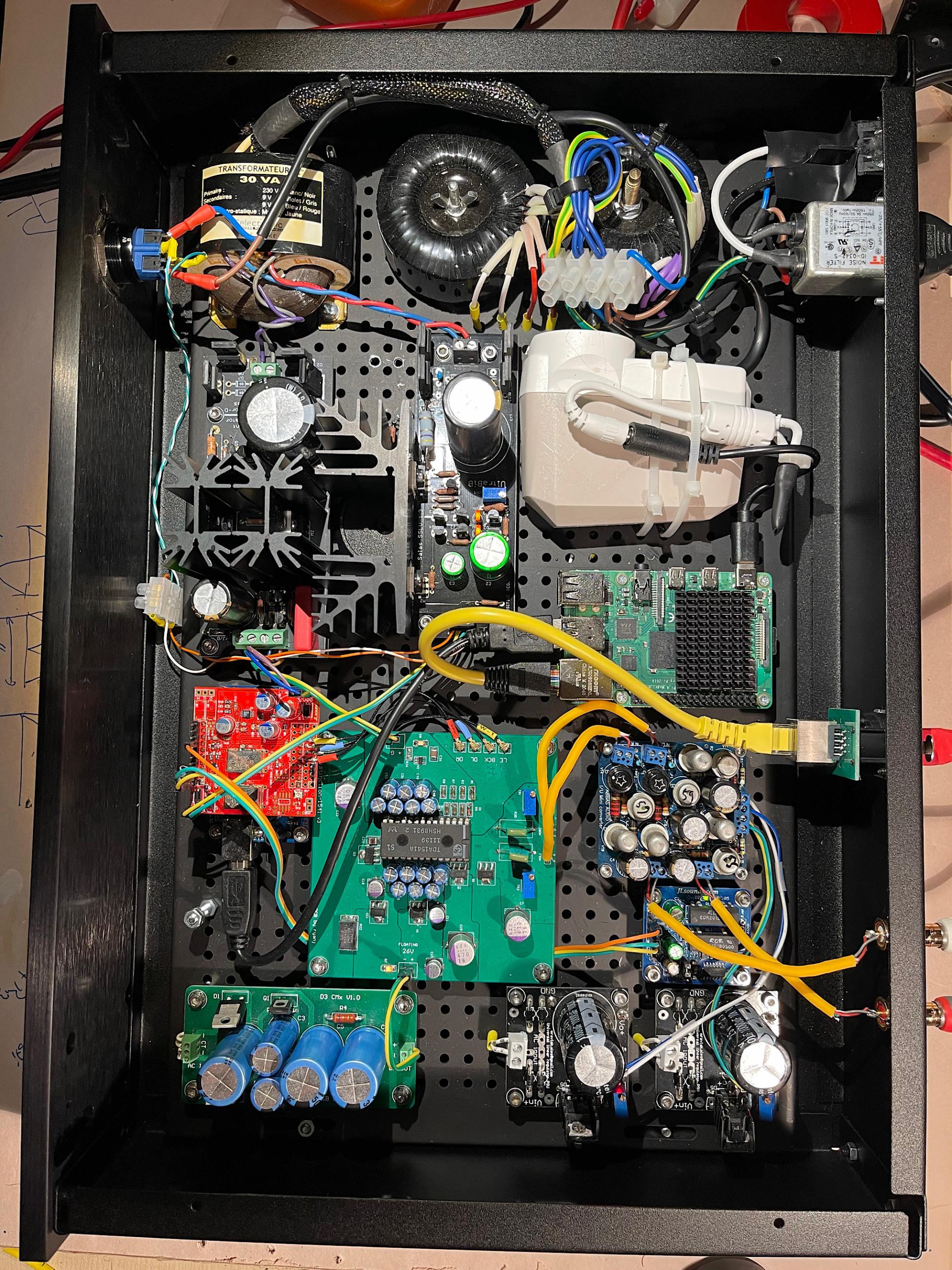

Finally I managed to actually give my D3 a proper housing. It deserves it well, just listened a/b with my Soekris DAM1021 which I really like, and the D3 is more pleasing to listen to. I am glad I went the D3 route. My nephew worked at the Philips department where his colleagues where designing the TDA series, so a bit of nostalgia is involved… never mind…
The setup included TDA1541A S1 (thanks super surfer), the Ryan, Ifi and Salas power supply’s, JLsounds in direct Simultaneous mode with upgraded crystals, rpi4 with Moode audio, Abbas I/V germanium converter, 30R rhopoint I/V resistors.
Next is the balanced D3 setup with the Sowters, all the sub components are already on the wooden test board, look forward to finish that build,
