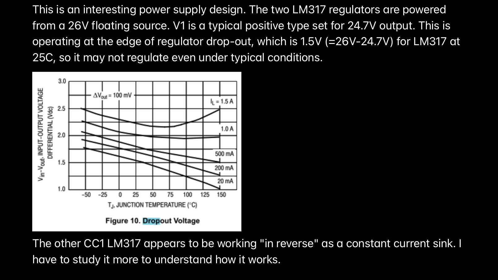

I had someone with more power supply knowledge than me look into the design and this is what he wrote me.
Hi there Supersurfer,
I appreciate you uploading that info- I think your friend is absolutely correct, an input voltage set to 26V is a tad to close to the drop out of the regulator. I think this issue is related to my error of initially setting the regulator voltage too high and as a result was practically doing nothing except passing current with a very low resistance... Now that the voltage is set to a more appropriate level (R21 changed from 5k1 to 4k7) the input voltage can be increased because of less voltage drop across CC1. I've just tested an input voltage of 27V and neither V1 or CC1 are getting hot. As for the SQ- I don't think it made much difference but its worth doing properly. Thanks again for bringing this up.

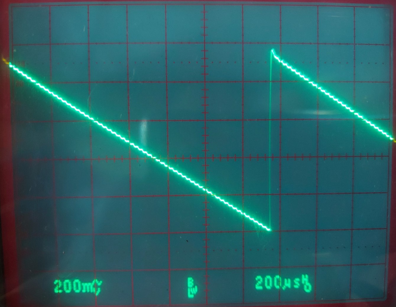

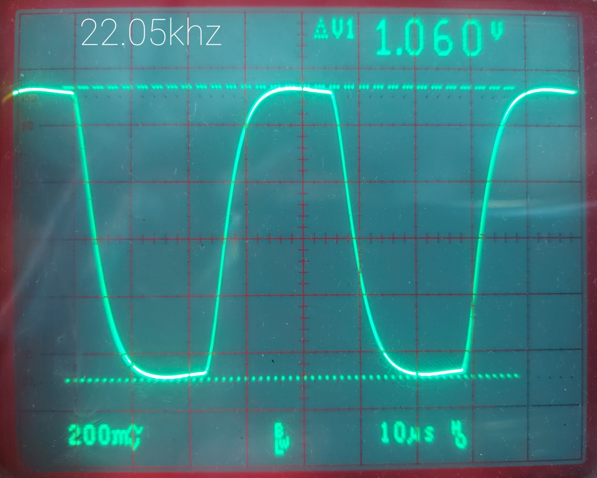

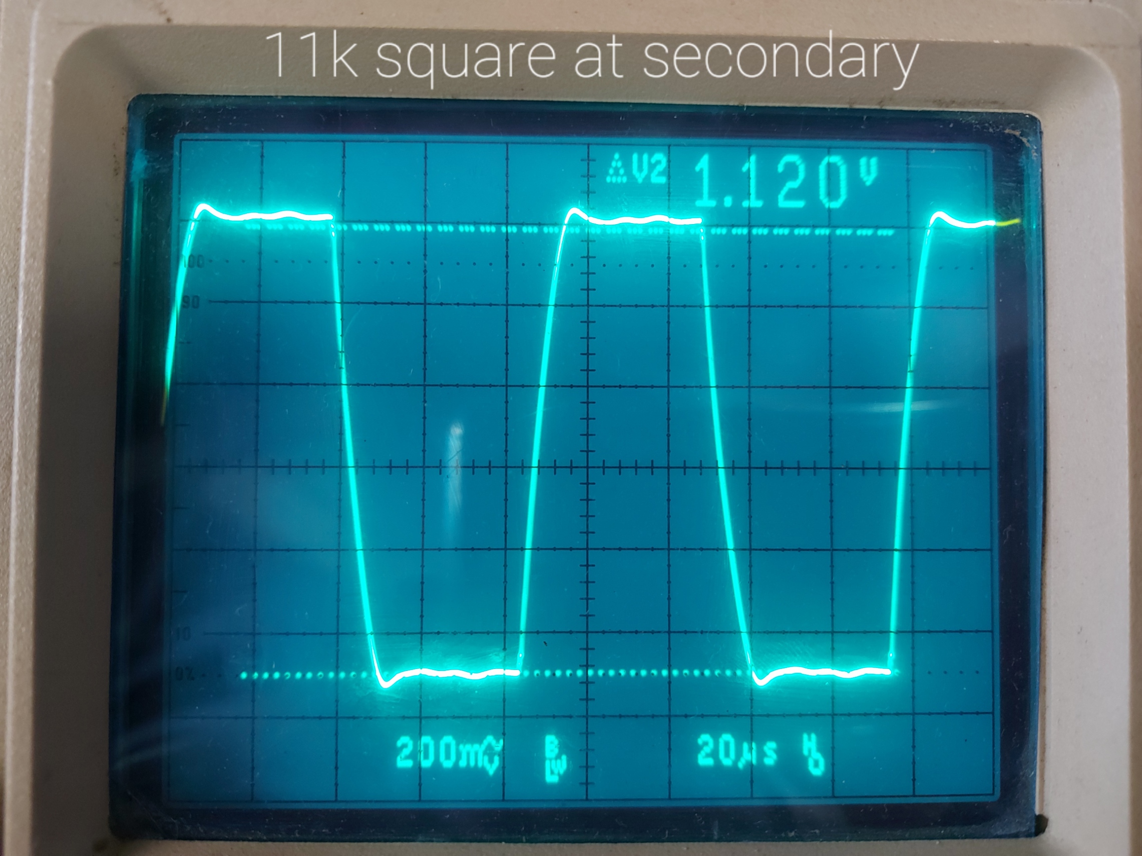

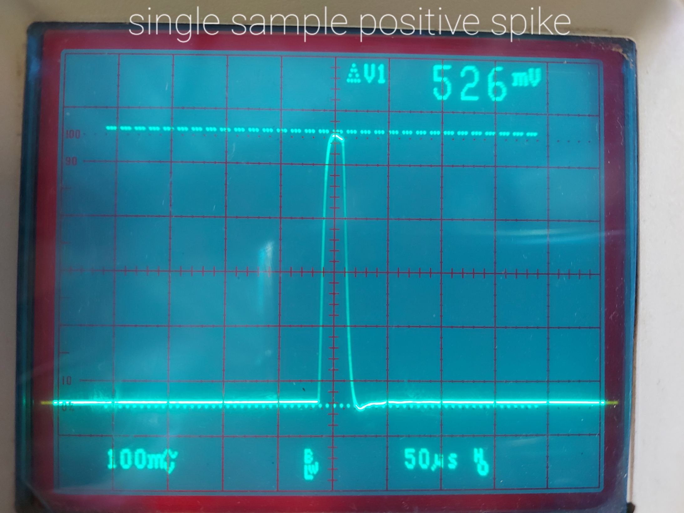

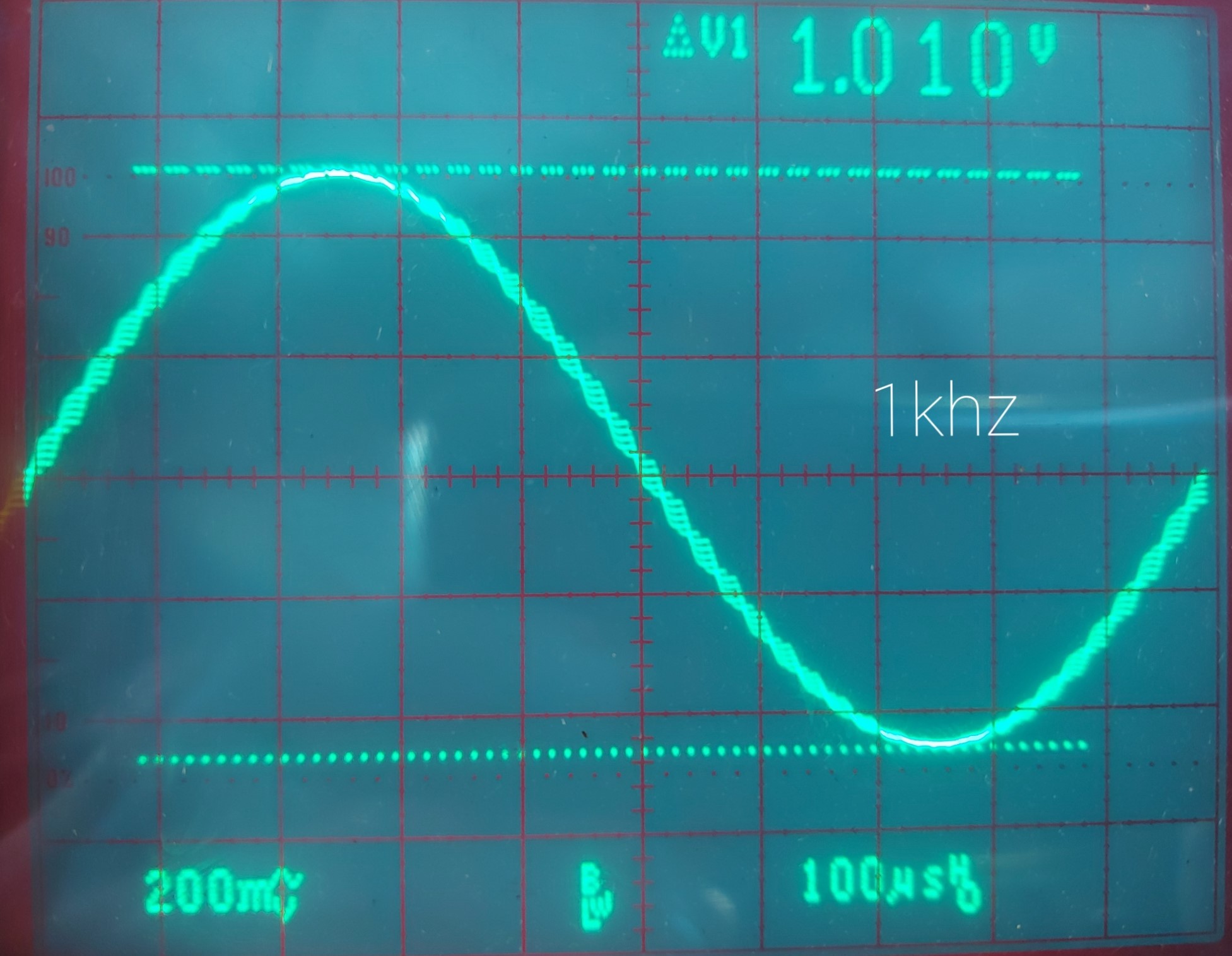

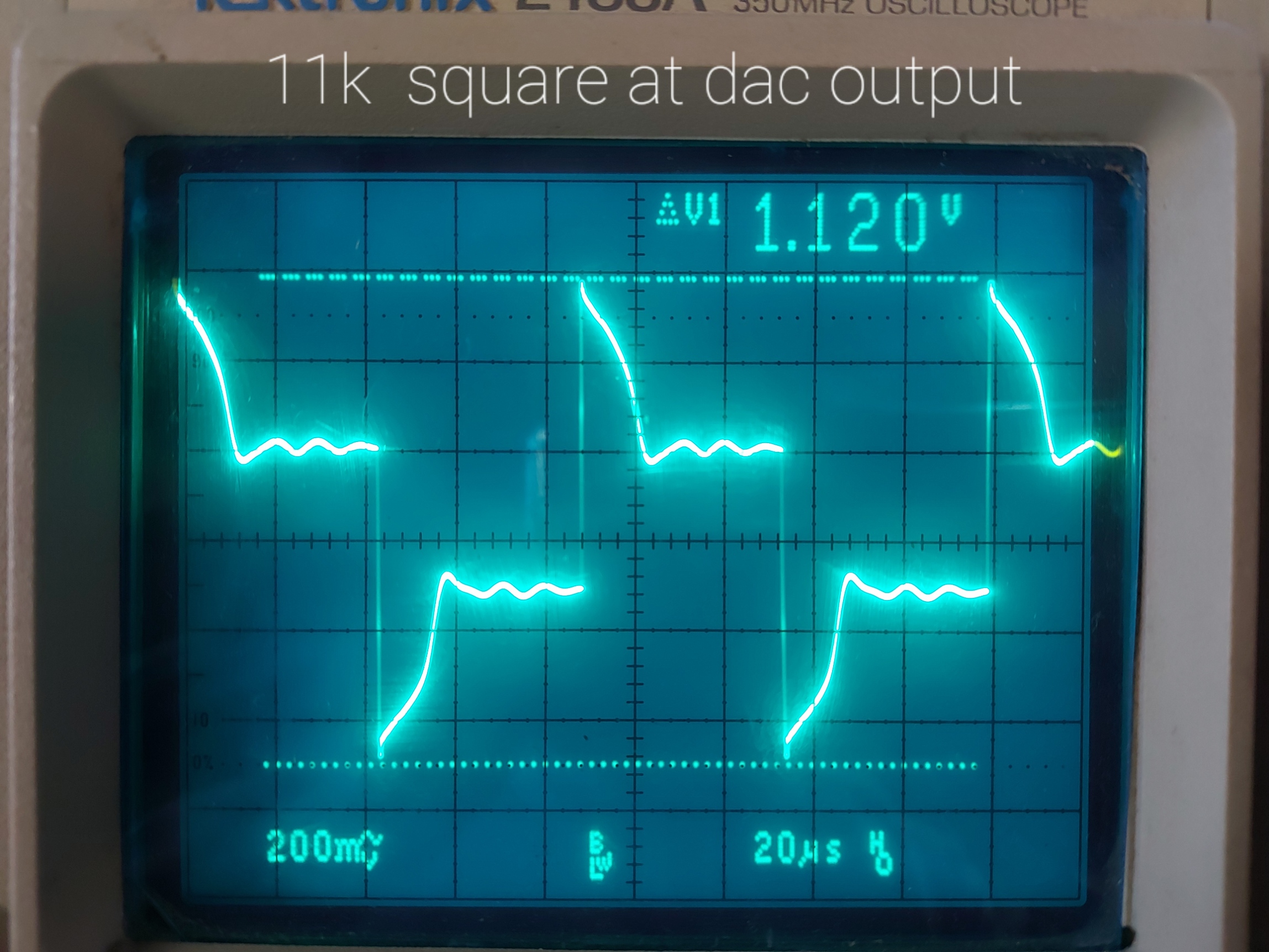

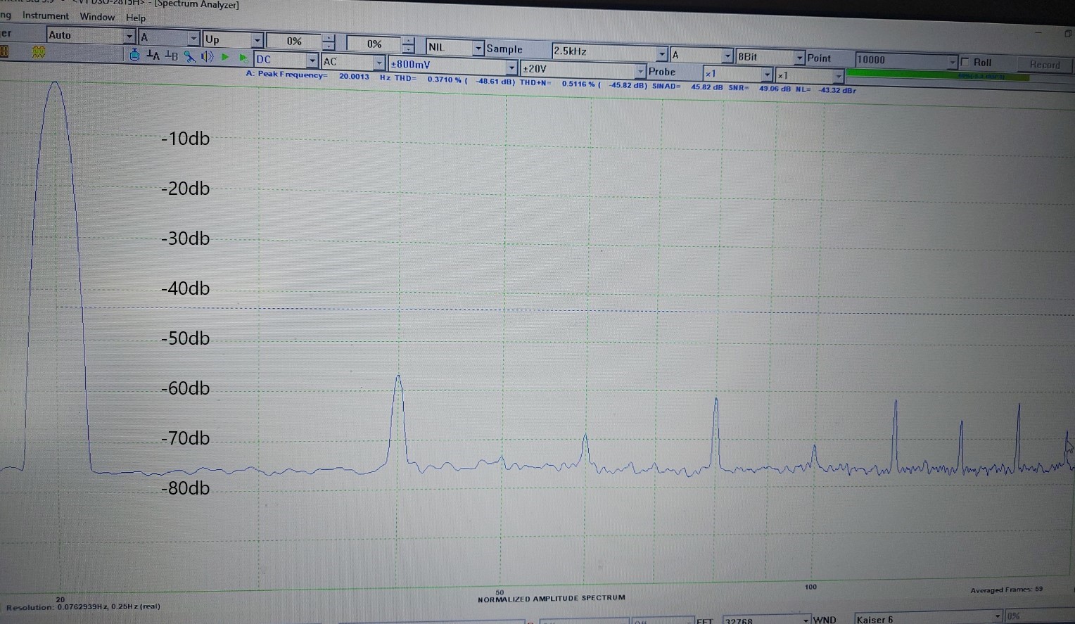

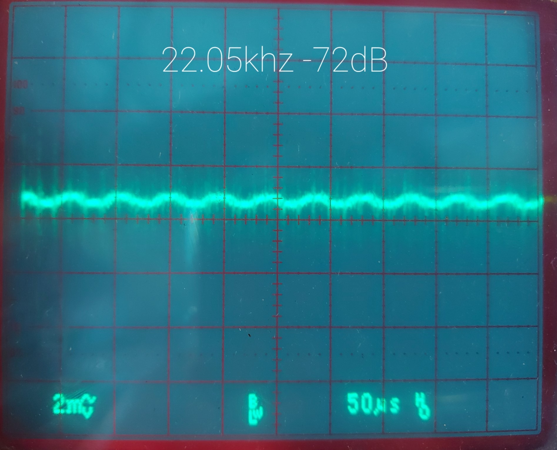

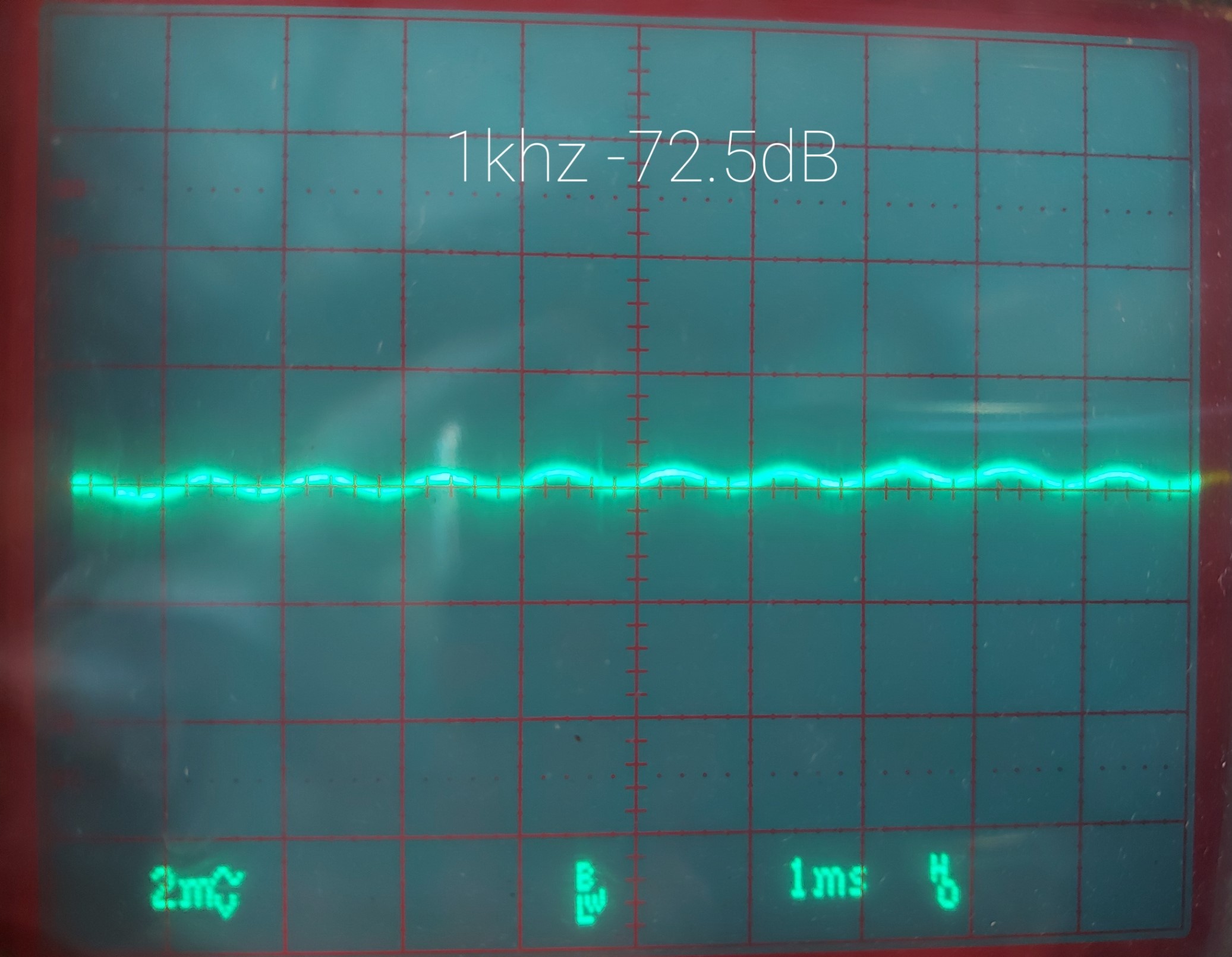

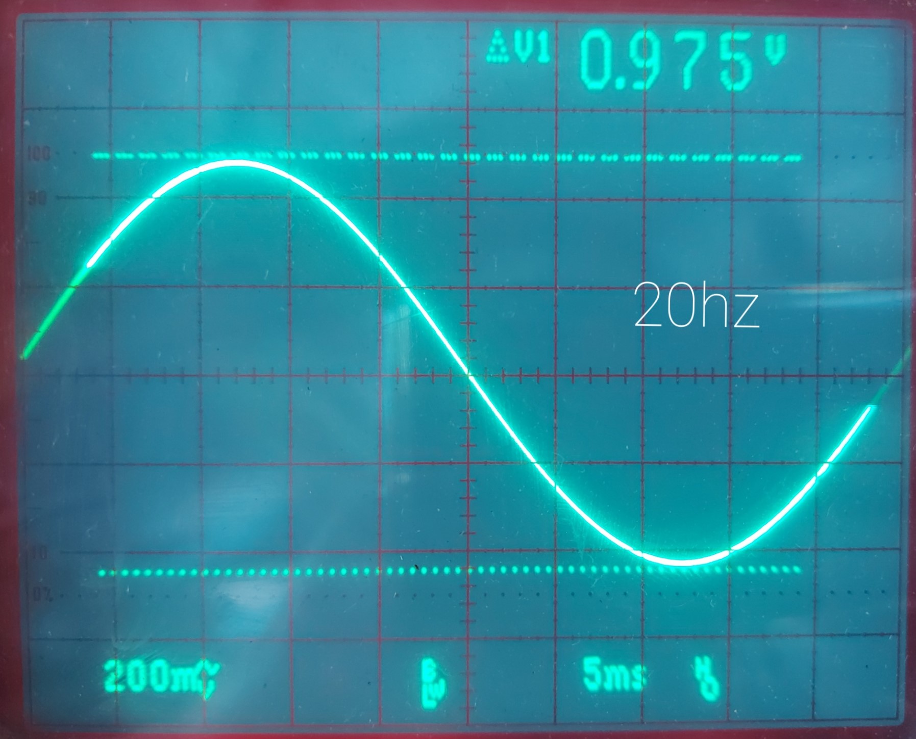

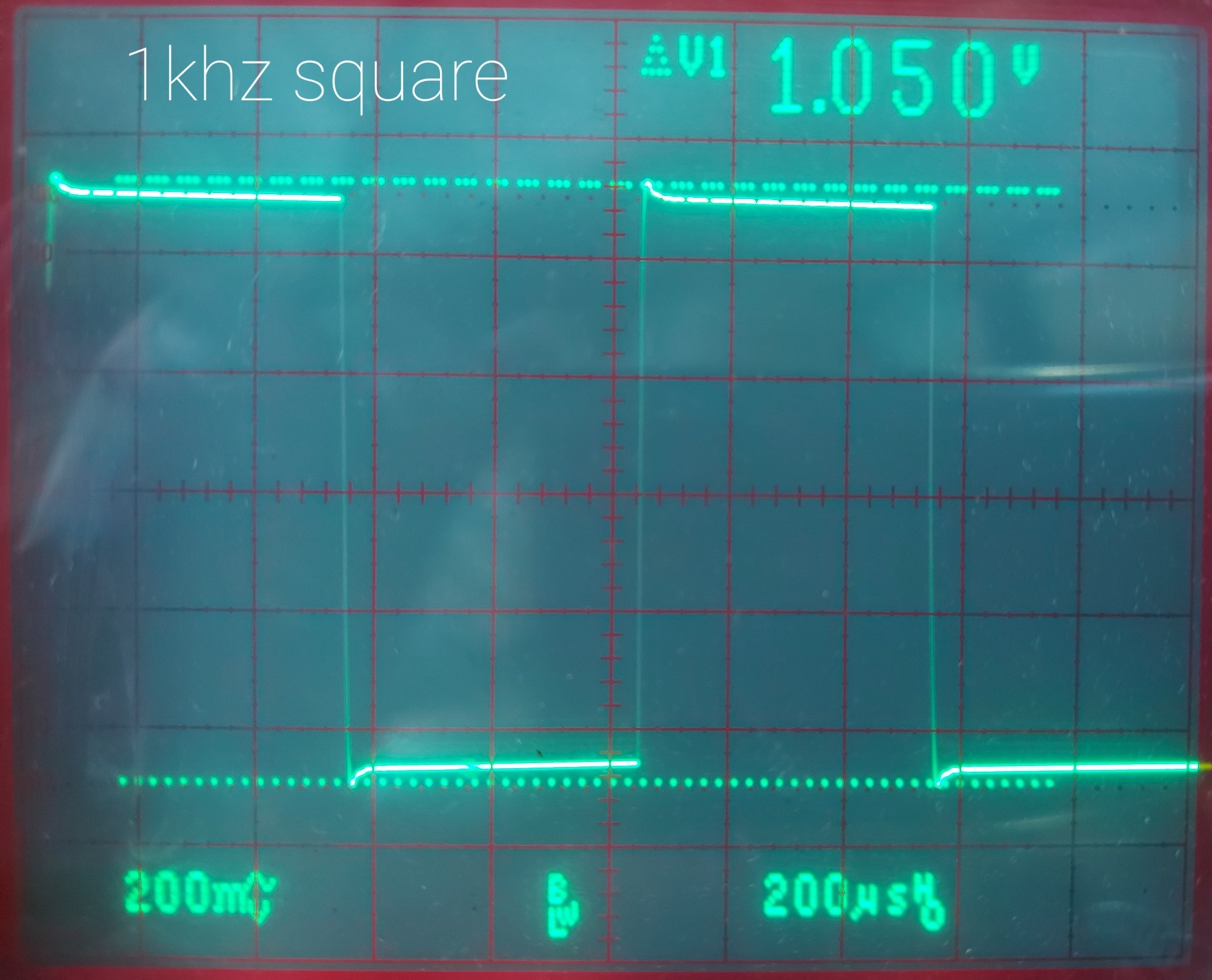

4 x D3 update
Hi All!
I've attached some oscillograms of my latest adventures with the TDA1541A (4 chips) running balanced into the Sowter 1465 transformers.
For IV conversion I have 4 x 13R hand wound CuNi44 resistors. The secondaries are in series with a load of about 20k (33k resistor // DCB1 input of 47k) To lower the ringing/overshoot I used about 700pF and 10k in series across the secondaries - still adjusting this.
So far this is the best result i've had with output transfomers, the sound is very natural with no fatigue.
Edit: Source files were all running at 44.1k
Hi All!

Ryan,
Very cool! The distortion products look very benign, however, I do think that they mildly contribute just enough to make this the most enjoyable dac I have ever heard. You hear deeply into the recording, with essentially the same detail as my ES9018, but with a much wider presentation. They both use hybrid IV OPSs, discrete class A to tube, and I have excellent,overkill, quite power supplies.
That is the key here, in addition to output stage, try different power supply schemes. A tube rectified C-L-C-L-C sounds better to me than silicone diodes. Try it!

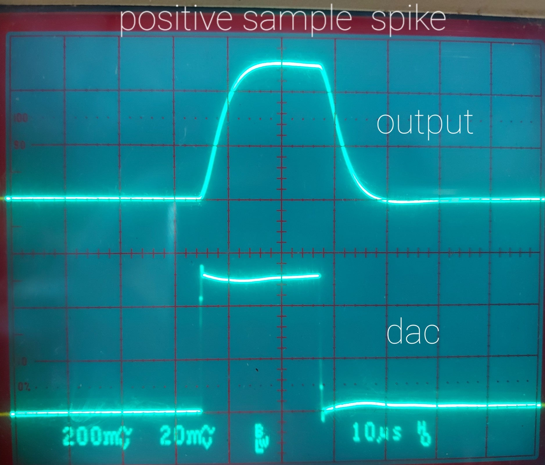

Hi Ryan,
These measurements look very good. What is the bandwidth of your scope?
The square wave output marked dac is the dac output at the iv resistor?
I understand you use the iv resistors on the primary side of the transformers. I connected them on the secondary side, (Also sowter 1465) this seems to be a better way (havent’t tried primary though), did you experiment with both positions?
I am also interested in your damping capacitor for the overshoot, what is the audible difference?

Thanks Greg,
To be honest I dont think my distorition measurments are accurate, they are very inconsistent - when I change the input voltage range the harmonics change completely, H2 goes down to -70dbr, and H3 goes up to -50dbr. Also the noise floor changes depending on the settings. So im thinking my results are not reliable, Ill have to see if I can upgrade to a USB sound interface and install REW to see if I can get some meaningful measurments.

Hi Supersurfer,
My scope is 350mhz, but the leads im using are 100mhz. The measurments above are all 20mhz band width limited.
Yes, the pic labled dac is what was at the dac output with 13R IV resistor. When only a load resistor is used on the secondaries (without an IV resistor on the DAC outputs) there is much more voltage on the dac output. When I tested with a square wave there was a 1Vpp spike on the DAC outputs (attached pics). This doesnt happen very often when playing music but it did concern me considering that the output compliance of the DAC is +-25mV.
The damping cap I used caused phase shifting (smeared sound stage that sounded nauseating), so I removed the cap, changed the IV to 25R, changed the secondary windings from series to parallel and changed the load to 10k. So far this sounds like a good balance.

Hi Supersurfer,
Yes I see your point - with your setup you need the current drive, but my concern is the impedance the DAC sees under the conditions as in my previous post (full current delivery in one sample). I'm really not sure if this is something to be concerned about as i haven't seen this occur in music I've observed on the scope. Maybe this is more of an issue when running at 44.1k.
As for the sound impressions - changing to IV resistor has made a positive impression on me so far, ill have to do a bit more listening but I think I have noticed an apparent increase in detail and transparency.
