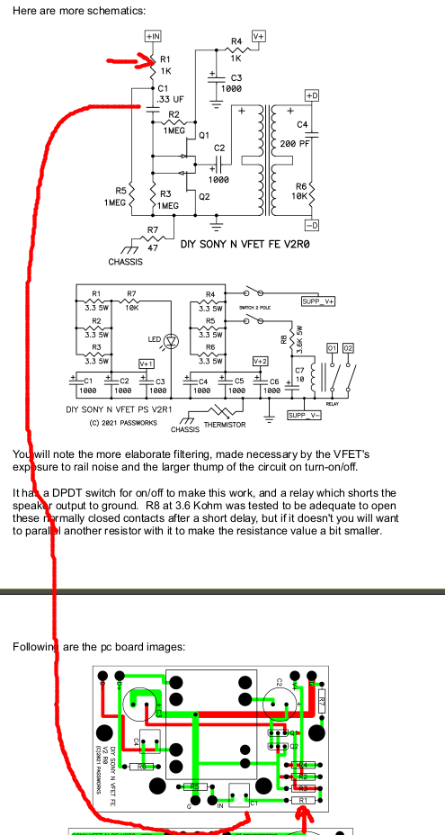

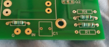

that is not error, really
call it Artist's Freedom
or you can call it - another Thinking Trap for Greedy Boyz
observe - R5 is still outside, to bleed C1
Yes, board and schematic do differ. But I think the way it is implemented on the PCB makes more sense - capacitor C1 as first element in the signal path, and R1 being able to function as gate stopper, connected directly to the gates of the JFETs.
