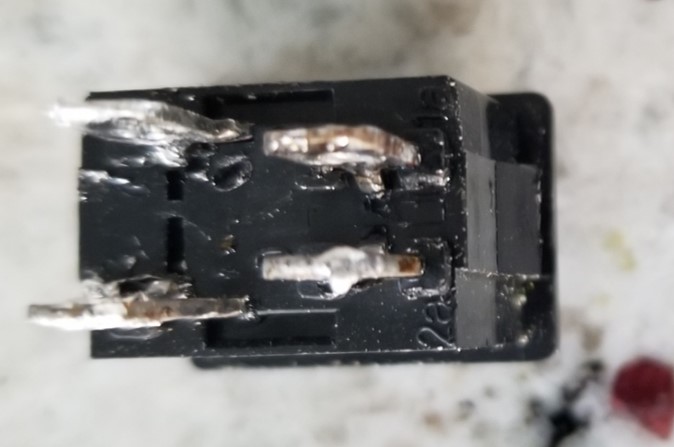

Yes it will do the job but technically you only need a DPST. I have this one in my cart that seem just perfect : https://www.mouser.ca/ProductDetail/CW-Industries/GRS-4021-0022?qs=qit5zruqE%252B%2FQTDoTW5oGZg%3D%3D
It's thump suppression - many can live without it, but I added it considering the complaints I would get from owners of delicate drivers and/or ears.

I want to repeat all he appreciation we all have for the hard work and generosity that made this kit possible. If you have not ordered a DPST rocker switch yet, I suggest you opt for one that has a DC rating. Digikey has in stock GRSV-4021-006, and Mouser has GRS-4021-0004. They may give a slightly longer life. However, if you already have another DPST switch, go ahead and use it and do not worry about it.
The switch that was supplied with the kit, a SPST, will still work if you do not have a turn-on/off thump problem. I remember a similar situation with the SMPS on the ACA, but the thump was so small on my speakers that it was far from objectionable. Maybe high-efficient speakers have more thump. Anyway, disconnecting the AC side (unplug the AC cord, or switch off the AC) greatly reduced whatever thump there is. 6L6 once suggested an AC power cord that had a switch built in, but I cannot find it.
If you do not think you have much of a thump problem, you can also try the amp without the thump-suppression section connected. Find the two 18G RED wires from the O+ pads on the PS board and disconnect them from the speaker posts, and tape the ends, or do not install these two red wires. You may be just fine with the small thump.
However, you do need to do something if you are using the supplied SPST switch, because the NC contacts on the relay will continue to short the speaker outputs S to G until the relay is energized (from a second pole on a DPST switch) or the O+ wires are disconnected.
